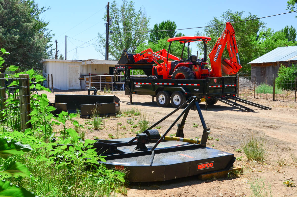

Lauren, thanks much for dump trailer advice. I took some measurements and think the 16' will be ok for weight distribution, but you are right, I should look into it more carefully. Backing in would probably not work well with a GN (maybe; if the goose neck forks which they
do tend to do). I think I would be in trouble with the 14' dump; that extra 2 feet makes a difference for tractor hauling. The trailer I have been looking at has 8K axles, 16K total, which ought to be enough and is at or over what I should be hauling already. A tri-axle trailer should be able to haul like 20K! That is too much for my truck and for hauling in the mountains; at that point I would be thinking about buying a used dump truck.
The three way tailgate would be nice to have; the PJ I am looking at has only the 2-way. Rear axle weight is a concern. My truck is also SRW, however the axle itself is rated at 10.5 or 11K. It is the wheels and tires that limit the rear axle rating to 6.6K or so (only 3+K for the load itself). A solution is to use 19.5 commercial truck tires and steel wheels - these are rated to 5K or better per wheel, as good as a dually. I don't see how a tri-axle trailer would help, since one still needs to have 15-20% of the weight on the pin. Check out for example, Rickson truck wheels.
A good test will be to load the tractor on my 22' bumper pull and use the Sherline scale to adjust the weight distribution. Then the distance from between the trailer axles to the front of the tractor will roughly give the minimum clearance at the front of the trailer required for a balanced load (with a bit of leeway as the front of the GN itself adds quite a bit of front weight). I will try that before I buy the dump trailer.

One rule of thumb i have found with goosenecks is they will put about 20 to 25% of total weight on the truck if loaded fairly normal.

I finally went ahead and got the dump trailer mentioned in an earlier post. This is to confirm that the M59 fits a 16' dump trailer well; I am even able to close the rear gate. Loading, tie-down, and hooking up to the truck with the gooseneck all look easier than with the flat bed trailer. Attached is a picture of the tractor loaded into the dump trailer to check out the fit, although I have not yet had a chance to tow with it loaded.

Looks like a neat package... made to order.
