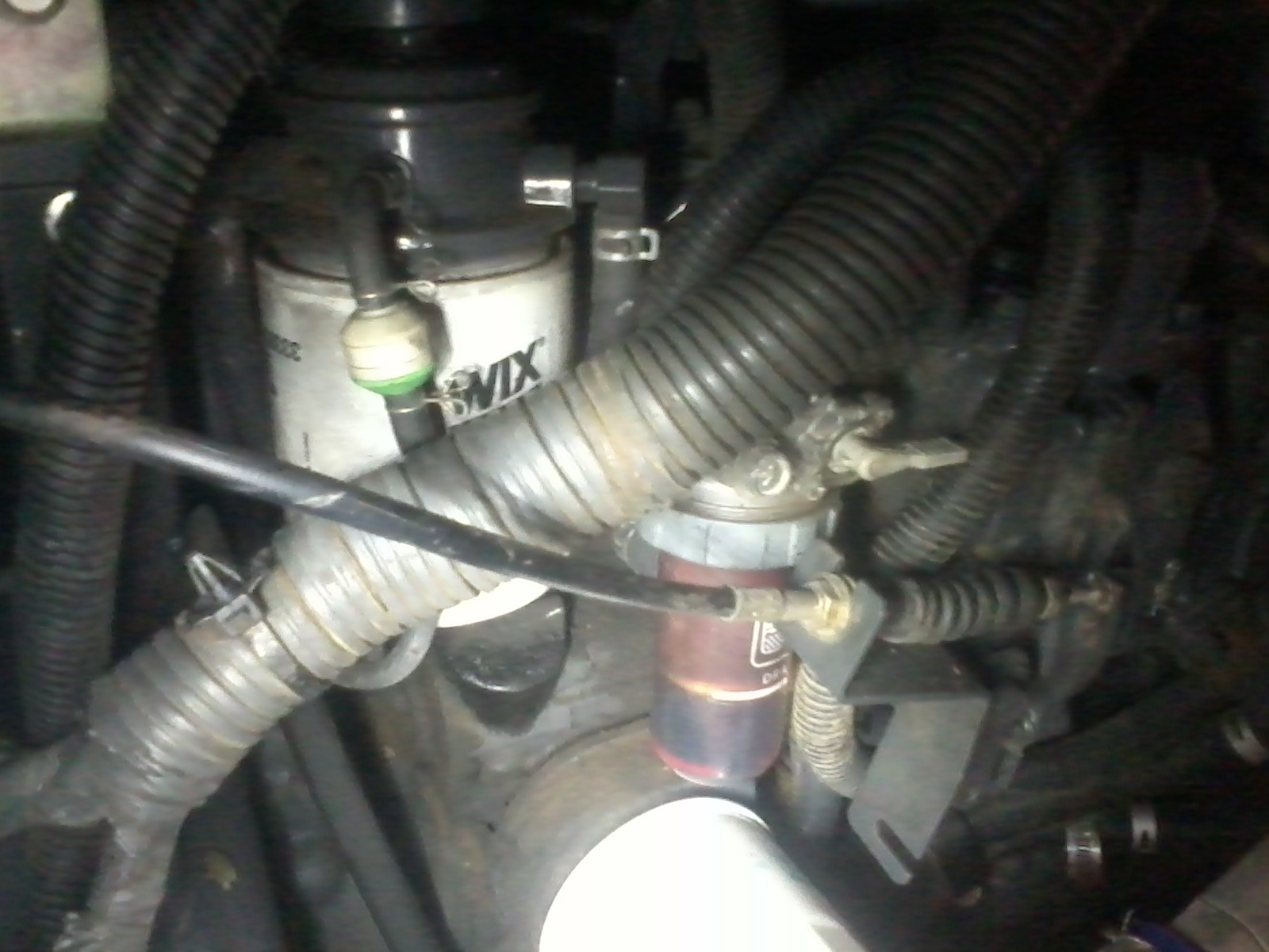

Maintenance stuff
Found a leak in the upper radiator hose (3C981-32439), need to order it. Going to replace all the filters to set my baseline.
The water separator is in a tight spot. If the loader bracket was remove it wouldn't be so hard, but still squeezed in there. It looks like it just unscrews but only being able to get a few fingers on it, doesn't get me much leverage. Assuming its like the ones on my track loader, shut the fuel off (I see the lever) remove, clean out, clean and inspect element, reinstall loosely, turn fuel back on and when fuel starts spilling, tighten.
Anyone have any tricks or tools that work? Figure I'll try my nylon filter strap wrench if nothing else

After I posted this comment I did find the other thread on the M7040 with same comment. Appreicate the responce. Did go out this AM to do some more work and it was around 34F and it didn't make a full turn over before it fired right up. Guss this is an issue I don't need to worry about.
Now if I can figure out how to get the separator removed for cleaning
/ M9540HDC24 #12
Yeah mine cranks easy.
Every time I've changed mine I've been able to get it off by hand. Probly jinxed myself now.

I got the water separator off, used a large pair of channel locks that barely fit on. Didn't take a lot but once moved I could go the rest of the way by hand. There was a bunch of crud in the bottom, yet another sign that who ever owned it, did very little maintenance.

Another question; How is the fuel filter and separator refilled?
The fuel pump appears to be mechanical which is mounted on the injection pump. The fuel filter housing has a plastic thing on top but does not appear to do anything if push down. Unable to find a bleed screw or other hand pump, and when the fuel valve is re-opened on the separator, no fuel comes back in
