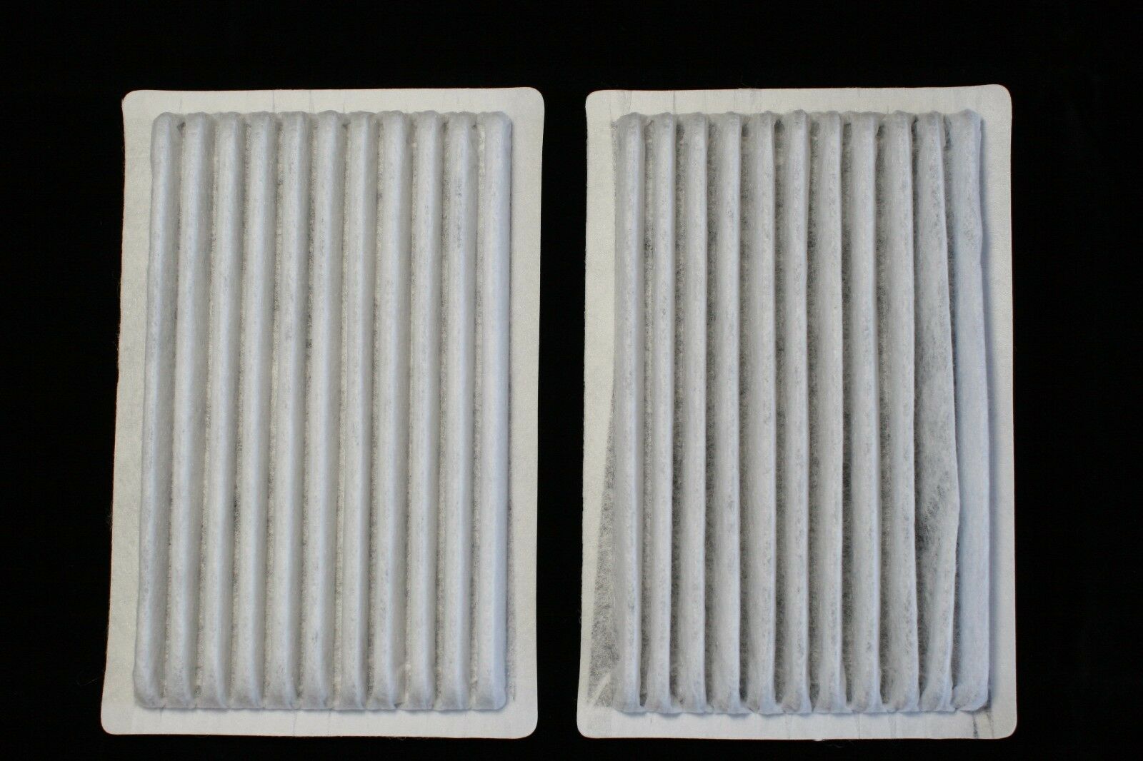

Anyone try using just regular filter media for the inner air filters?
At $20 something each (6A671-75090 req 2) is a bit much

Not the engine air its the cab filters, 4x6x1/2
/ M9540HDC24 #32
I have the same filters and no need to replace them. Just wash them thoroughly in warm water with detergent and let air dry. They look just like new after washing.
/ M9540HDC24
#33
Will give that a try, thanks
