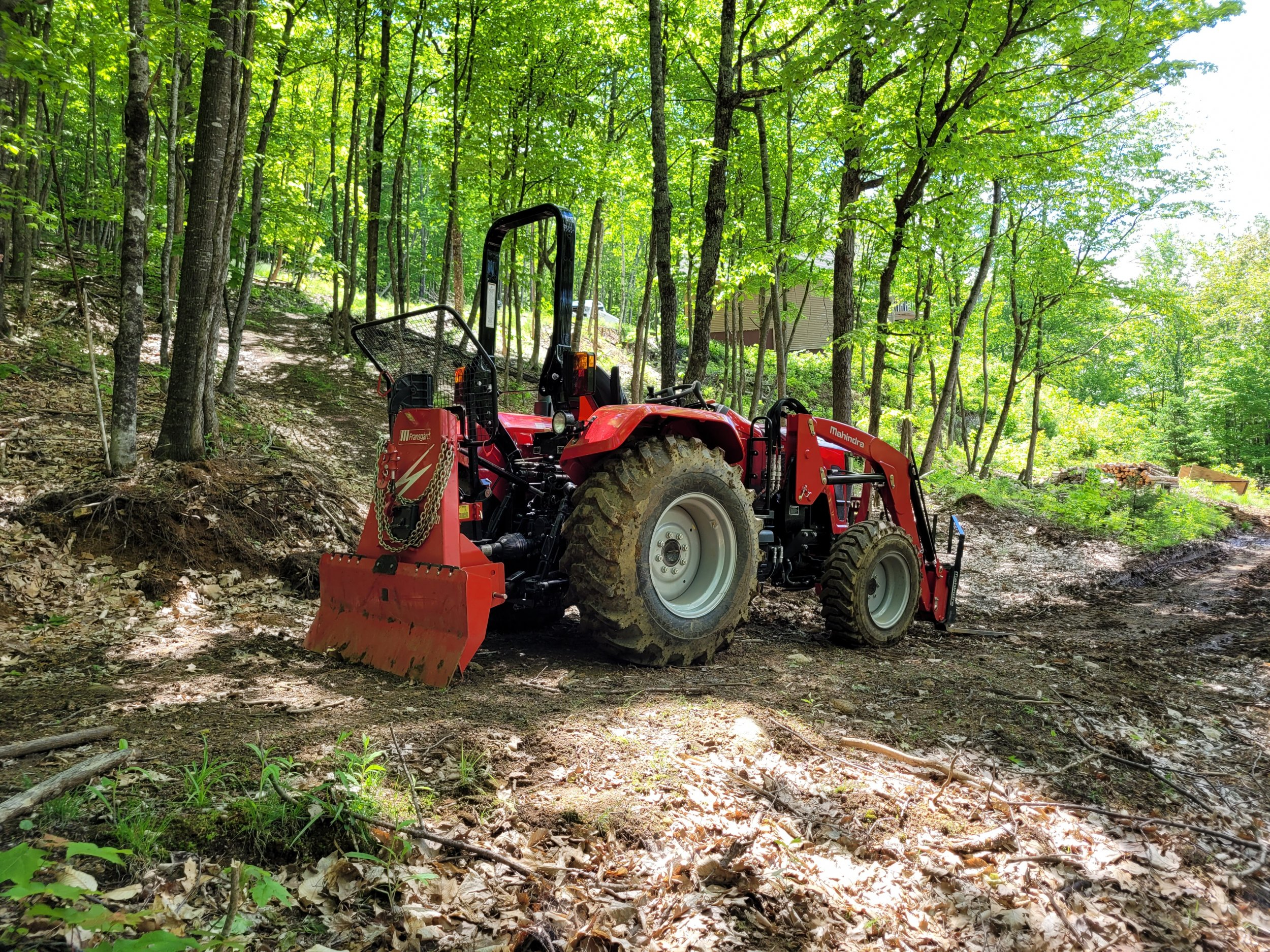

I wish that I could make my wood fall in a neat pile like that, mine is always all over the place lol. What is that attached to your 3pt? I'm thinking that i can build a saw carrier and attach it to the grab handle placing the saw between the FEL frame and the knee shield.
Haha, yeah I wish I could make it fall in a pile like that as well. Would save a lot of time. My wife and I spend many hours processing, stacking, then later on moving and restacking our firewood.
It's a wood winch! It's a Fransård V-4021. 8.8k lbs of line pull and 164' of 3/8 cable. I just purchased it a couple months ago after wanting one for pretty much all of my adult life. It has very quickly become my favorite and most-valued implement by far. It has made logging for firewood on our steep mountainside property much easier and safer, while significantly reducing strain on the tractor by using the winch to skid logs instead of the tractor's driveline.

I also have the skidding/logging/forestry/wood winch on my 5155. It is a KRPAN 4.5E. Just got it and haven't gotten to the PTO shaft adjustment, if needed. Still working on installing a W.R. Long third function.
On my 4550, I had the smaller KRPAN 3.5E which is good for a tractor 25-45 hp. It worked so great for pulling logs to the tractor even up steep hills that I wanted one on the back of my new 5155. The old one is available for $2100 - see photo.
Also, the 5155 is 97" high and my garage is 95: high. So, cut down the height of the ROPS by 5" to allow for a future canopy. See photo of original work not yet cleaned and painted.

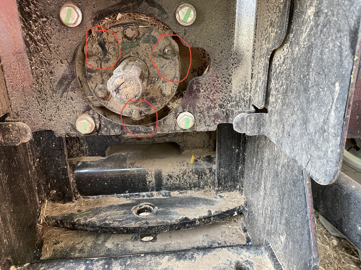

so sad day, I broke my tractor. The dealer is picking it up saturday. something broke in the front driveline. I will follow up after the dealer inspects it.
Any word yet on what failed on your tractor?

I just went by the dealer ( great guys btw) and there is something broken in my front axel.

Well that sucks. Let us know what they find when they dig into it.

just got the word, they found broken spider gears, the service manager (also a great guy btw) said that they never see these break and it is the same assembly as used on other mahindra heavy tractors. he thinks that this is a one off manufacturing defect. I would think that this is a manufacturing defect also because the spider gears are usually not the weak link in a diff. I was betting on ring or pinion. Also they expect parts delivery to not be an issue, :)

just got the word, they found broken spider gears, the service manager (also a great guy btw) said that they never see these break and it is the same assembly is used on other mahindra heavy tractors. he thinks that this is a one off manufacturing defect. I would think that this is a manufacturing defect also because the spider gears are usually not the weak link in a diff. I was betting on ring or pinion. Also they expect parts delivery to not be an issue, :)
Well all the n all that’s great news. Both in that it’s not the load carrying components of the axle and that the parts are readily available. Yes very unusual to have spider gears go bad. If they suffered from brittle failure then they likely were heat treated to too high a hardness. Which is what is likely or it simply could have been a bad lot of raw material. They likely don’t hardness test every piece but instead do a lot hardness test on a sample or a few samples from one lot or batch. So it’s possible for a “one off” bad piece to happen from time to time. Also good to hear it’s the same pieces as used in their bigger tractors. That lines up with everything I understand about this series. They were designed to be very stout mechanically. Let us know when you get her back. I’m at 40 hours now so getting close to doing my first service.
