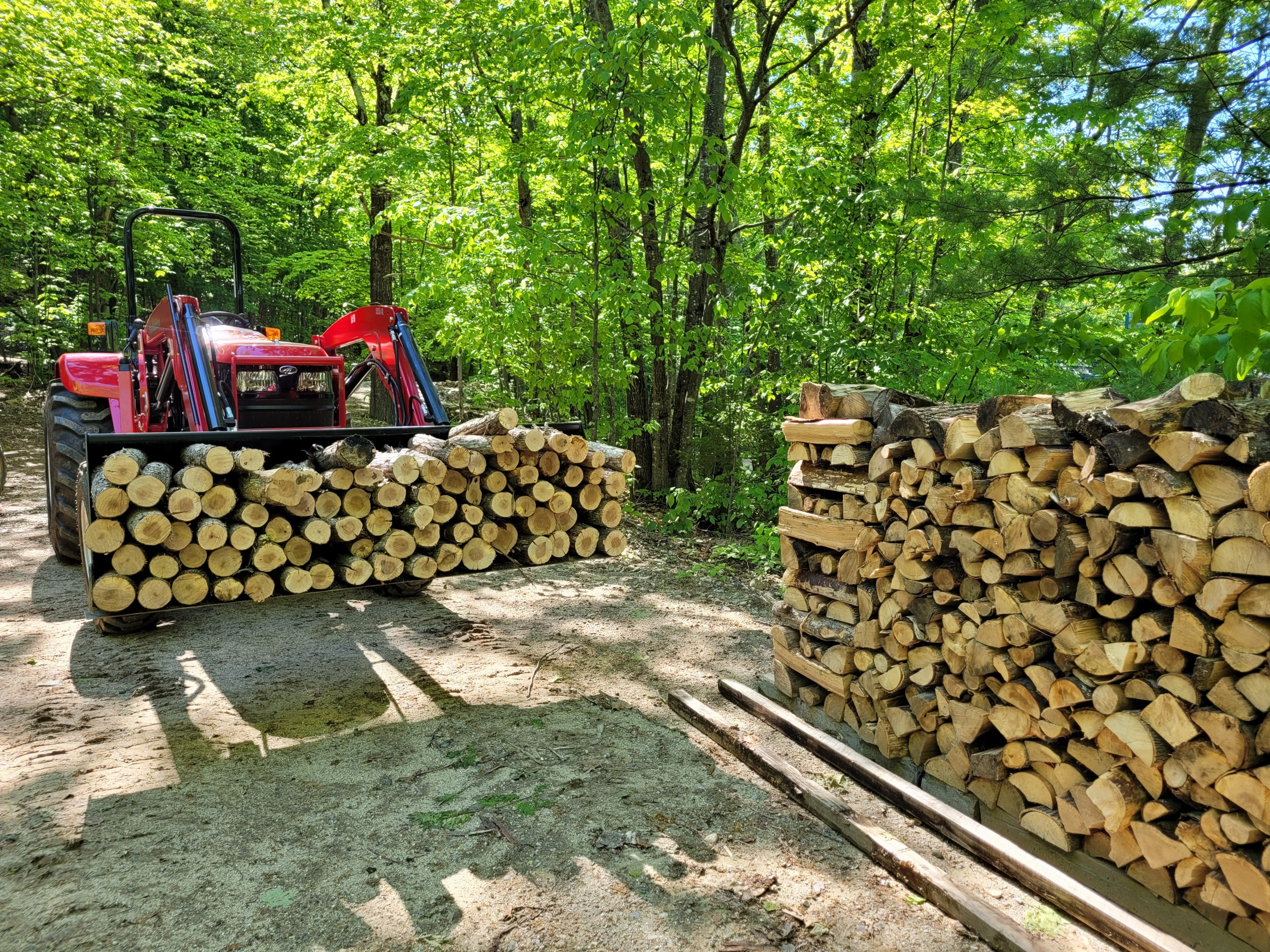

On another note, I've been using mine to gather and process some firewood lately. 29 hours on the tractor so far, and I'm really loving it compared to my old 4540. It's hard to say this without sounding biased since I own a 5155. But, I've operated many different tractors in my life including compact Kubota's and Cub Cadets, CUT JD's and Mahindra's, and AG sized Kubota's and New Hollands. The 5155 is my favorite tractor that I have operated to date.
Anyways, couple pictures of the 5155 hauling firewood.
Also, I mounted a Sawhaul chainsaw carrier on my 5155 today. Seems to work really well, I like it a lot. The Sawhaul "tractor kit" comes with a large u-bolt that clamps the carrier to the loader frame. I opted to drill two holes and bolted the carrier to the loader frame.
View attachment 749071View attachment 749072
I wish that I could make my wood fall in a neat pile like that, mine is always all over the place lol. What is that attached to your 3pt? I'm thinking that i can build a saw carrier and attach it to the grab handle placing the saw between the FEL frame and the knee shield.
