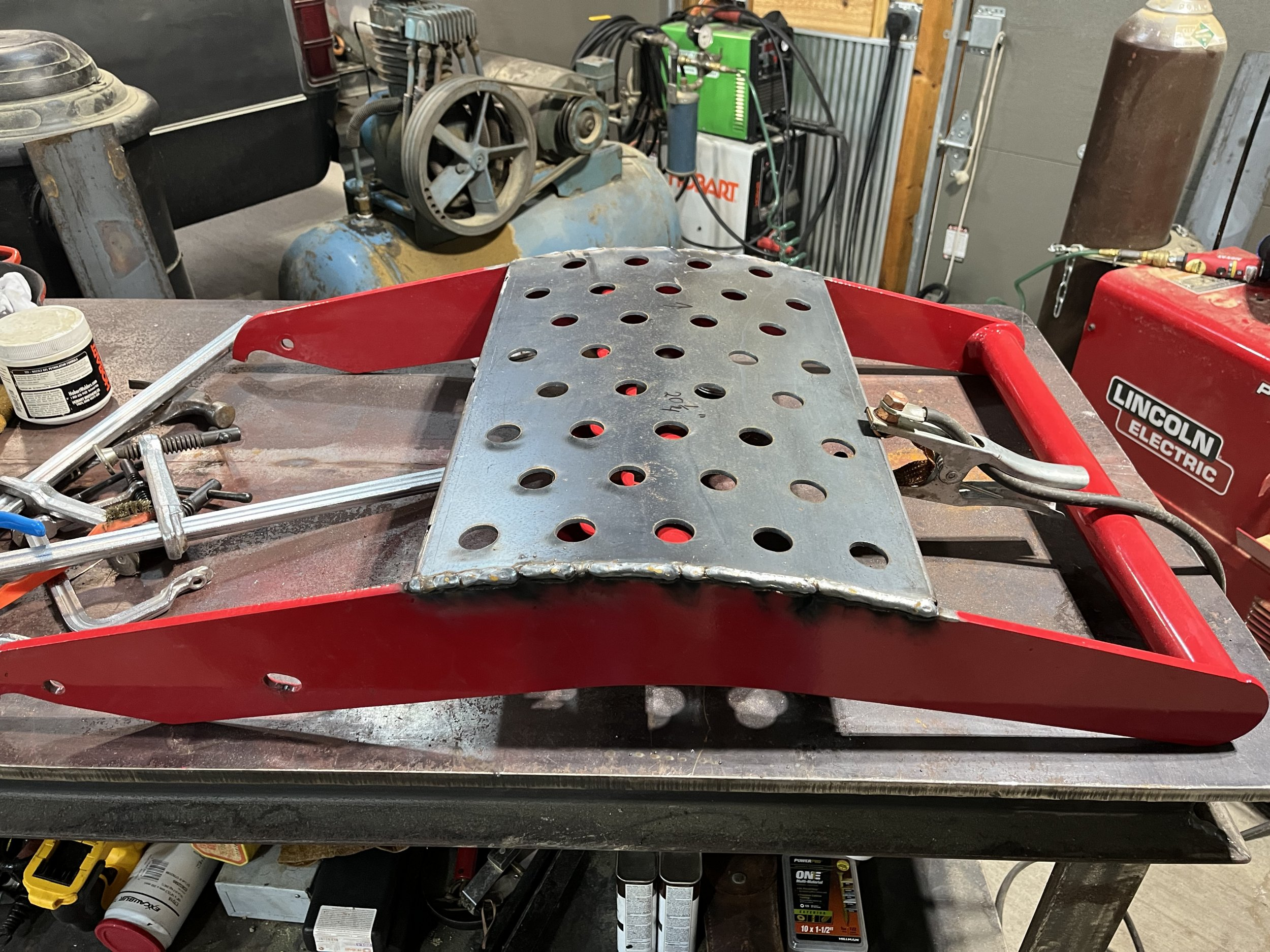

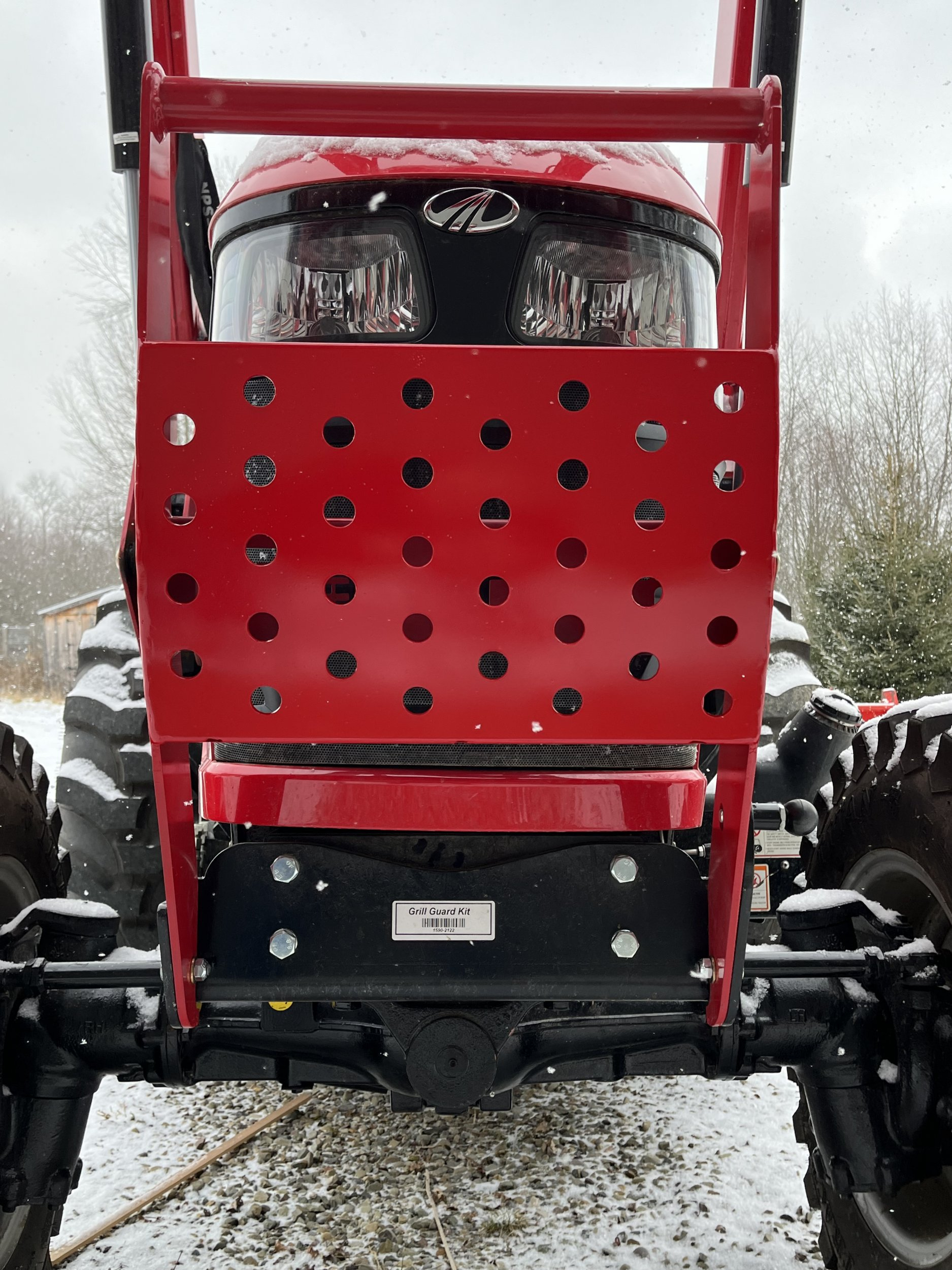

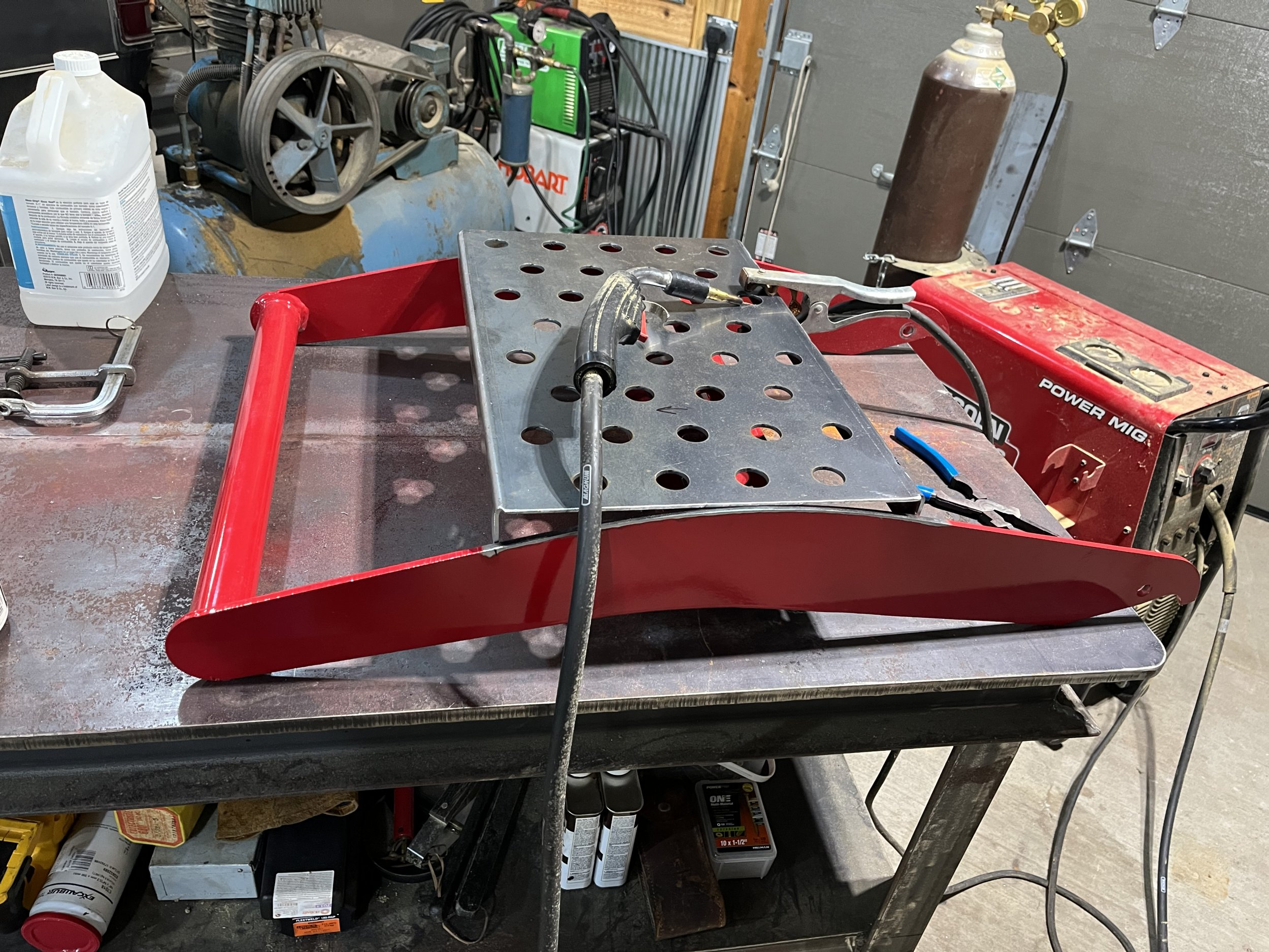

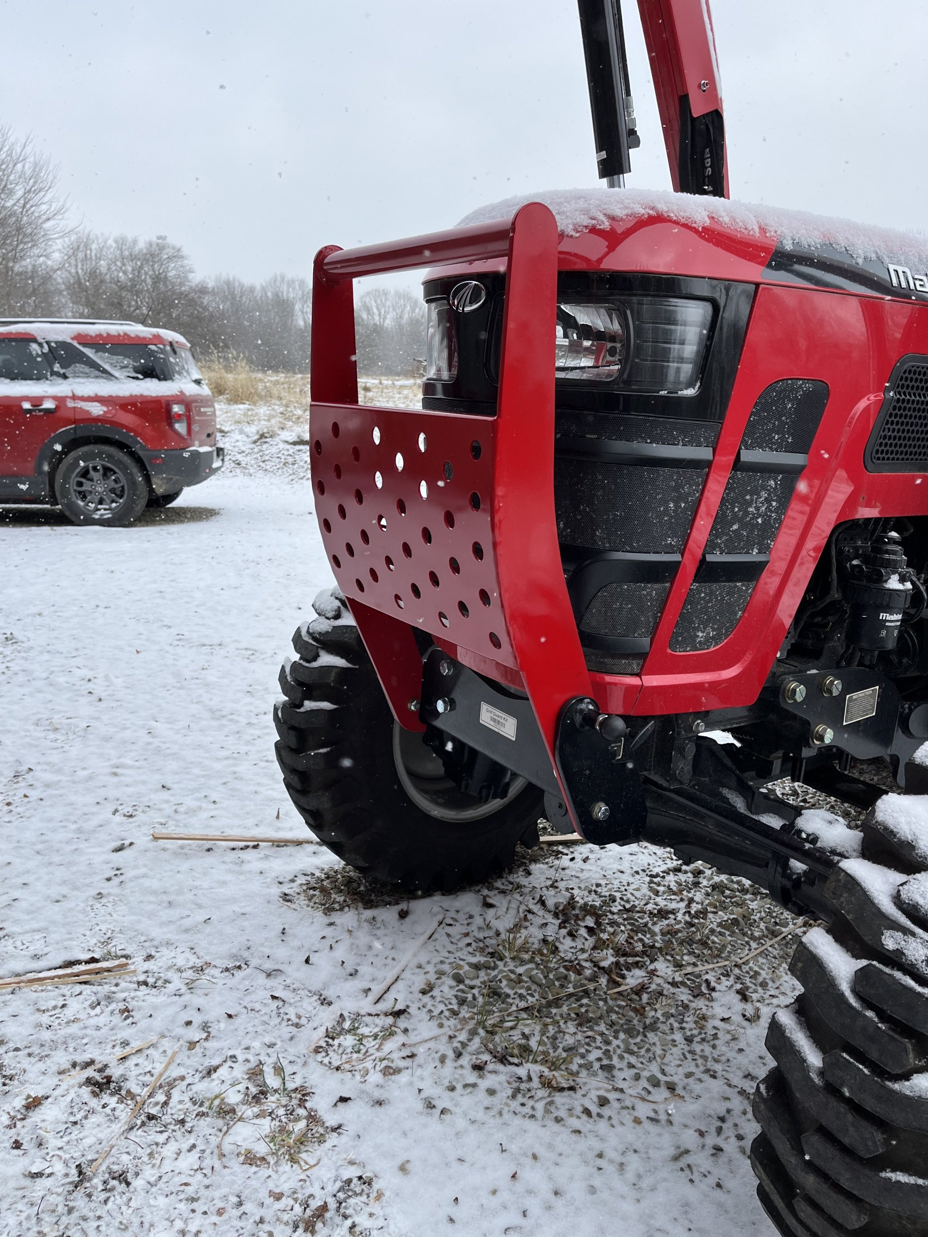

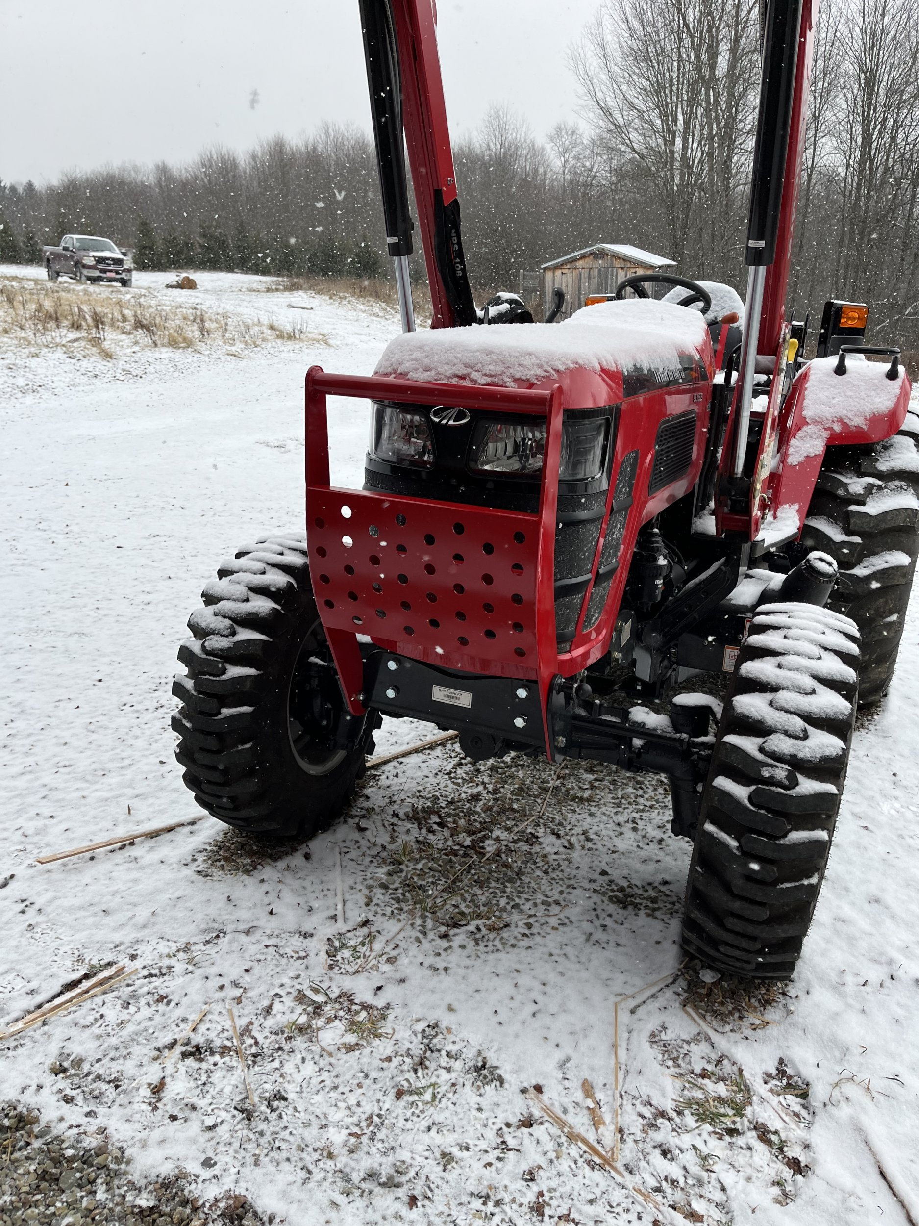

Just a little project I finished up today. I wanted to improve the protection of the factory grill guard. So I got a piece of this 11 gauge steel that had holes plasma cut in it. It was a leftover piece from a shop I know so I got it cheap. Anyway I think it will improve my chances of not puncturing my radiator when I’m using the grapple etc. BTW I found that Rust Oleum “Sunrise Red” is almost an exact match for the Mahindra red color.

Just a little project I finished up today. I wanted to improve the protection of the factory grill guard. So I got a piece of this 11 gauge steel that had holes plasma cut in it. It was a leftover piece from a shop I know so I got it cheap. Anyway I think it will improve my chances of not puncturing my radiator when I’m using the grapple etc. BTW I found that Rust Oleum “Sunrise Red” is almost an exact match for the Mahindra red color. View attachment 775144View attachment 775145View attachment 775146View attachment 775148View attachment 775149View attachment 775150View attachment 775151
Nice, i'm thinking of doing the same but i'm planning on using bar grate
