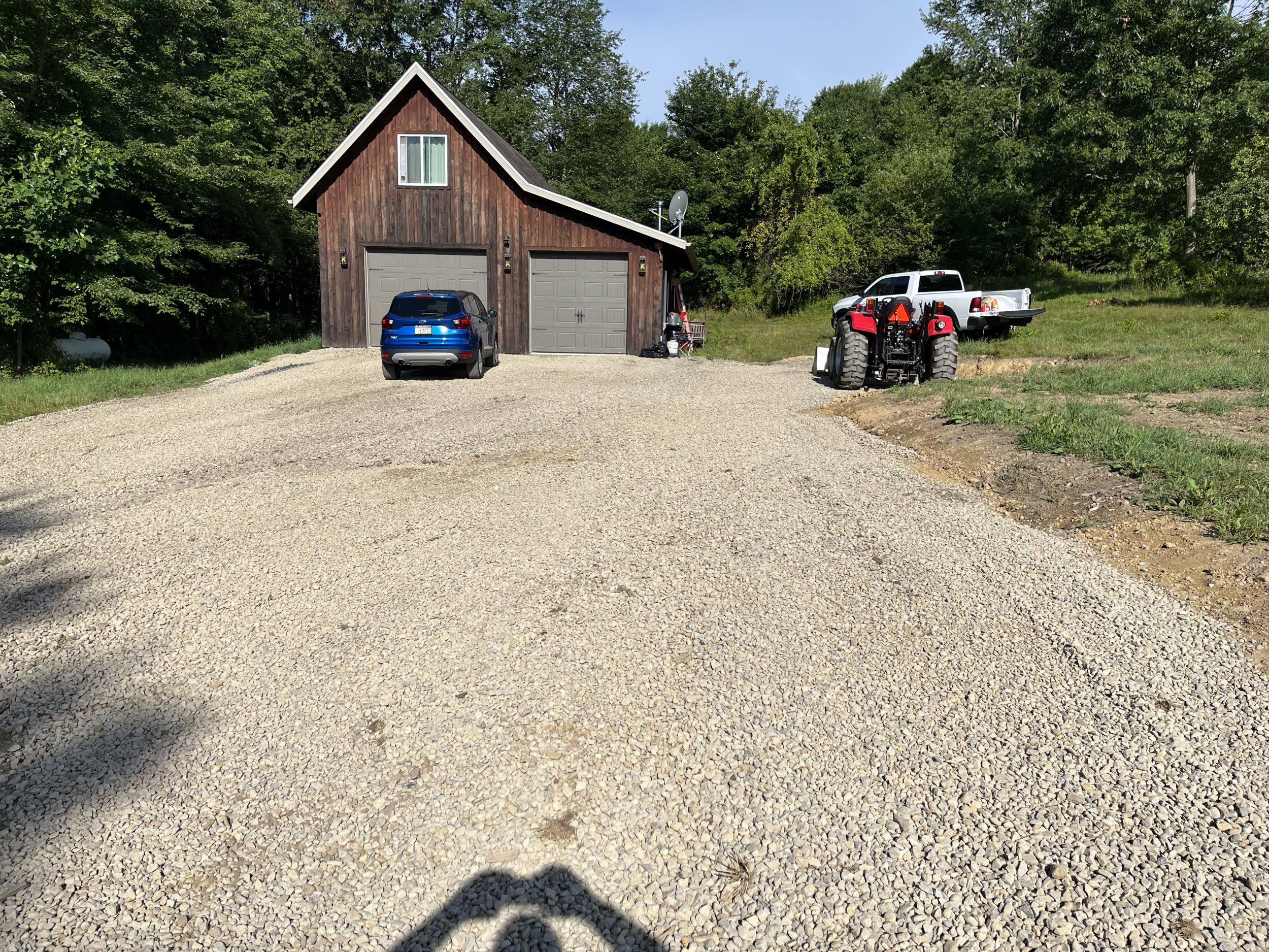

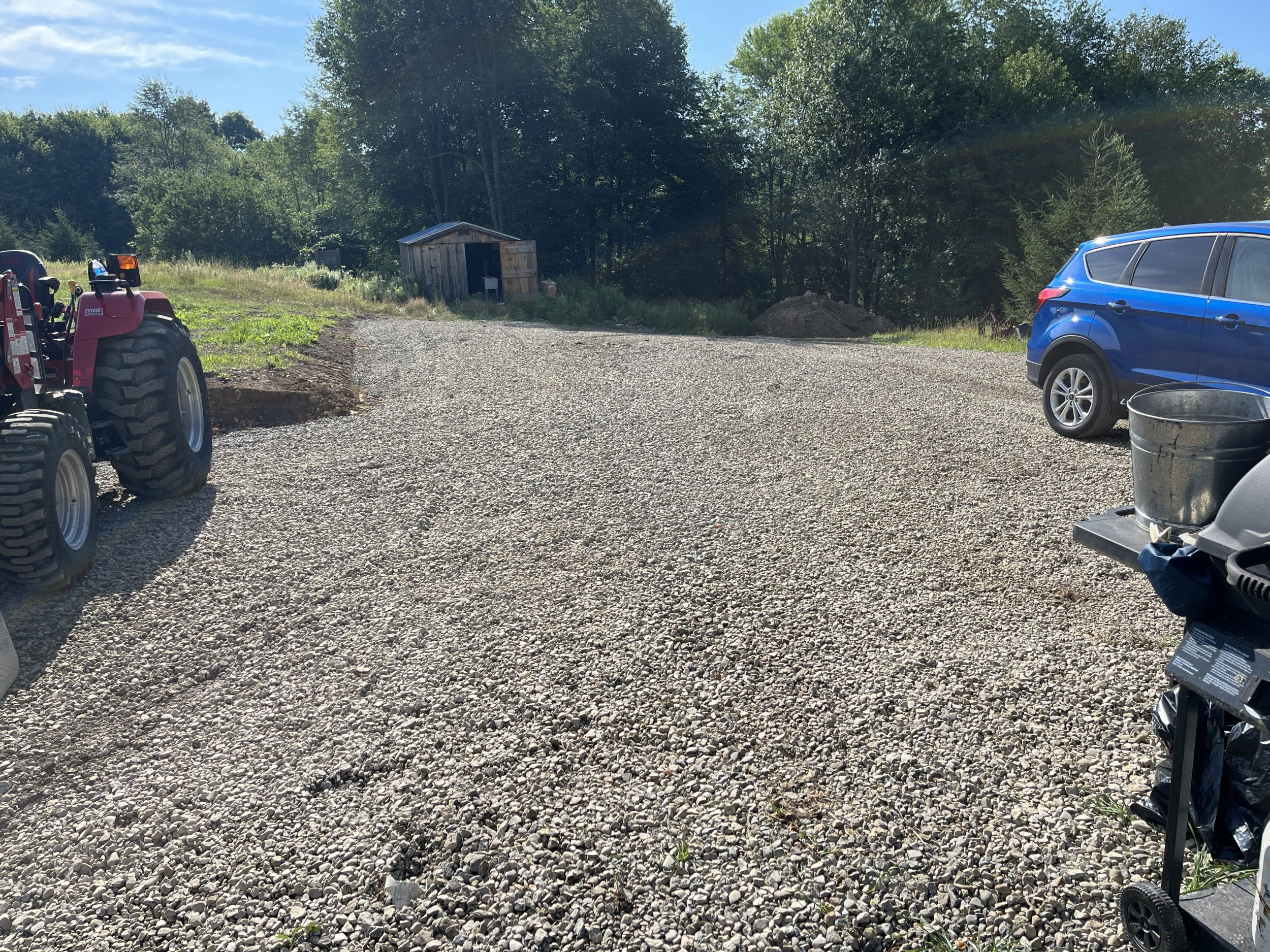

Spent this Saturday and Sunday clearing land around my shop that I'm building... this 5155 is a workhorse!!!! I love this thing!
