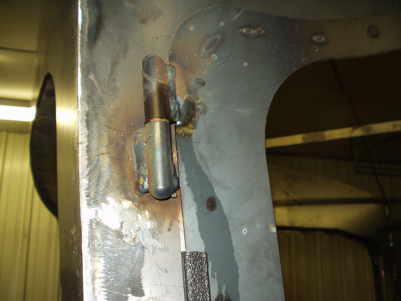

I made "Regal" Style door pulls. I liked Regal's idea so much, I had to incorporate into my doors. I used lighting fixture down rods from my junk pile, slapped them with the 1/2" EMT pipe bender and welded them in place.........thank you Mr. Regal.
I bought $8.00 HD storm door handles with latches for each side.
They have a lock with can be accessed using a small pin sized wire, if I need to lock the doors. Maybe I should have gone the extra mile mile and bought the latch with door bell button, incase I take a nap in the machine and someone stops by for a visit.

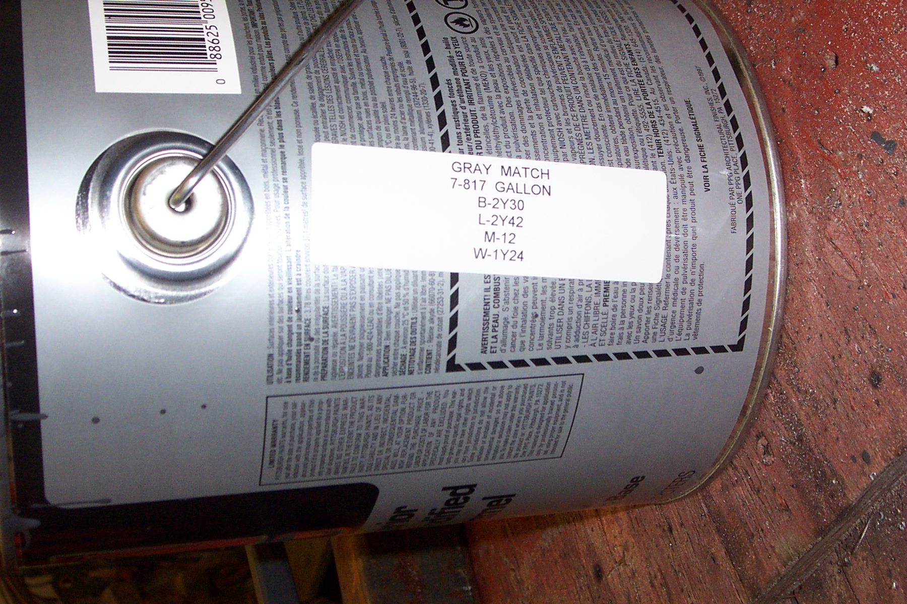

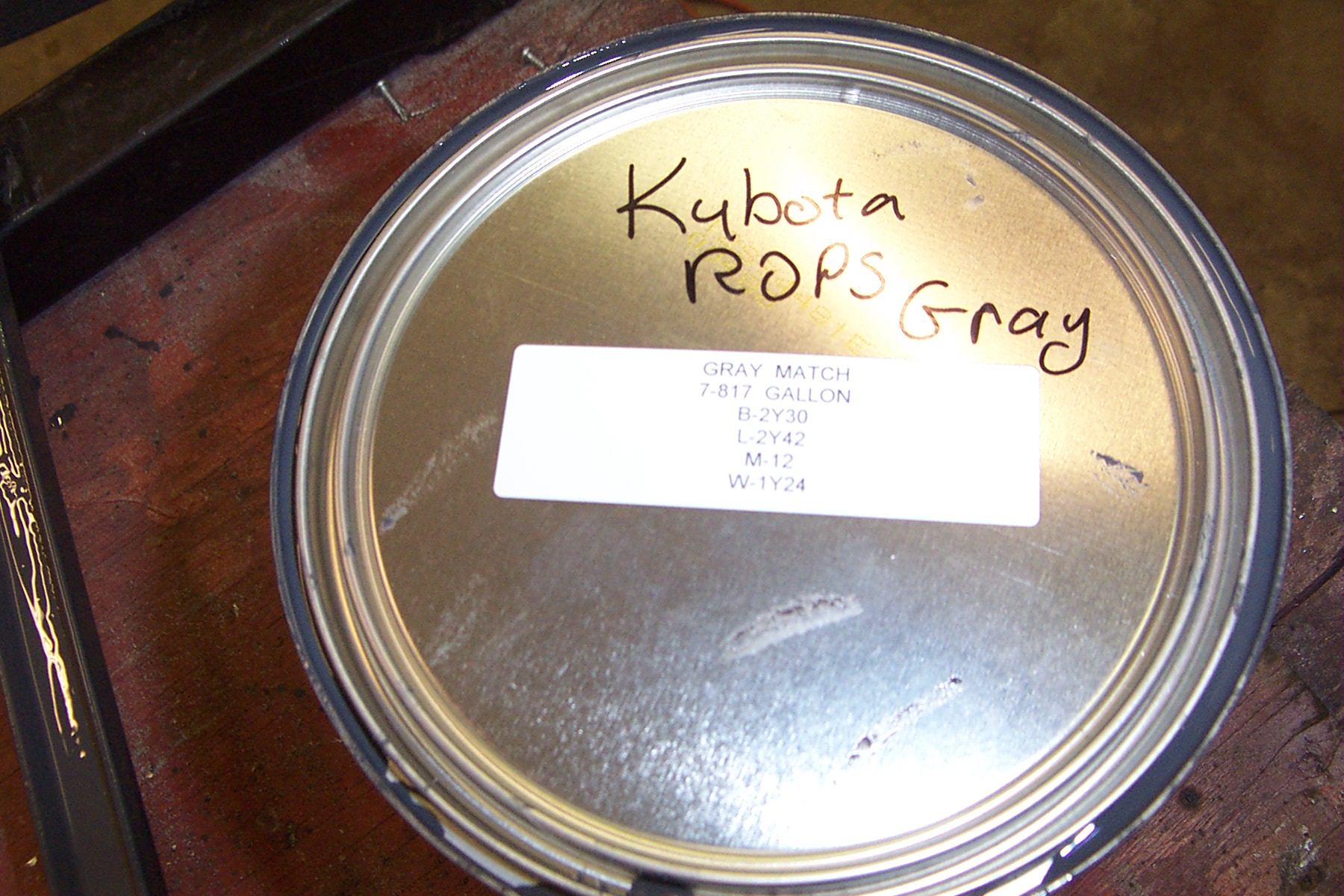

Had a local guy match paint, it took him all day...paint has to dry and that takes time. He needs an extra day for the Bright orange 2.
I have the formula for the Rops gray. as you can see it is in the process of drying very close to original color.
Oh and $28.00 a gallon.... compared to 12oz spray can with 6 oz of paint and 6oz of propellant for $12.00.
Pick up the orange next week, let me know if anyone is interested in the orange formula.

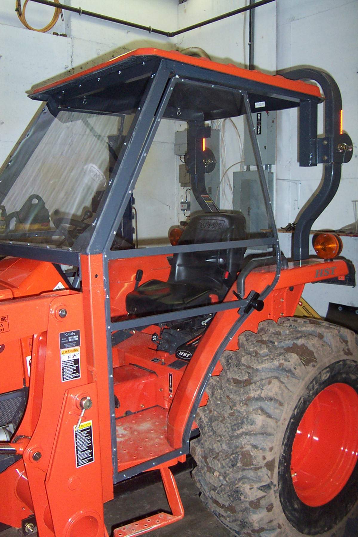

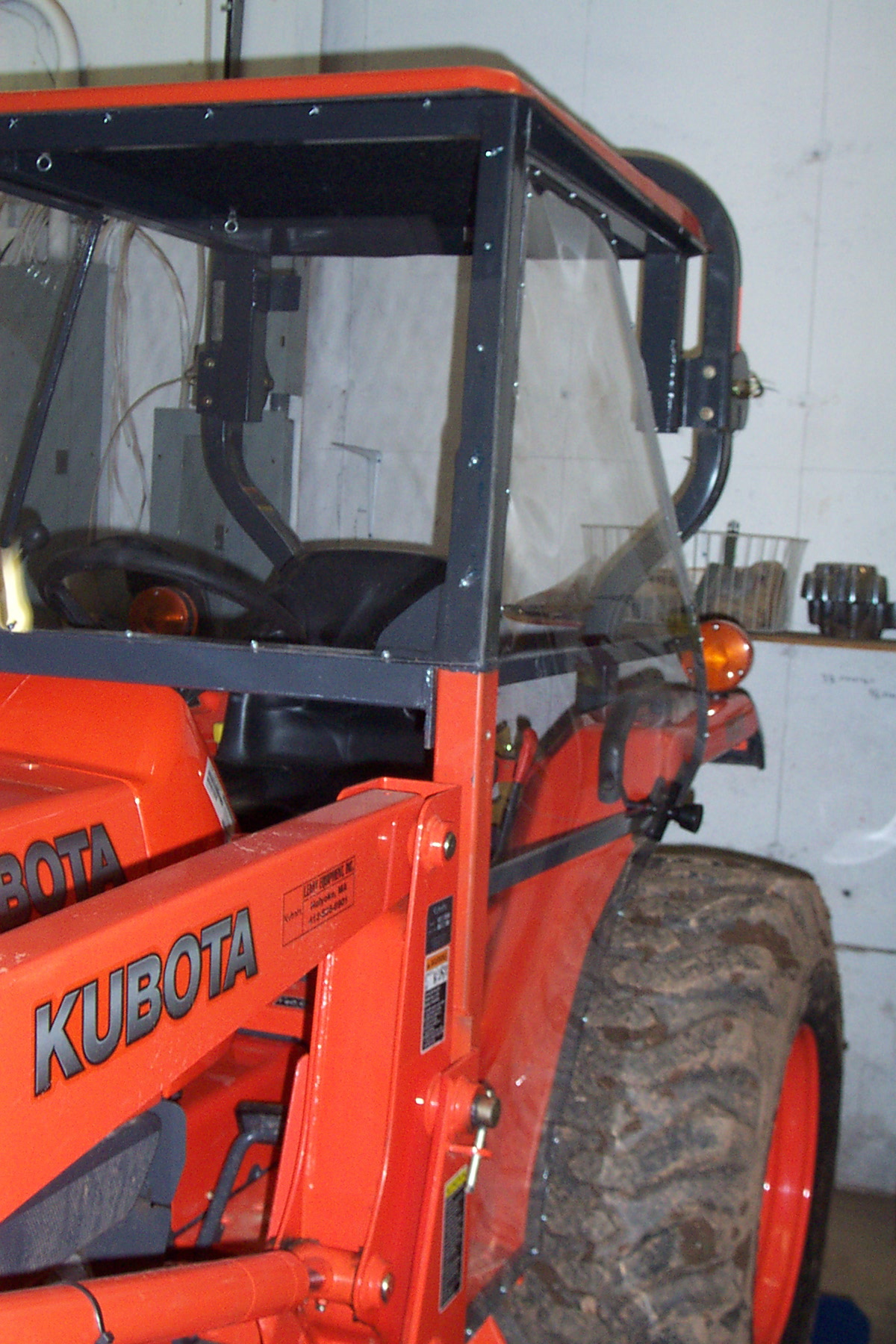

I finished the doors. They scratch easily, but work well against the wind.
It seems to lift the noise level up, so I will take them off and just use them for plowing. I need them in place for now, so I can fit the next pieces around the back of the cab.

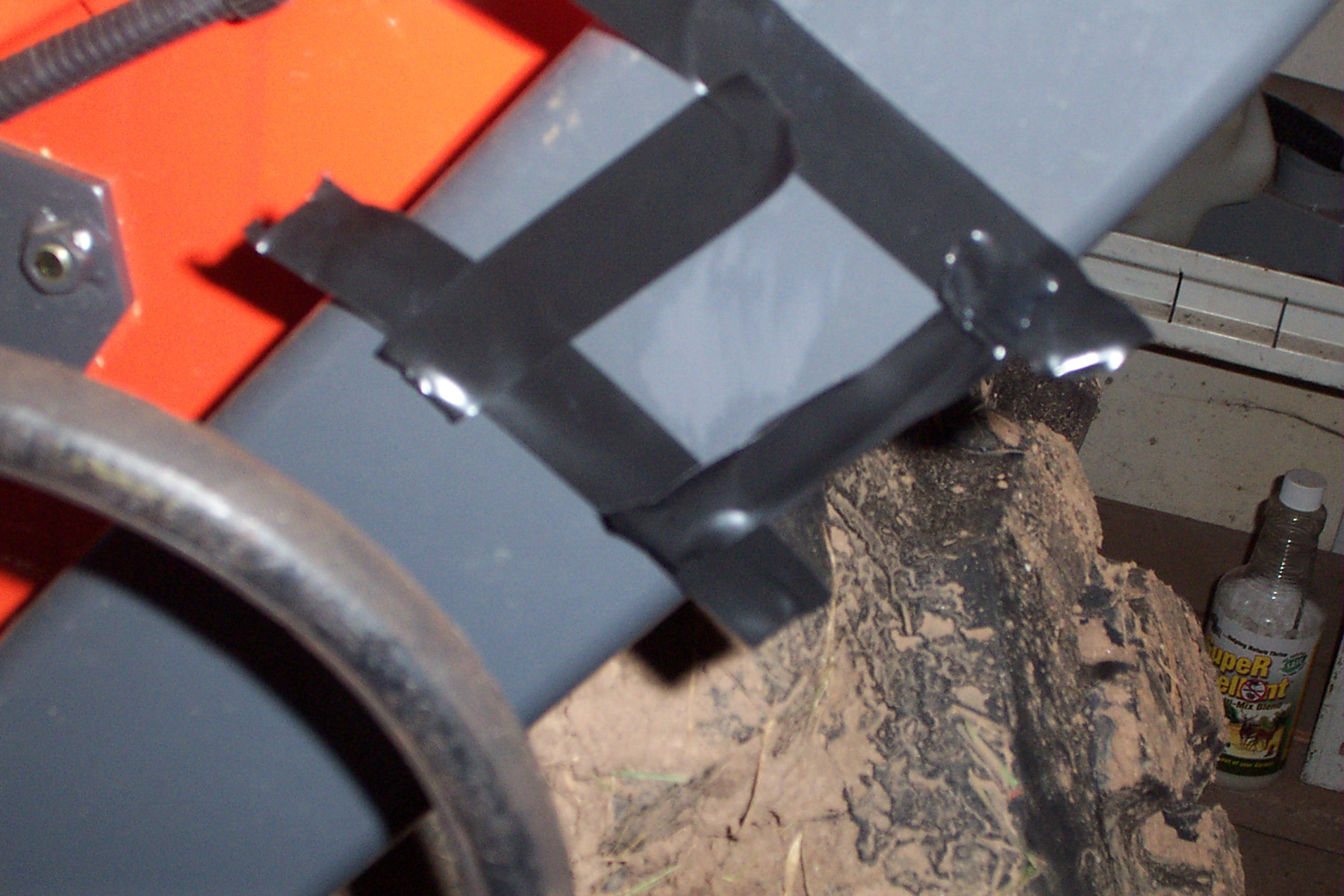

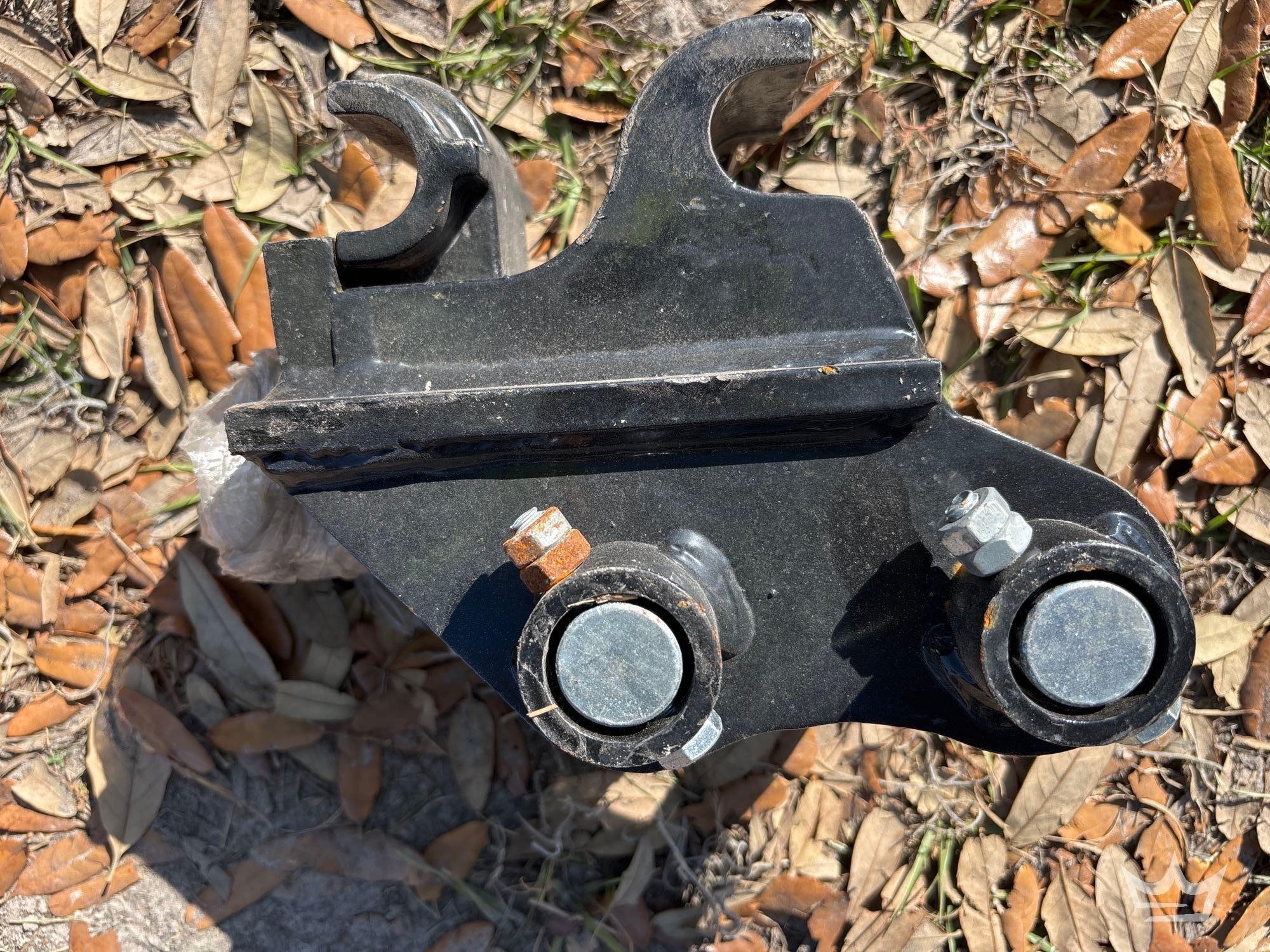

I made this set up for my canopy. The little bracket mounts to my rops. Then I take the canopy with the large brackets and drop them into the small ones and insert a holding pin. $20 plus shipping if you want them.
You can postion the canopy over the just over the rops and therefore it can be set back a little to cover the backhoe seat, depending how far your backhoe sits. I made a custom backhoe bracket because I wanted my bachoe to sit close to the tractor. I was able to cover the backhoe seat with these brackets.
Oh and to answer your question, I have plenty of room getting in and out of the tractor. I'm 5' 10".
