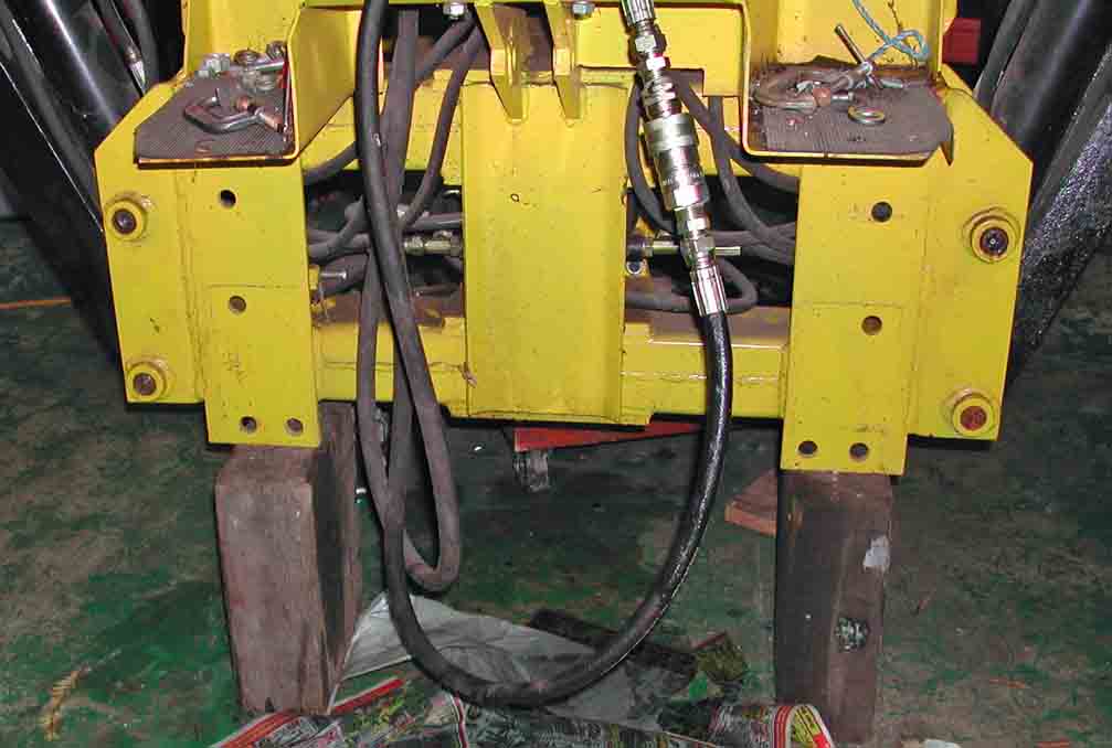

Very nice work. Could you explain how the backhoe is attached to the tractor? One of your pictures shows 3 bolts. What else holds it on? Never had a backhoe.

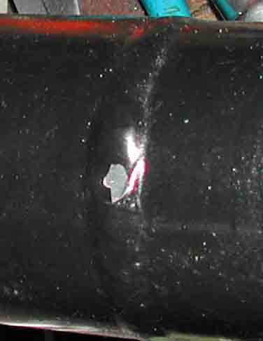

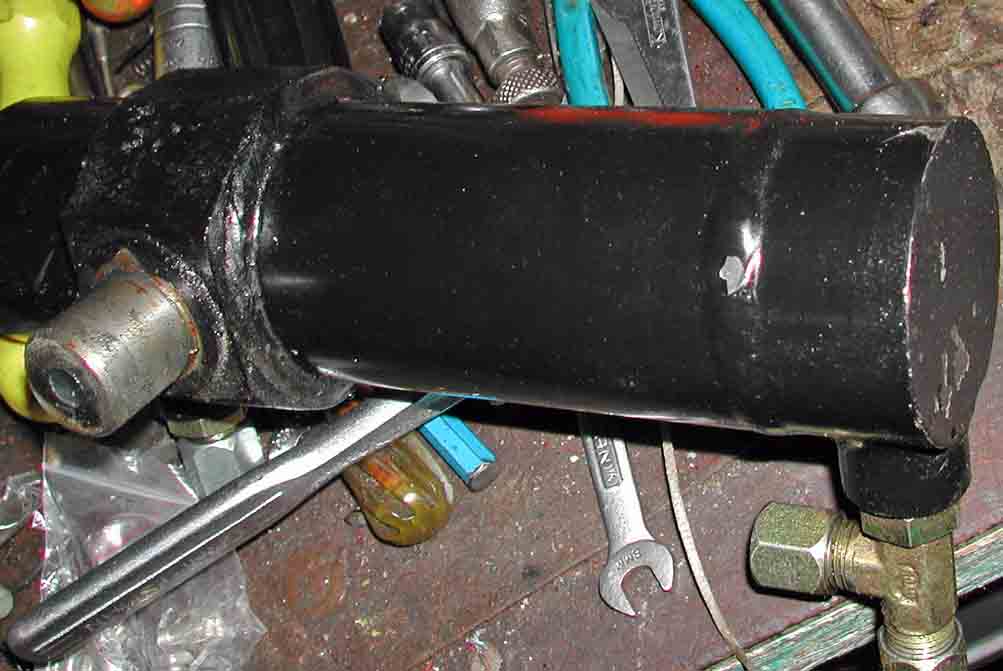

I had to replace 3 zerks that broke, and I tracked down a hydraulic
leak or two. New equipment often has hyd leaks since there are many
hoses and fittings, and not all of them are tight.
I also had a tiny tiny pinhole leak in one of the swing cylinders. I
thought it was a hose leaking, since the location was hard to see,
and it only leaked when swinging one way. Well, here it is. You
can see where it is from the paint that came off. It is so small that
my smallest wire can not go into it. It puts out quite a spray.
To fix it, I removed the cyl, drained the oil, and drilled a divot with
a 1/4" drill bit about 3/16" deep. The divot was aligned with the pinhole
and did not go all the way thru the cyl wall. I then put a bit of acetone
in the divot to dissolve the remaining oil. Oil will cause porosity
in the weld I am going to do to plug the hole. You can also burn out
the hyd oil with a torch, but I did not want to heat the cyl more than
I had to. The weld took a second, and worked great.
The original weld seemed to be done by a machine (perfectly straight),
and the pinhole was right at the start/stop point in the bead.

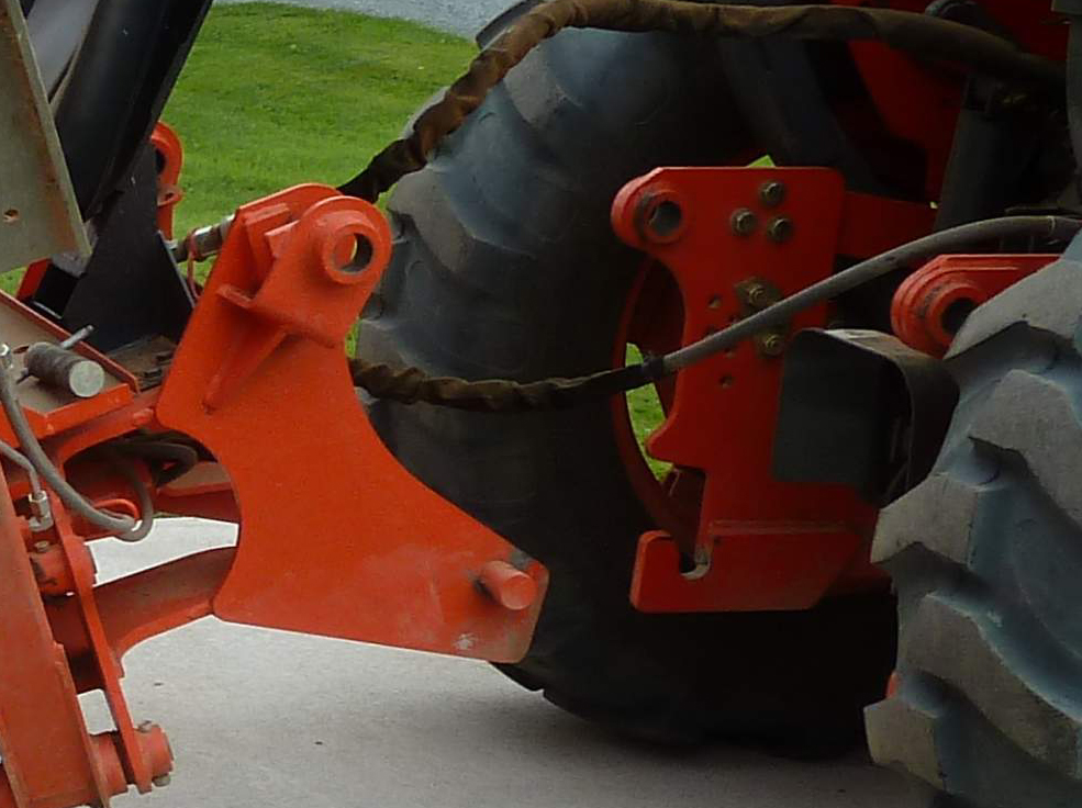

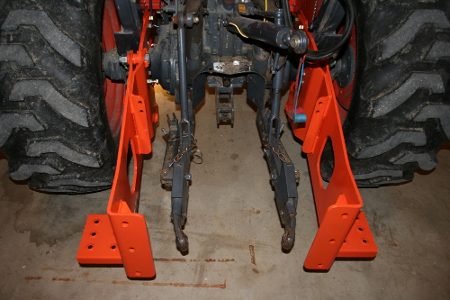

Thanks for another great build Dave. I do have a question about the saddle. I suppose the saddle will take much of the weight and other forces when the backhoe is being used. When I compare your saddle to the saddle on the Kubota or Woods subframes they seem much beefier. Do you think this may be a weak spot after some heavy use of the hoe. I've attached a picture of the saddle on one of Kubota's subframes.
Thx for the support, LURE.

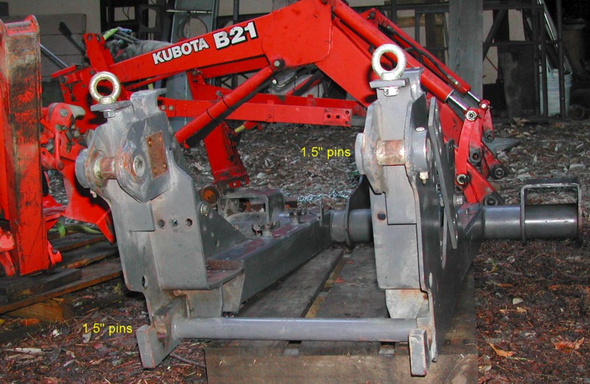

Why do you say the Kubota's saddle is beefier? It's only 3/4" or 1" thick and it's pin is supported
on only one side of the plate it is attached to. My saddle is 2" wide and forces bear on the pin
thru the center of the 1/2" plate. What is your pin diameter?
I know the pins on my B21 4-pt hitch were thicker at 1.5", but they were supported
on both ends in U-shaped weldment, not unlike your upper support. The mainframe was
1" thick where the saddle was, too.
The vertical forces on this subframe are divided among the 4 main connections,
since the toplink pivots. Most of the time the hoe is used, the larger forces on the
saddle and it's pin will be horizontal: rearward when digging, and forward while
lifting. These forces will be compensated (and opposed) by those on the toplink.
I think it will be plenty strong enough. I seems stiffer in use vs. the one on my Kioti.
Sorry I was not clearer.
The back surface of the hoe in photo #1 bolts to the surfaces you see in the
2nd photo. 3 bolts on each side. You can see the holes.

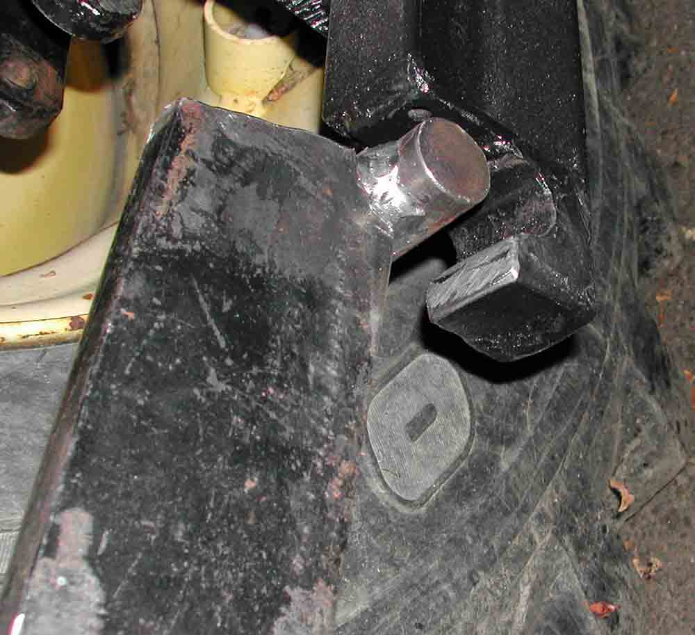

Oh that is not my subframe, BTW. I got that picture off another thread here on TBN when I was planning on building my own backhoe subframe. I now have a Woods subframe on my L3130 which I purchased from another TBN member and I'd have to measure the pin but I would say it's diameter is between 1 and 1-1/2 inches.
Great video! Your subframe is strong and stiff with out any movement at all when you are lifting and placing that rock.
Here is a picture of my woods subframe taken while I was installing it. Notice how long they made the part which stays attached to the backhoe. I think they did that so the 3pth can remain attached to the tractor or for tractors with cabs.
