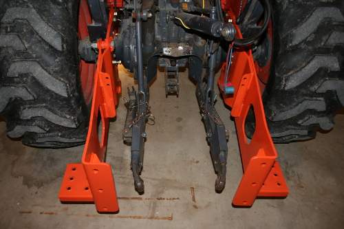

Here is a picture of my woods subframe taken while I was installing it.
Notice how long they made the part which stays attached to the backhoe. I think they did that so the
3pth can remain attached to the tractor or for tractors with cabs.
Indeed the latest Woods 4-point subframes are super-long. I assume they do that to for seat clearance
and so they can accommodate multiple tractors with the same hoe-side design. I have looked
at numerous Woods subframes and some of the hoe-side parts look the same for more
than one type of tractor.
If I had that subframe, my Kioti would not even be able to drive to several places on my property,
places that have dips over swales and my creekbed. Places I drive to often.
