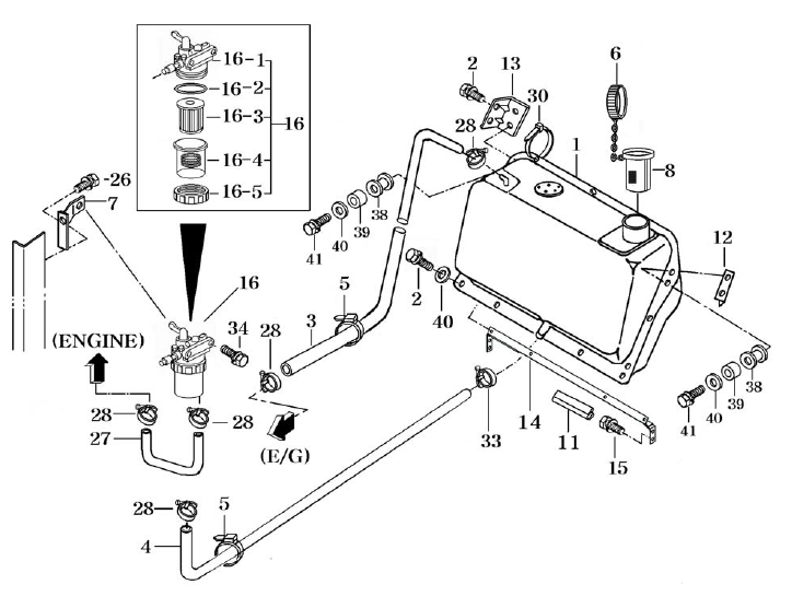

I am looking to drain the water/change the filter on the fuel system on my 2810. I assumer it is probably pretty similar. On the pump, there looks to be some sort of bleeder to drain the air from the lines, but I am not completely sure of that. Can you confirm the process?
Also, I have the tear down manual for the 2004ish 2310 and 2810. IF anyone needs scanned pages or specific data, let me know.
Wow, I'm really late on this! Not sure why I didn't get the email notification...
Anyways...
Mine has a round bleeder knob just above the fuel shutoff solenoid (just behind mid engine on passenger side) that you open (CCW) to bleed air through the system as you crank and run the engine. Once it is running smoothly, close it (CW) and that's it.
I've found it to be helpful to pre-fill the fuel bowl (aka "Cup"), even leaving it a bit loose until fuel starts to run out of the top, then tighten it....all BEFORE any cranking. Might take 10 mins to fill if you don't prefill it?
The manuals I have are 3510-4110.
Here's a pic, group 16.
Interestingly, I just had to look up the cup and give the part number to a local dealer. Mine broke :(
Driving along, stalls. Lug can to add fuel, see it dripping on ground, coming from bowl area. Upon closer inspection, the bowl is about 60% separated from the lip :eek:
I filled the bowl a few times with the bleeder valve open, getting about 20 feet or so each time, until I could get it off the road. Cleaning up after last days' flooding left big ruts in the gravel driveway, gravel on the road.
In case you didn't try it yet, simply unscrew the super-Hercules-tightened ring nut at the top of the plastic bowl (driver's side towards passenger's side direction to loosen), remove and dump the bowl.
Do NOT throw the spring into the snow covered weeds with the water and diesel mix. You'll never see it again. Ask me how I know, LOL.
BTW, that little filter element isn't much of one and will plug and freeze up pretty quickly. Be careful about your fuel.
