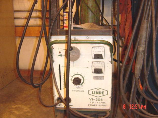

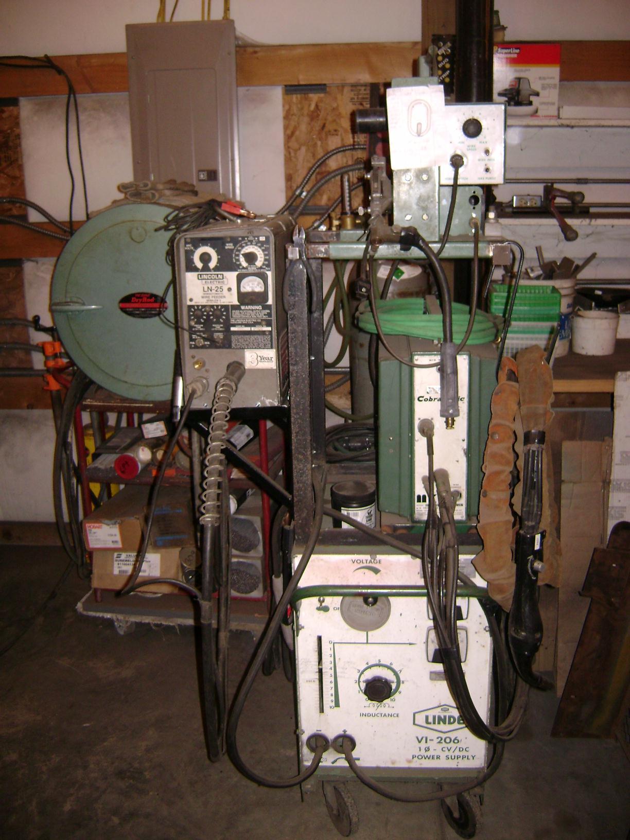

I use to have a Linde VI-206, it had inductance control, now that was slick.:cool: I think on my Lincoln V350-Pro it's called pinch.

Some call it Pinch or Dig..Your 350 pro has it.

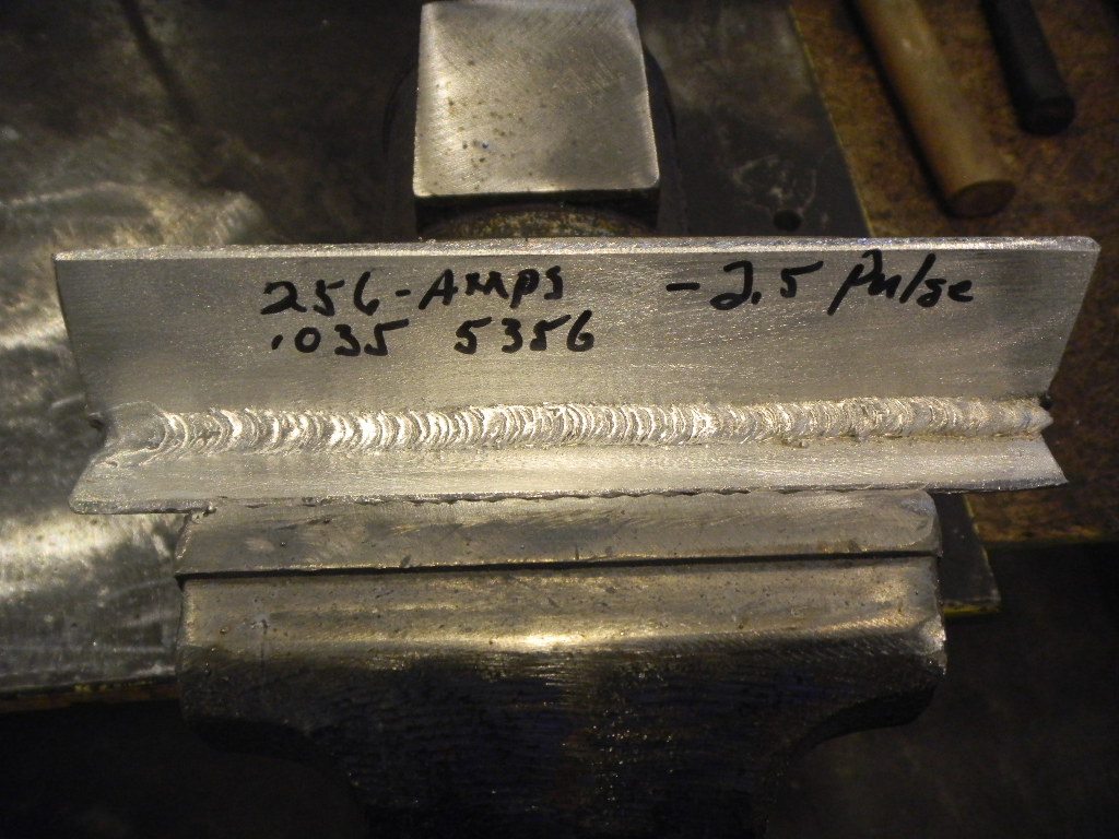

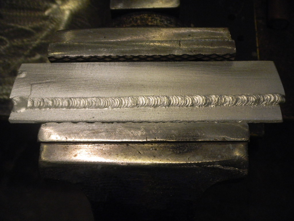

You know I'm not convinced on this pulse either. I haven't played with it a whole lot, and I can see where it's valuable with thin material. I haven't tried it yet with thick material. Now where I thought it was cool was on aluminum with the spool gun, you could get it set where it almost looked like Tig welding, but I was shocked at how many amps it took.
I have the same feelings about spray arc transfer. I could see it in a manufacturing setting where you made the same welds over and over. But even the 3-years I spent in a fab shop, I'm not sure it would be worth all the trouble to set up. Out on a bridge build, no way!:laughing:
