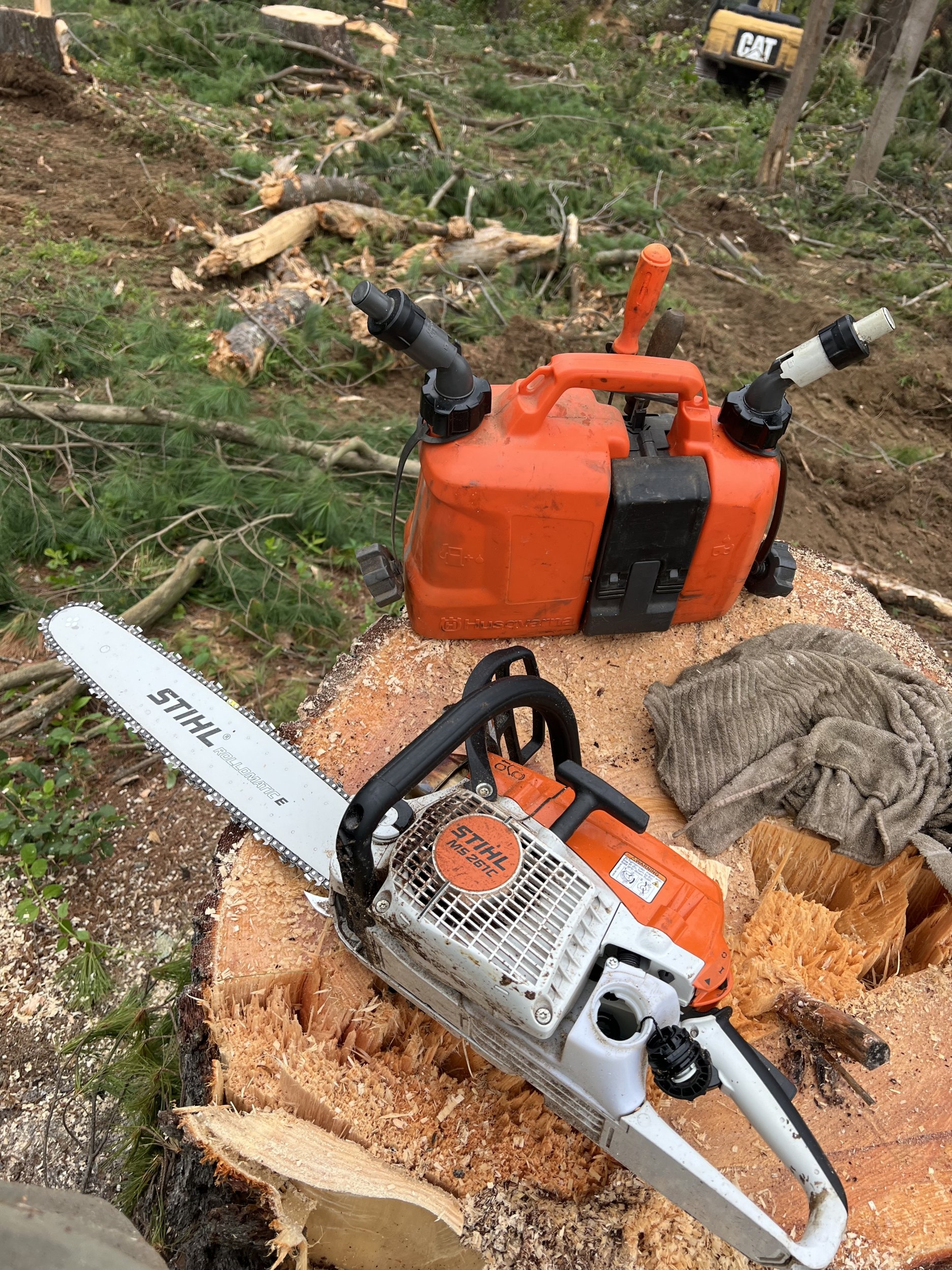

That's a lot to clean up! I collect the brush and downed trees for several neighbors, and burn it off every fall. Nothing like the volume you are dealing with though.
I particularly like the picture of the chainsaw sitting in front of all that WORK!

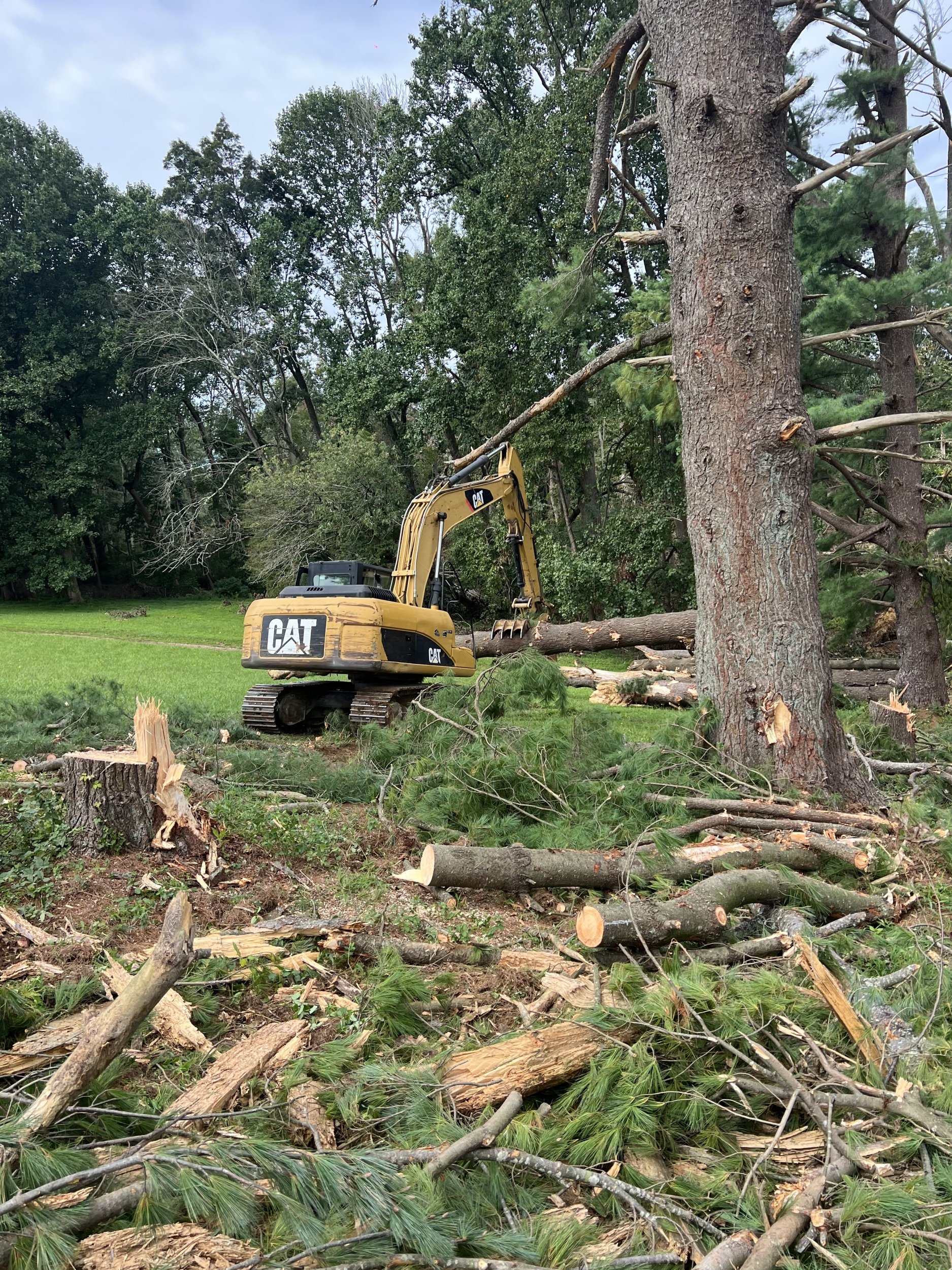

I have seen and worked on several of those types of events. We call them micro-bursts. They will blow down trees in a linear pattern, usually along ridge tops and other higher topography. Sometimes for a mile or so across the ridges, skipping the drainage bottoms. Typically we salvage the sawlogs in a timber sale to have the loggers remove the heavy volume, then pile or windrow the slash to prepare the site for tree planting. A small dozer with a brush rake instead of a blade works well for this purpose. Of course the piles are burned. A tub grinder would also work for slash removal from the site, but it’s expensive unless you have a local market for the residual biomass. The biomass outlet sure makes the economics of removal a lot more feasible. Most of the projects we work on don’t have that market, so burning is the only option.

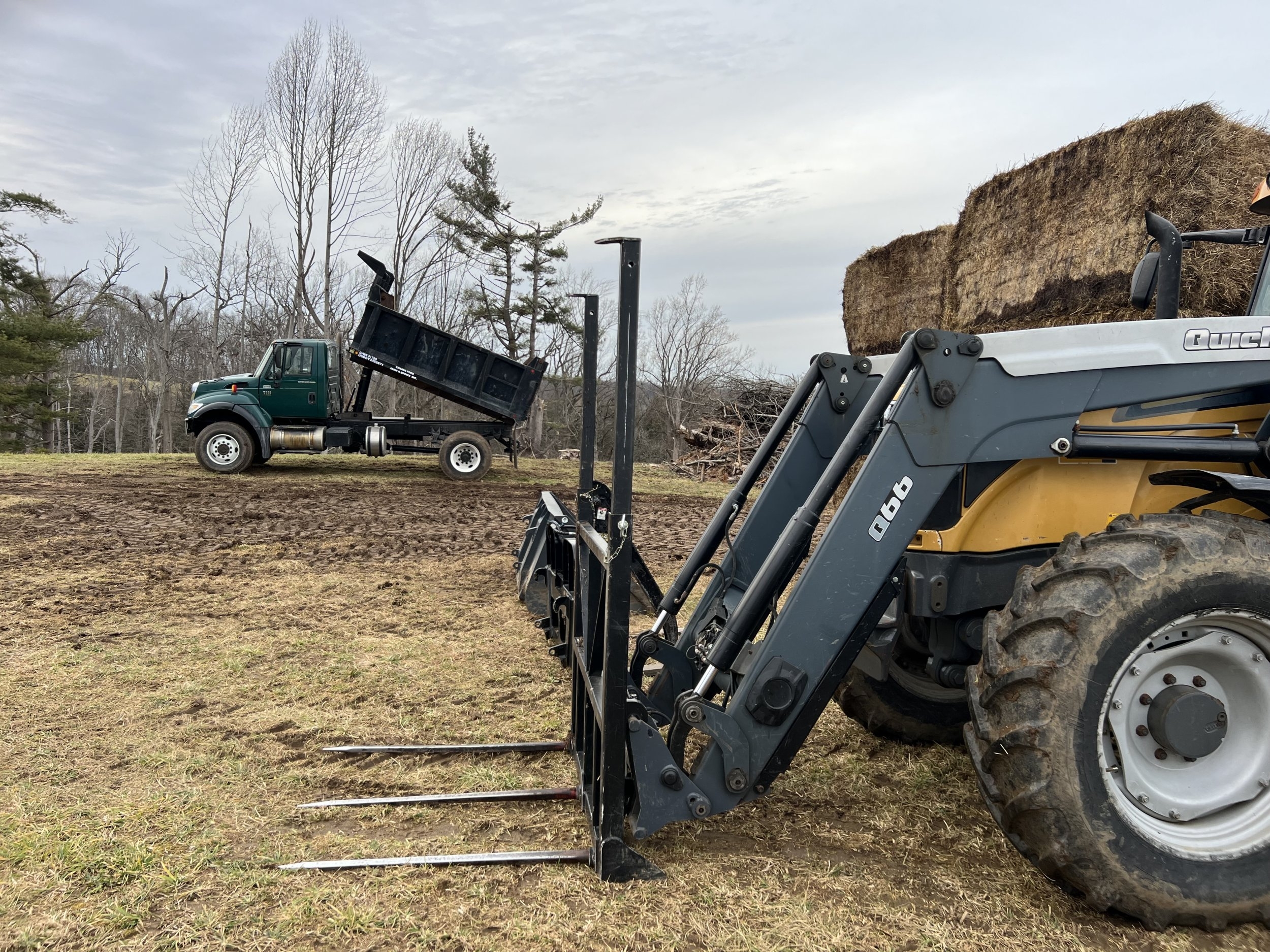

I was able to get this large pile hauled away this week.
This is about 1/2 hauled away.
Loading another of hundreds of logs.​
A few hundred feet ahead, you can see the next pile to be moved. Beyond the lone survivor evergreen is yet another pile.
By the end of the week, I hauled all of just this pile off the Customer’s property. I brought some square bales up in the last day of nice weather. We are supposed to get rain & snow and very low temps in the next 5 days. These bales were way down in the hollow and will be tough to access if we get buried in snow.
The IH-7500 truck performed well, although I do have a drip coming from my transfer case cooler. Tightened it a few times, but it’s still dripping.

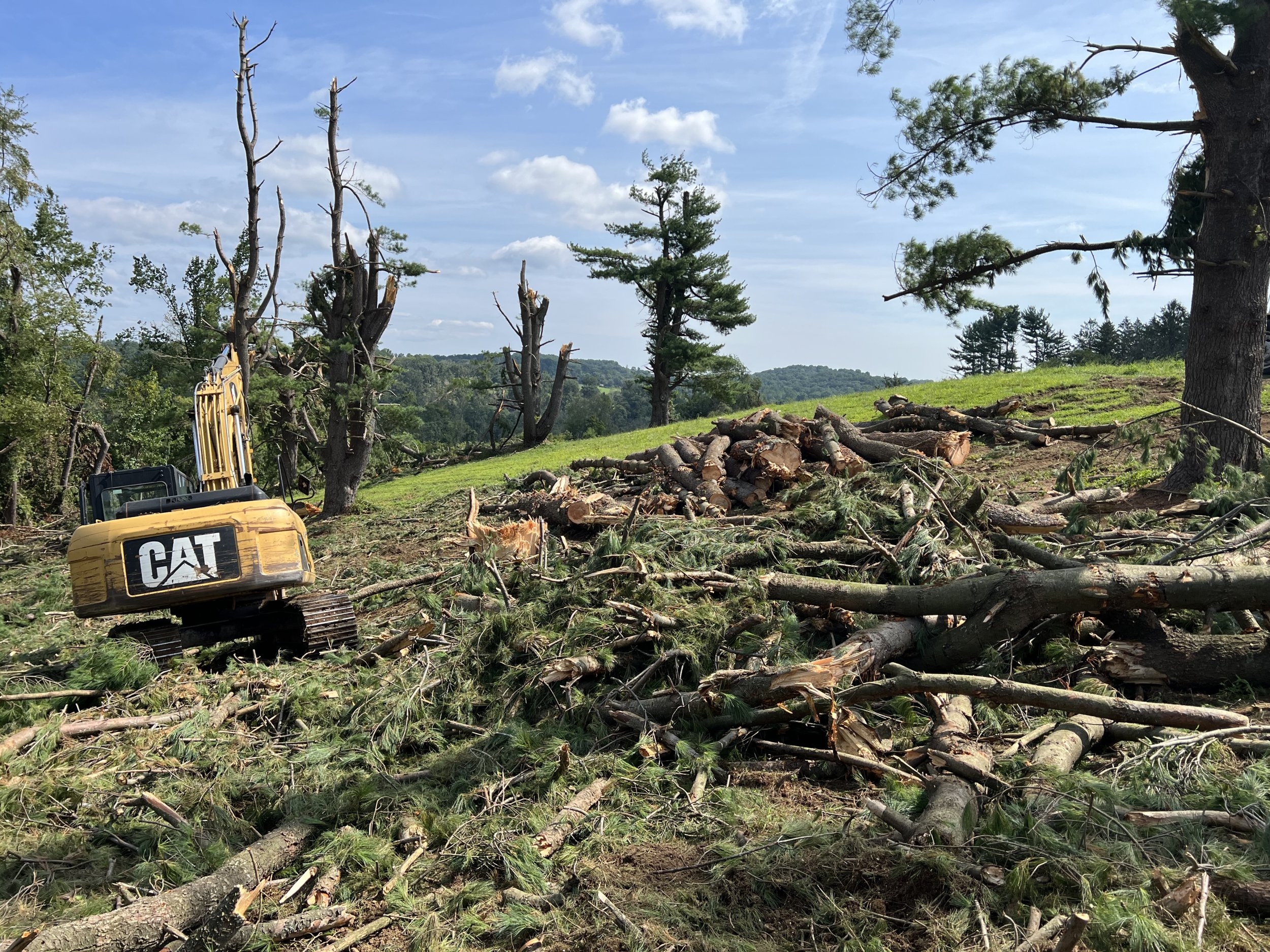

I was offered an alternative to chipping the brush piles that might work.
On the 128 acre property there’s a long “ravine”. It’s probably 1000’ long x 40’ wide x 8’ deep. Its actually an abandoned logging road that cut through the property. Hasn’t been used for many years. New road took its’ place.
The chief groundskeeper told me the owner thinks she would be satisfied if we push/transport all the piles of brush into the old ravine road and just fill it up.
I don’t like it. Feels like it‘s not the best land stewardship, but it’s not my property or money, either.
This ravine already has a lot of fallen & piled brush/large branches along it.
My thoughts were as follows:
1. Rent bulldozer and push aforementioned brush & large branches into ravine.
2. With remaining room left in ravine, transport other brush piles to ravine and push into it with dozer.
I only have a single arm log grapple to move the further away brush piles. Great for logs, but not the best for massive piles of fine, tangled-up brush.
Might need to buy a big brush grapple. Too long on a distance to push with dozer (probably 1/4-1/2 mile distance from ravine).
Need suggestions on “style” of grapple. I’d like something that can open really wide and “bite” into the side of the piles and really get a bunch at once. Gonna look for a used one on FBN.
Below is a sample pile. You can see another one about 1000’ behind it. There’s 5 more bigger than these.
Thoughts on brush grapple type?
