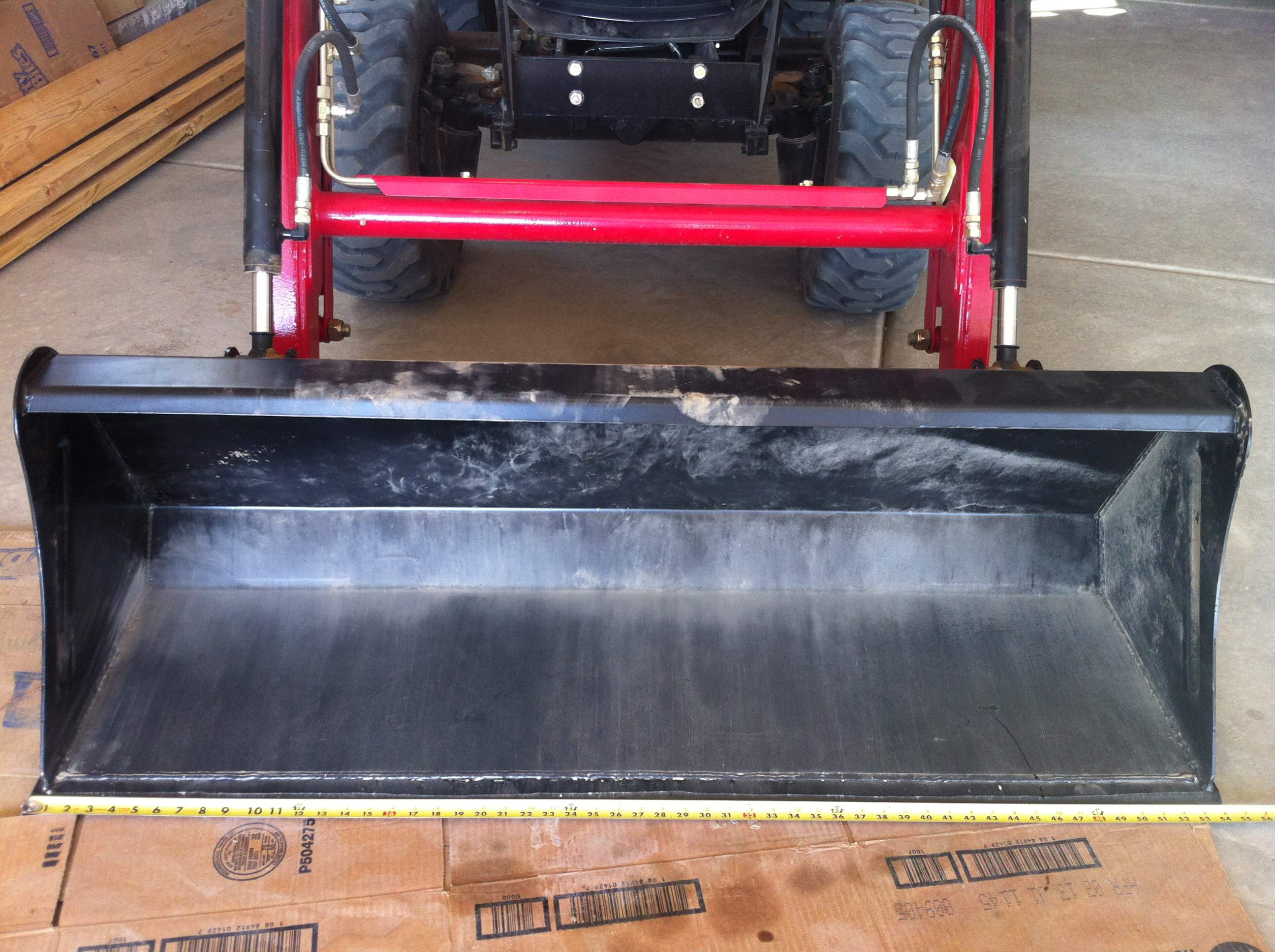

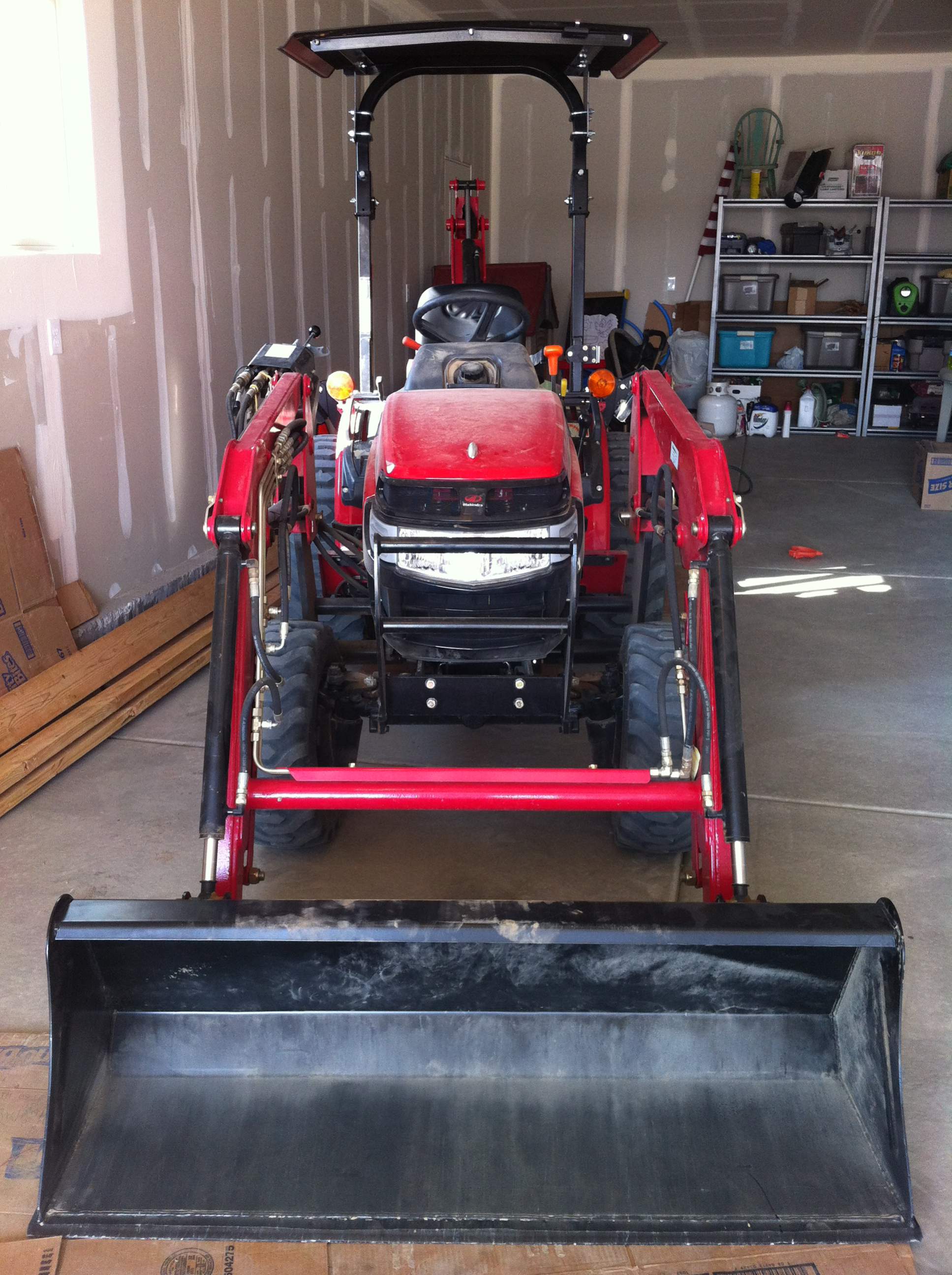

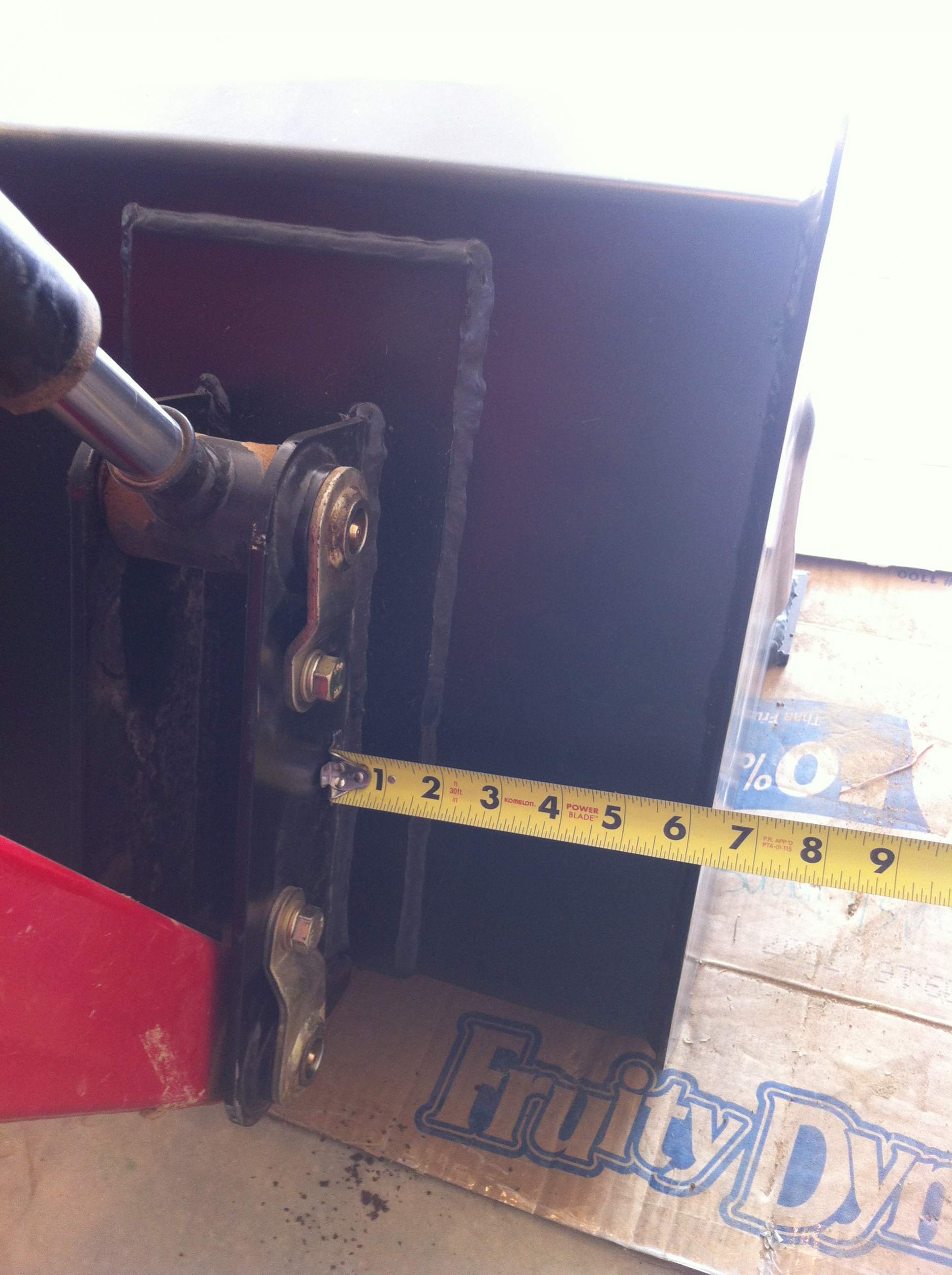

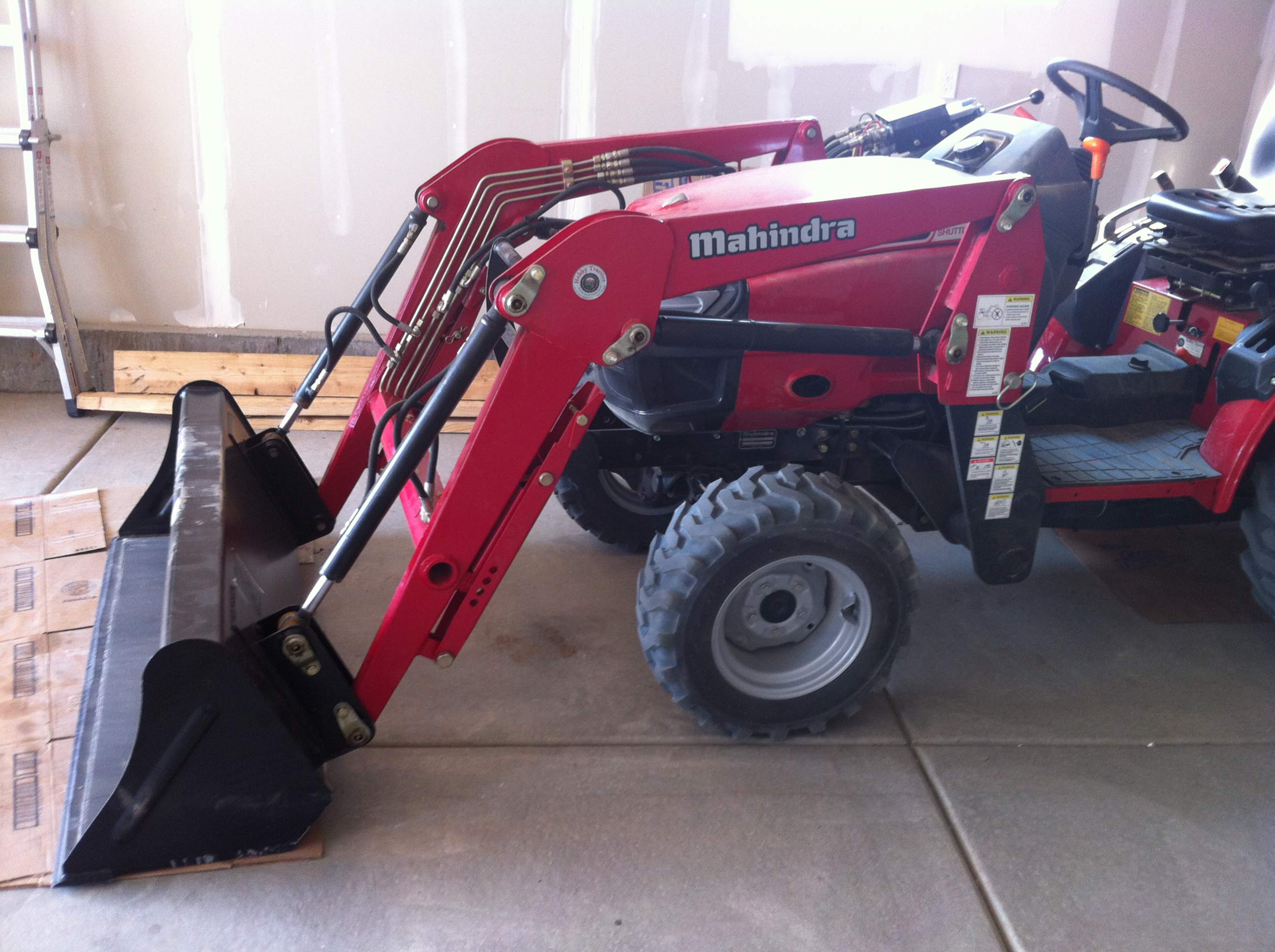

Here are some pictures of the 48" bucket.

Did they say why you got the smaller bucket in the first place.
Because that was the standard size for the first few hundred ML205 loaders. They then changed to 54", but there are still quite a few of the 48" buckets in the system.
So during this time when both bucket sizes are available, dealers sell the 48" buckets until they are gone, and generally swap to a 54" (at the dealers expense by the way) for customers that want the wider bucket. And most want the wider bucket. The Max28 with ag tires is under 48" wide, and so there may be some applications where a 48" bucket makes sense on an ag tire unit.
