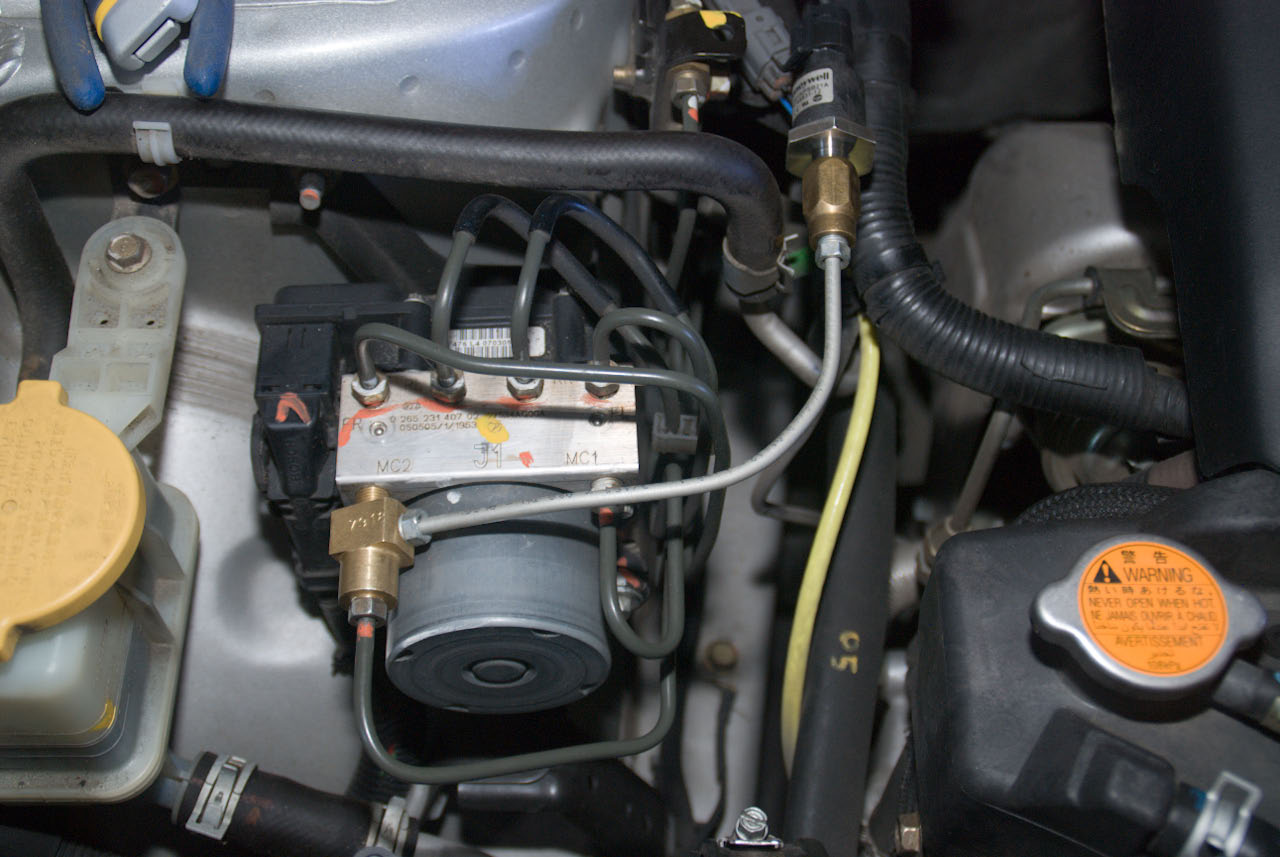

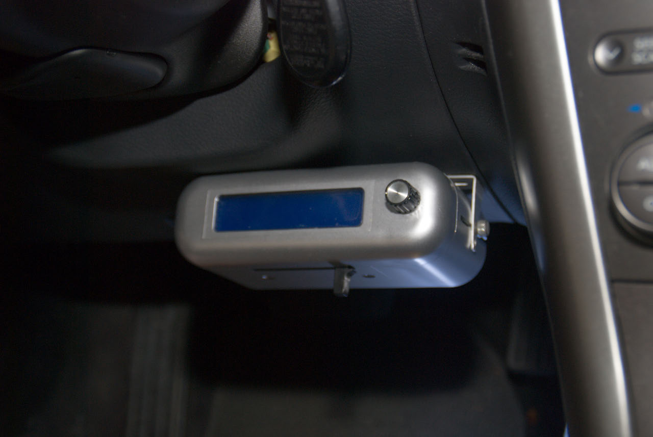

Well I got it installed last month, and it works great. I was unable to install the Tee right next to the master cylinder, but there was plenty of room at the other end of the tubes by the ABS controller. I snaked the sensor wire though the firewall and mounted the controller under the dash.
As far as I can tell, it works great. My only complaint is that the LCD screen is polarized such that it is not readable with my polarized sunglasses on.

Zephrant: Did you have to round off the tee to install the Tee on the ABS unit? Looks like there wasn't enough clearance to turn the it...

I did not have to round off the Tee on the ABS unit- It just barely fit, and snugged up at just the right angle to put the short tube on.
