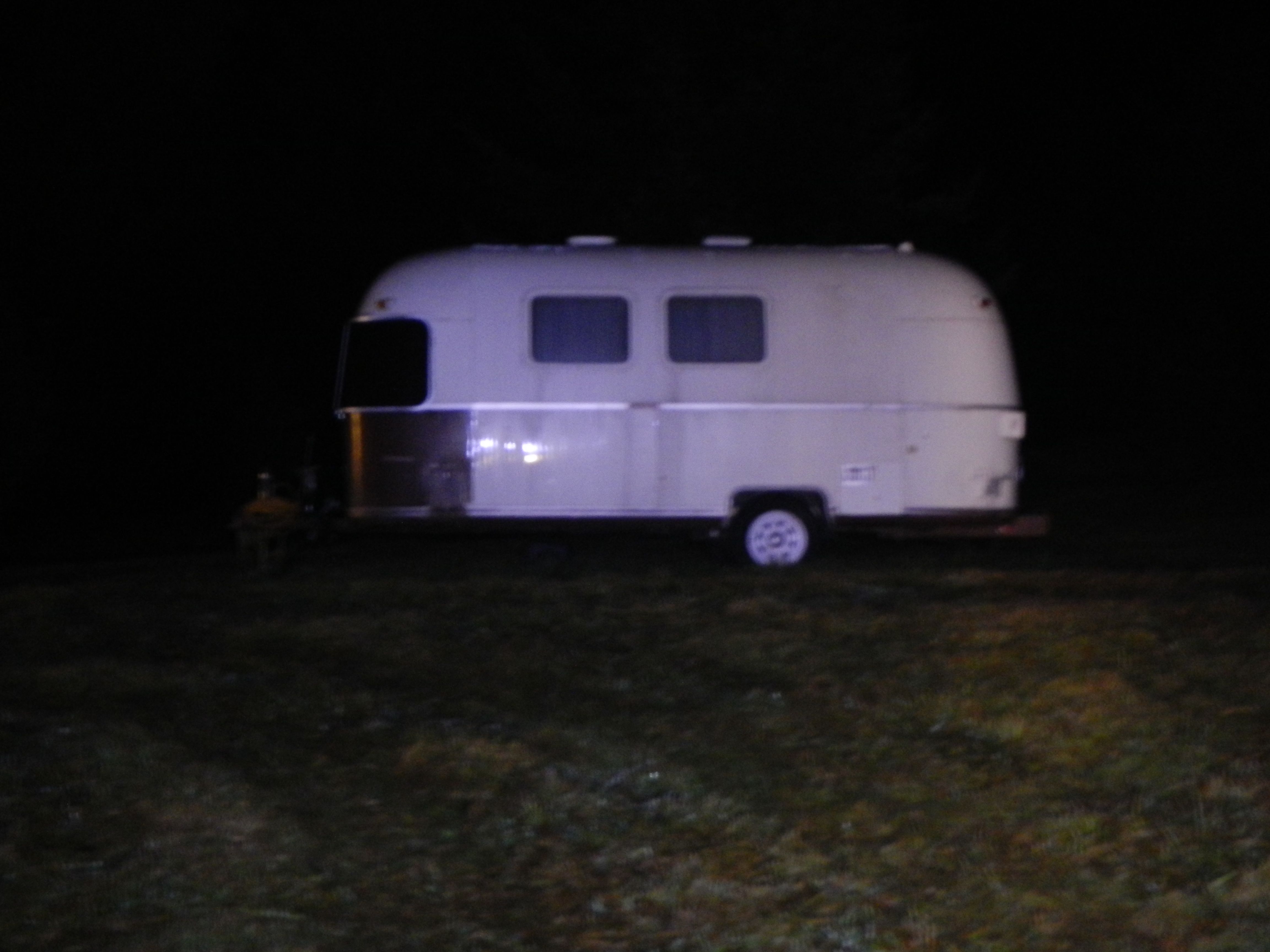

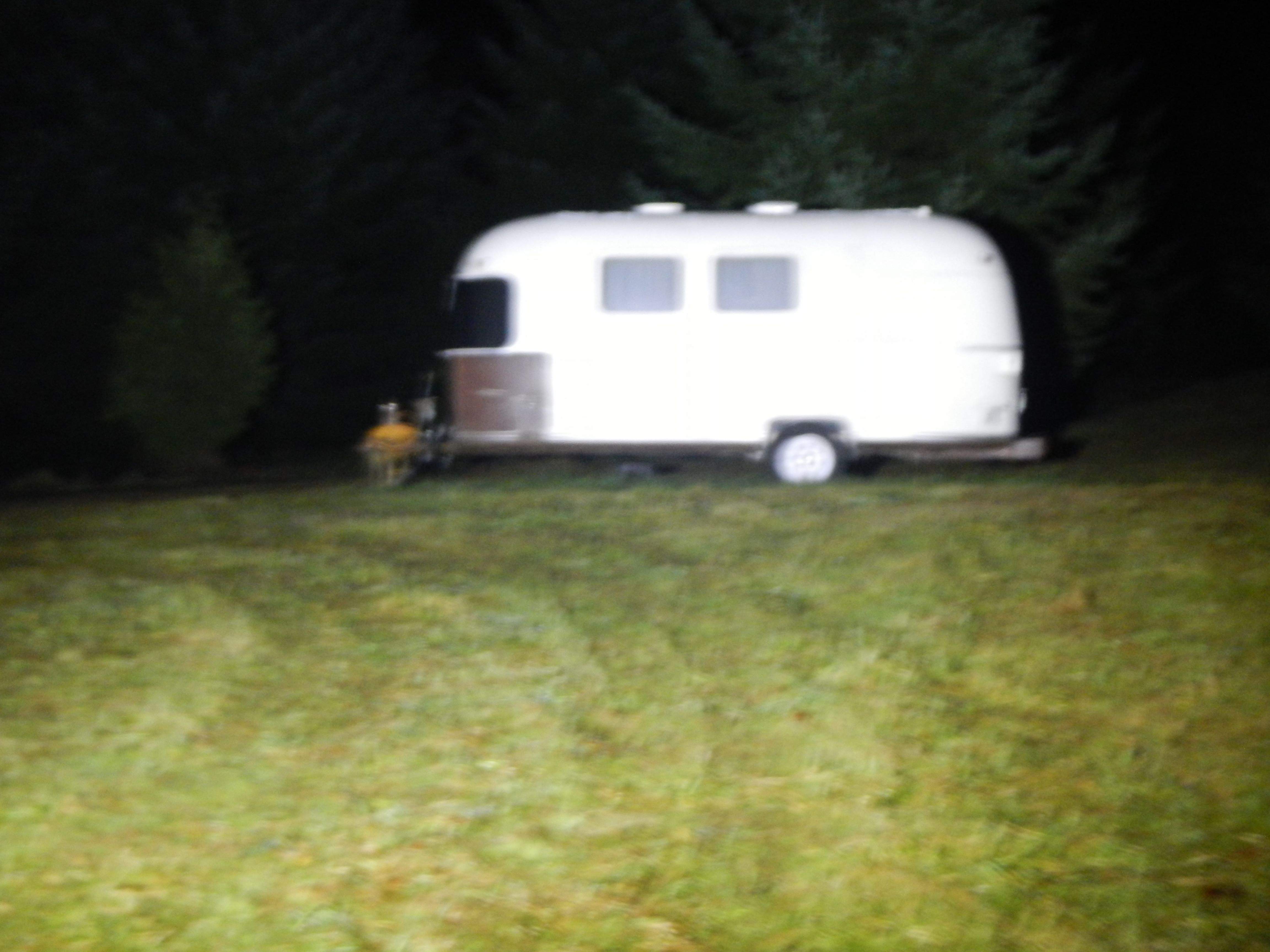

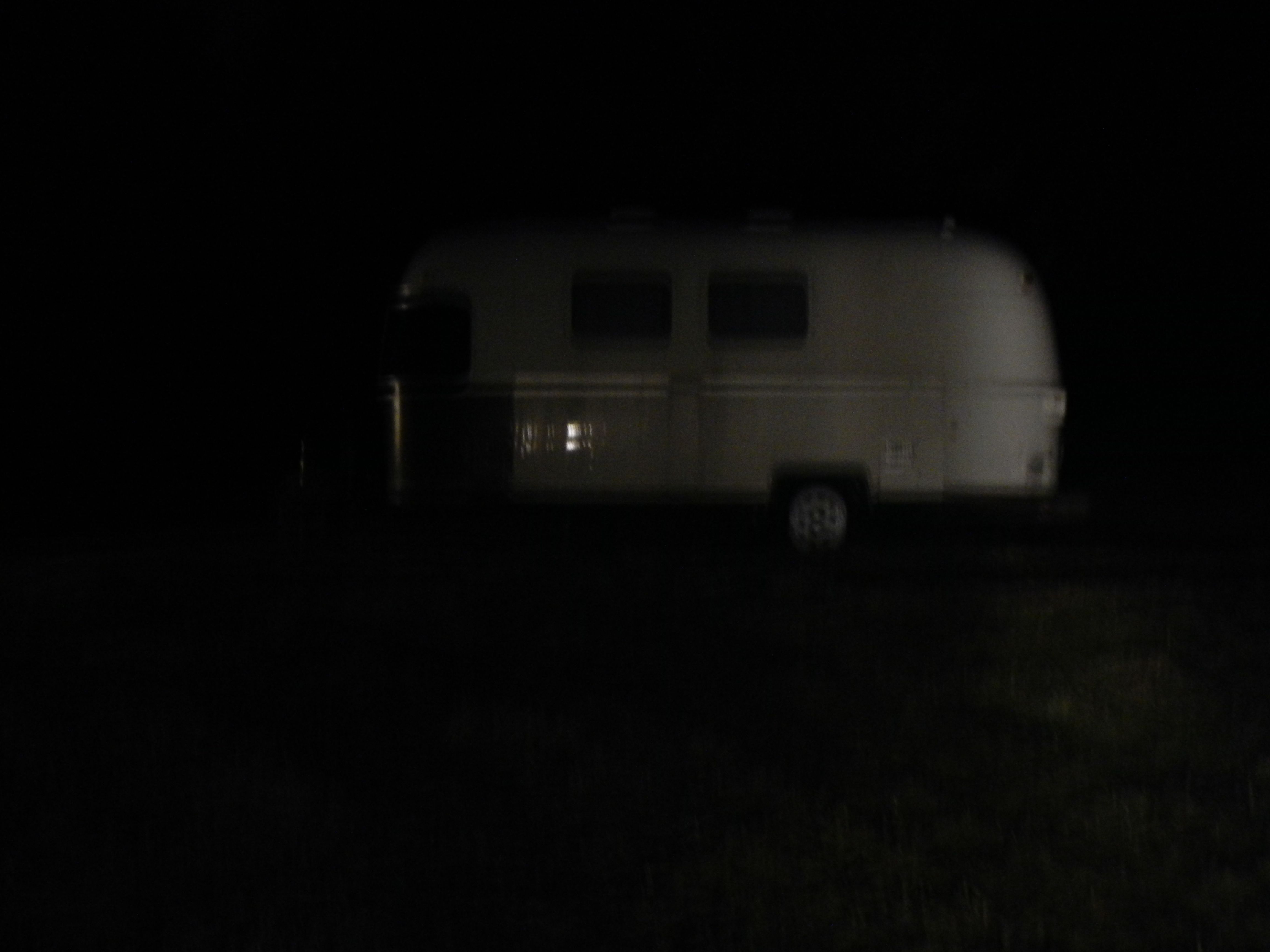

I do not battle snow much, but glare issues exist with brighter lights.
Here is a test I did a while ago. Set my camera to manual, and used only ONE light....
Darkest picture is my stock lamp
Second picture is my 28 watt LED (I think it was 28 it might be 18 but I am not at the farm so)
3rd picture is the 40 watt LED
That's pretty bright! :thumbsup:
