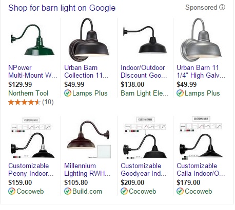

I thought you were writing about "barn light" fixtures such as what shows up if one searches the net using google and the term "barn light".

Newbury: I think they are actually called lamp holders or lamp sockets or something. But everyone around here just calls them barn lights
