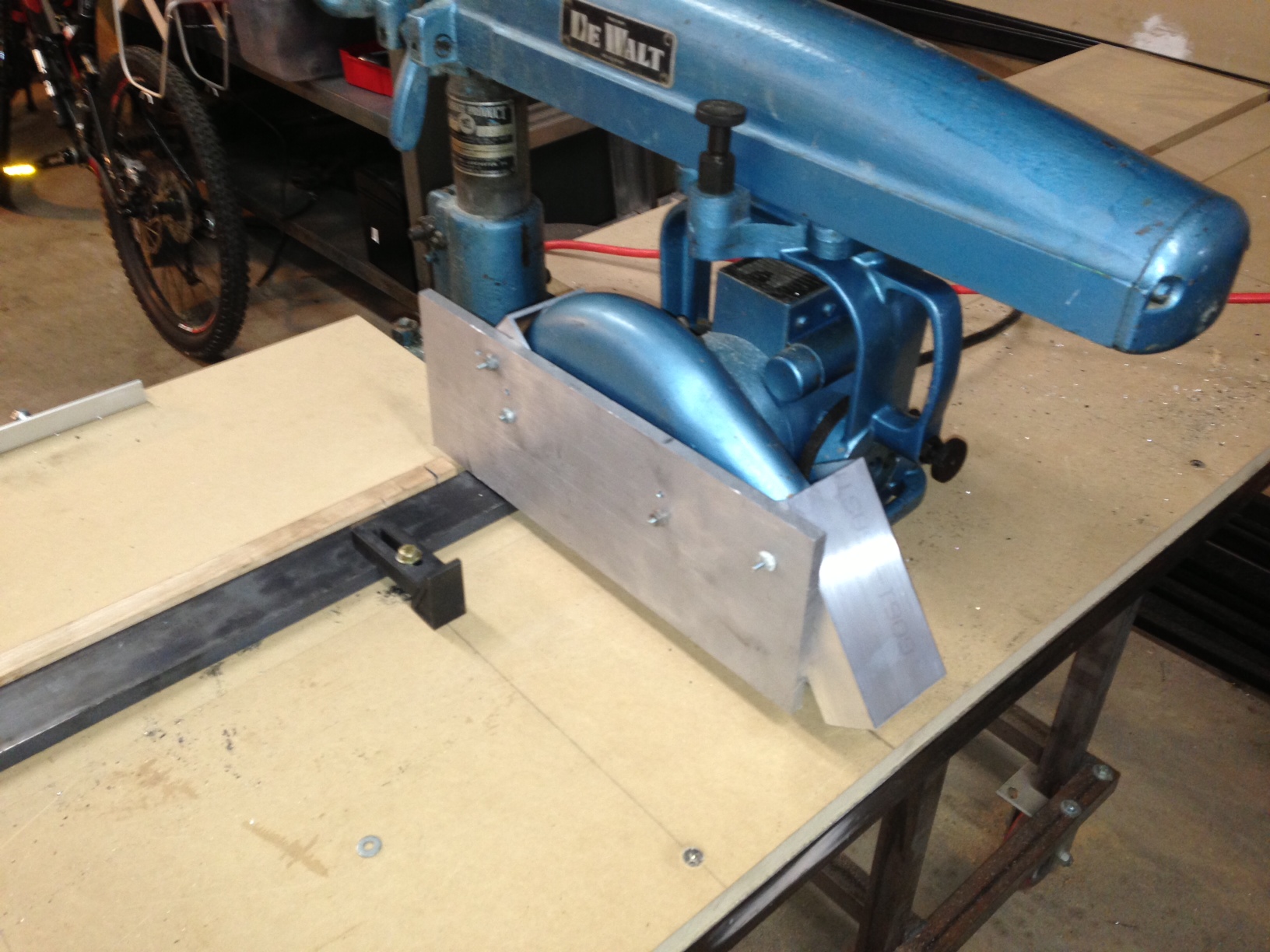

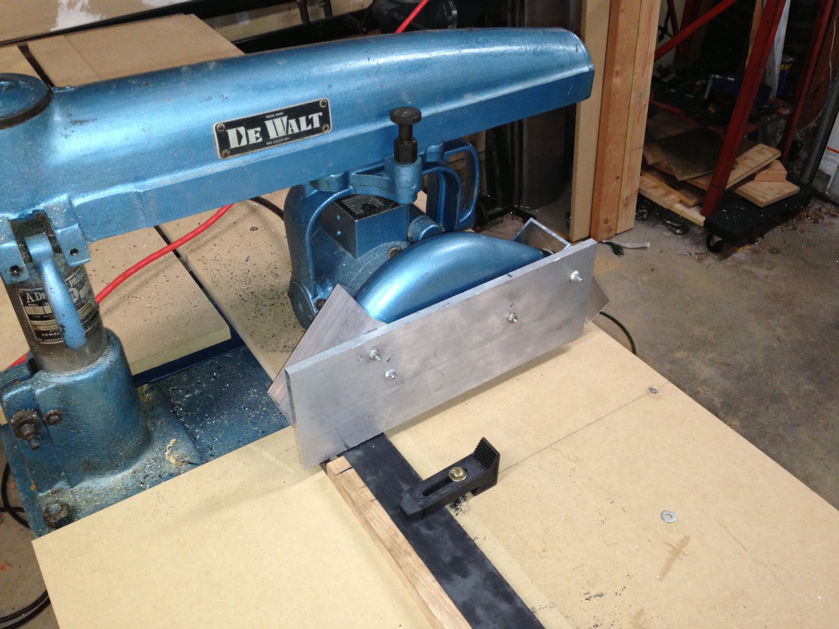

We all know common sense isn't as common as it maybe used to be. Sometimes I think a substantial fraction of the remaining common sense in this country is concentrated in the TBN readership. I really appreciate the considered, experience-based comments, especially for this topic, where I know for sure I am pushing the envelope on my own experience.

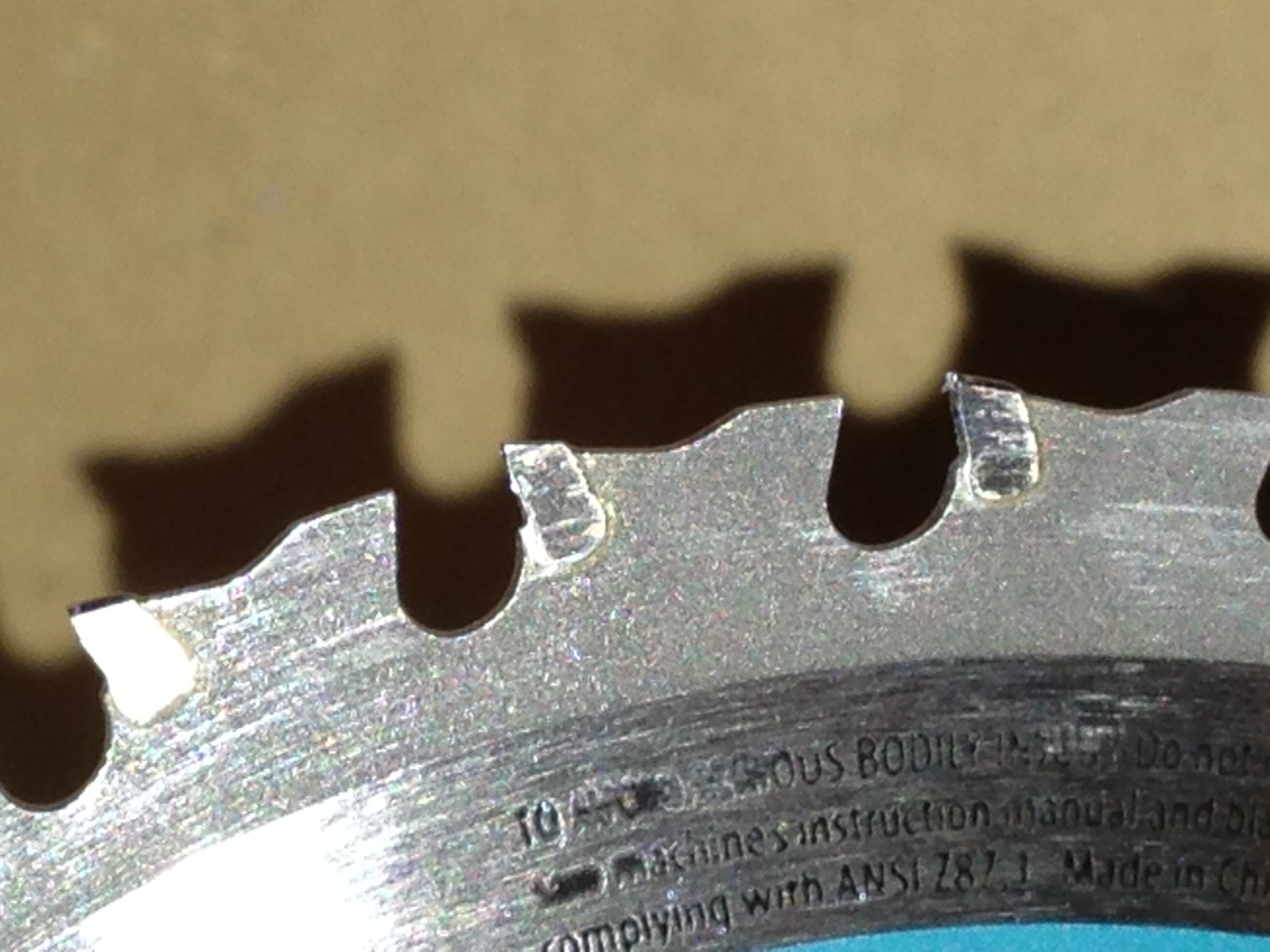

The blade is obviously the main concern. In coming up with this approach I read a fair amount about other metal cutting saws and blades. Here are the main issues that I identified.
RPM. The Makita 5 3/8 blade is rated at 4600. The DeWalt motor turns at 3425.
Tooth speed. This is a function of RPM and blade diameter. Slower is better for thick mild steel. The range for six of the most commonly available metal saws is 4082 feet/minute (Makita 12" chopsaw) to 7745 feet/minute (Milwaukee 8" skilsaw style). Tooth speed in the Makita/DeWalt application is 4817 feet/min, that is toward the slow end of the range.
Tooth Design. See photo below. The Makita blade uses a carbide tooth that is mechanically locked into the metal blade and also has a very restrictive controlled feed design. And has a lot of negative hook. All three features add to safety.
Binding. I never had the Makita cordless bind, even when cutting 2" x 4" aluminum channel. In the DeWalt application the blade is perfectly square and rigid in relation to the table, so vertical binding is not likely. You can see in the earlier photos that I use a fence on the left side of the cut but not the right side. This eliminates the possibility of horizontal binding.
Self-Feeding. This is a big problem with radial arm saws when used according to manufacturer's directions. That is, if you start the cut with the motor head at the column and pull it toward you through the work. Especially if the saw is the least bit out of adjustment. The blade will try to climb onto the material and jump toward you. This is very demoralizing. After one or two such episodes (30 years ago now), I stopped using the radial arm saw that way. Pushing through wood in the normal (skilsaw) way is much easier and safer. I am sure that goes double for metal.
Heat Buildup. I never experienced this with the Makita cordless including 6" cuts in 1/2" mild steel and 12" cuts in 3/4" aluminum. For intermittent use I don't expect it to be a problem on the radial arm saw.
Specifically on cutting thick stock. The Makita literature, like everything these days, has about 4 pages of "do not" guidance. Apart from specifiying the maximum depth of cut (2"), there is no other reference to material thickness. Clearly it is intended for tubing, light channel, metal roofing, etc. But as others have noted, folks have been using metal blades in skilsaws for thick stock for a number of years.
All things considered, I feel reasonably sure this application is safe for the purposes I intend. Especially with a heavy duty shroud if things go wrong. Will provide an update after the first project, which is cutting out the components of a mechanical thumb for the B21.

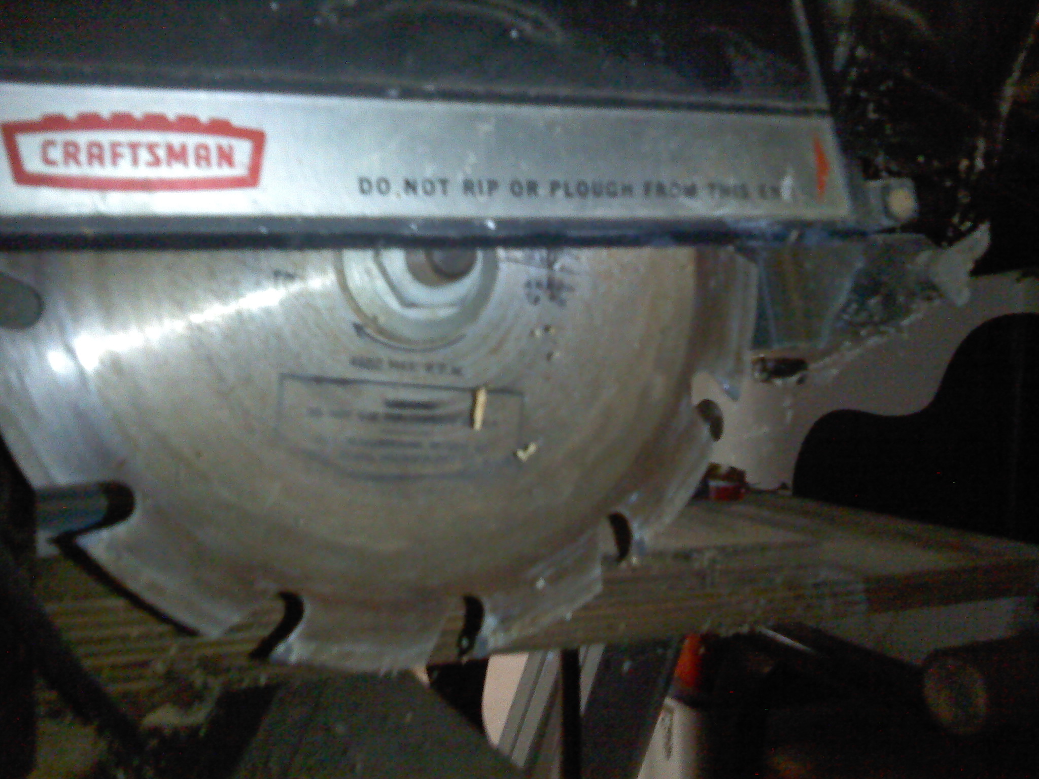

JJ, you cant compare a chopsaw, table saw, or skill saw to a radial arm saw. I dug into the storage to get to my radial armsaw to take this pic. 1229131459.jpg I dont know if you can read it in the pic because of the glare, but it says Do Not rip or plunge from this end. I trust the manufactor on this and have seen the results of ignoreing this advise. Yes the blade is turning in the same direction as it would with a chop saw, cutting from top down, as it appears in this pic, but you actually cut fom the back side of the blade so it is cutting from bottom up. The reason you dont pull a radial saw thru the material is because the saw is running on a rail, back to front and if a saw tooth graps hold on the wood, it will launch the saw toward the operator pretty violently. A chop saw blade is fixed to the motor so it can only be raised up and down, a table saw blade is fixed, but a saw sticking can throw the wood back toward the operator, but not the blade. Nether of those type of saws has the ability to launch the actual saw at the operator, unless something breaks. Pulling a radial arm saw thru the wood is the number one reason people get hurt with this type of saw.

Mud stopper, I tried to say it, but you did a much better job. Thanks. If anyone is reading this, please listen to us and heed our warnings. I like a radial arm saw, but the thing can kill you. Be careful and we can all talk together next year.

I read the articles, but it does make things more confuseing. In the pic I posted, off and actual radial arm saw, it plainly says to not cut from one end. On this saw, that end as the saw is in the pic, would be pulling the saw thru the wood. So that means what exactly. Further reading also the point was made that pulling the saw thru the wood could cause the saw to climb out of the wood and more or less, launch like I said toward the operator. Then it went on to say to properly use, you should pull the saw thru the wood, but keep a slight push to hold the saw back. I suppose the push to hold the saw back is intended to keep the saw from climbing and launching, I dont know. What I do know for a fact cause I have done it, pulling the saw thru the wood to make a cut can cause the saw blade to launch dangerously toward the operator. With that said, I also read about the proper type of blade to use on a radial saw would be one with a negative rake. Since I bought my saw used, I dont know what kind of rake the blade has and that could very well be what caused my saw to act like it did. Acting like it did, launching the saw toward me is the very reason I have it stuffed in the back of the shop not being used. I still think it is one of the most dangerous saws I have ever used.
