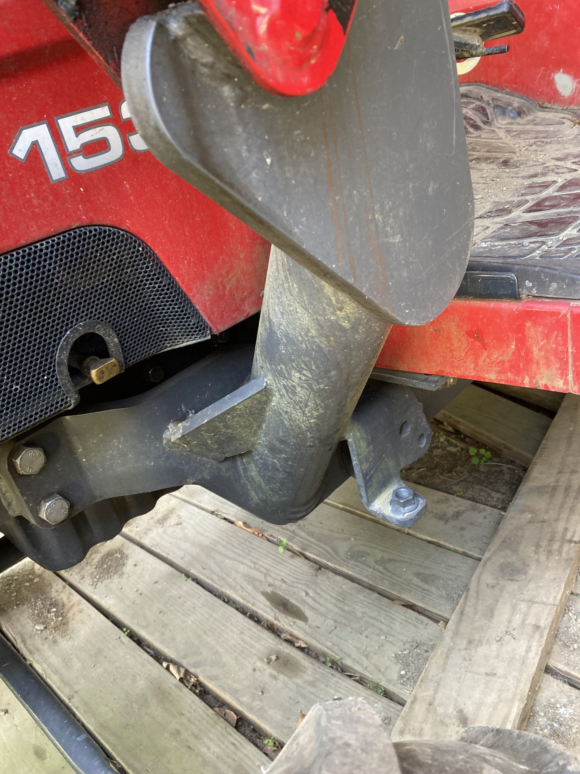

That’s a couple really bad breaks. I have MF1533 with a 120 FEL and my mounts look a lot more structural stronger than yours. The only problem I’ve had is broken and loose bolts that attach the loader mount to the tractor frame. I’m definitely going to add looking for cracks to my maintenance list.

First off, he should have been inspecting regularly and caught it when it started cracking.
   / MF 1835M loader support collapsed on tractor #93
Looks like bad design, with not enough support for the load. If you repair it, I would weld a plate behind
it to increase support.

Was moving dirt today when all of the sudden my loader started going down all by itself. This was crazy looking. You can see in the photos that the loader sub frame View attachment 802798 gave way on both sides. It appears to be either bad welds or cheap metal. Either way, it’s nuts that it would do this with only 140 hours on it.
It least it failed slowly and not catastrophically.

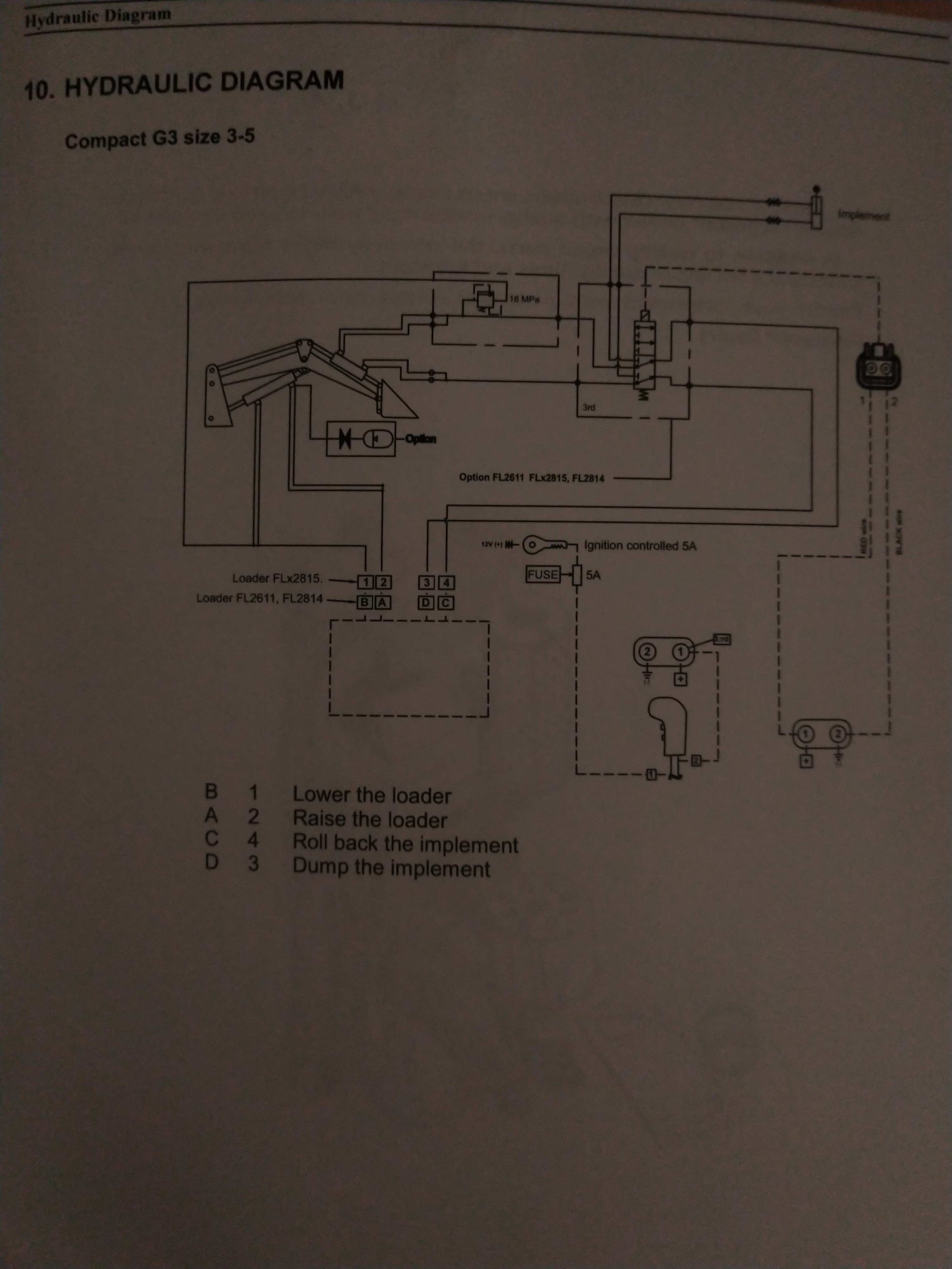

Maybe I'm misunderstanding the hydraulic diagram, but is that not a 2610psi pressure relief valve in the top middle? If I'm wrong, then I do apologize for the misinformation.

Interesting. Do you happen to have a diagram how this works? I always thought when the spool is centered it closes all other ports off so no way for the relief to work.
The valve banks have reliefs built in often for each circuit so one function doesn’t overload another. Most noticeable in a backhoe. Perhaps some budget machines don’t employ a system like that.

Looks to have been cracked for a little bit too.. then finally gave way while you were working.
Agree. Looks like the corner wasn't welded at all and the crack probably started there.
