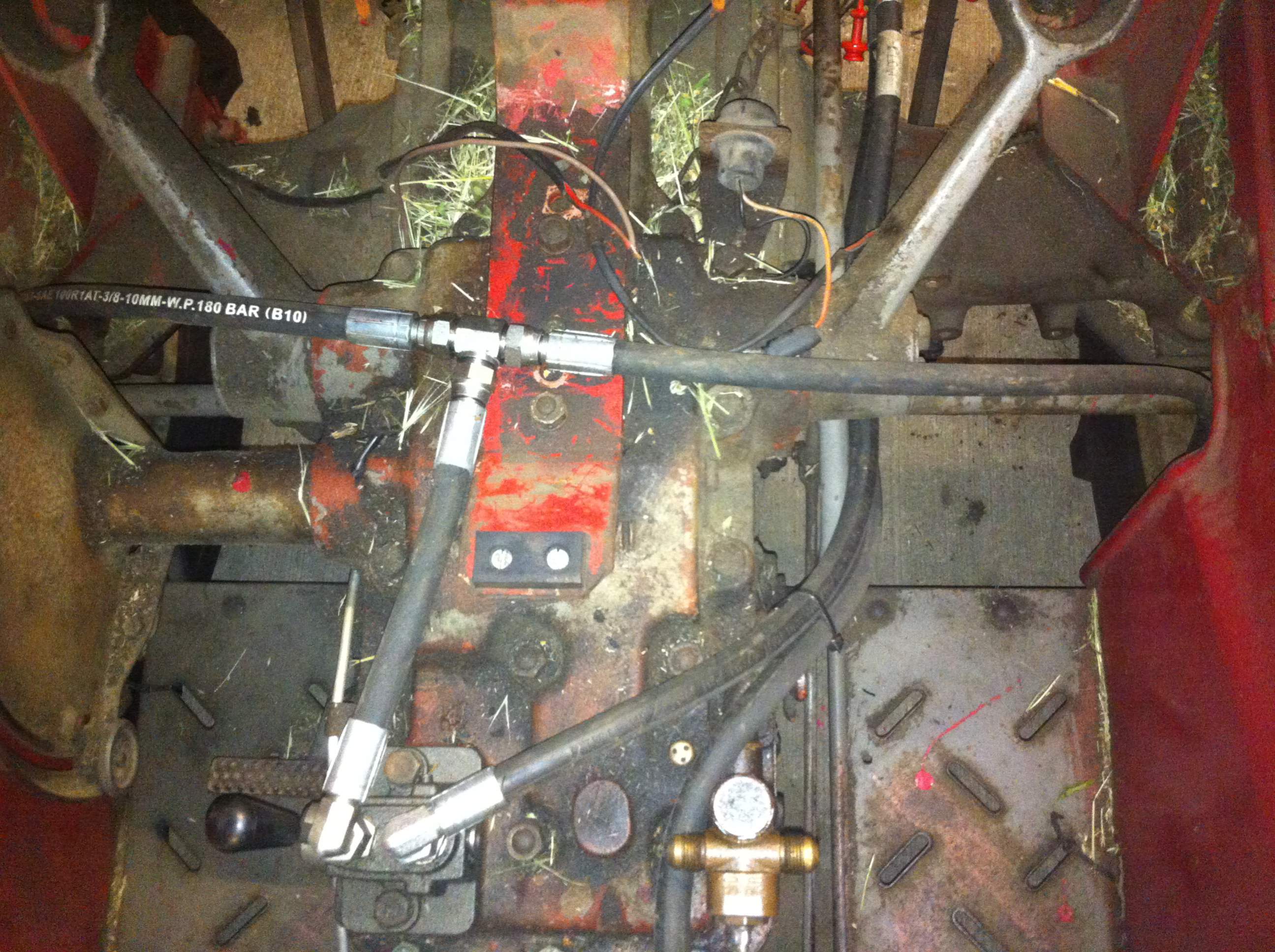

Can some kind owner with an older MF, ideally a 35 (but a 100 series would probably do), with a front loader on, please let me have some details of the hydraulic hose routing from the diverter valve to the loader cylinders?
Its the last part of my rebuild, and I cannot see how to route these hoses nicely, especially on the RHS past the exhaust pipe.
A few photos would be ideal of course :)
Many thanks in advance,
Jim

Sorry, but I cant find the pictures here but I can describe to you what I did if that will suffice. Its not very complex after all.
If you're not in too much of a hurry I can get the pictures and make some measurements for you next time I'm back home, but that wont be till beginning of October.

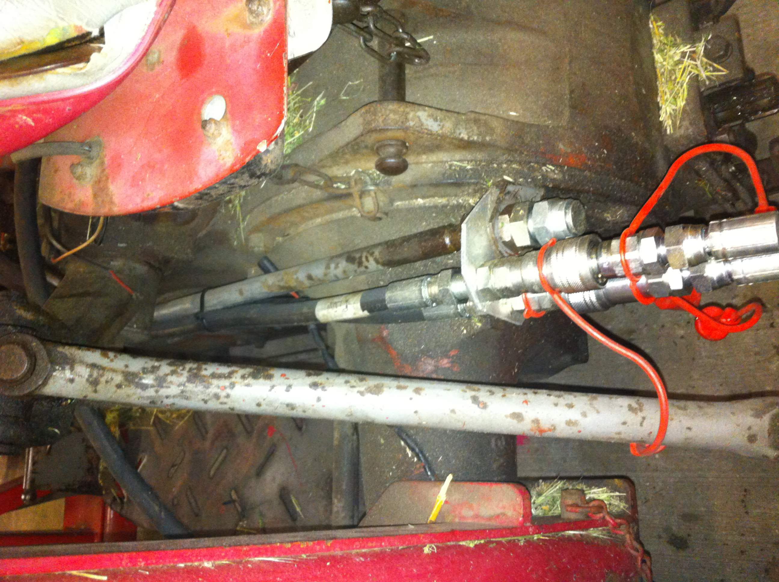

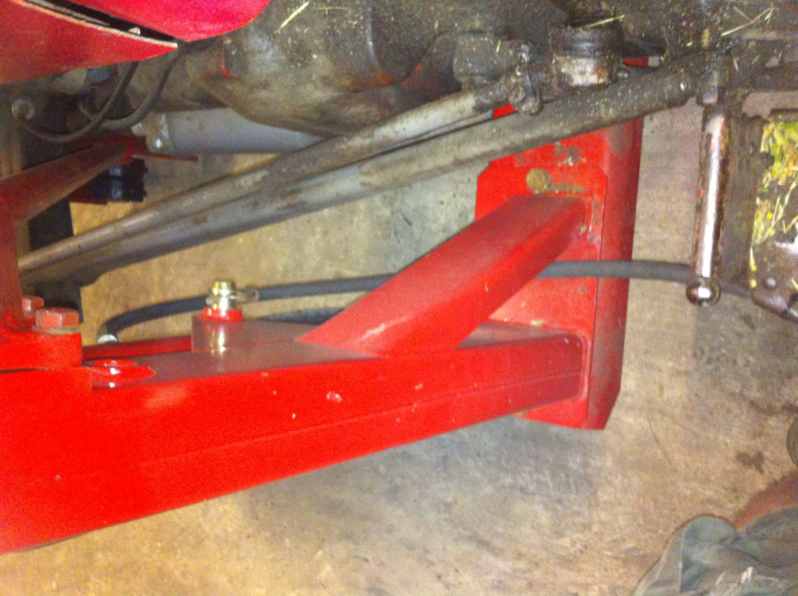

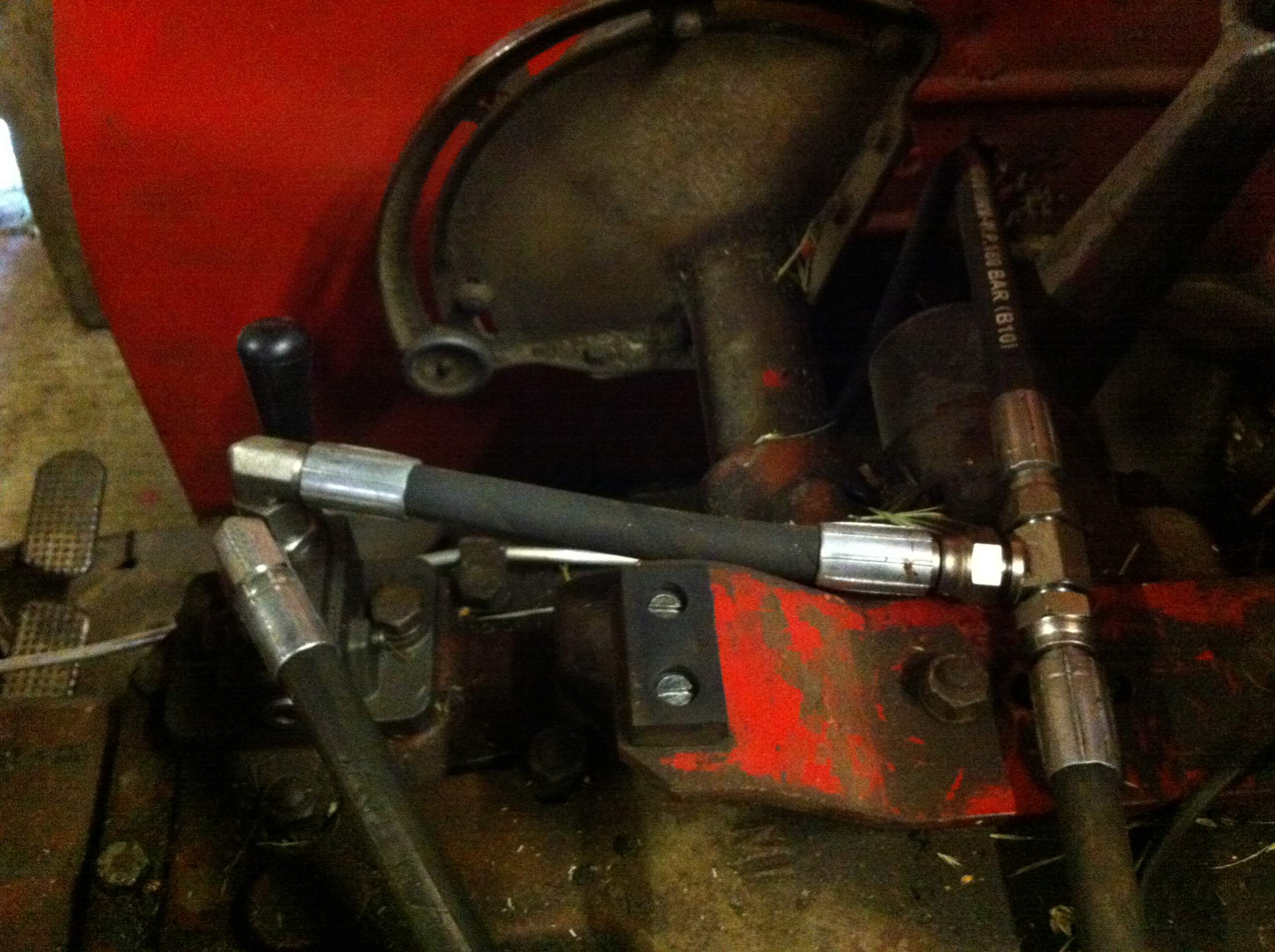

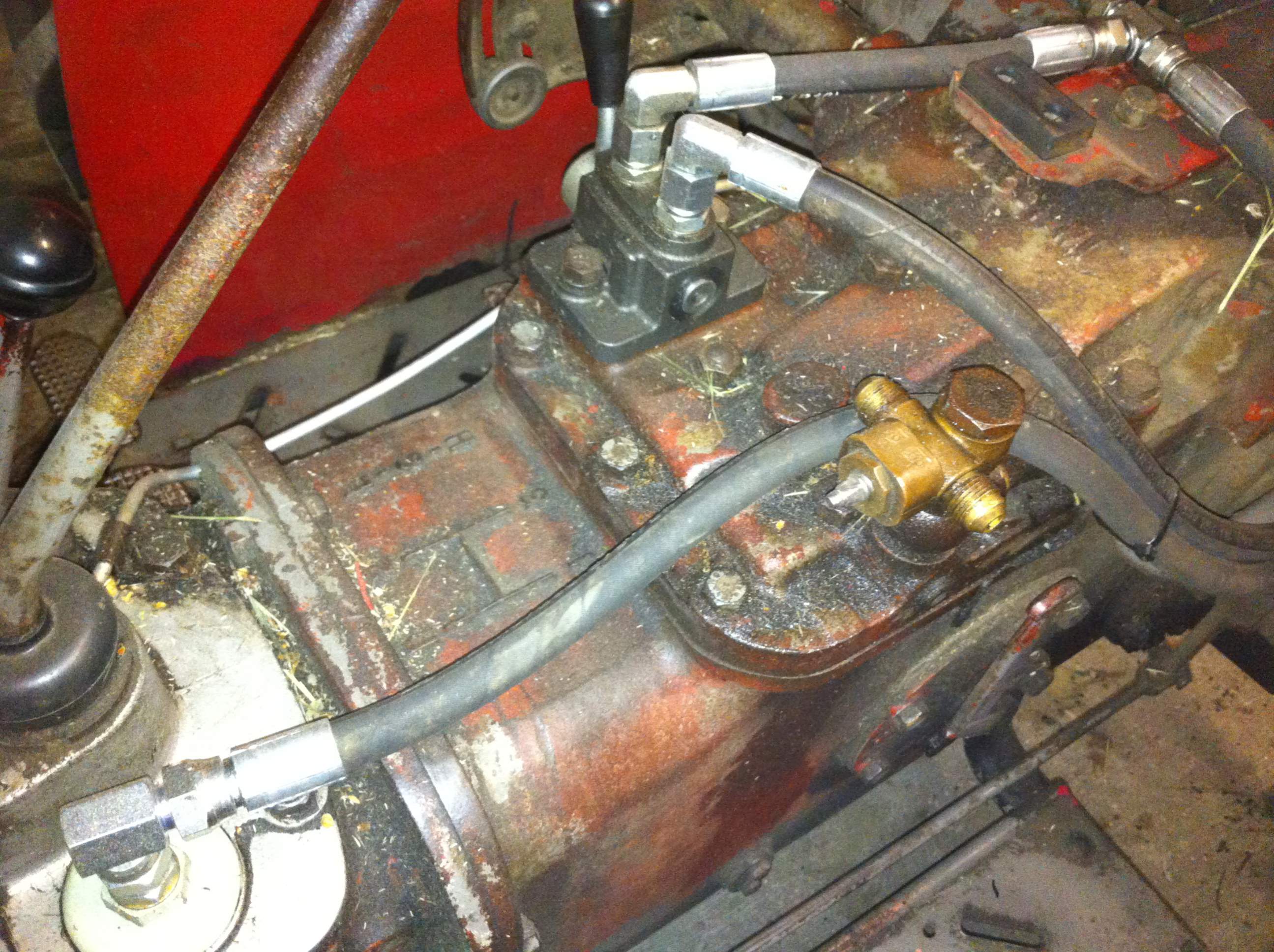

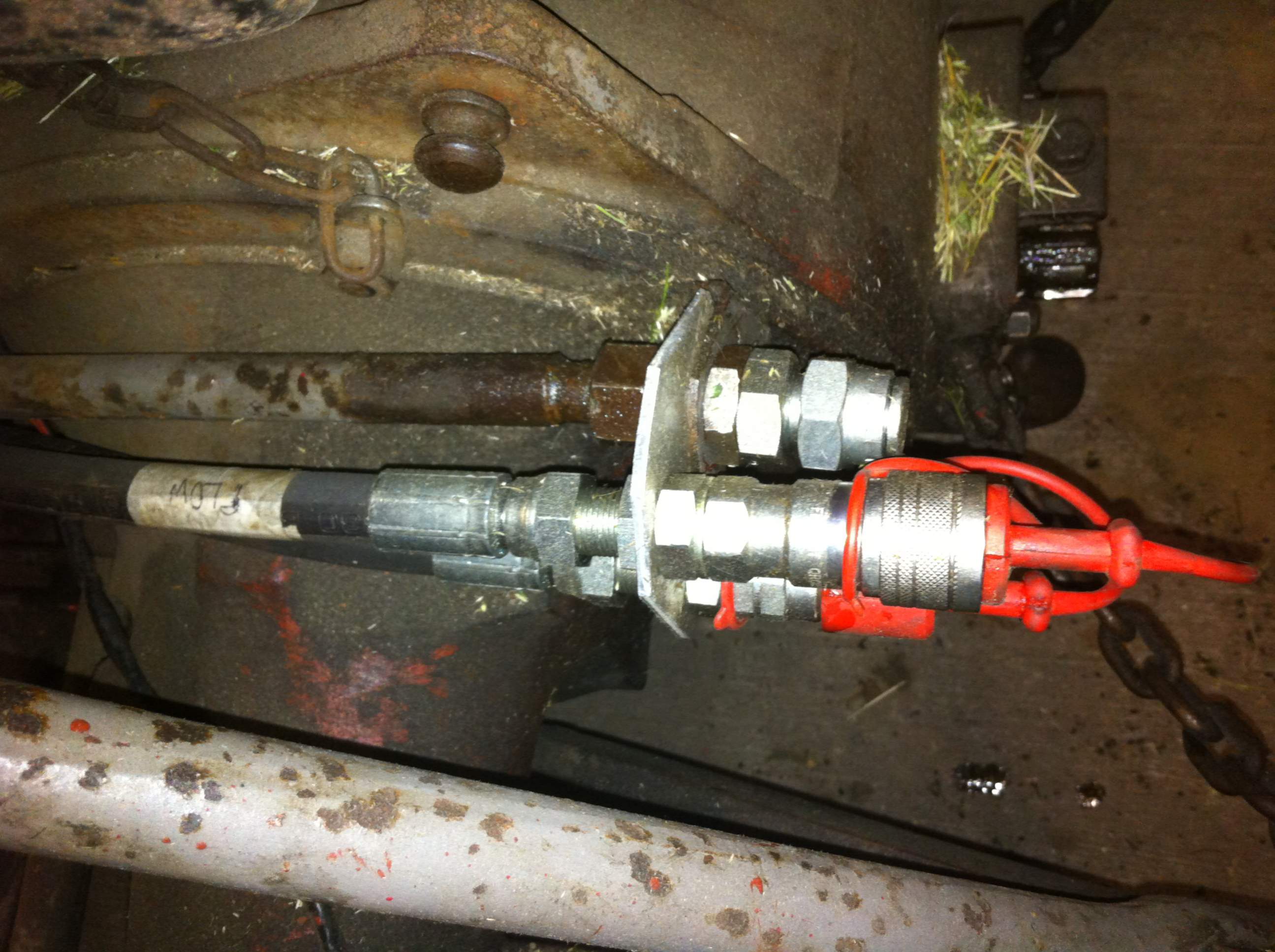

Caroline,
Here are the photos. I found them finally.
Any questions, please ask.
Jim

Caroline,
You're welcome.
I used a mixture of weld-on hose clamps, fabricated brackets and cable ties to hold it all down in the end. I would probably have made the radius of the bend at the loader arm different if I did it again.
Its OK in normal use but when the loader is removed the rams need to move more and this can bend the hoses at the base overly.
You will see that I put in a rear take-off from the second port of the diverter valve to a bracket at the rear by the original tipping trailer fitting. The return hose for this goes to a fitting tapped into the oil filler cap as shown.
I use this for my log splitter at the moment, and it works fine.
Let me know how you get on.
Jim
