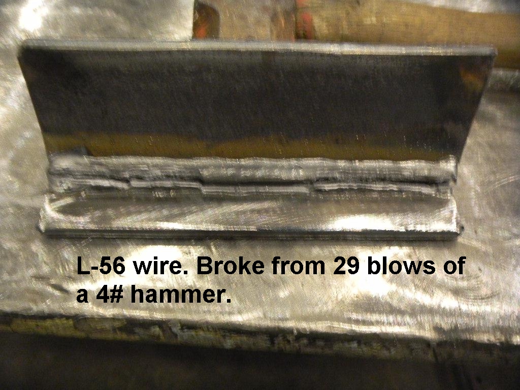

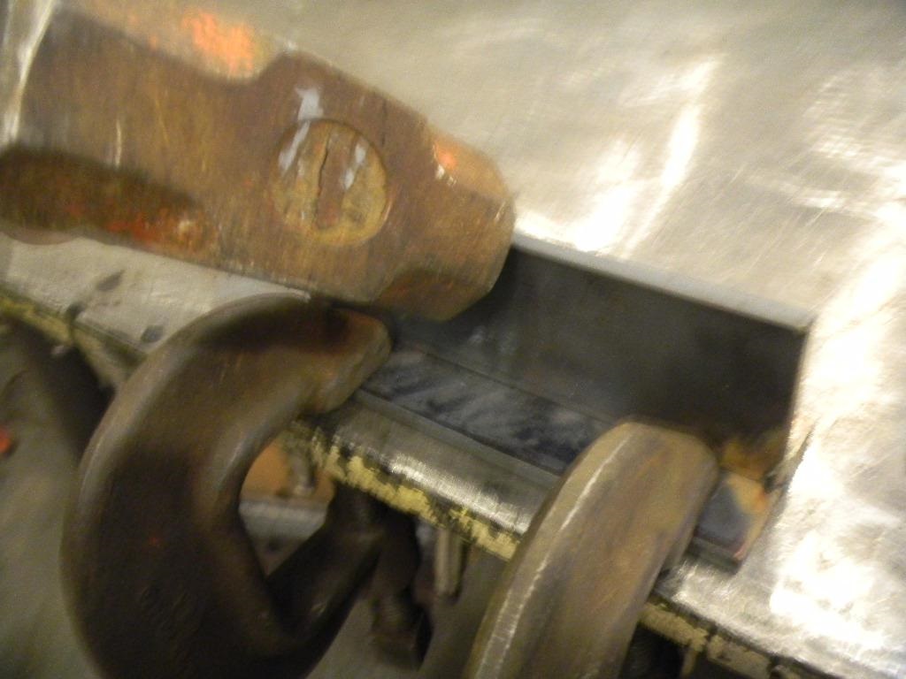

Tractorguy24 several years ago I did some fillet weld break tests. Lincoln L-56 wire broke from 29 blows of a 4-pound hammer.
7018 right out of the rod oven broke with 23-blows from a 4-pound hammer.
7018 that never seen the inside of a rod oven broke with 18-blows from a 4-pound hammer.

Does the lincoln l-56 have a tensile strength of 56,000psi? Mine is 70,000psi. Makes me think that will be quite a bit more brittle.

Do not equate tensile strength with brittleness.
