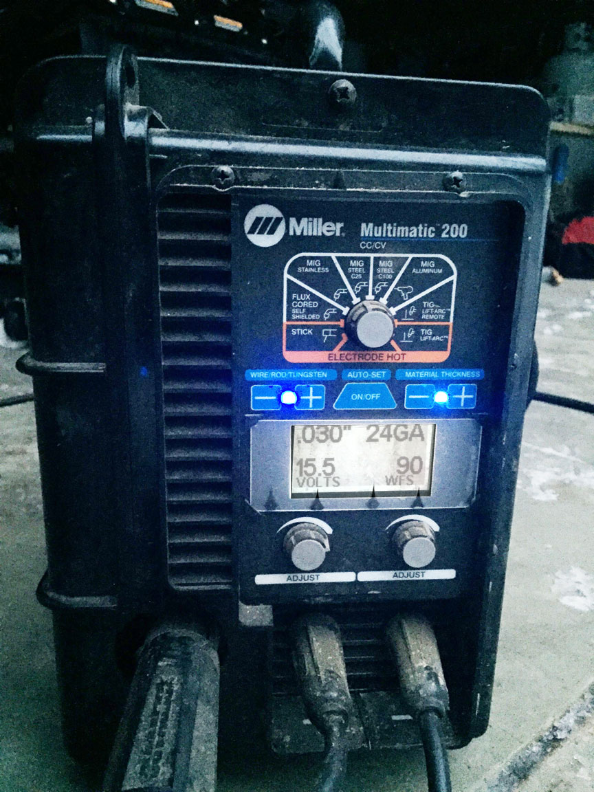

Wanna weld razor blade thickness metal together then that is the territory of tig.
Agreed.
But the versatility of a MIG is compelling.
I'll probably never weld razor blades together again but was able to do a satisfactory weld, on the 1st try (with a MIG). If all I had was a stick I would find it extremely limiting.

Nice pictures Sodo, but those are carpenter's utility knife blades and easily within the thickness capability of mig. Heck those things are thicker than sheet metal on most cars.
Razor blades are a fraction of that thickness.
/ Mig Welders #13
OK you caught me, the old double edge razor blades were something like .005
This utility blade is probably .023-.025
O.P> asked what's the fuss about MIGs, why people like them. This is just an example of the versatility of a MIG. Lots of folks reading thru these threads get the message that they need to get a stick or go home.
It's my opinion that those folks who are looking for a useful tool will be stymied by the long learning curve for stick welding. They ought to start with a MIG, and if they need a stick, then get one they're easy enough to come by.

OK you caught me, the old double edge razor blades were something like .005 This utility blade is probably .023-.025 Intent is to show an example of the versatility of a MIG, the topic of this thread.
plus it's a lap joint! Fail!
