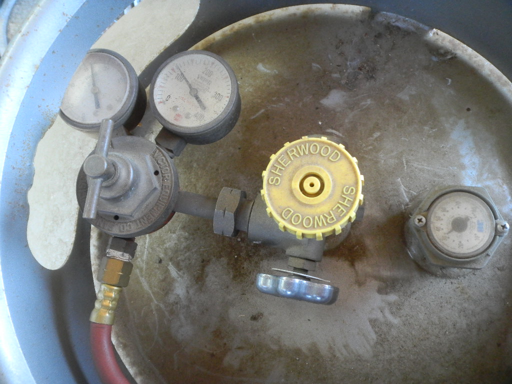

My oxygen contract is around the $60/year. If all you use the O/A for is cutting then you should switch to propane. Well actually switch for everything. I could need to be corrected on this but from what I understand you can use propane instead of acetylene for everything but puddle welding cast iron. Something about adding carbon to the weld which isn't good. The only change needed to your torch is a propane cutting tip.
I usually get around two years worth of O/A use out of 20 lb bottle of propane. It's a lot cheaper than acetylene and no bottle contract either.

So just switch to propane? Anything gotta be changed.. Regulator? torch?
/ Mig Welders
#73
Everything stays the same. The present regulator just screws into the propane bottle. The only thing you need to change is the cutting tip. A local welding supply store or where you buy your oxygen should be able to supply you with a tip. Just take the old one along to make sure you get one that fits.
The puddle welding tips don't put out as much heat as they used to but I get along just using my largest tip for brazing. The other thing to remember is that acetylene rises in air so you light above the tip. Propane sinks in air so you light below the tip.

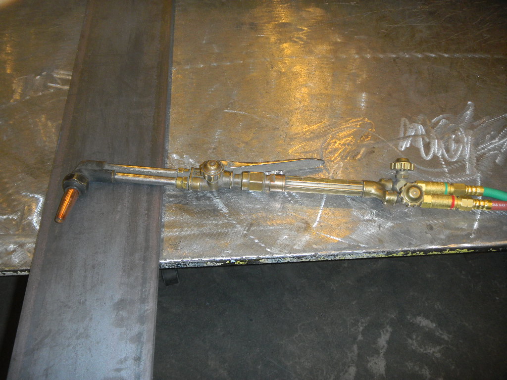

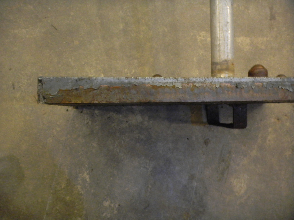

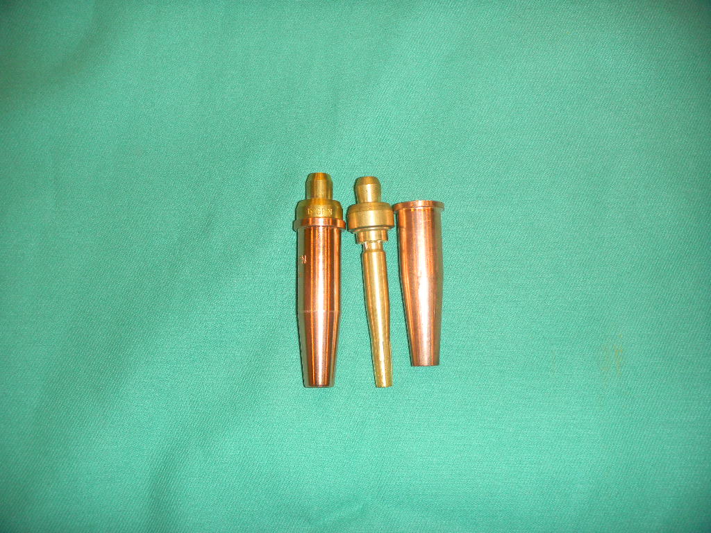

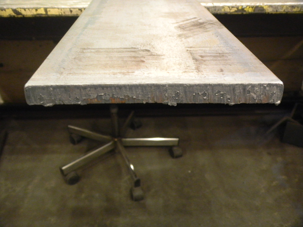

Here is a good video on getting set up with propane. It make a real nice cut, takes a little longer to preheat tho. I can't stand to use propane to heat shrink anything, just takes way to long.:thumbdown:

I just finished using it to cut a circle in some 1/4" plate. Besides I only paid $7 for it. PA had a sale on.
I sure wish my cut looked like the ones Shield Arc posted. I spent way more time grinding than cutting. I think I need a LOT more practice.
