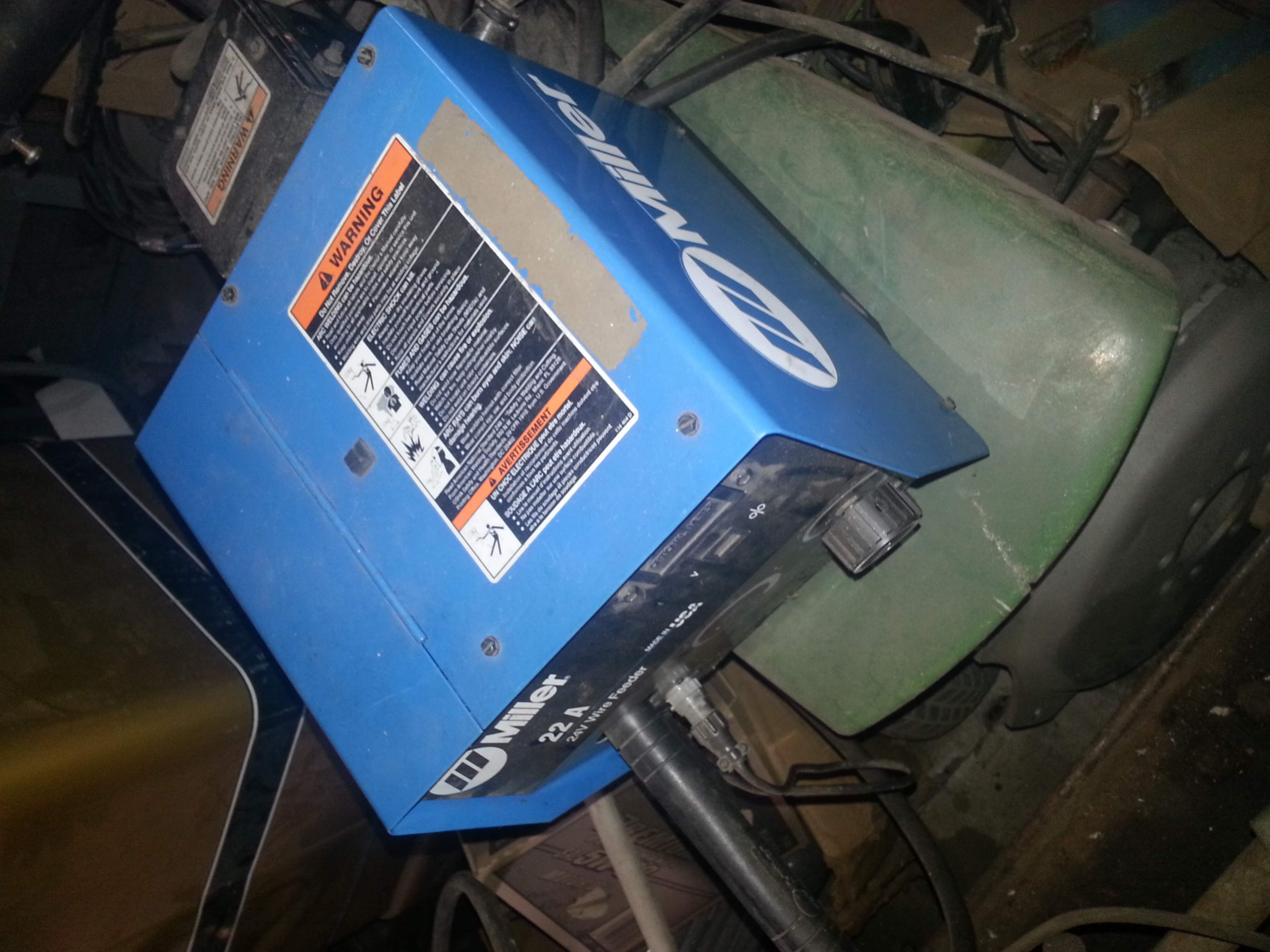

Well In a quest to find a bigger MIG welder for my own shop (220) I got a smoking deal on a Miller 22A MIG wire feeder attachment. So what Im looking for is the most budget friendly way to run this weather it be an older TIG or ARC machine, TIG would be great as I am starting to use it more and more at work.
Basically what would be the oldest machine that could work with the 17 Pin plug that this little guy has? Tracking down the specific machine wont be a problem Im pretty good at finding this stuff.
Any help or direction would be much appreciated!!!
Thanks!
-Mills

I'm not 100% sure:confused:, but maybe the Miller XMT-304, or the XMT-350.
/ Miller Welder Help Needed!! #3
Yeah, It's going to have to put out CV. A straight TIG or TIG/stick machine is CC. I think the 22A will fit a XMT...which is CC/CV.
/ Miller Welder Help Needed!! #4

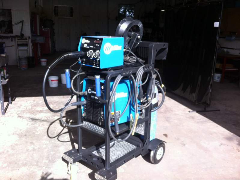

image-1837816815.jpg The XMT for sure. I have one on mine. It will also run on Miller Shopmate 300, CP302 , Deltawelds and Invisions. Terry
BTW that is prob a 14 pin plug.

View attachment 367336 The XMT for sure. I have one on mine. It will also run on Miller Shopmate 300, CP302 , Deltawelds and Invisions. Terry
