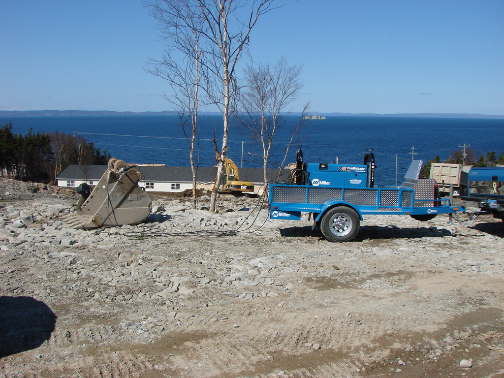

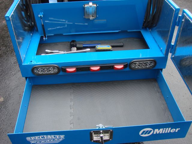

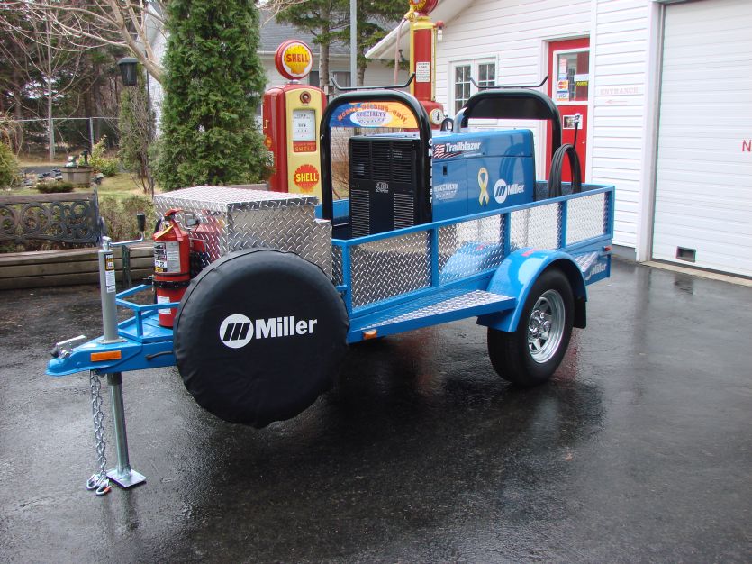

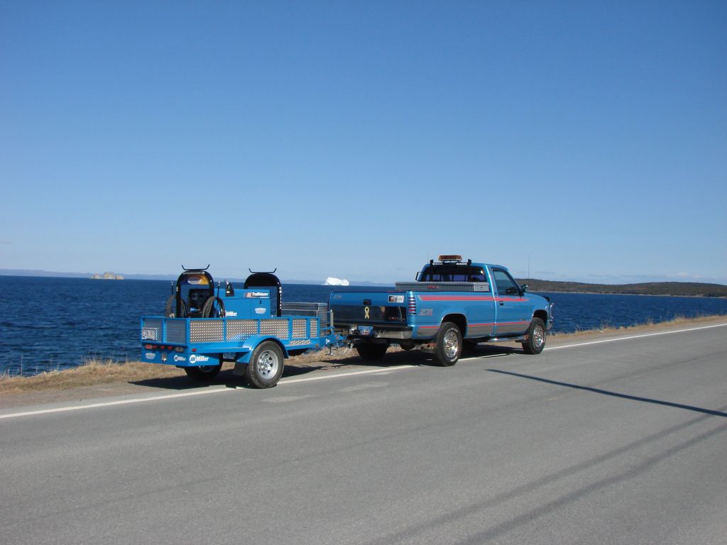

You can't go wrong with a Miller. My shop has all Miller gear. I put a new Trailblazer in service last year and it's been fantastic. I built a custom trailer to pull it around as well. The 302 has a duel in generating system that will put our plenty of power as well. I'm more than pleased with it.

   / Miller welder #11
4shorts, that is one good looking rig! Miller ought to pay you for advertising.:D
Very nice 4shorts! :D
You really did a great job on the trailer.... I like how you made the storage.
Yea Jay is right, Miller should pay you for advertising. :D
This is hard for me to say since I own Fords... But nice truck. :rolleyes: :p.............:D

Thanks guys glad you liked the trailer. When I bought my Trailblazer new last year I had a choice of two engines. I could have either the Kohler or the Subaru/Robin and I picked the Subaru/Robin because the shop that does the repairs for both engines said the Subaru/Robin didn't give any trouble but the Kohler had some cylinder head problems. I've had no trouble with the complete unit and glad I got the thing.

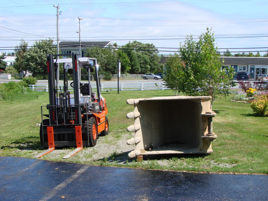

By the way. In the picture you'll see a bucket that I was patching. that was a few months ago. Today I got it back for a total rebuild. Sure was happy to have my old forklift for this lift. The bucket is off a Cat 320 excavator and it's big and heavy. Here's a picture of it.
