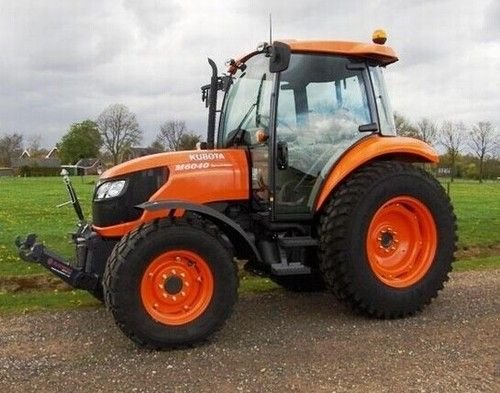

A Kubota M5040 with a hydraulic power shuttle would be a nice tractor for owners property description.
50HP, 4 cylinder, hydraulic shuttle, cab, 4wd, loader, No DPF.
run about $30-35k for a used one.

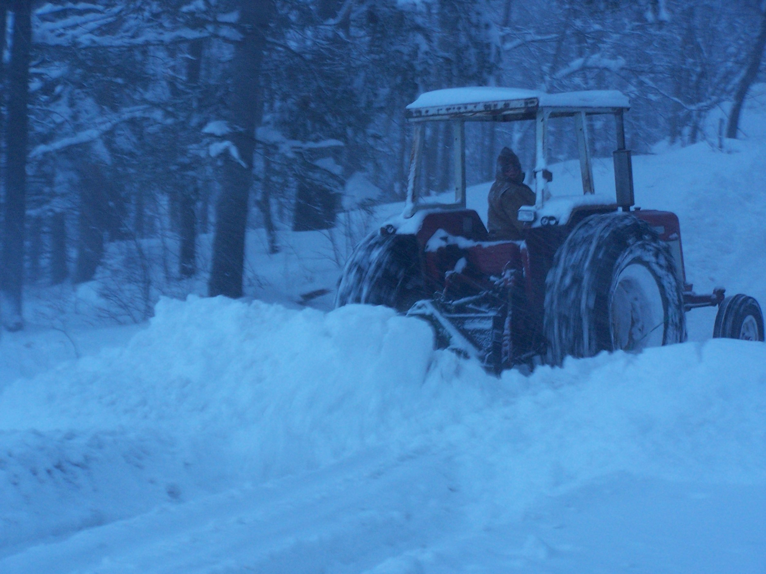

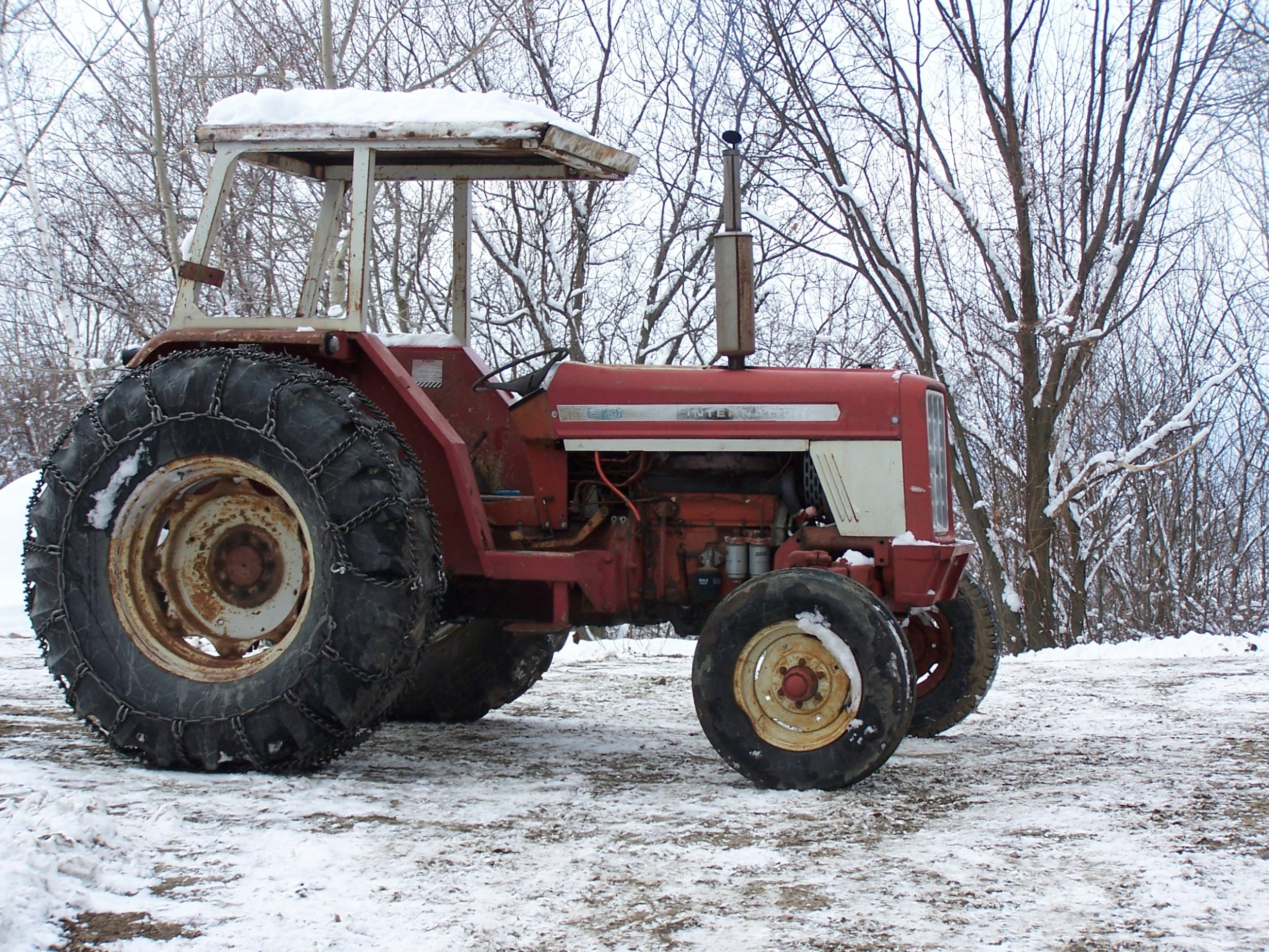

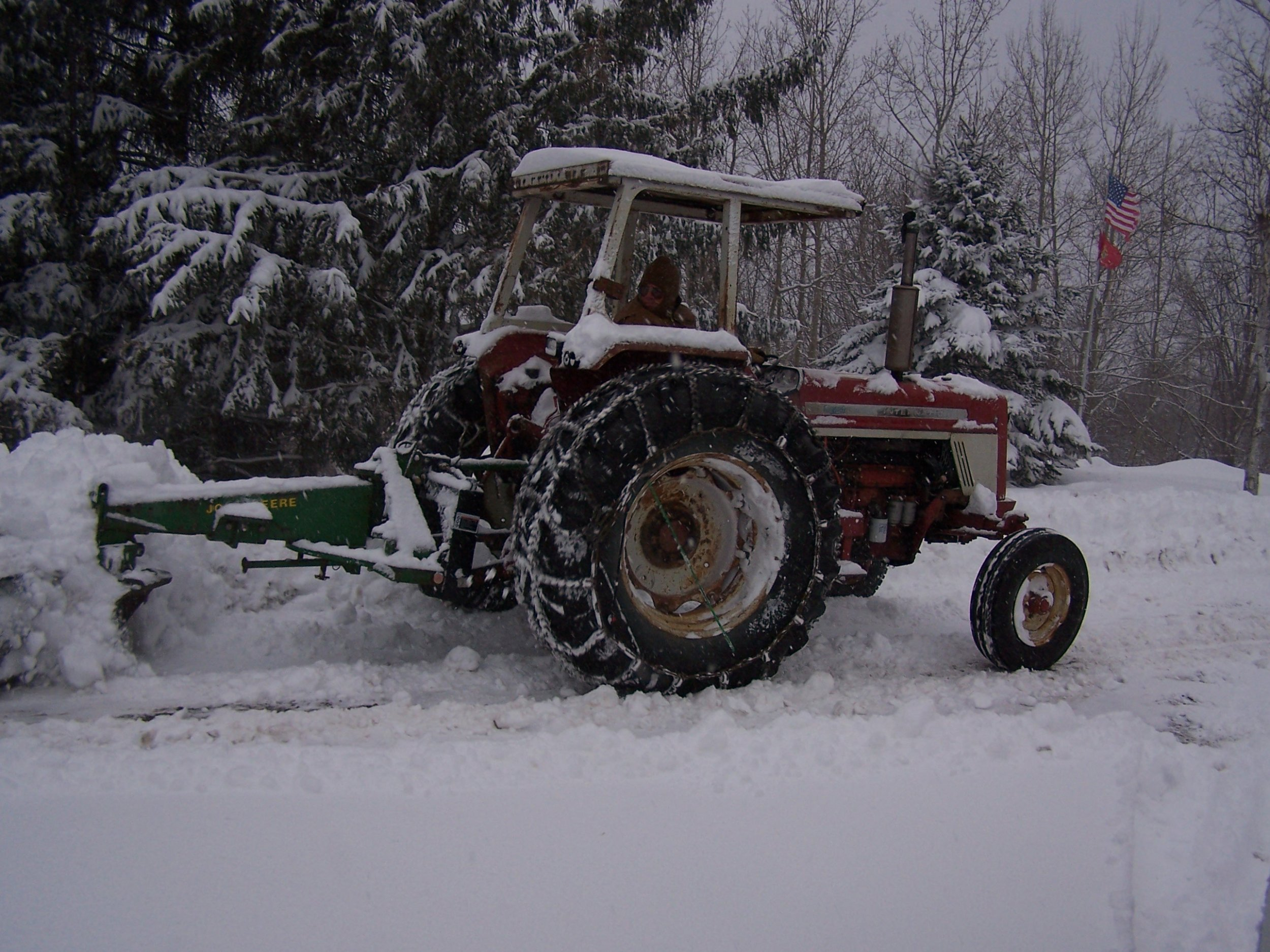

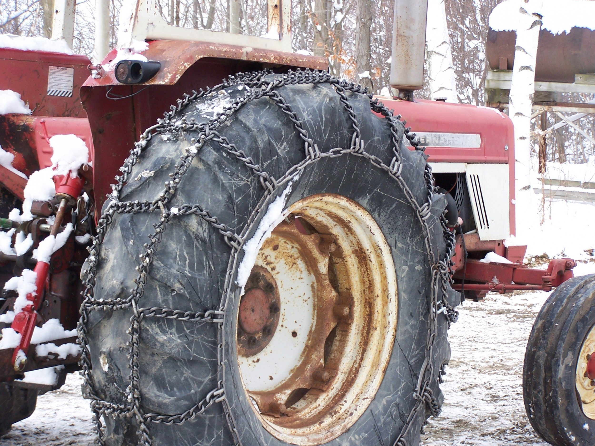

A 2wd doesn't need to weigh 12,000 pounds to work good.
This 574 has no iron or tire fill, and is handling a 10 foot blade.
Under 6000 pounds pushing a 10 ft blade and moving lots of snow,
yes I do run very good chains which can be easily installed.
Do I push snow up my steep driveway, nope.
I plow down, drive up and plow down again.
Is it the best solution, no.
I have a much newer 4wd with a cab now but I used 2wd's for almost 20 years on my driveway,
with a 26% grade.

Say LouNY -- trying to view your attchments it tells me I do not have authorization to see them. Maybe need to debug how they are inserted/attached? See the little icon just to the right of the smilie face icon in the top row? I usually click on that and follow directions and the images show without having to be separately opened.
   / Min tractor size for repairing long gravel driveway with potholes? #89
That is how I do it also, I had dropped them on and resized them after I posted originally I went back and I couldn't open them either.
So I edited it and reloaded them.
