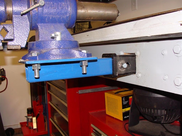

I have nearly no work space, so for a small welding table, was dreaming of building a small one, with the top 20" x 20 x 5/8 plate and mount in on a spit truck rim as its base. Kinda like this photo.

IMO, with a vise on top, it may become kinda clunky to have around. If not in a big hurry, a t-slot top setup this way might be nice To have and would make the clamping choices a little bigger.

I was thinking that the vice should be readily removable. Photo of this T slot?

Those slotted tables are to hard to clean out. I was thinking of putting the vice on a 2" square tube. Vertically, not horizontal like seen in this photo and weld a hitch receiver in the table. That way weld debris would just fall out the bottom.

Another option is to drill the tabletop to match the mounting holes in the vice and weld nuts to the bottom of the tabletop. Would be okay for occasional use, but if you're constantly taking the vise on and off a faster mounting system would be nicer. The only thing about using receiver tube is that adds a lot of weight.

That was my thoughts as well. But taking 4 or three vice mounting bolts off-on would be time consuming.

Get a receiver mountable vice mounting it to underside?
