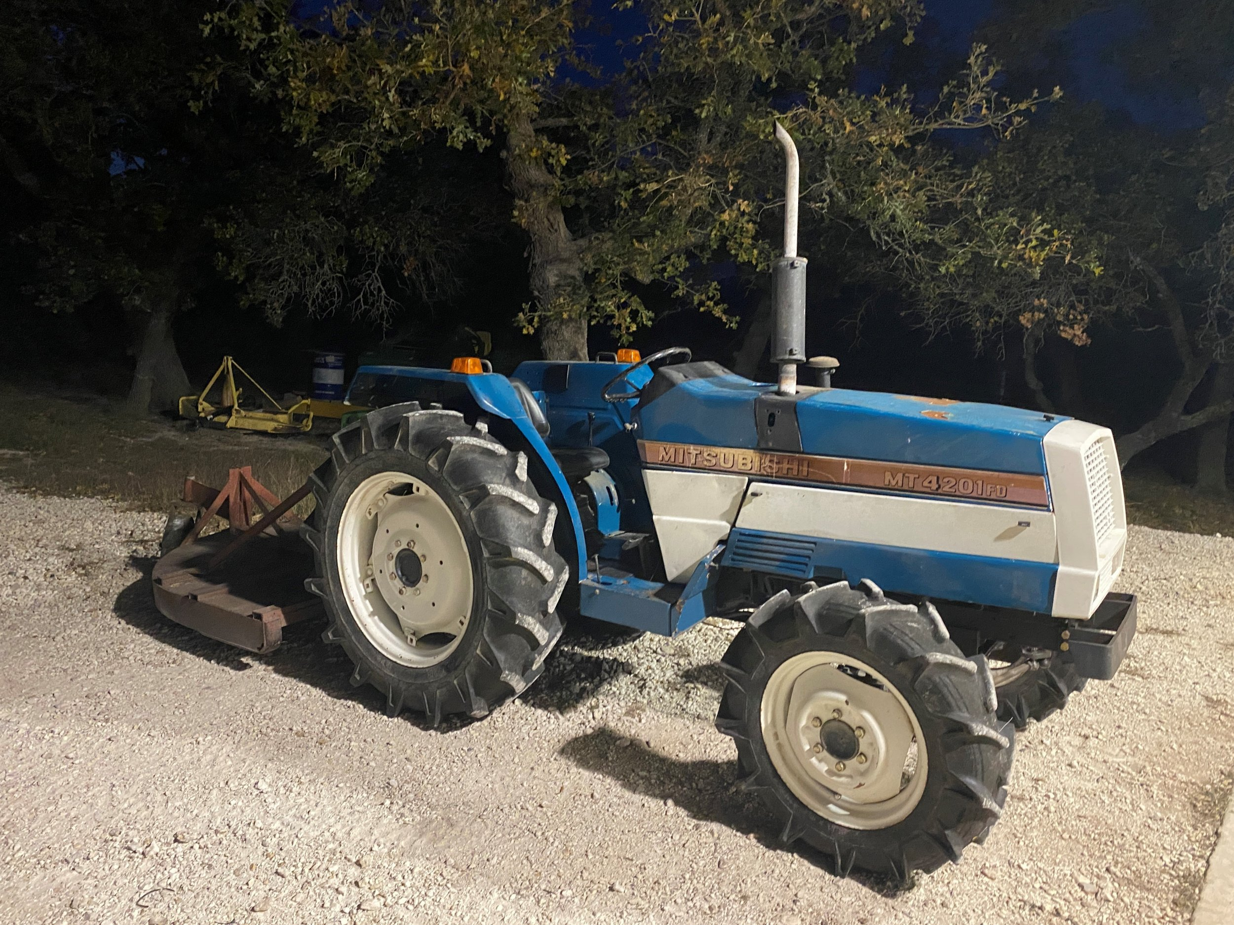

Good morning and Happy Thanksgiving week! I recently purchased a pretty worn down Mitsubishi MT4201FD, all the usual leaks I would expect from a 1989 model, but I am experiencing what I believe could be a hydraulic issue, however the unit has a clutch. When moving, the tractor will stop, clutch is still engaged, in gear, but will not move. After waiting a minute or so, and having pushed in the clutch, fiddled with the gear selection, it comes back and it may move properly for 20 mins or 3 mins. There is a 'level' on the left side of the dash that I do not know what does. it moves forward and back or up and down, chrome, with a 2" black handle. This seems to make the most difference when I am fiddling around.
I will start my search for a service manual today, but wanted to ask a few questions. 1. Although the tractor has a clutch, does the hydraulics play a role in the machine moving? 2. I have found two dipsticks, one for the engine oil and one on the left side of the PTO and gear selector shifting knobs, does the transmission and drive train share the same hydraulic fluid? 3. I also assume this tractor is full time 4x4, is this the case on this tractor? 4. There is fluid leaking out of the steering column and the steering wheel is a bit loose, before I damage the steering wheel by trying to take the center cap off, can someone tell me if there is a nut in there like a conventional steering wheel that I can tighten up?
This tractor will be fun to fix up and use, just the thing stopping for no apparent reason is a bit frustrating. It almost appears to happen when I am turning the steering wheel and using the hydraulics for the power steering. I just do not know enough about this tractor yet.
Any guidance on where the best site is to get a repair or assembly manual is also greatly appreciated.
Thank you.

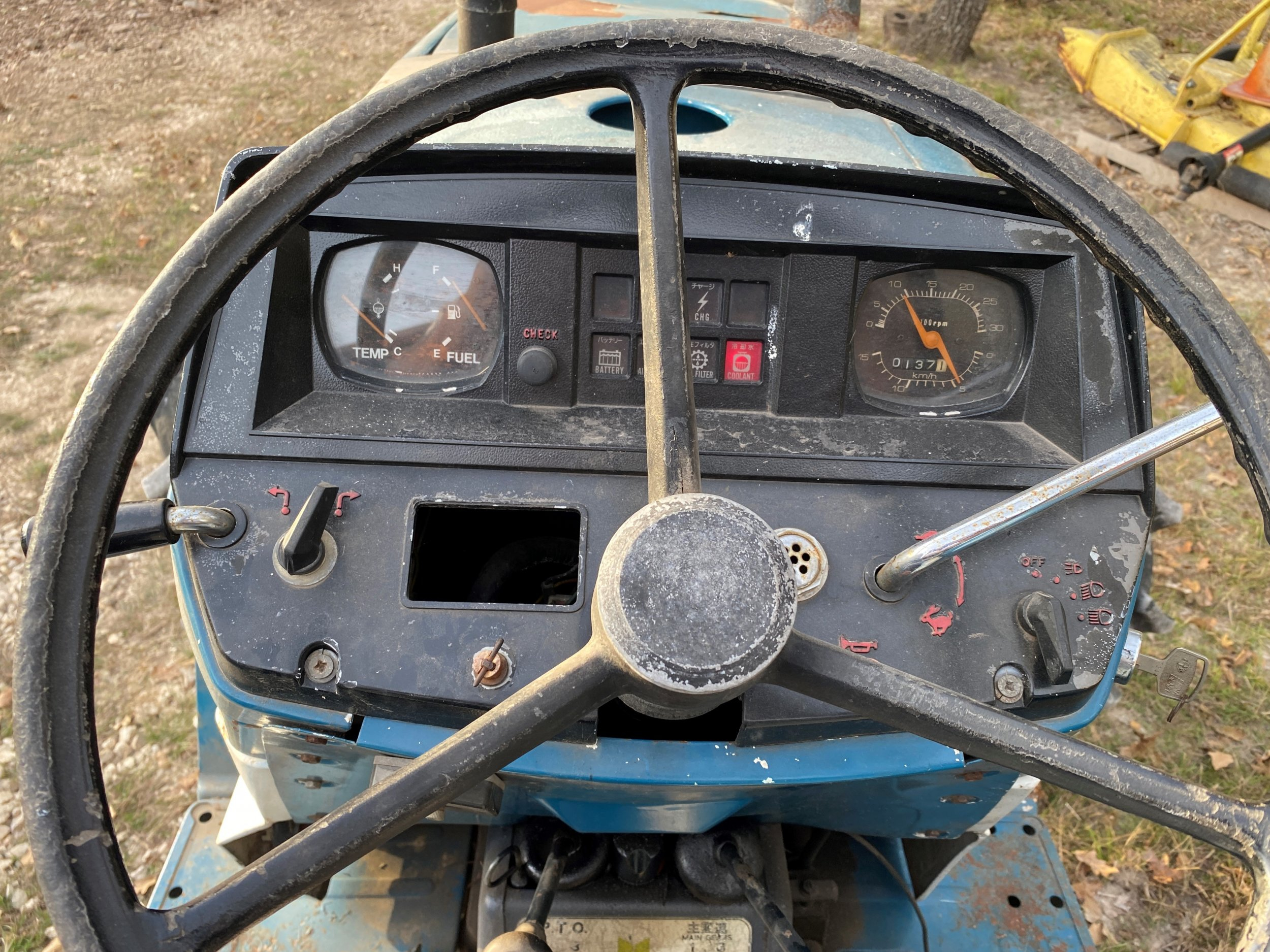

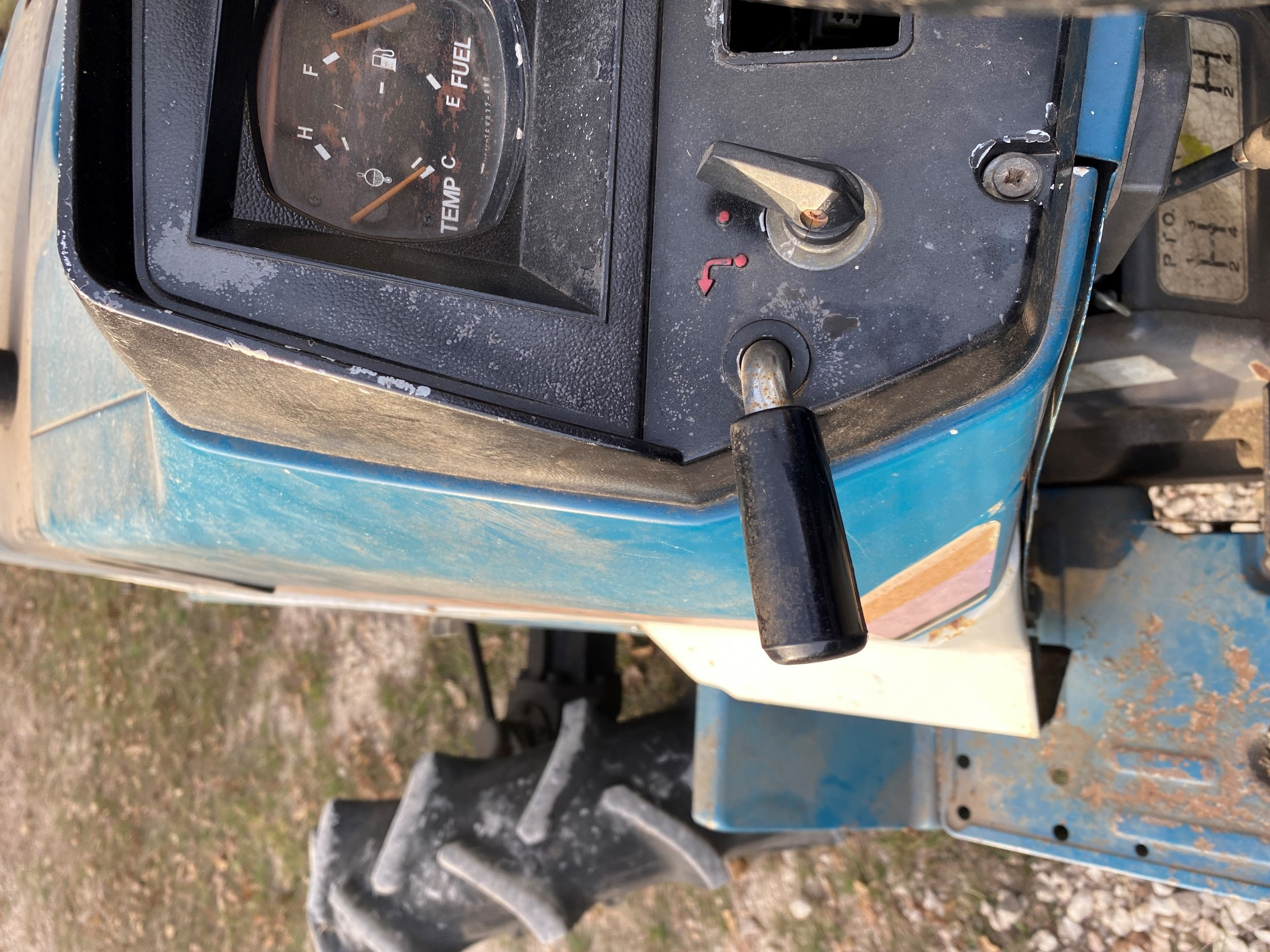

Here are pictures of the dash. what does the Lever, left of the turn signal switch do? And yes, I am emailing Valley power for manuals. But in the mean time, what does this do? Thanks in advance.

/ Mitsubishi MT4201FS #16
That lever usually mean it's a shuttle shift. The means you flip that lever to forward or backwards. This shuttle can either being mechanical with a dry clutch or hydraulic with two clutch packs, one for each direction. In this later case the clutch pedal just dumps the pressure of the clutch packs.
However, that lever doesn't look quite right to me. Almost if it is disconnected. It looks way to close to the dash both. Should be higher, almost as the same lever of the steering wheel. Have tried to peek under those covers to look for anything obviously wrong?
