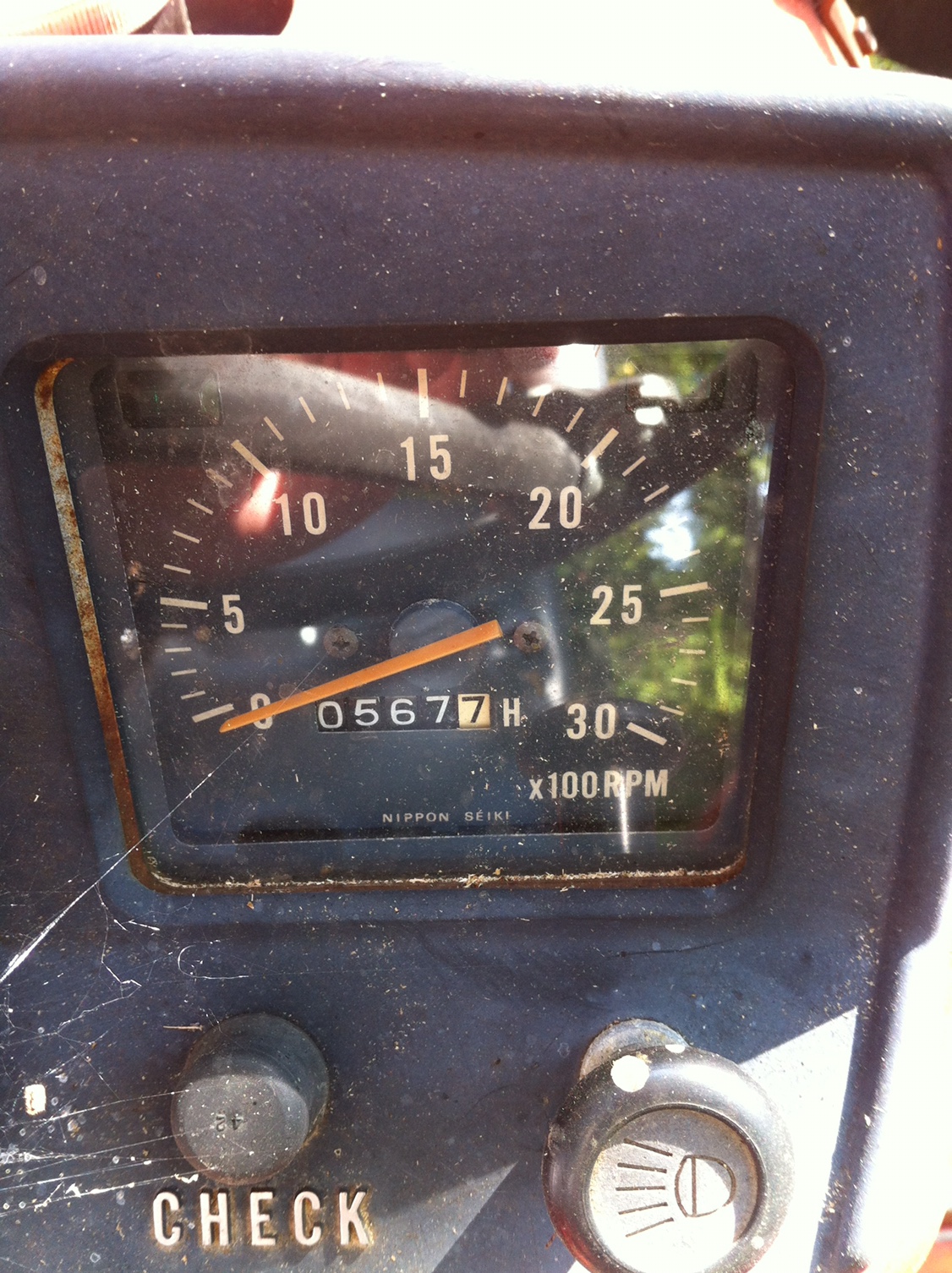

Are you saying the tach is labelled for the various rpms needed to attain PTO 540 in the various pto gears?
Here's the YM2000/YM240 tach diagram. For US YM240 with two speed PTO, 2200 @ engine gives 540 or 1000 rpm at the PTO.
61665d1159237755-20-series-owners-manual-errata-ymoperatingrpm-gif
For your first question, the answer is YES.
And we had discussed this last year here: See page #2 and my post #15.
https://www.tractorbynet.com/forums/yanmar/406501-engine-rpm-vs-pto-rpm-2.html
Now that makes a whole bunch of sense now. One the YM US models, there is only PTO on or PTO off. For my YM2610, this seems to equal the PTO selector #1. Nice find. :thumbsup:

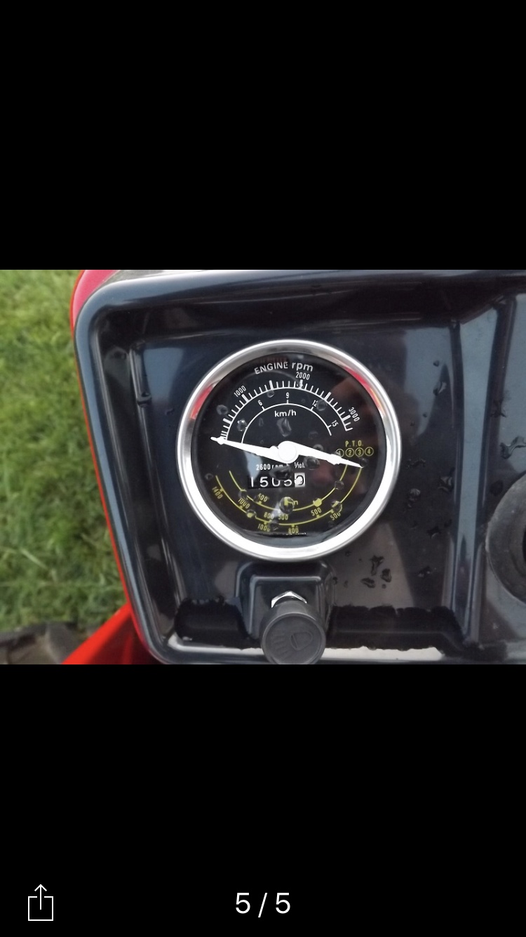

A borrowed picture here may be worth more than words. I believe this was from a 2610 but could be wrong on the model
As I understood the explanation with this picture, regardless of what PTO range is selected, he could match his engine rpm’s to generate 540 PTO rom’s. [
This pucture is from my YM2002D and I do not have that extra info on it.
ATTACH]627023[/ATTACH]

This picture is from my YM2002D and I do not have that extra info on it.
Mine has 3 PTO ranges I have looked it up in the past but forget exact numbers and am not where the manuals are so here are approximate speeds at operating engine rpms of around 2500 rpm
1=540
2=760
3=1000
Hope this helps clarify.
Yes, that is my borrowed pix from my tractor. lol :D Sorry it was wet after the wash and blurry. Here's a better one I took last week as the hour meter just rolled over.
Bummer there isn't a second inside PTO selector arc curve in your RPM tach gauge. You could pick PTO #2 and run the tractor to 2200rpm and probably hit 540rpm on the PTO output. Likewise applying the same principle to PTO #3 and maybe run the tractor at 1200rpm to probably arrive at 540rpm on the PTO output.
So, if you have an automotive timing light or an adjustable strobe light, you can tune what RPMs gets the other PTO selectors for 540 PTO speed rpms on the output. There Are a few good YT vids showing how to track and set a strobe at a constant speed, then keeping that setting on the strobe, change to the other PTO selections and adjust the engine RPMs till the strobe matches either in stillness or a pulse that you can count in a rhythm.
Your Yanmar has some hidden talent ready to be utilized. :thumbsup:
Sounds like your Yanmar is fully capable to do this, just that the indicator on the tach isn't there.
