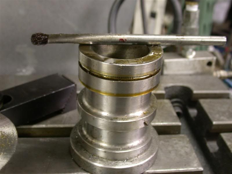

   / MODIFY BRUSH HOG SOME MORE #86
Rob,
The pins came out great, they must be worth their weight in gold now., looks like they were a load of work, with many different machining operations. I suppose it's tough working with hardened steel like that. The recessed Zerk fittings came out really nice. And the wheel brackets are coming along nicely too. I don't remember seeing your whirly gig, the gizmo you used to turn the pins while you ground the retaining ring slots, I'd like to see a picture of that setup. You seem to be getting pretty close to wrapping up this fine project. Is there any brush hogging that needs done so you get a chance to try it all out?

Thanks Larry for commenting.
It is a lot harder to work with hardened steel. There is always a risk of work hardening the material and also scorching the drill bit and freezing it into the hole. ??? Usually you have to grind or use carbide, but once you get through the case hardening, the centers are cut-able or drill-able.

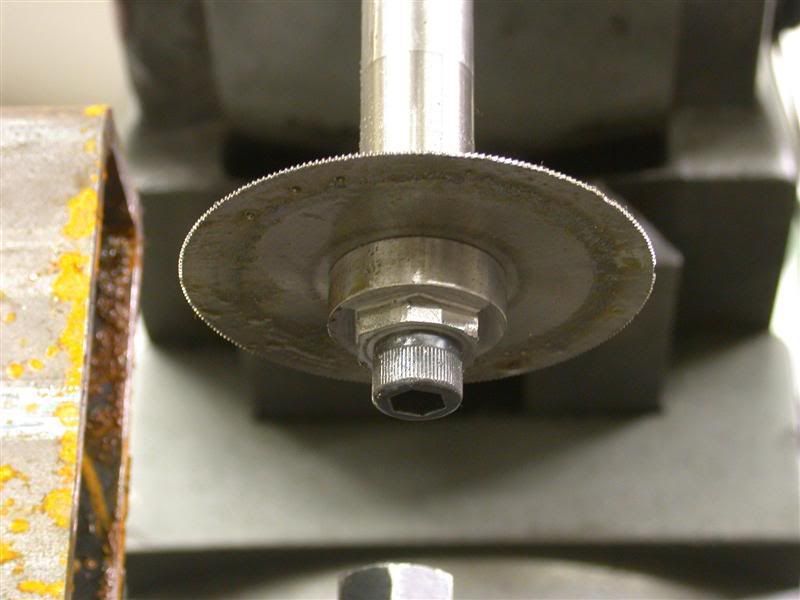

I have 3 Harigs and 1 Gromax whirlie gig that you can put round stuff on to grind, cut off, cut slots and index for different cuts/holes and a couple motorized pin grinders. One I made myself. They all have sliding "V" blocks to put the round stock in, then you center them up using a test indicator. They run true to about .0002" TIR (total indicator reading). They are super handy and I have a large round magnet to spin larger diameters.

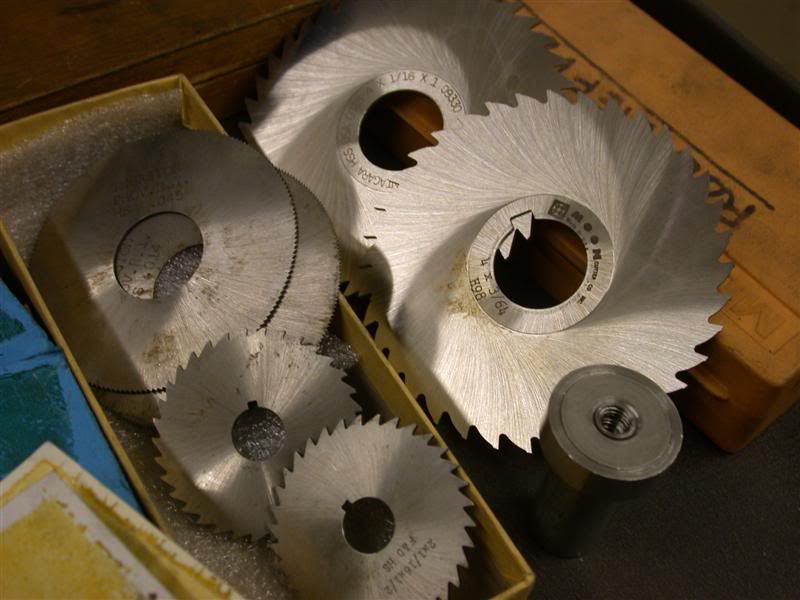

Rob,
I really appreciate you taking the time to post the pictures of all your whirly gig's. In the first picture, the one in the box, how old is that one? looks antique to me, I bet it works as good now as it did new. The one on the right in the first photo seems to have a magnetic base, does it have an internal magnet? And I see you have one with a motor. Man your sure did assemble quite a collection of machine tools and accessories over the years. I bet you never imagined you would use all that to modify your brush hog along with all the other great tractor fabrication projects. If it weren't for your tractor you would probably just me making "stuff" on all that equipment just to keep yourself busy and to keep it all from rusting.
Larry

Larry,
Some of those spin jigs are old but still true. I have used them to make many, many things over the years. I love making tractor stuff (I'm just like you). Can you tell?:)
