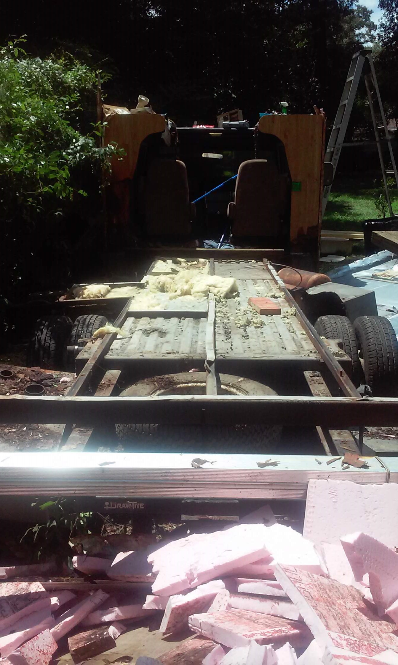

Now you need to take a micrometer or calipers to the box frame and measure it's thickness. If you can measure it though like an access hole or other hole in the frame in several locations in the rear, mid section (where transmission is) and toward the front where the bumper mounts or where the engine/front a arms mounts and let us know the thickness.
Material thickness is key here, a box steel tube is strong, but as Jim said above depending on it's thickness, oak logs placed in the middle, behind the cab area, could be enough to cause cracks and failure. To strengthen the frame, you'll need to use some more box tubing or plate steel and add it to the sides of existing frame and bracing side to side to make it stiffer sideways. You can Google truck fame failure and truck frame reinforcement to find out more info here.
After looking at your pictures again, you are going to have to chop off some of the rear end (make shorter) OR move the rear axle back a few feet. The reason is a 5th wheel needs to sit above or slightly before the rear axle. Also, If you did mount it currently I bet there are very few 5th wheel's with a neck long enough to reach without contacting the rear bumper.

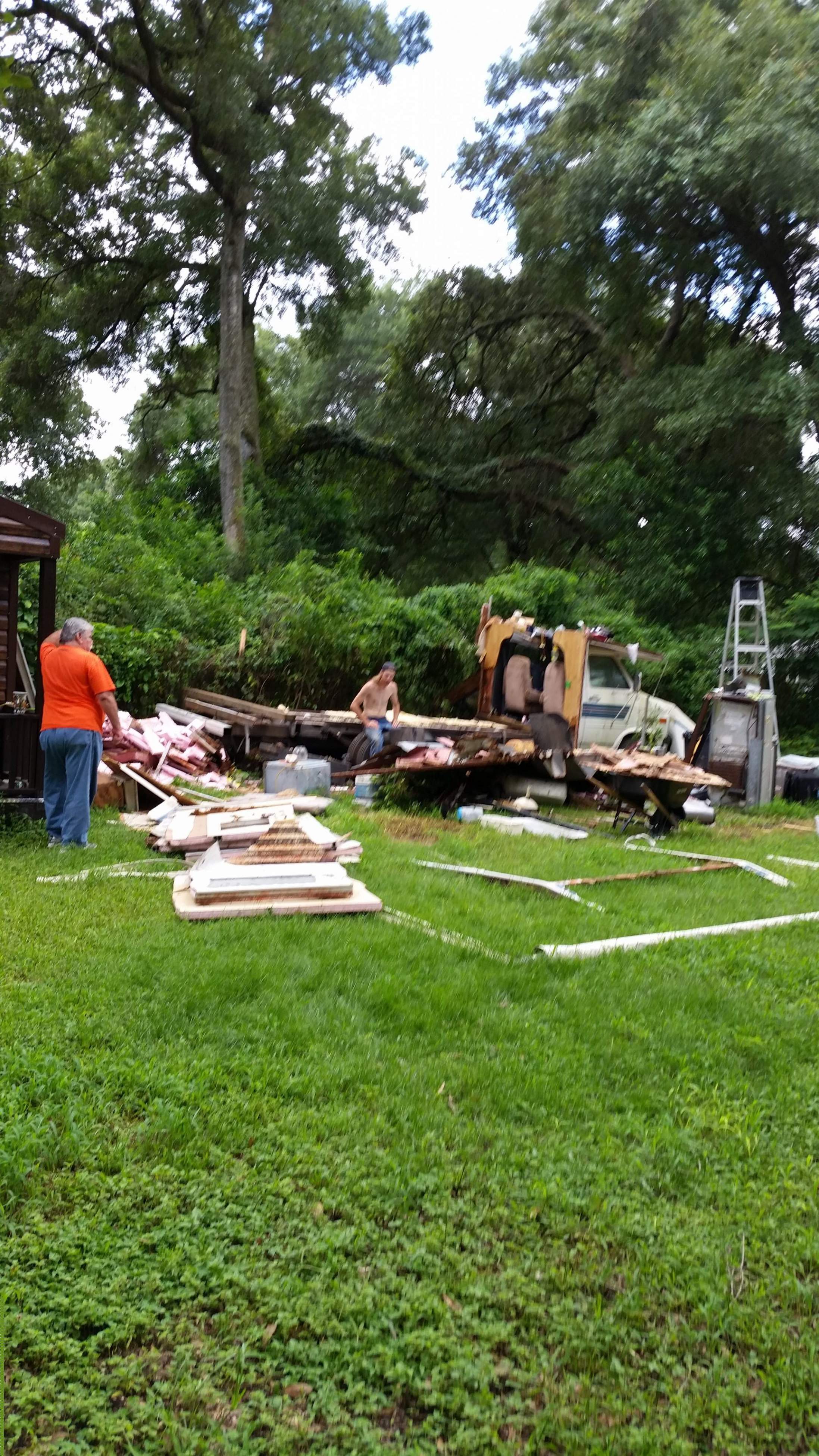

   / motorhome convert to pickup #95
just a little more progress...
It took me 2 days of grinding carrage bolt heads off. I would grind some and then lift on the floor frame with a floor jack to pop the ground bolt heads through and find any that I missed.
but now there is 1 more sub frame welded on. I got my angle grinder ready for that
I found out a couple things...
2 loads to the dump yesterday and maybe 1 more. everything else is burnable or scap metal
the vehicle frame is THICK AS **** and straight. it is right close to 1/4" or 3/8".. no curves behind the cab at all.
and it sure does have alot of springs..
also keep in mind that this is my first 1 ton..
I rotated the last two photos...
#96
thank you for rotating pics, my brother took those. I am the blurry long hair hippy sitting on the tire without a shirt on. It gets REAL hot here in florida. Also we dont have humidity here in florida.. We have steam...
#98
Could be an episode of 'COPS'. :D
Just kidding. I've often been spotted in that pose looking over the destruction I have just caused. :thumbsup:
my thoughts at that moment were "what did I get myself into".
I have more cleanup work to do than mechanical work.
mechanically all I need to do is wash out and dry fuel tank and then flush fuel line and return line. and change that stupid little 1" long hose on the gm fuel pump. I put 1 on there 2 years ago but I know it is not the right one.
