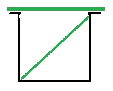

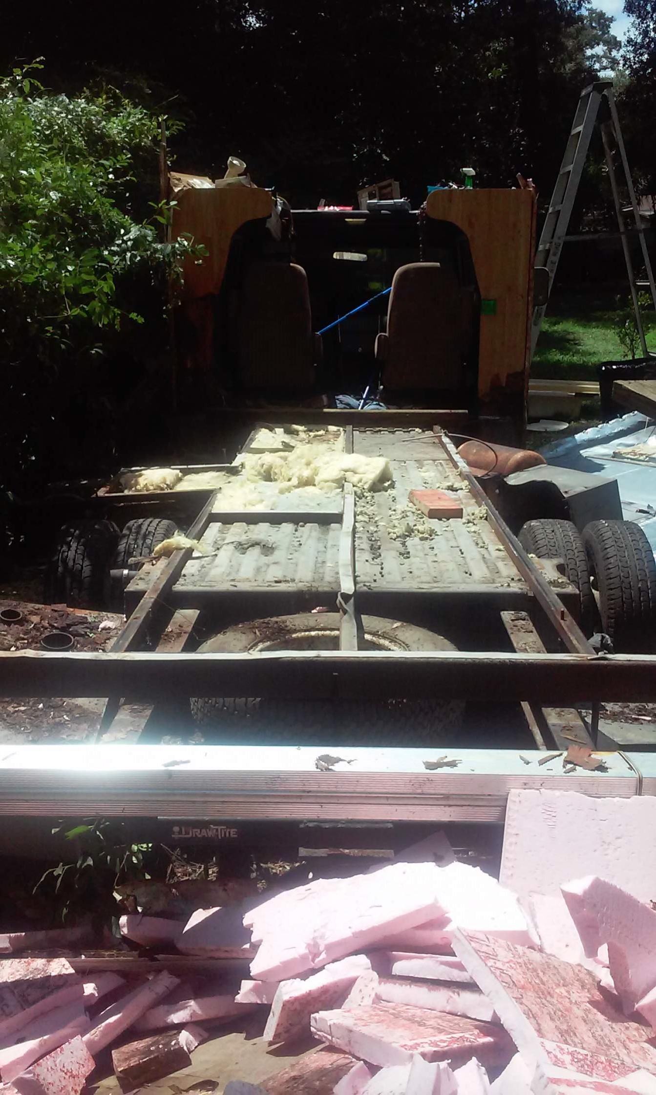

the frame is NOT box... it is U shaped. I couldn't tell before because the sheet metal covering it.
Now that I got the sub frame off and I can see under the sheet metal
some places there is a 1/4" thick top plate welded on
and in other places there is a diagonal plate inside the u but not all in the same places
and in some places the u frame is doubled up
here is a drawing I got pics comming later when I get my cell phone back.
please someone tell me what to do??
is this some sort of unified frame/body???
wtf
I think my hauler dreams just went out in the friggin garbage!!!

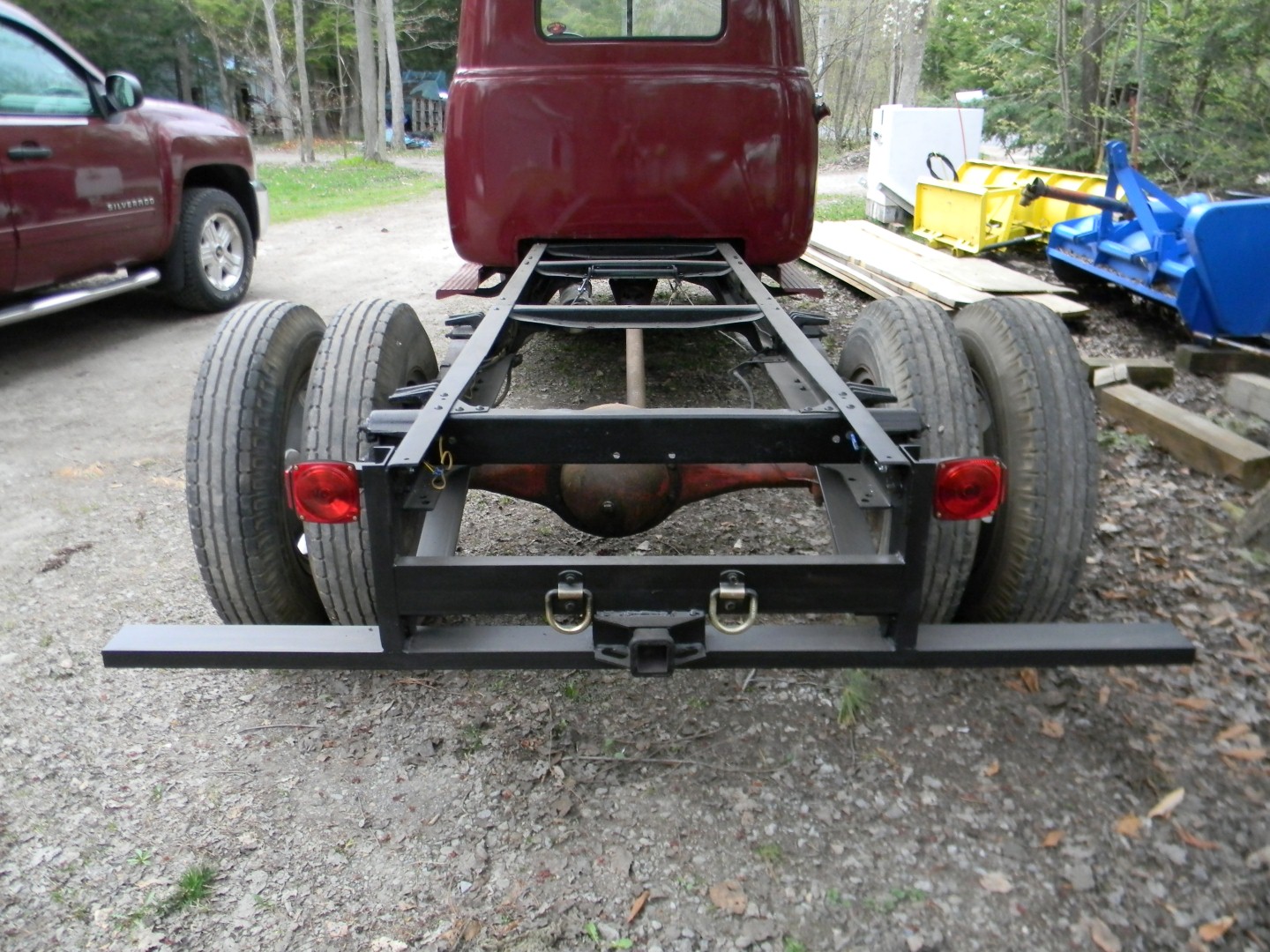

Nothing wrong with a C Channel frame. Most trucks use this type frame.

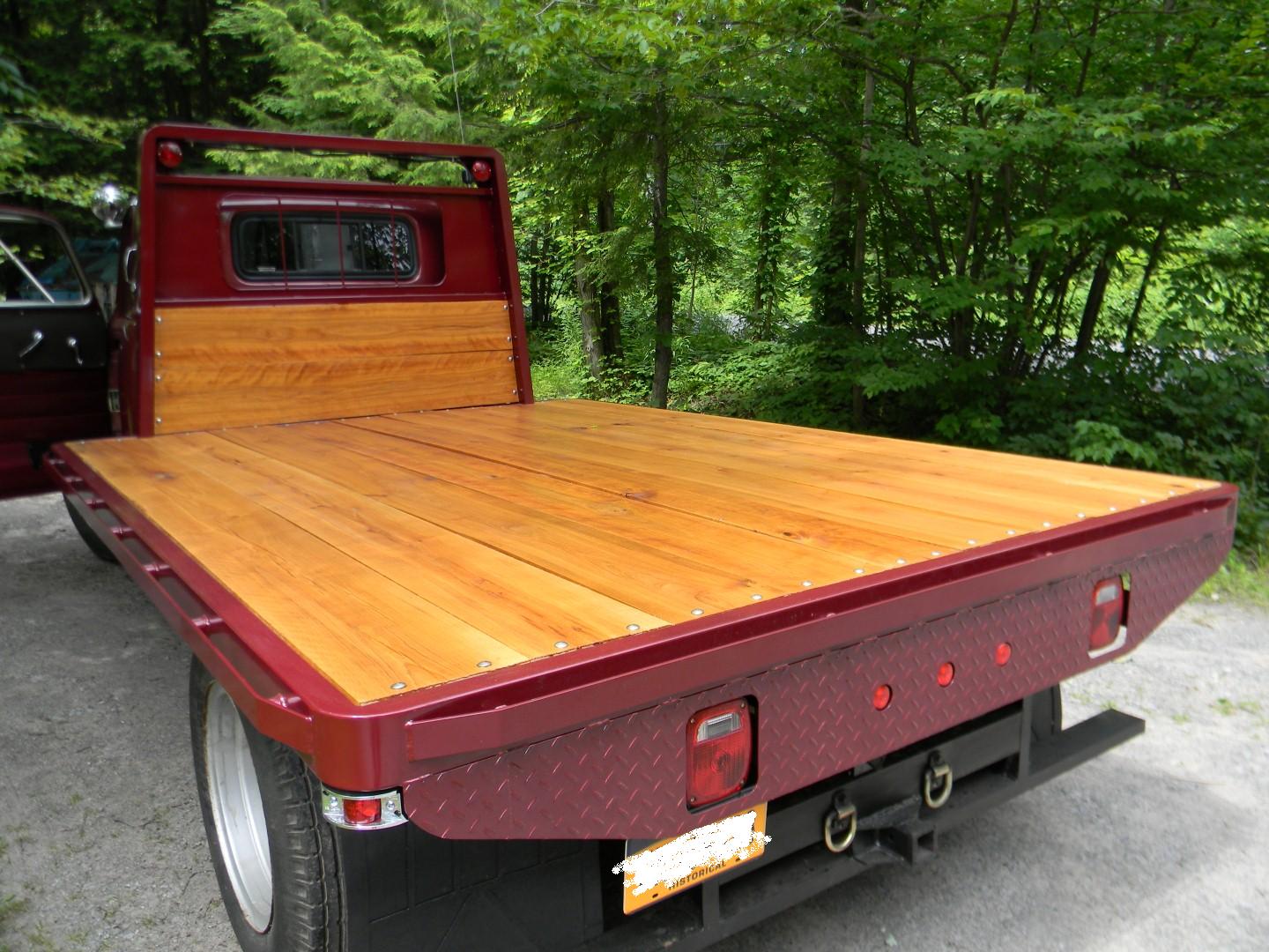

I have a 49 Chevy 1 1/2 Ton that has C Channel frame. It was originally a fire tanker truck. That C Channel frame hauled a 1000 gallon water tank on it. It was a cab n chassis when I bought it. I had a 10'6" x 8' flatbed built for it and I installed 2 x 10 hemlock deck. Made the rear bumper with trailer hitch also. I thought about mounting a goose neck hitch but I don't have a GN trailer anymore and the truck spends more time going to car shows than hauling anyway.

no, this is NOT a c channel frame.
this is not a box frame.
It is a U as in the letter U shaped frame!
It is a unibody
that means I cant haul **** with it.
I could haul a lawn mower trailer and that is about the max...
project over
not even worth pulling the engine or tranny out of it.
I am calling the scap guy tomorrow to come get it!!!
SAW - "GAME OVER"
I lose..

How about some better pictures of the frame you're talking about?

from the pics you posted (attached) where the spring perches are mounted on 1 pic and the frame on each side of the spare tire in the second sure look like a C channel frame to me.

Sounds like he found some fish plates from where it was stretched.
We need more pics. You can't be this high strung getting into a project like this. You've gotta roll with what you uncover.

I don't know why you are scrapping this project? The frame you have was heavy enough to support a rv and all it's supporting equipment, why would it not be heavy enough to haul what you want with it? I am assuming the flat bed you would have fabricated would have strengthened the vehicle even more.
Your frame is just like a C-channel turned up and enclosed on top. It's essentially a boxed tube, should be strong enough. It was strong enough to require a dually axle in the rear.
