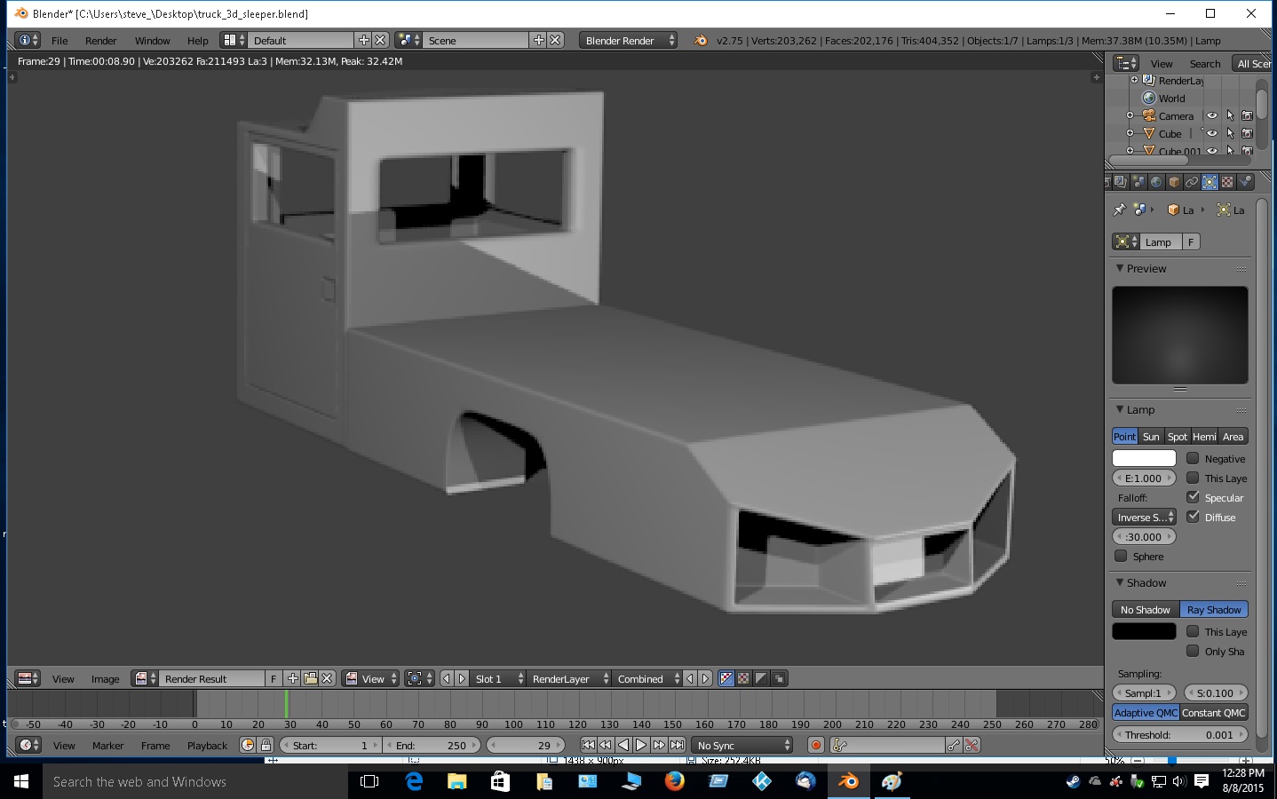

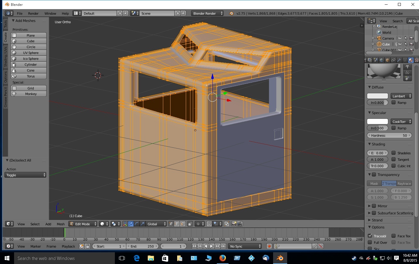

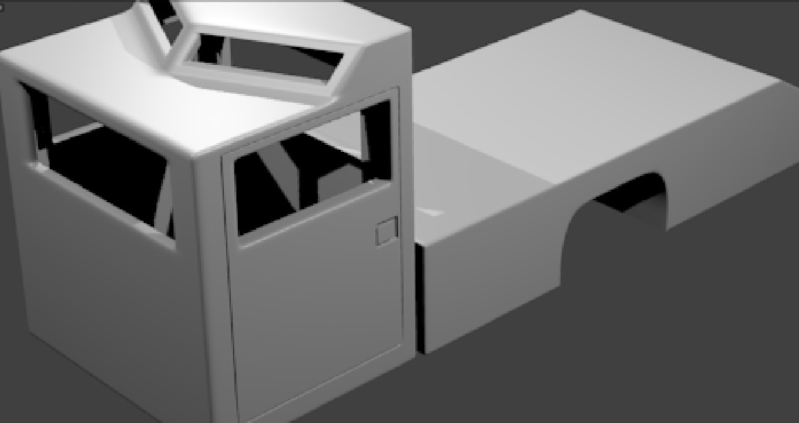

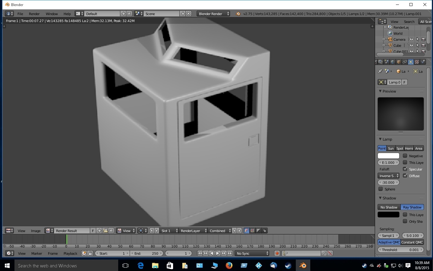

well, since it is flipping raining again, I decided to get some ideas out of my head. I drew them as best as I could in blender 3d. I am not really a 3d artist. I know just barely enough to be able to do stuff like this.
like I said, I am not a pro 3d artist..

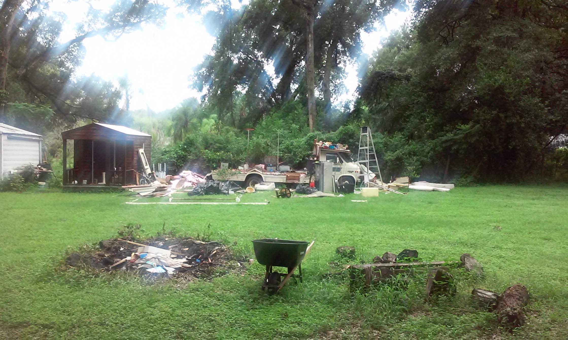

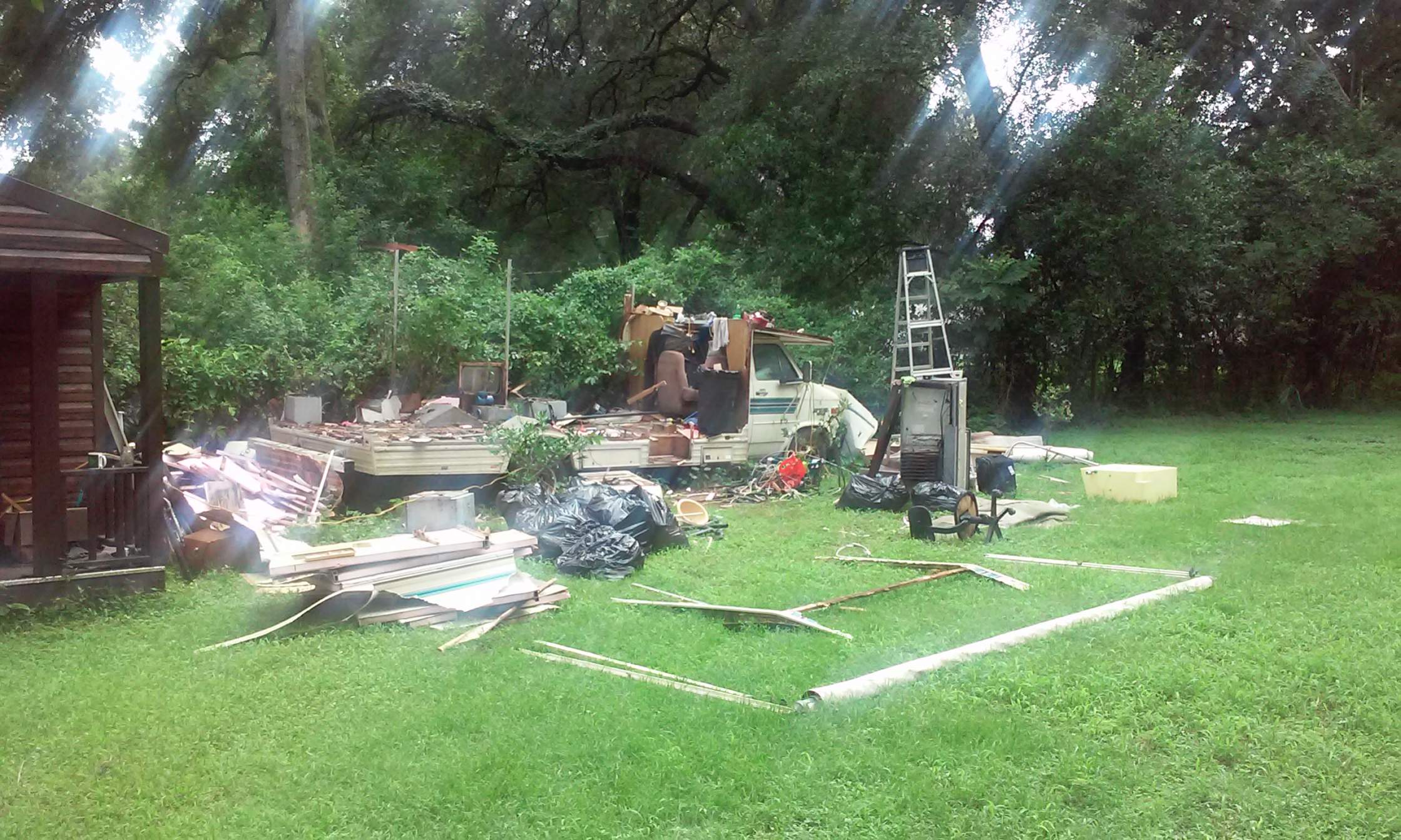

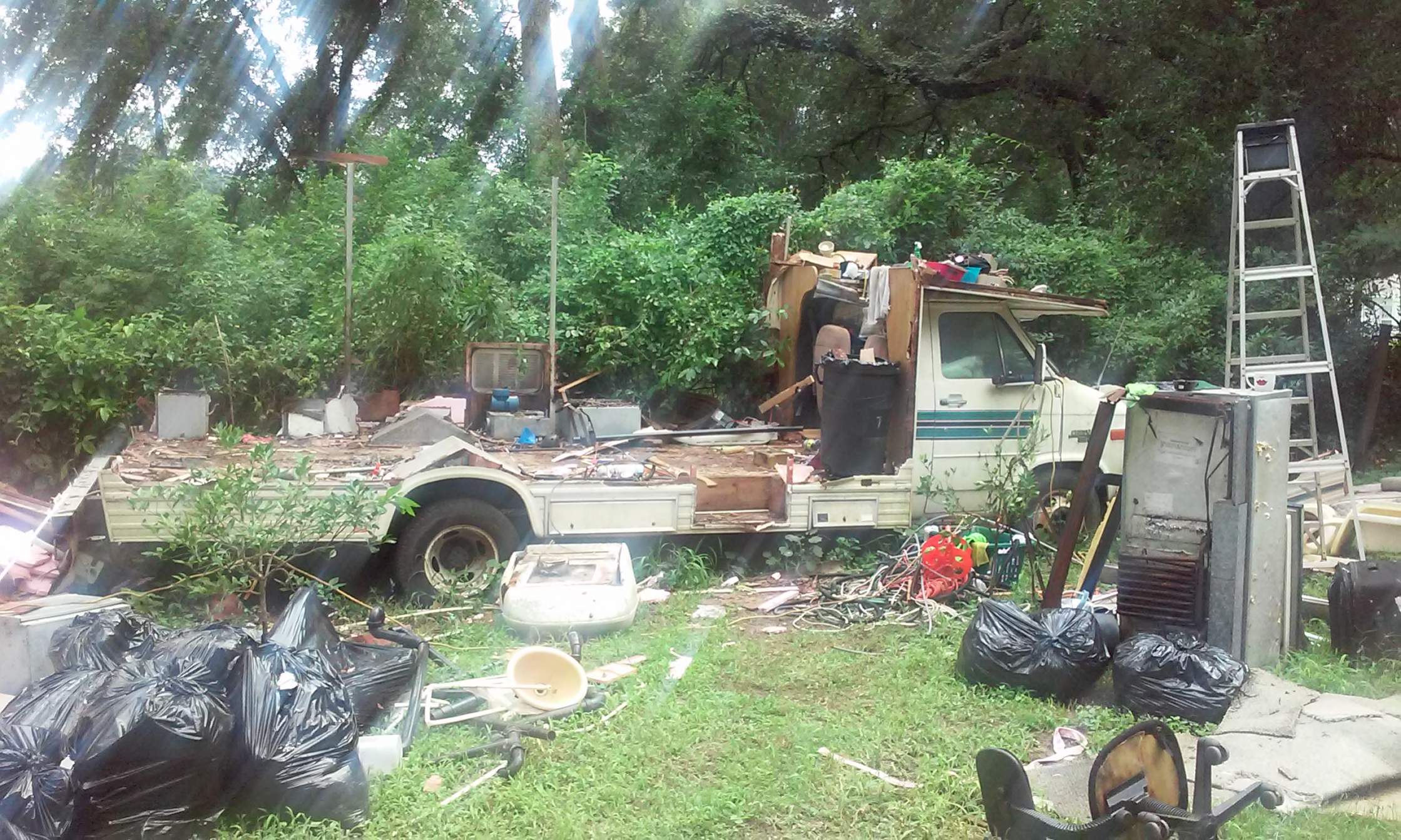

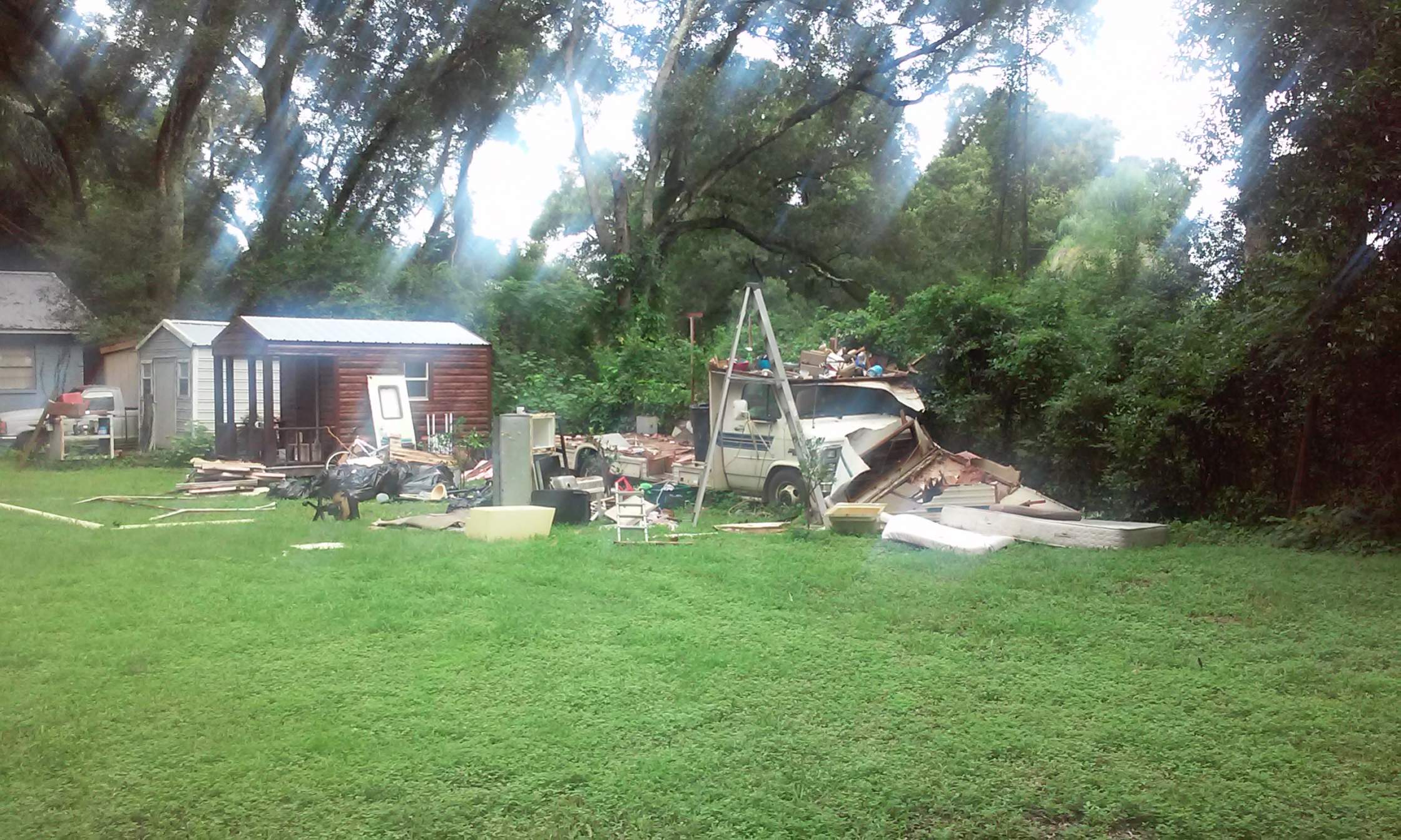

it stopped raining long enough for me to get some work done today.
I can now start to see where I am going with this project. here is some pictures I just took of the progress and the big honking mess I have to clean up.
I got a plan! I am going to let my little brother to help me clean up because I know he will be all over the scrap aluminum frame and copper wire. he is one of those that will spend 3 days cleaning metal for $30 at the scrap yard.
It looks to me like 1 load ish to the dump and 1 load to the scrap yard

Why that funky tail in the 3rd picture? You'd lose deck space and its not square, so you won't be able to drive anything up there. Just curious, not critical. :)
   / motorhome convert to pickup
#74
that is specifically for towing a trailer purposes. With angled corners like that, you can cut a trailer around a corner at a sharper angle without jack knifing it and breaking something. i.e. less chance of bumper to trailer contact.
like below
and it was just a idea for a hauler bed. made with diamond deck and wood

Ha ha your yard looks like they just shot a James Bond movie there!
About 1:50 in the clip.
Good luck it's a cool project, Fred

Steve,
Be aware that the frames on the P chassis vans are vastly different from the C and K series trucks. So you won't have a 3500HD truck, but rather a van with a flat bed with 10,500 GVWR. I don't want to discourage you, just correct your line of thinking.
The frame differences per model and wheelbase are staggering. There are about 30 different frame types for the C and K trucks alone, most of which are not visually any different, but are significantly different in strength.
like below
436909-motorhome-convert-pickup-jv-hauler-jpg
i generally curse bumpers / steps, well i should say my shins and knees do. then i get a bit moody trying to lean over the steps / bumper to get to stuff. good pants on or like, and leaning onto bumper / steps.
my issue with truck bed steps to just flat bed trailers. is a step does me no real good, and needing like a hand rail or something to grab a hold of with hand, while using step / bumper.
you can get and/or make longer "ball hitch draw bars" that stick out a few extra feet. i you want something for specifically jack knifing. for say when parking trailer in a garage or like.
i would more likely favor being able to place ramp or ramps on back end of bed. and holding the ramp in place, make it a 2x6 / 2x8 boards with a L shape angle iron that goes down into a grovish area. or like.
