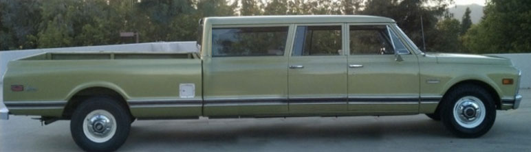

   / motorhome convert to pickup #82
attachment.php
,,,,except with duallies.

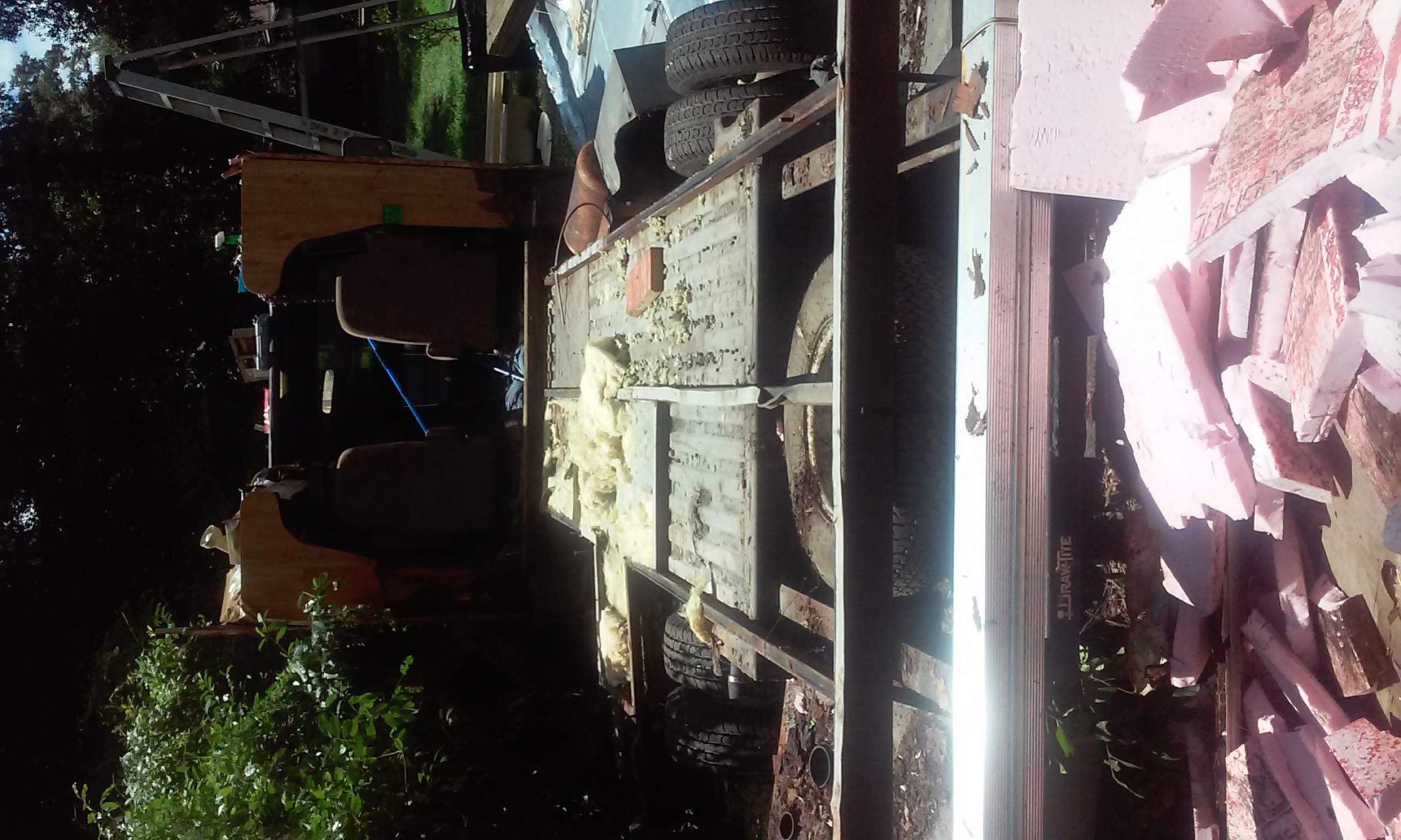

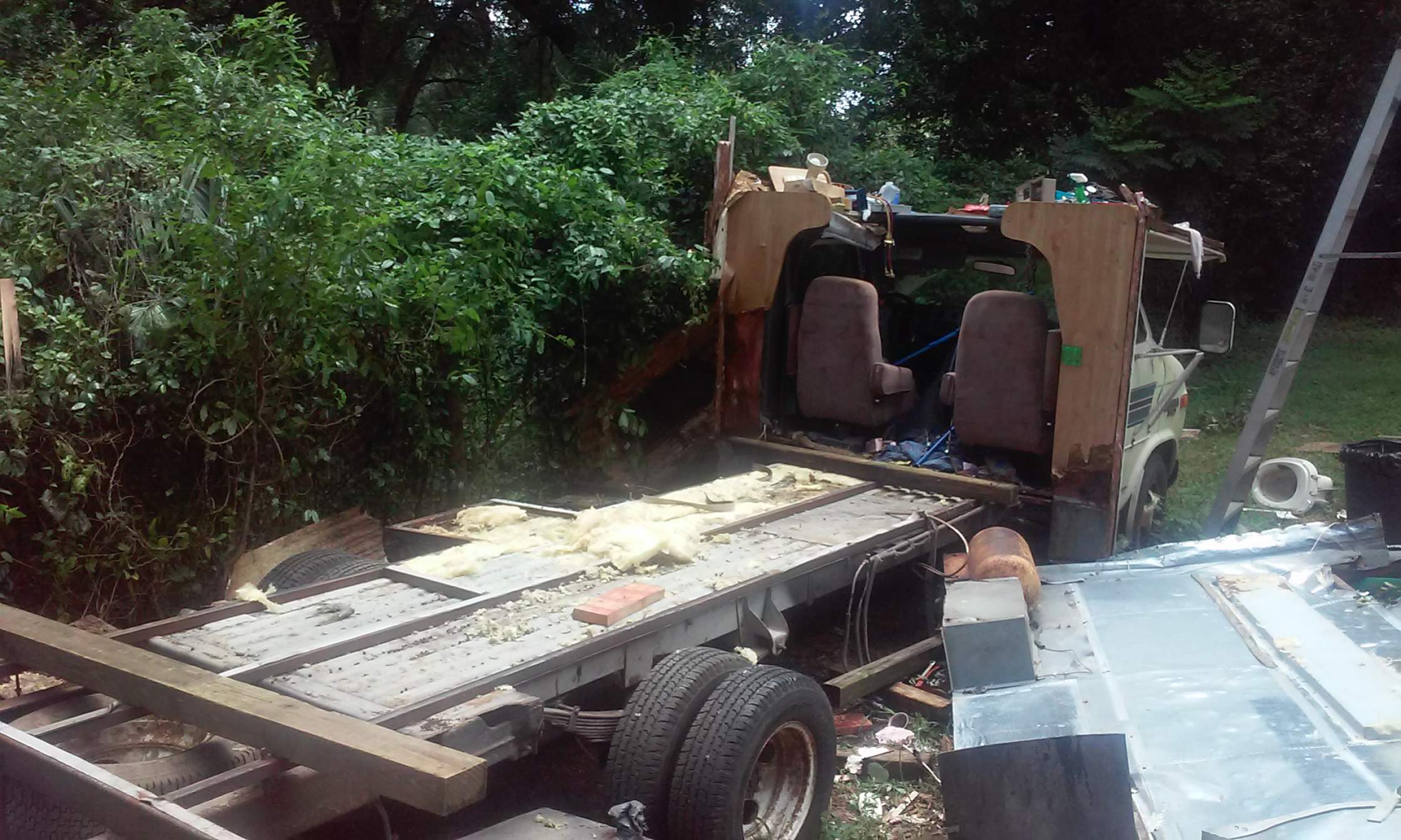

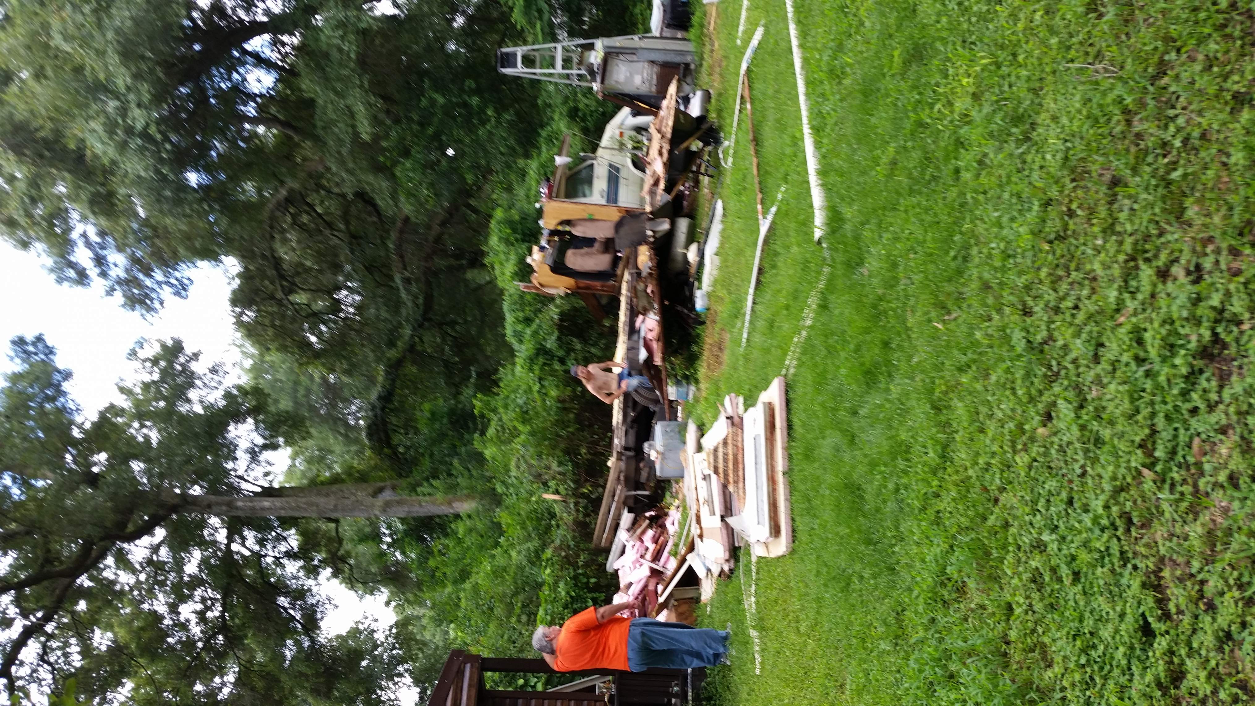

just a little more progress...
It took me 2 days of grinding carrage bolt heads off. I would grind some and then lift on the floor frame with a floor jack to pop the ground bolt heads through and find any that I missed.
but now there is 1 more sub frame welded on. I got my angle grinder ready for that
I found out a couple things...
2 loads to the dump yesterday and maybe 1 more. everything else is burnable or scap metal
the vehicle frame is THICK AS **** and straight. it is right close to 1/4" or 3/8".. no curves behind the cab at all.
and it sure does have alot of springs..
also keep in mind that this is my first 1 ton..

is it a C channel frame or boxed frame?
I just looked and it is a BOX frame. The motorhome company added on a c channel frame on the back about 4 feet long. I just haven't got under it and looked until just now.

It means that the truck had to be extended to fit the camper on it. If you are using the truck in residential and rv camp sites that are tight you might want to shorten and take the C channel off
