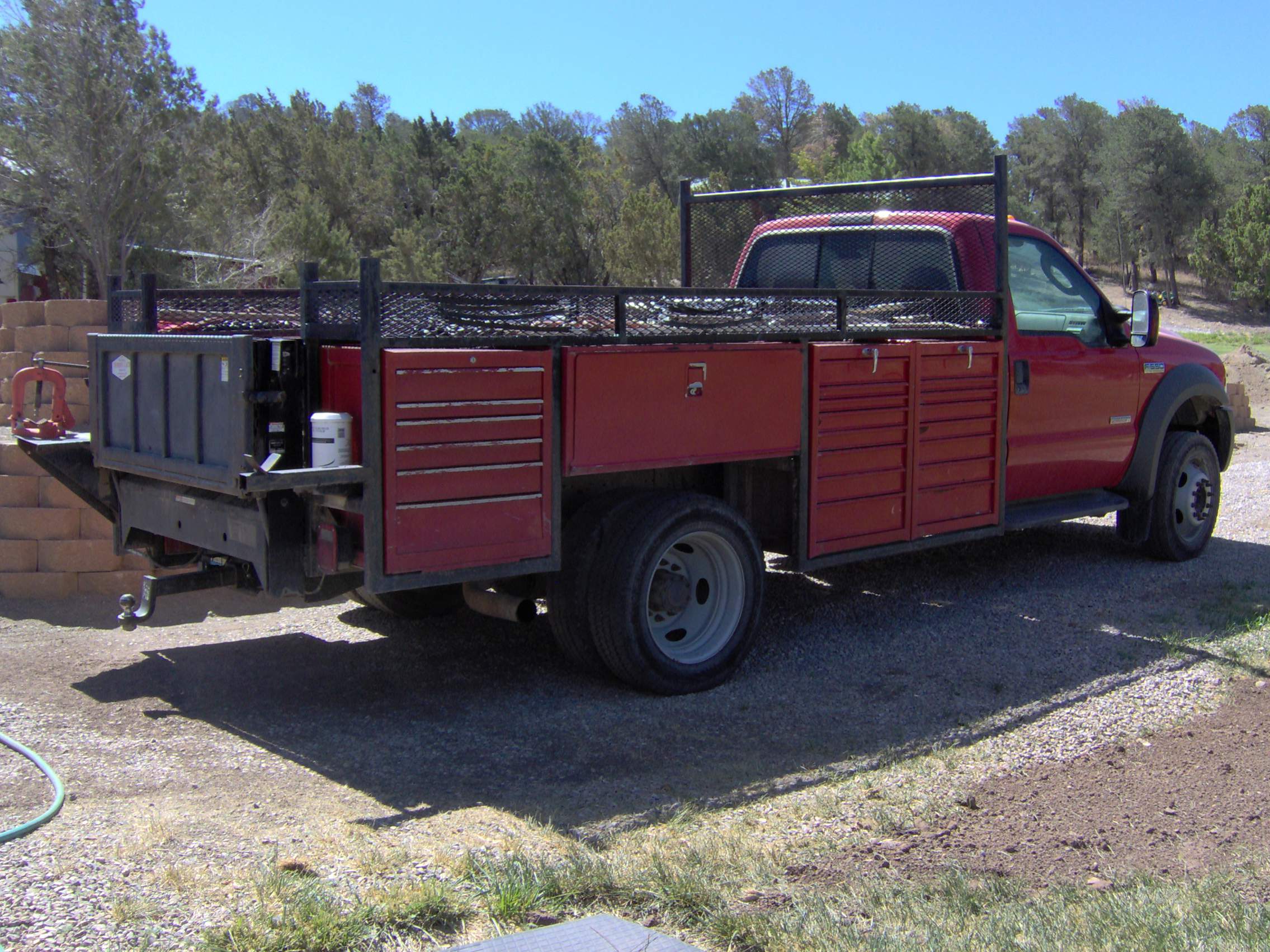

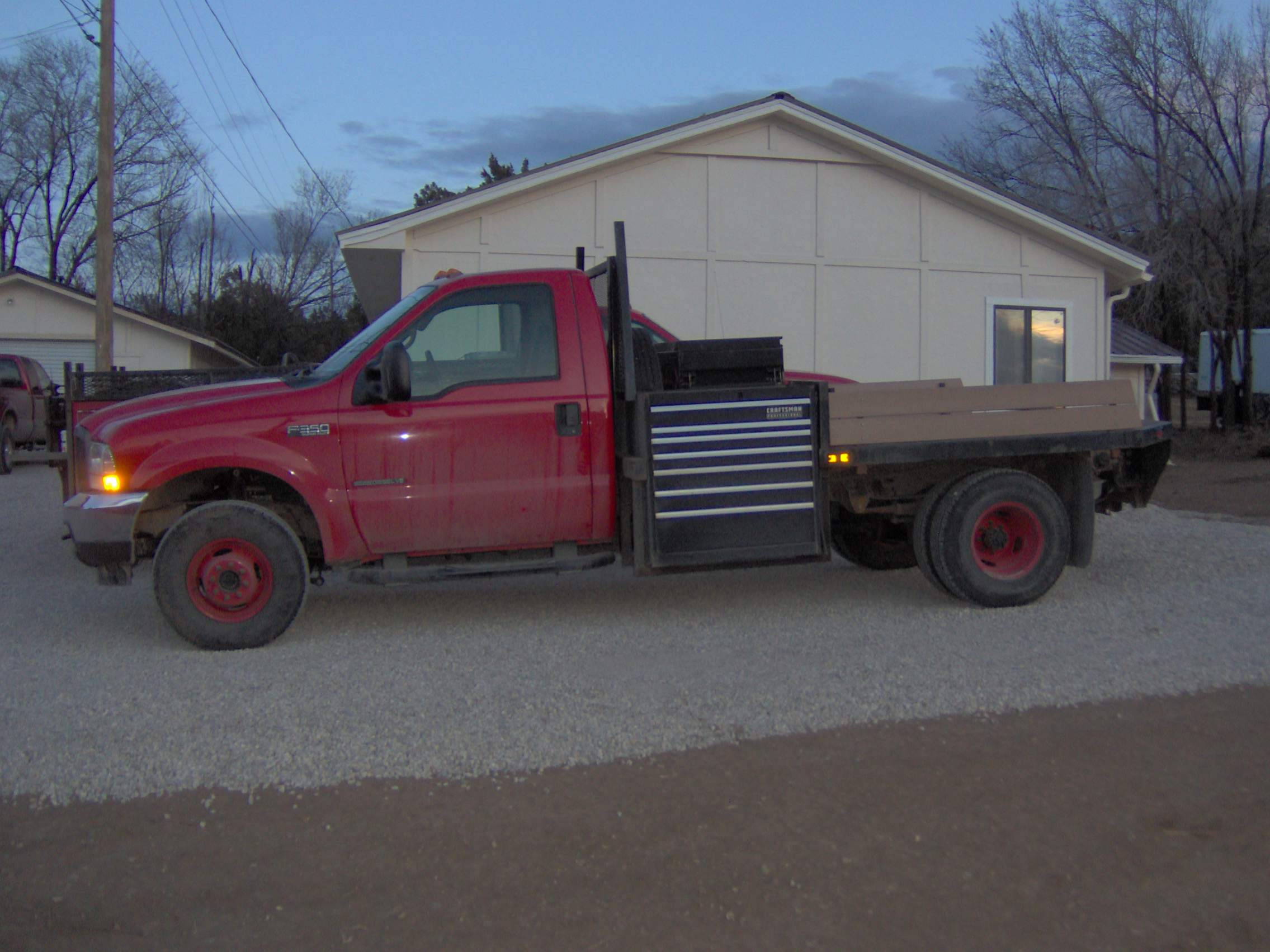

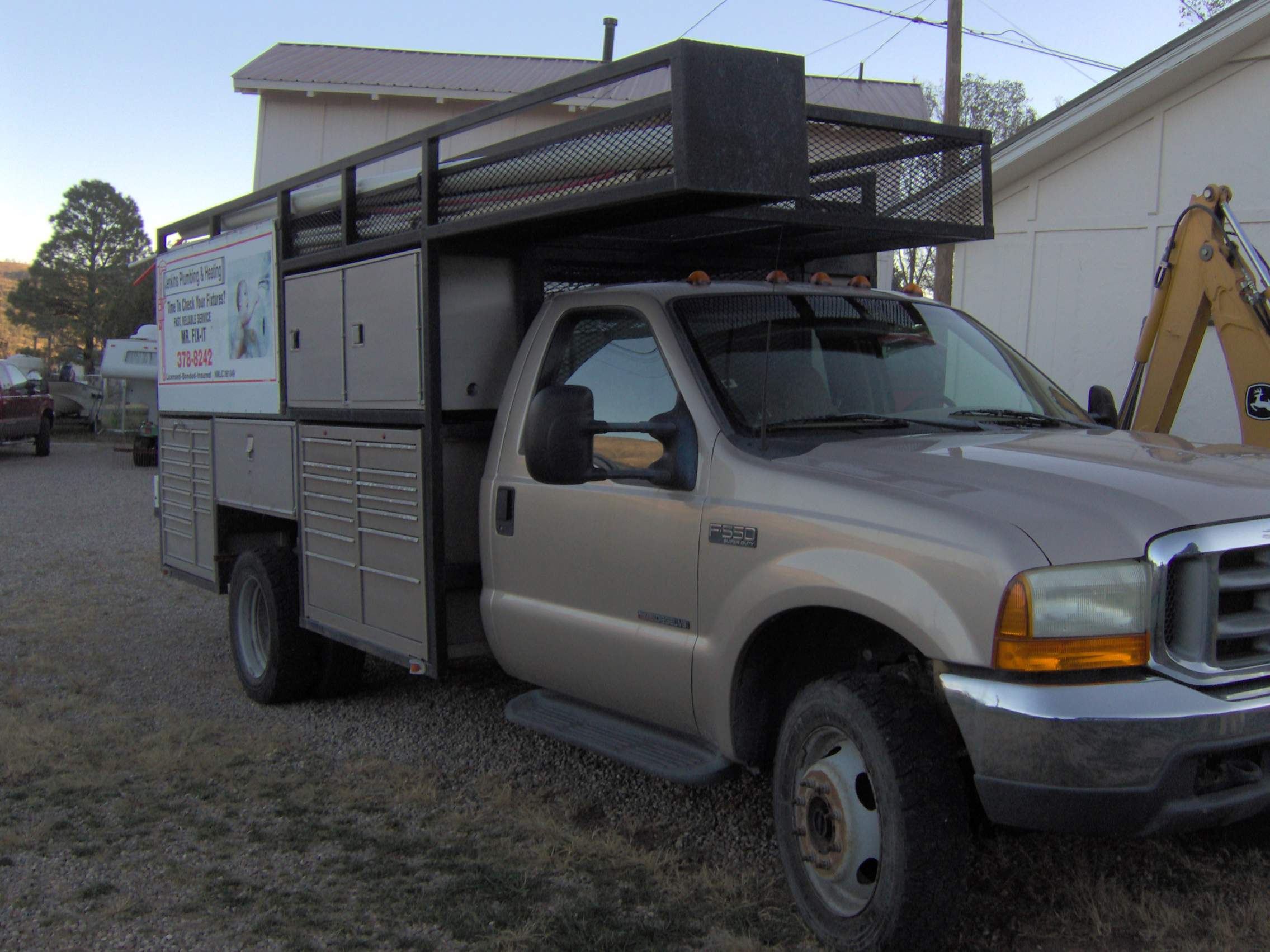

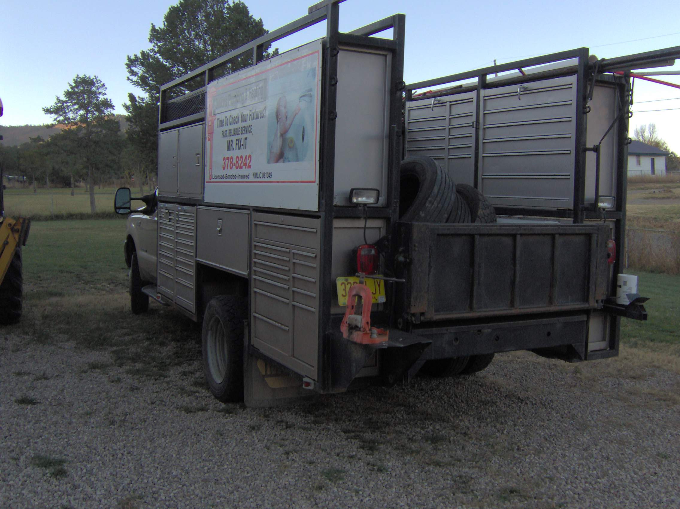

There is no way that a C30 doesn't have a frame strong enough for this project. I would not give up for that reason.
I have built a few truck beds as I got irritated with the utilty bodies offered by suppliers such as Koenig and Knapheide. Not very good for small parts and organization, so I built my own. You can do this.
