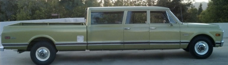

,,,,except with duallies.

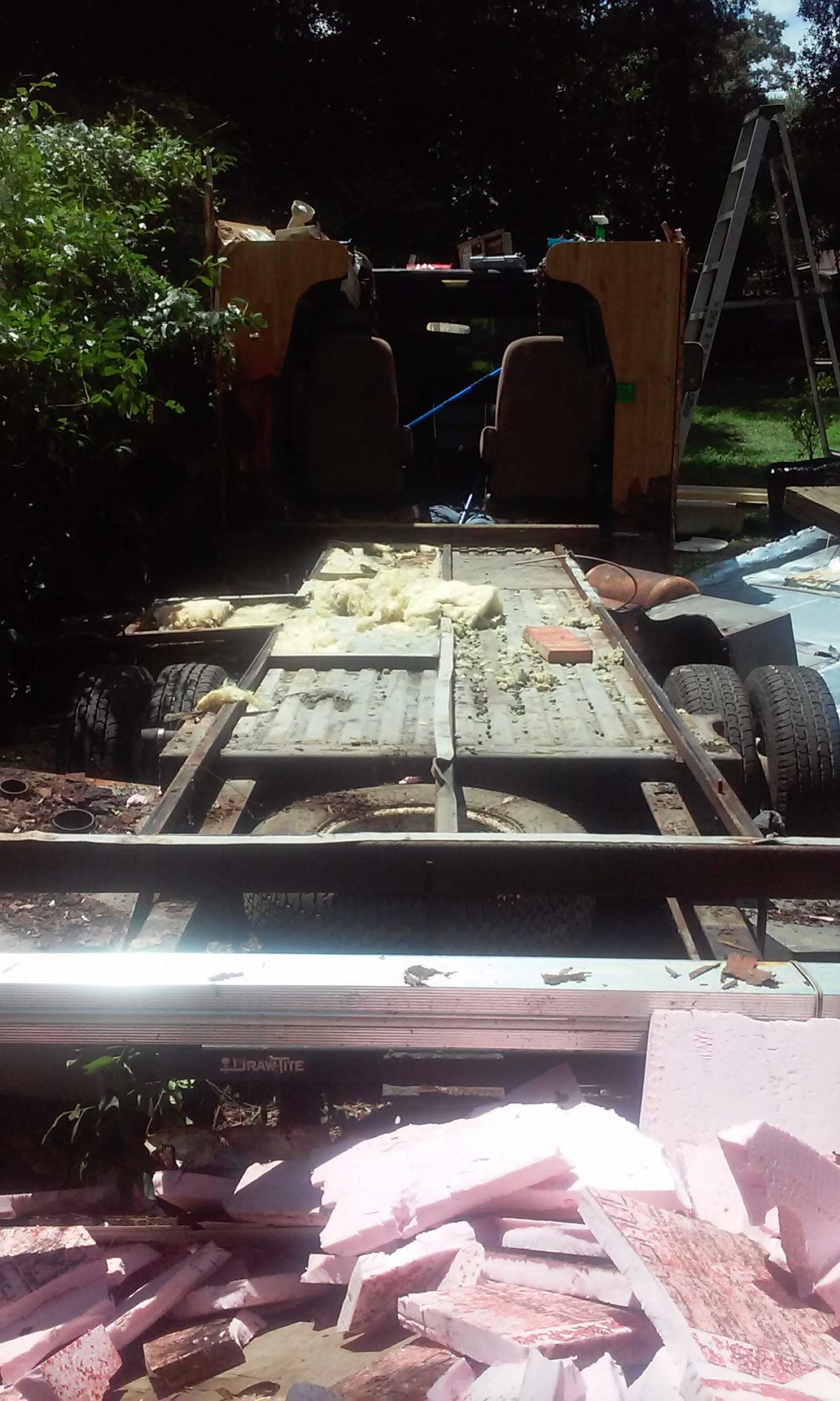

just a little more progress...
It took me 2 days of grinding carrage bolt heads off. I would grind some and then lift on the floor frame with a floor jack to pop the ground bolt heads through and find any that I missed.
but now there is 1 more sub frame welded on. I got my angle grinder ready for that
I found out a couple things...
2 loads to the dump yesterday and maybe 1 more. everything else is burnable or scap metal
the vehicle frame is THICK AS **** and straight. it is right close to 1/4" or 3/8".. no curves behind the cab at all.
and it sure does have alot of springs..
also keep in mind that this is my first 1 ton..

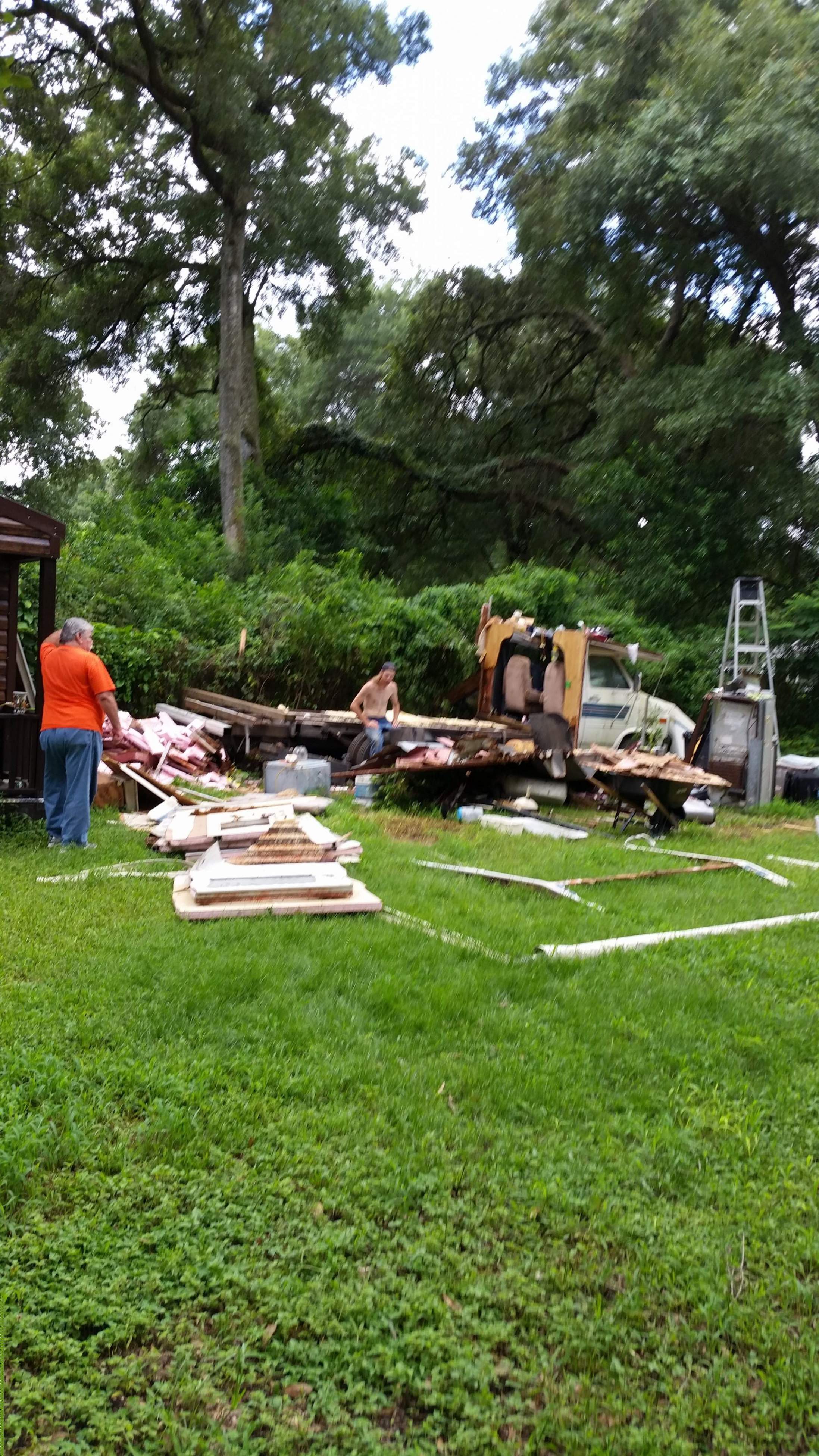

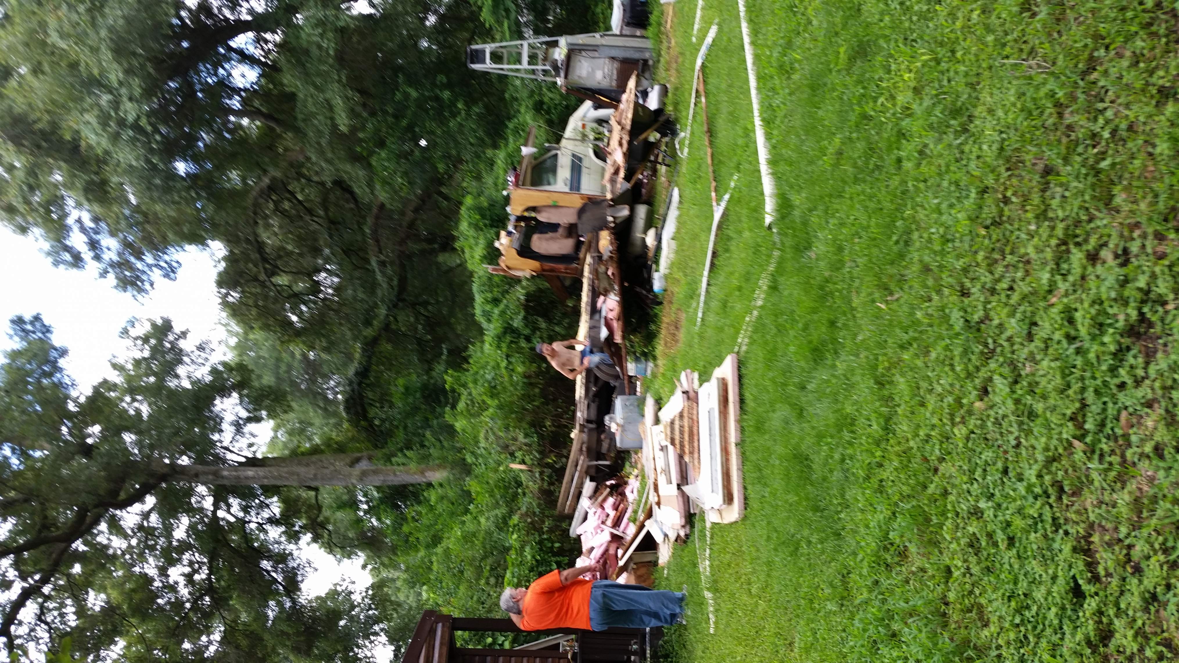

I rotated the last two photos...

thank you for rotating pics, my brother took those. I am the blurry long hair hippy sitting on the tire without a shirt on. It gets REAL hot here in florida. Also we dont have humidity here in florida.. We have steam...
   / motorhome convert to pickup #97
..... I am the blurry long hair hippy sitting on the tire without a shirt on. ...
Could be an episode of 'COPS'. :D
Just kidding. I've often been spotted in that pose looking over the destruction I have just caused. :thumbsup:
