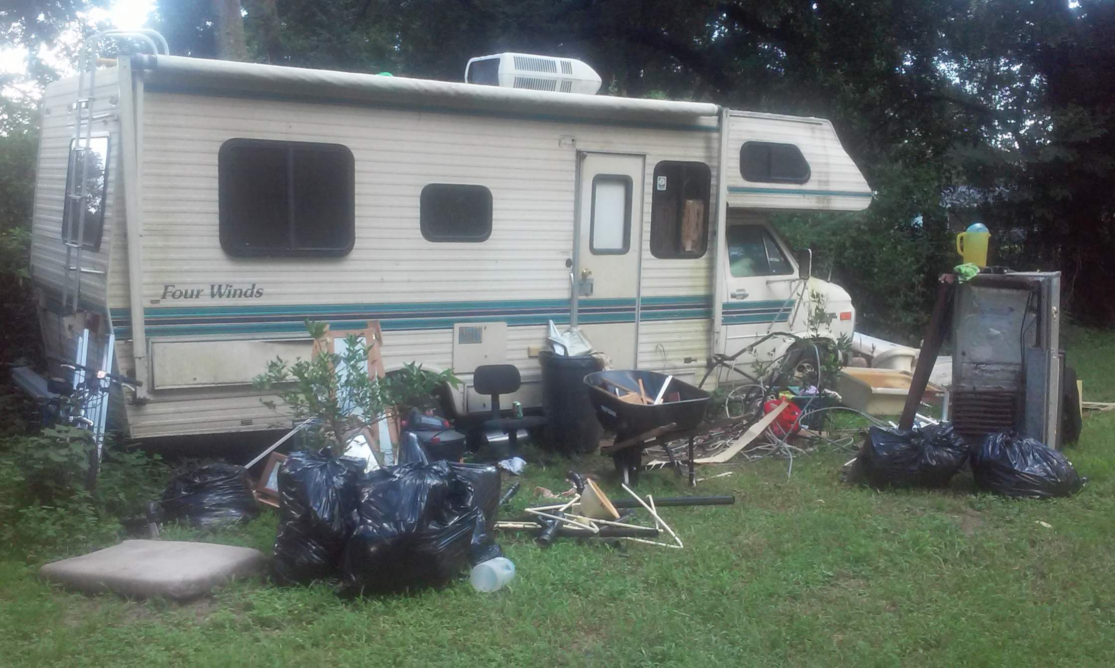

progress update on motor home to pickup project!!!!
now that the Cambodia monsoon jungle rains have stopped here in florida...
tomorrow, I attack the body!!!
Thank you to my brother rodney for helping, even though I had to bribe him with a hunk of cash that might be more than most people make in a day.

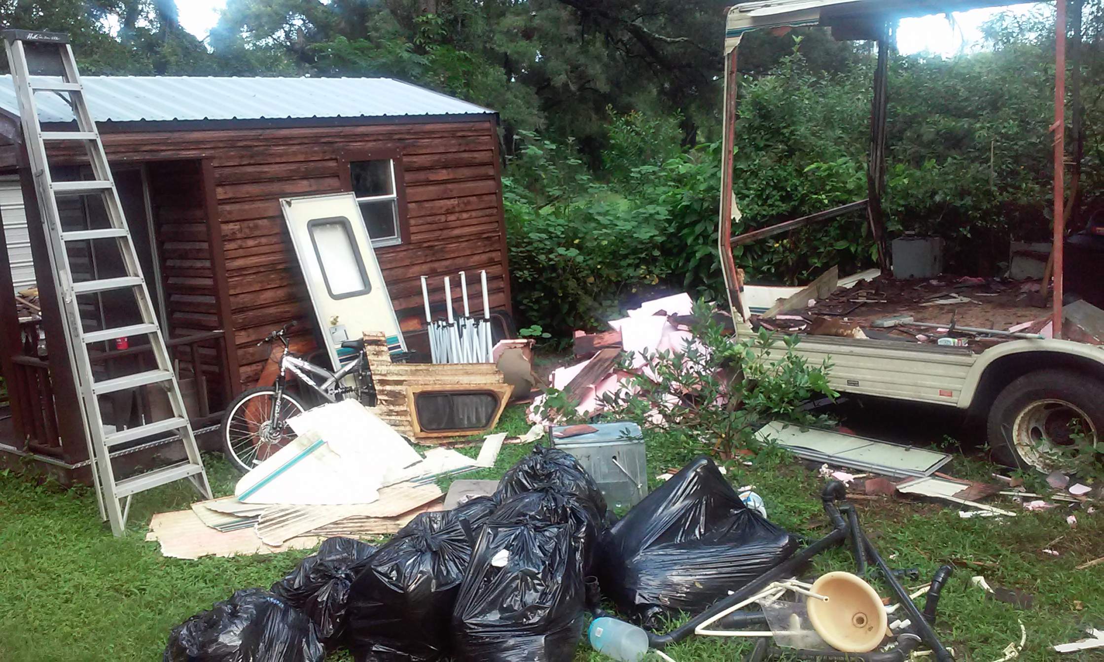

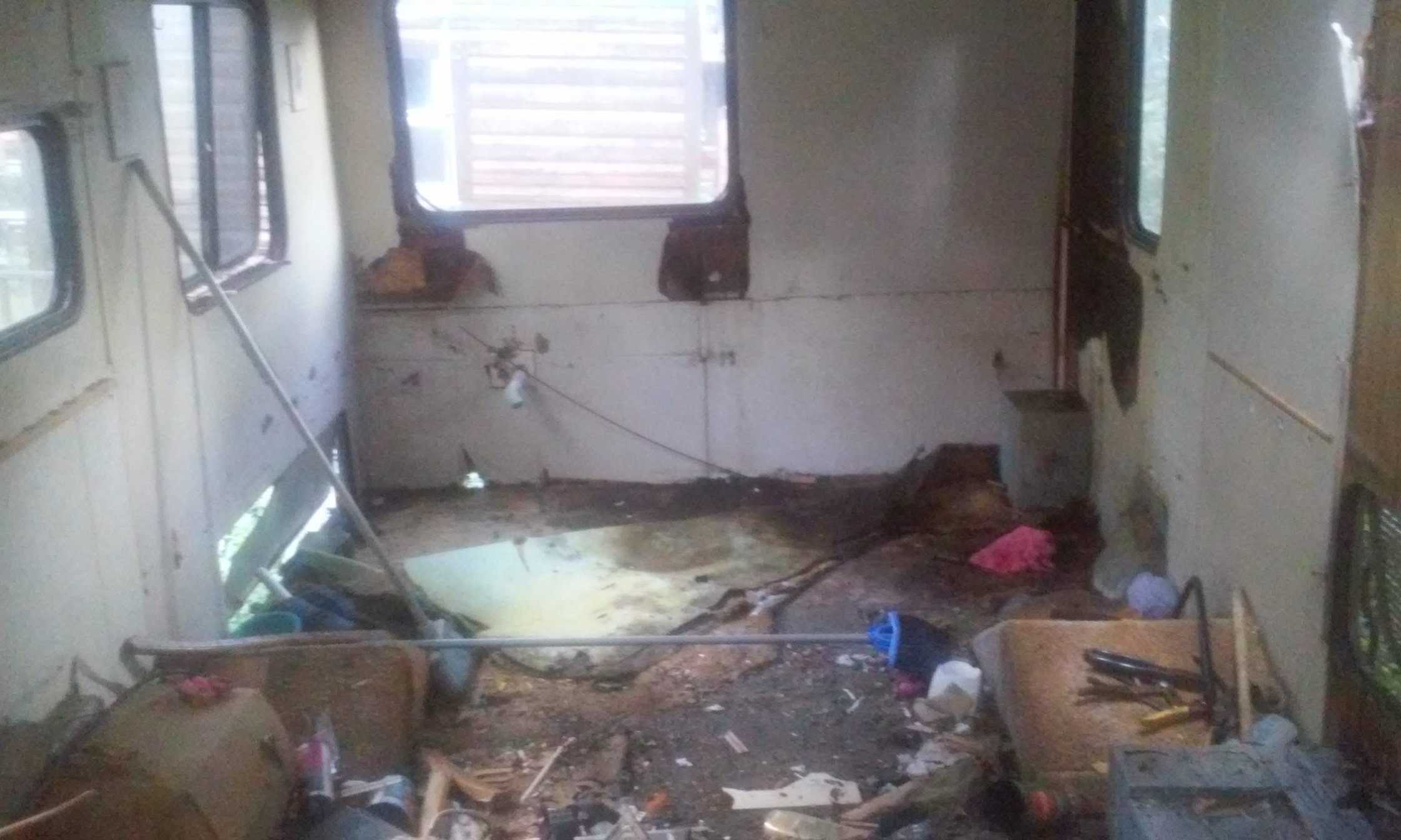

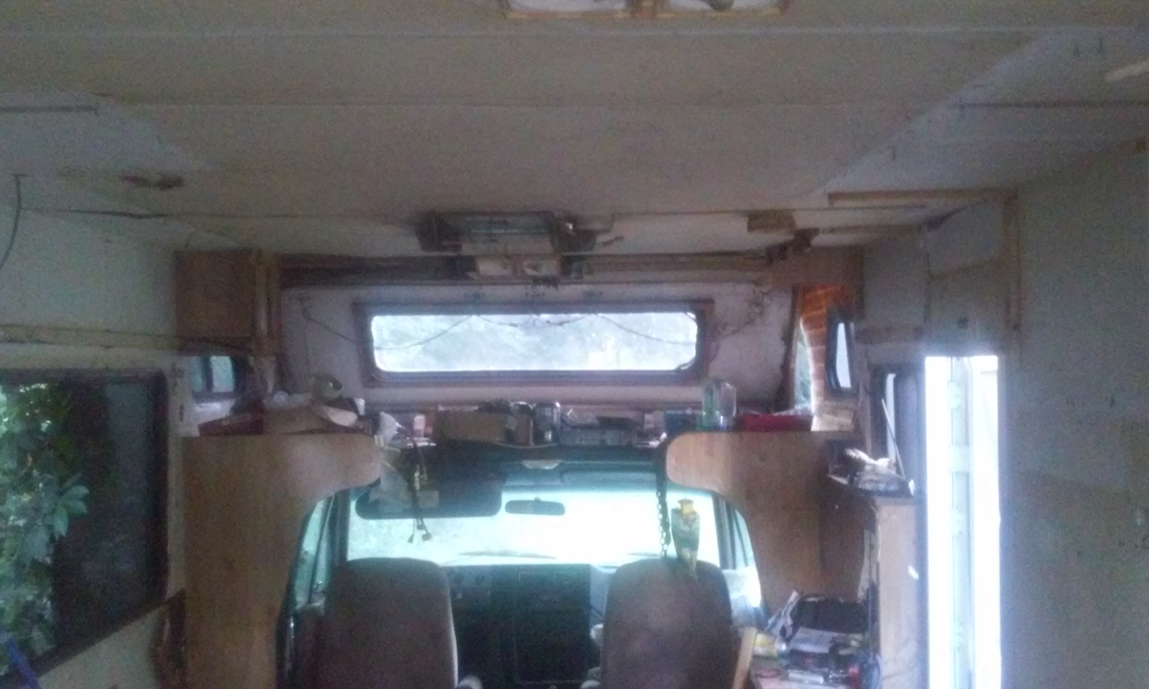

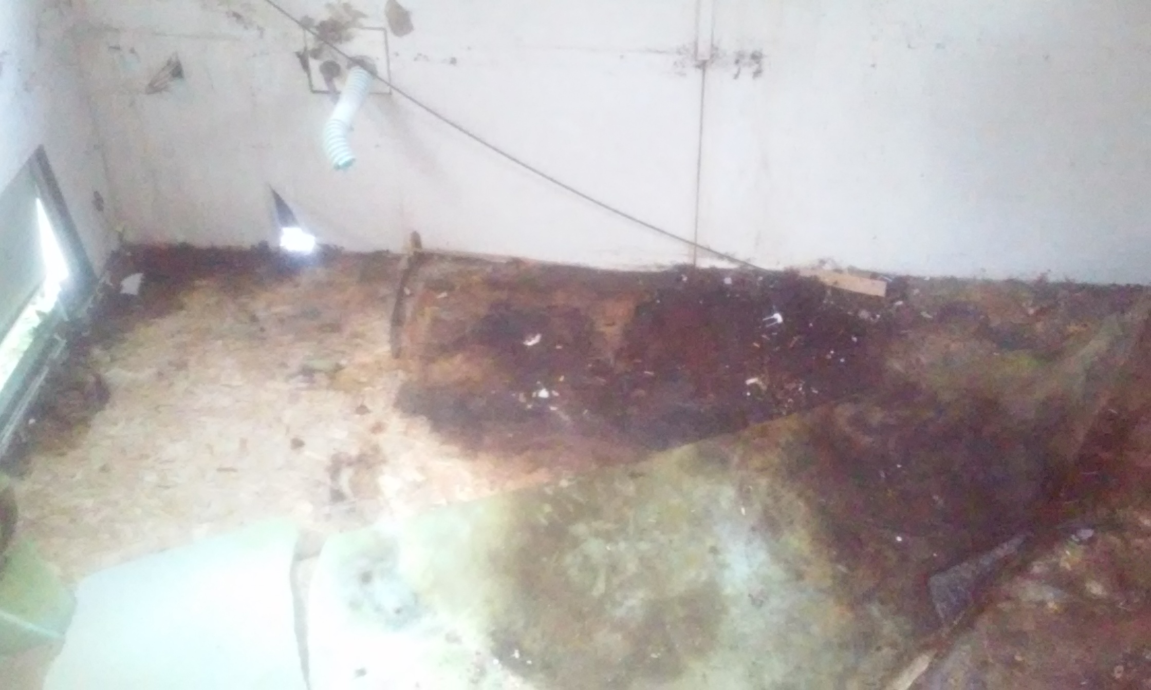

It is really starting to get nasty parts breaking out the walls. lots of mold wet wood and ants...
why am I doing this again??
oh yeah!!! I am getting a 3500!!!! yay.. go me! go me! go me!...

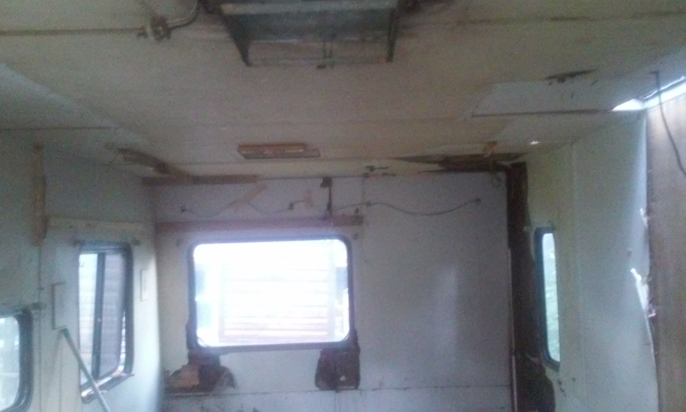

I got all the windows out and the door off and I found the body is made by welded aluminum frames. there is 1 framework for the roof, and 1 for each of the 3 walls. and each panel framework is welded together but the 4 panels are not welded together. just glued like everything else. I started pulling and I had 1 whole side of in less than a minute because when the material gets wet, the sprayed on glue FAILS.
I should have taken the roof off first because now the walls a wobbly and the ac is still up there.
I will put up some more pics if it stops raining so I can take the camera out.

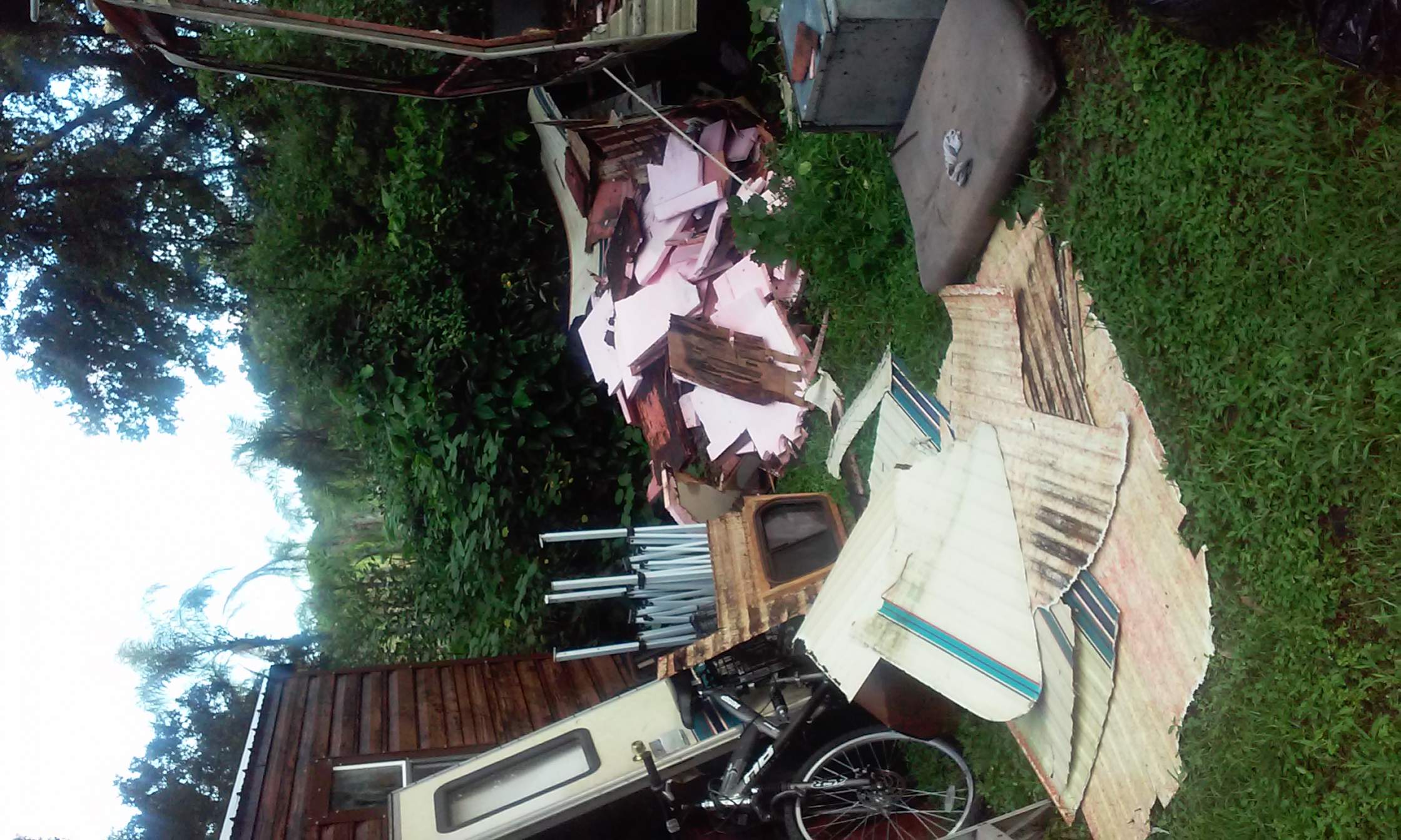

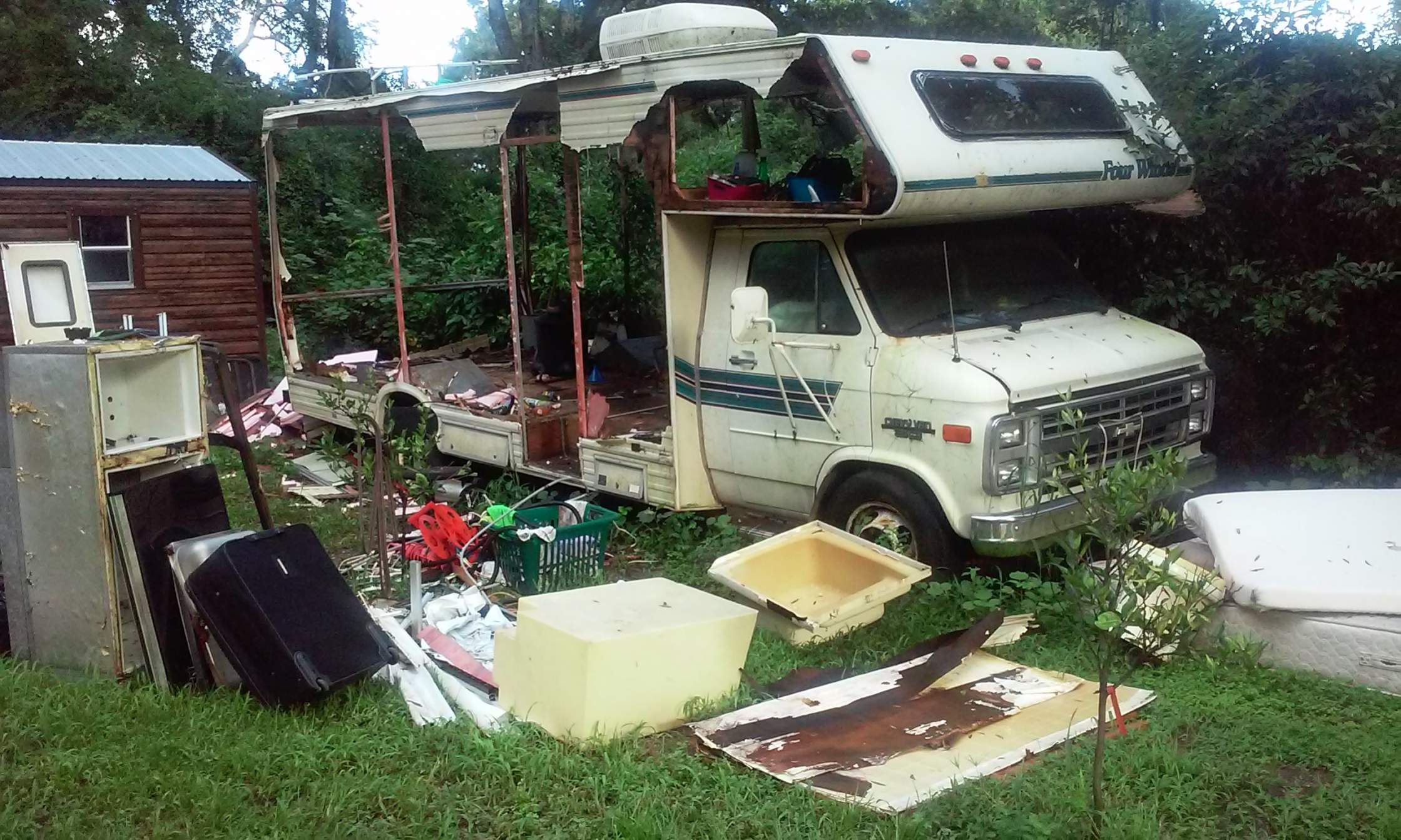

just making the windows a little bigger here.

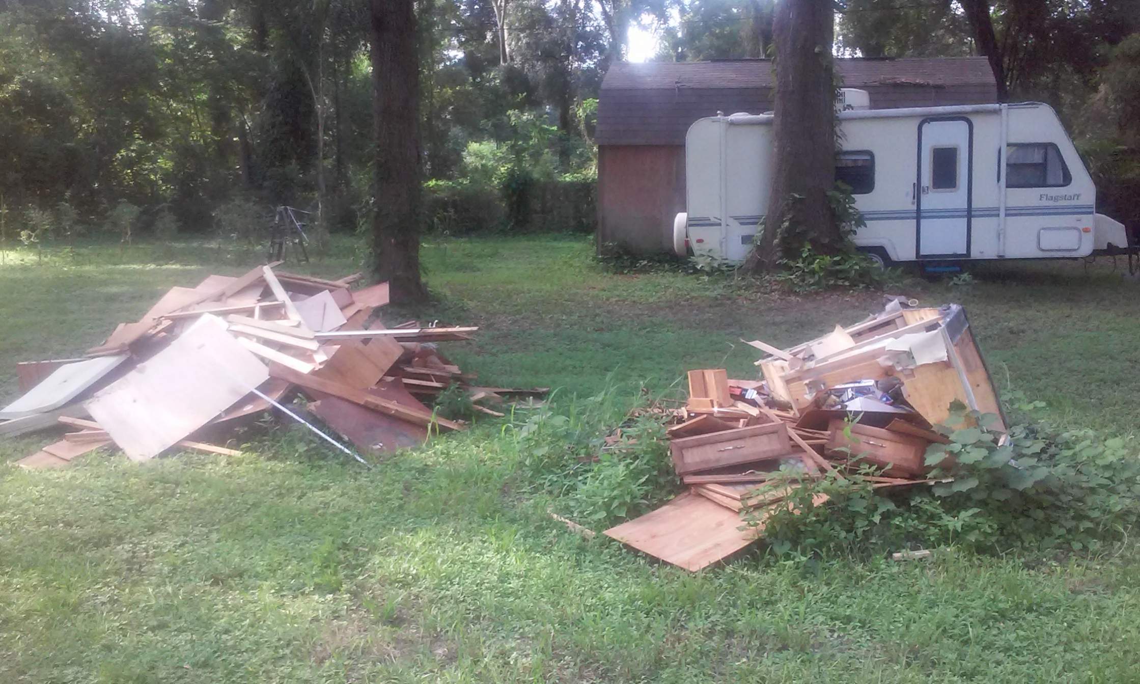

sorting out the crap.. insulation, plastic, fiberglass wall panels, windows, and misc garbage.
most of the wood is burnt up now in the fire pit.
not to long now, I should have a truck-ish vehicle... of some sort.

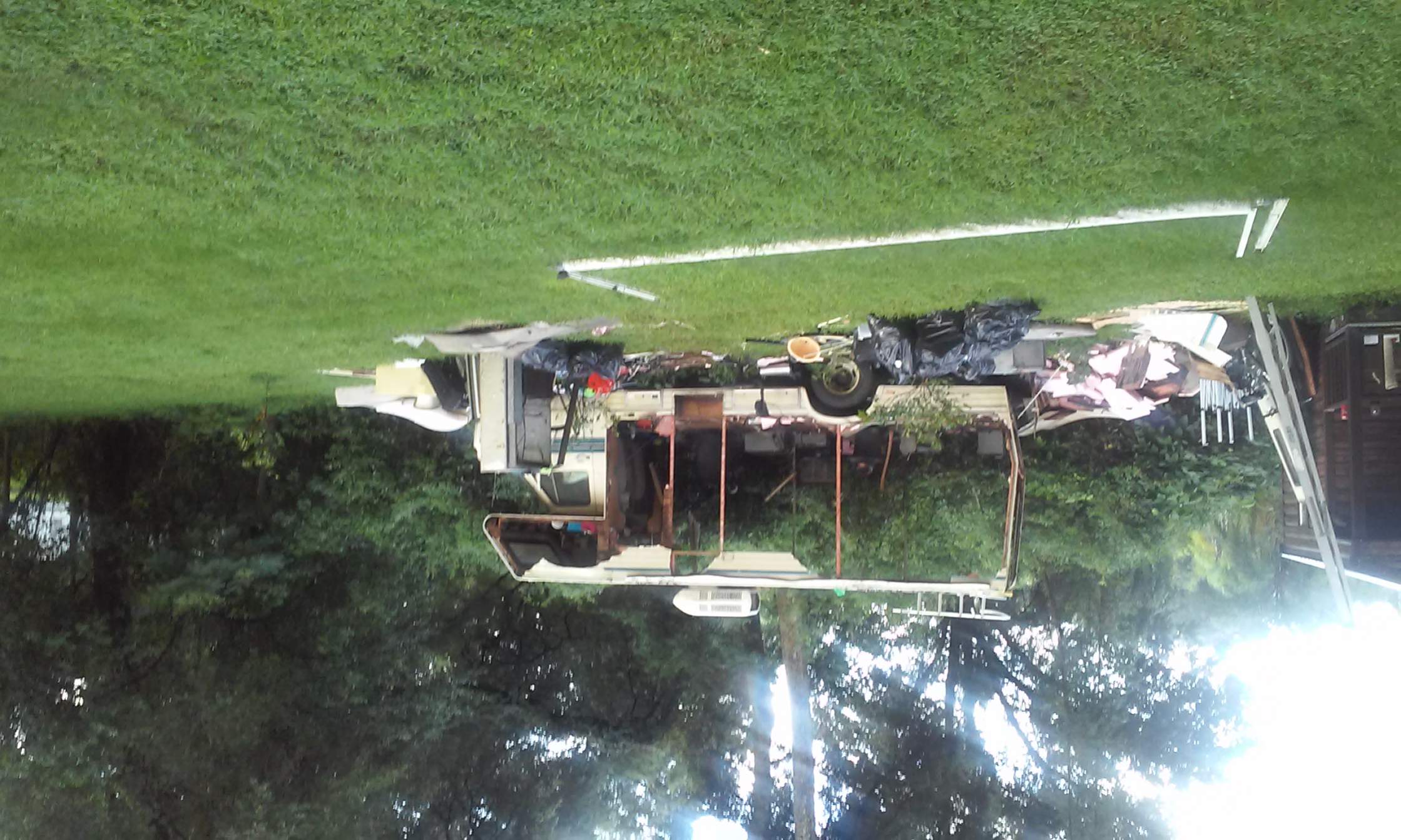

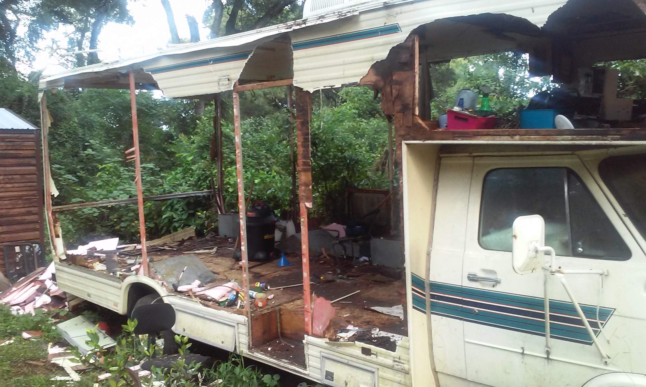

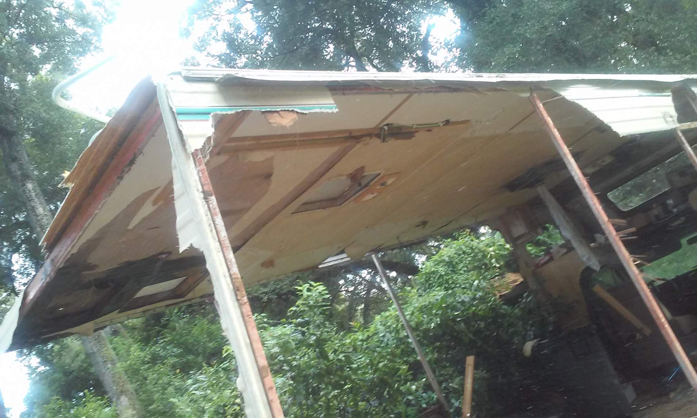

day 1 of demo was sledge and 3' prybar for inside
day 2 was axe and 2 foot prybar for outside walls.
today will be sawzaw for the roof and above the cab.
my brother said I should use the metal frame work to build the bed. he does not understand how thin that stuff is an I want to haul more than light weight tree limbs.
I need pickup bed or hauler bed.
