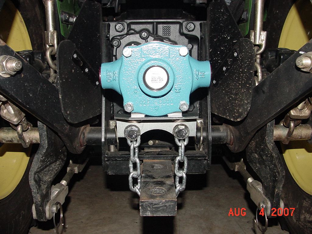

My 4 roller sprayer pump, same thing but different:
Edit: For some reason I can get it to show as a thumbnail like usual??
   / Mounting a PTO hydraulic pump #6
Agree with Rick. The bearings on the pump don't want to be constrained. Since the whole rig will want to wobble a bit, you should let it.
