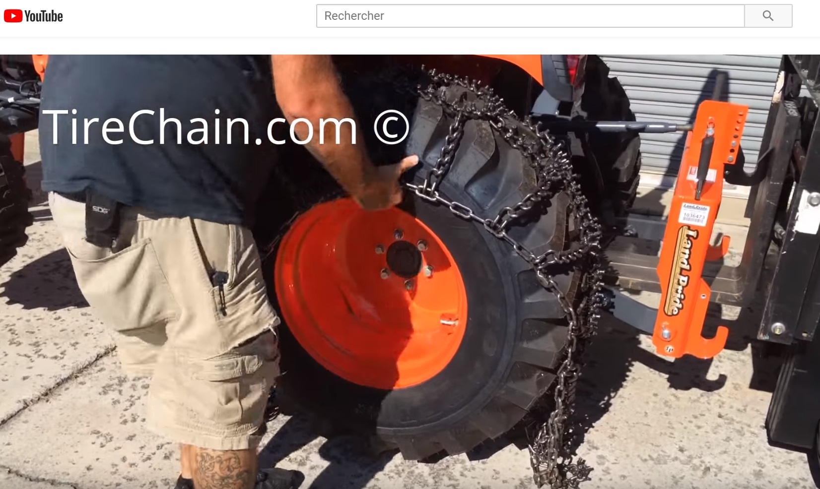

I always want my fasteners at the bottom of the tire. Let gravity pull the slack.
That works fine if you have a smooth tire like a R3 or passenger car tire but with R1 or R4 tires the cross links always get hung up in the lugs and you have to manually keep lifting the chain and making sure it is straight and even.

Letting the tractor pull them up and around there is no slack to fight with.
That's what makes it easy.
/ Mounting tire chains #46
^^^^ This is key to the method Lou uses. I think those who haven't tried it may be missing this point. And like jgayman said it makes chaining up R1's and R4's a breeze.
EXACTLY! I just drive them on and clip them together. No need for adjusting or retightening.
