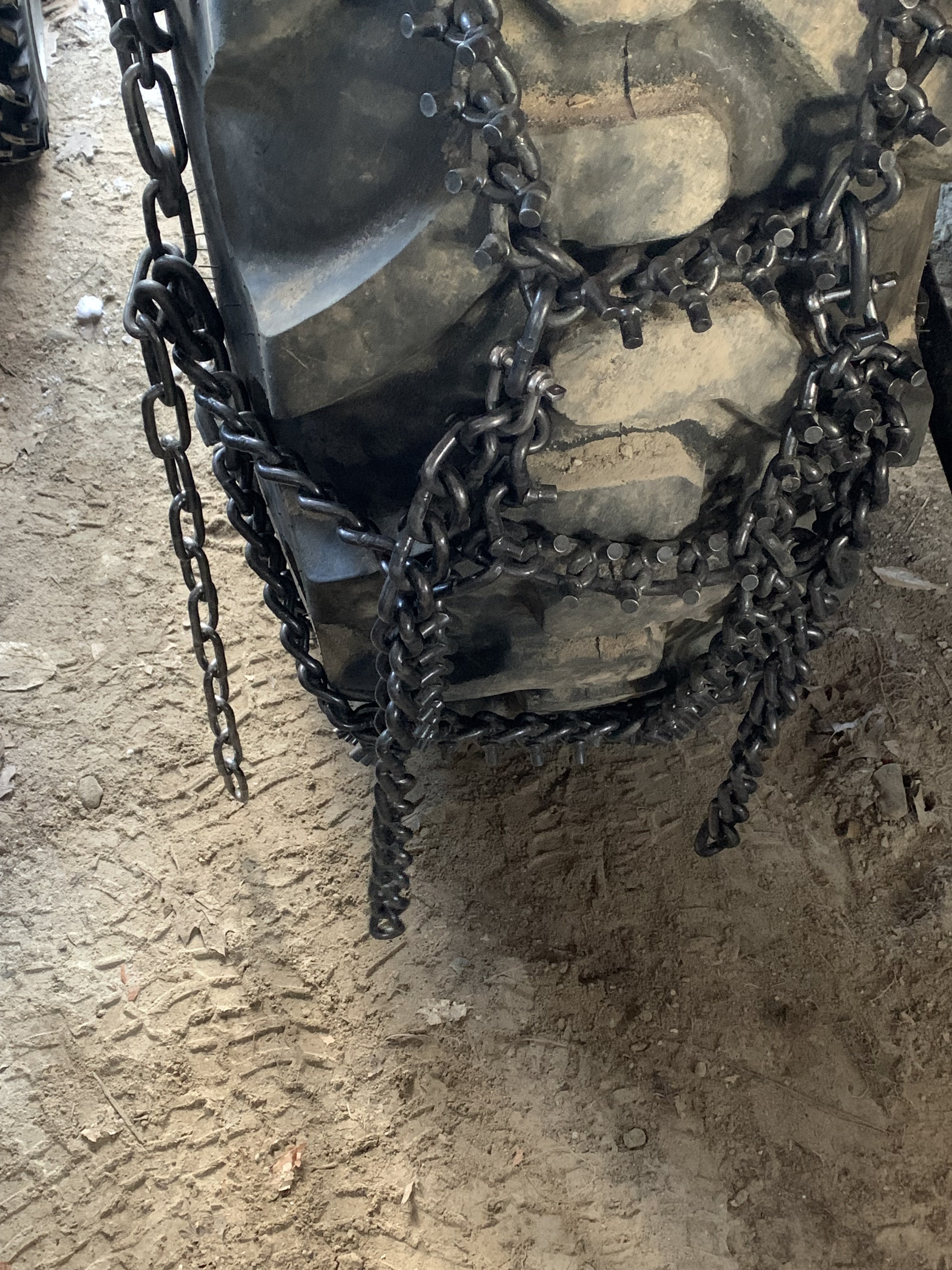

I’m putting on my new tire chains for the first time and have a question. There is a lot of slack chain left and I haven’t even rolled a bit to readjust them. Is this normal? Should I cut some of that extra length off or zip tie the excess etc.?
They are Aquiline Talons 16.9 - 24.
Are R-1 Ag tires a little larger circumference?

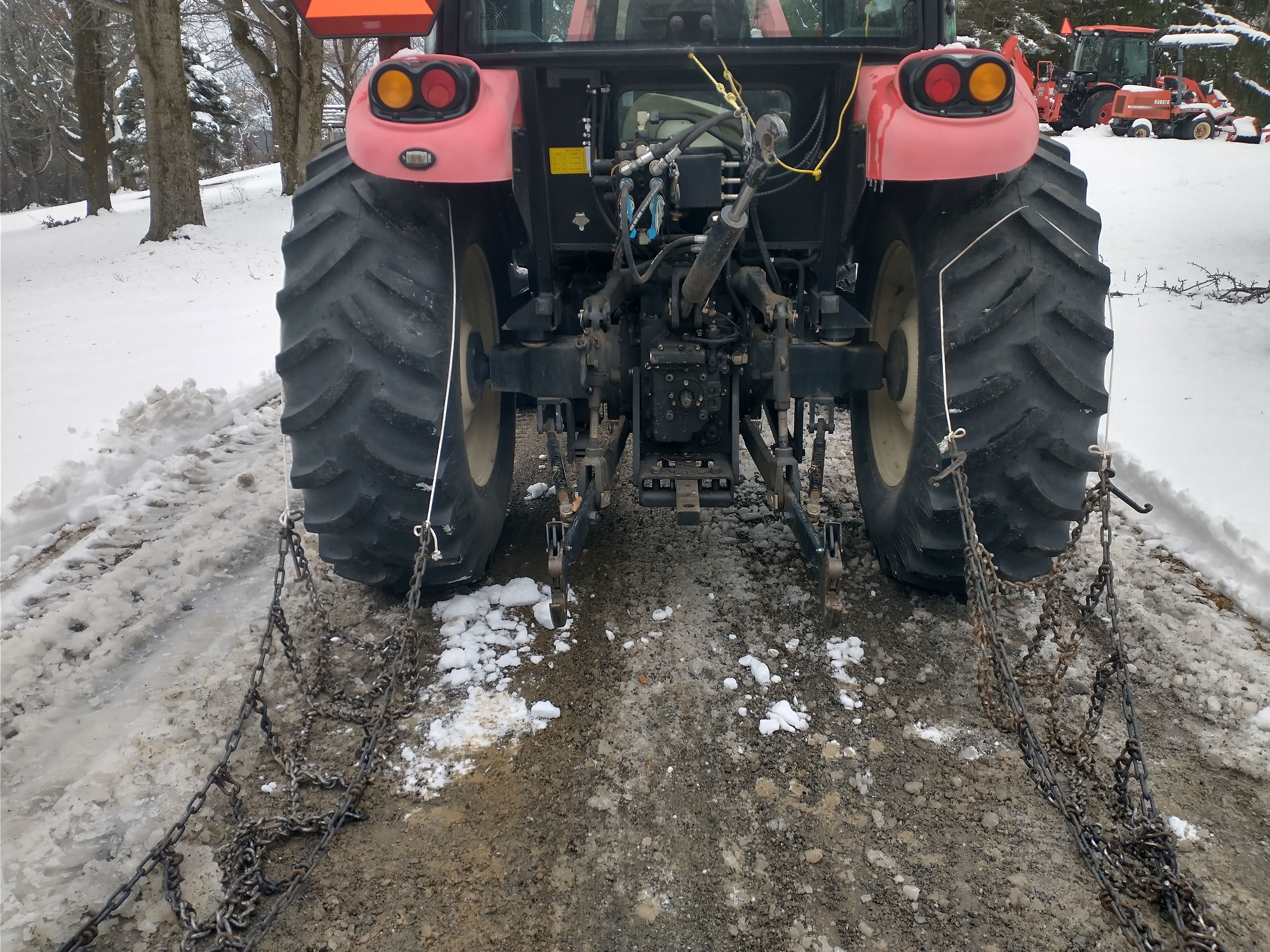

Here they are with the ropes tied to the chains just below the side chain fasteners with the studs facing up.

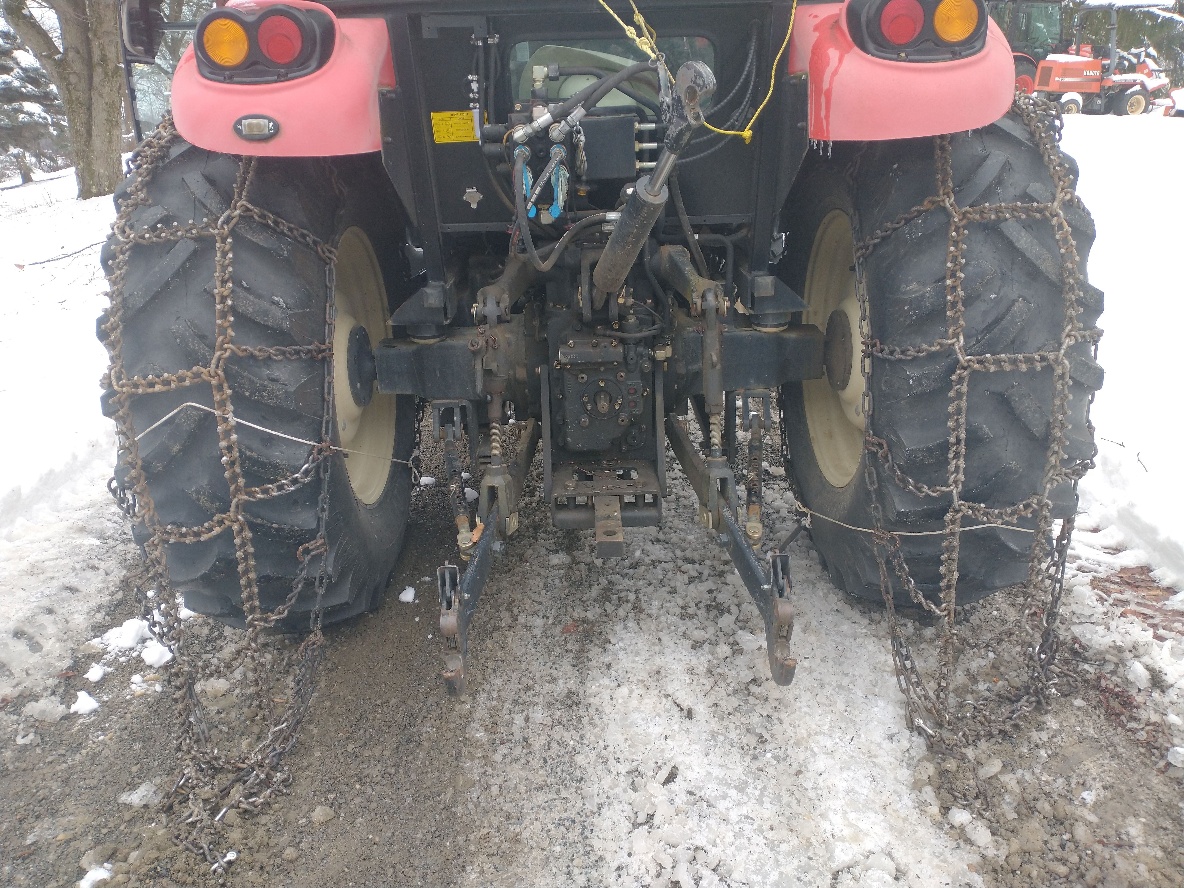

Here I have moved the tractor almost a full revolution of the rear tires, stopping and centering the chains over the tires every couple of feet.

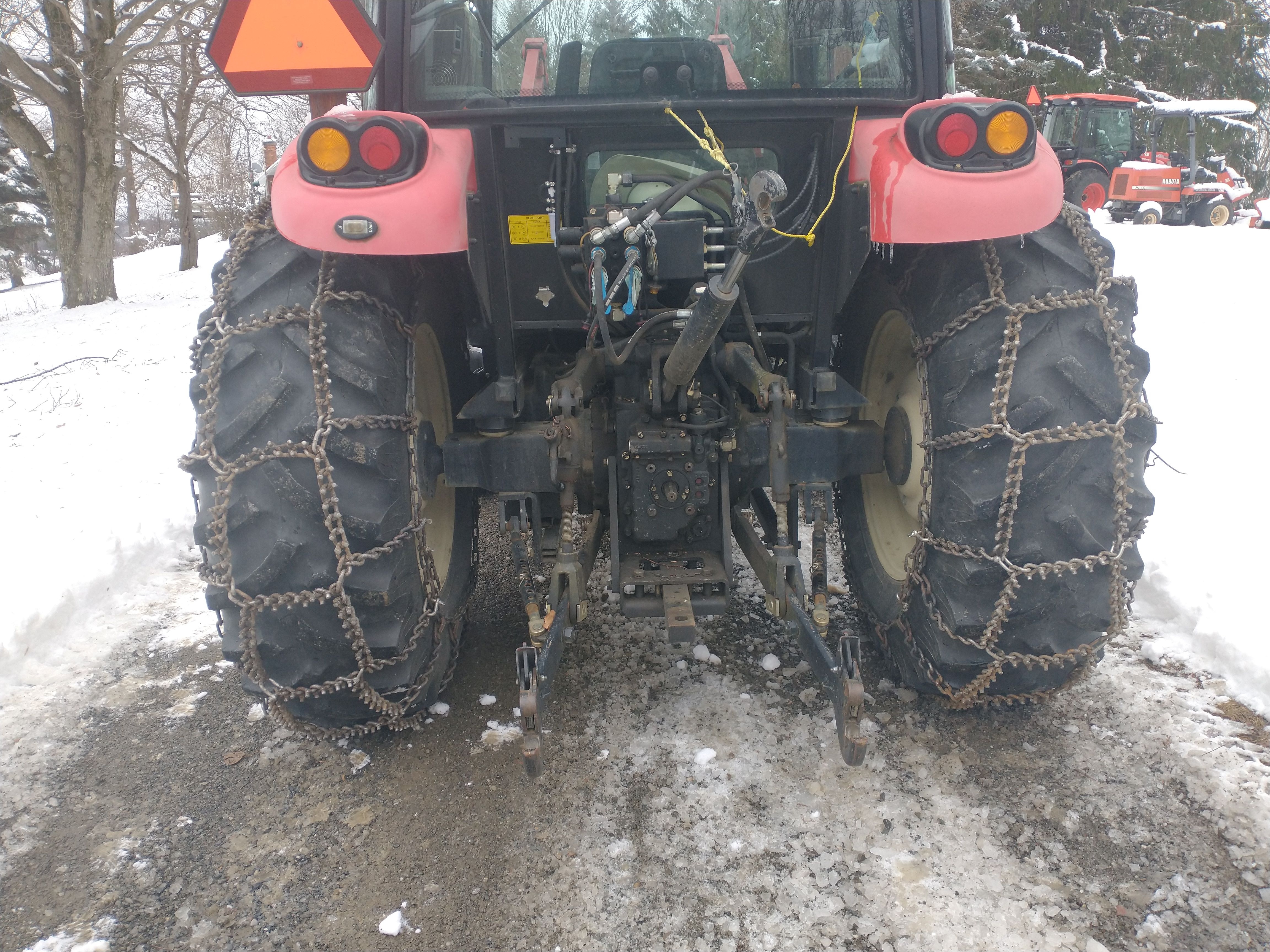

Here we are fastening the center chains, I use D ring shackles to connct everything, just pulling the centers together by hand. On the left side you can see the shackles waiting to be fastened. Just be sure when you are done fastening the chains together that they are the number of links on the center sections. Then when you fasten the side chains be sure that they are the same length doing this keeps the chains square and even on the tire and they will stay on much better if not they will tend to try and walk off the tire.

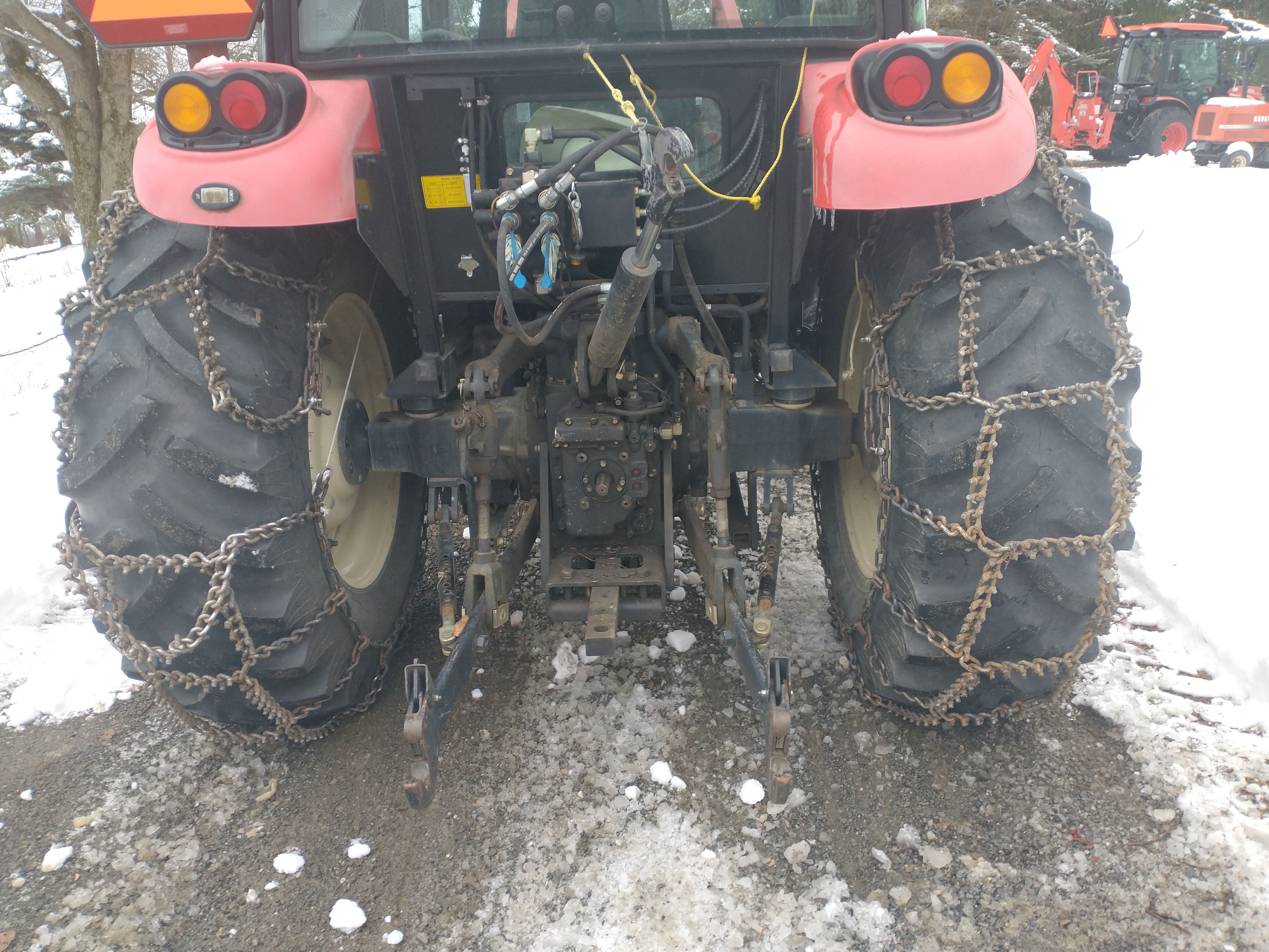

Rear chains on, I ran them up and down the driveway checking them at each end. I use shackles for all connections and to hold the excess side links to the side chains
If you zoom this picture you can see the shackles.
Good luck
Good luck

They are not setup correctly but having said that, the hanging ends are supposed to be shackled to the Side Chains. See my first picture. At the 9:00 position of the tire, see the shackle on the side chain. I have same style. Mine are made by Trygg/Nosted (of Norway).
On mine, they were designed for a few different size tires. Because of that, they send these half link pieces and a guide telling you where to install. You istall these once and there after, thr chains fit great. You have way too much cross chain left. When done correctly, that H pattern should look the same all the way around.
Using the half links as shown in my instruction, made the chains fit so well i do not use any tighteners.

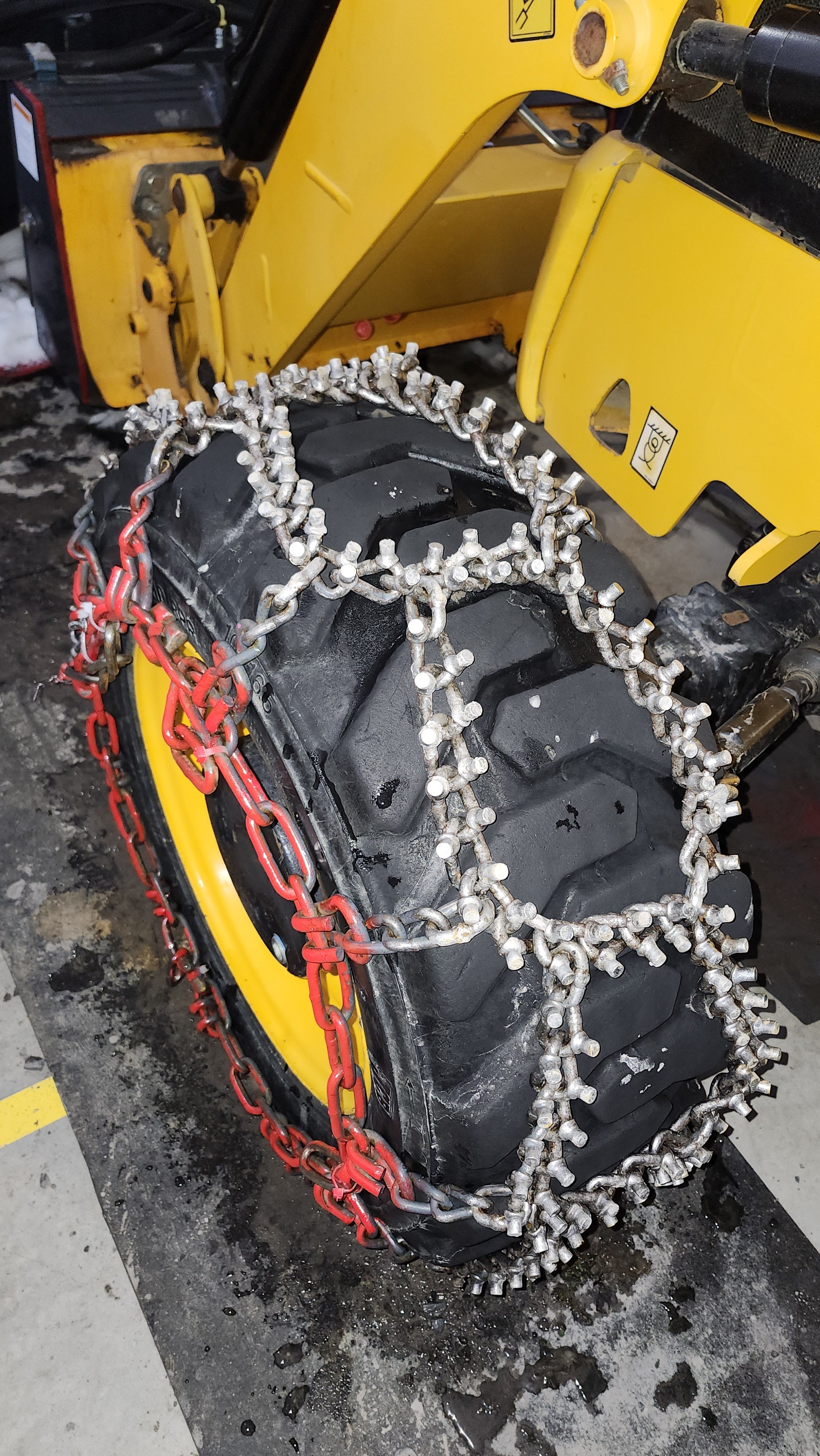

This shows the side chain adjustment.
