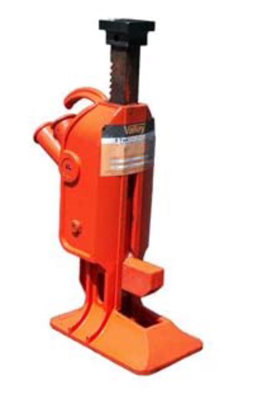

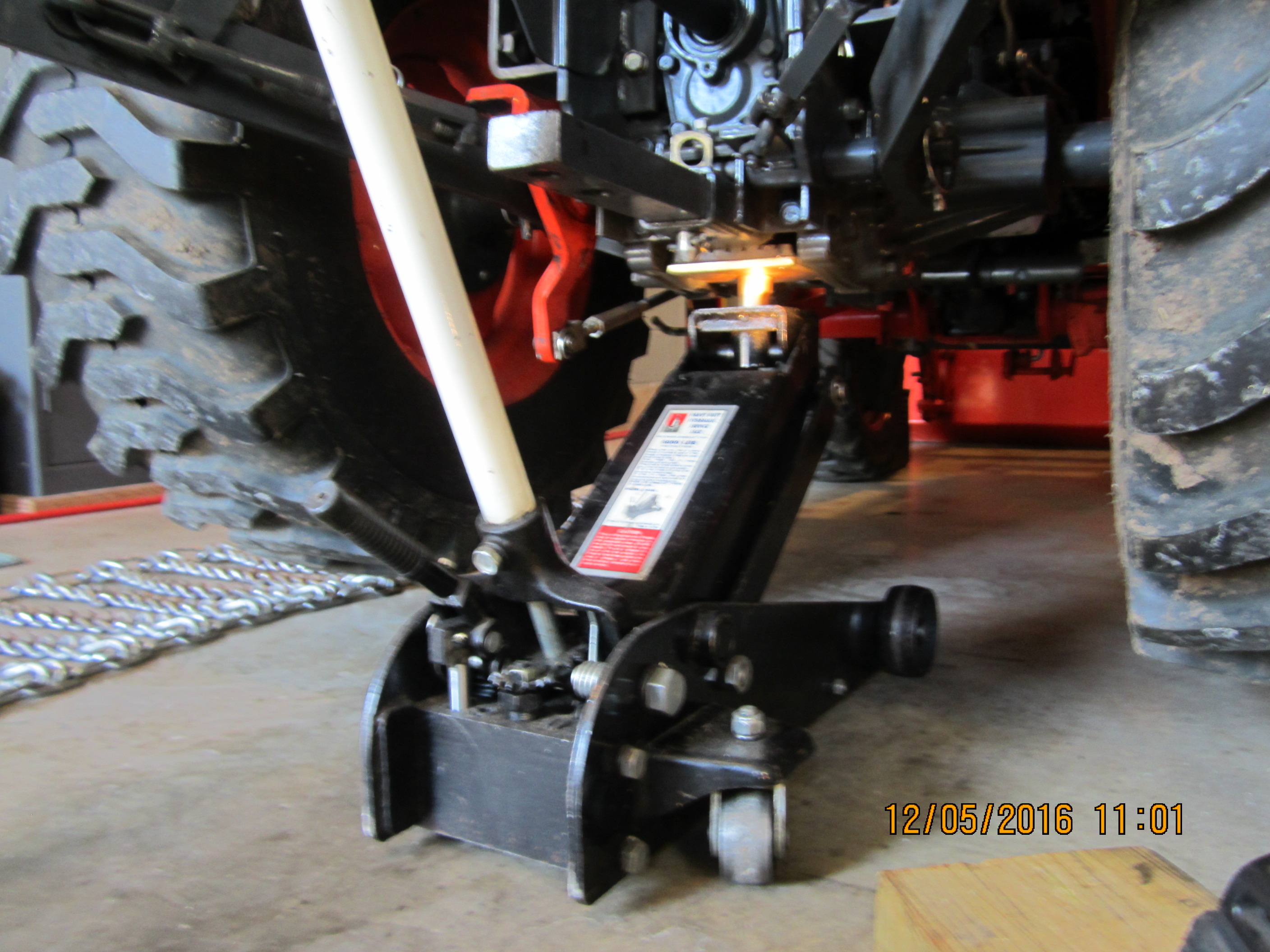

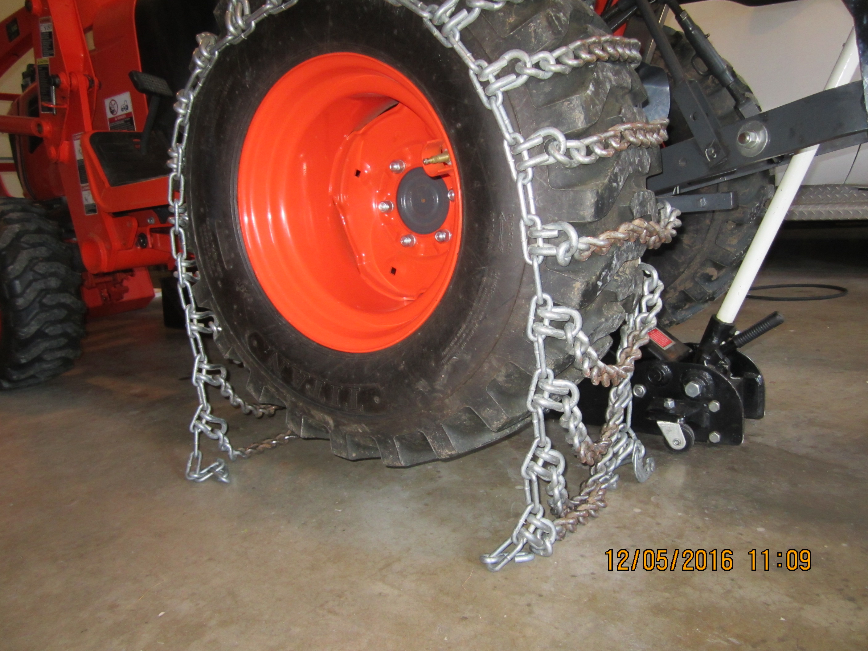

Thanks LouNY for posting your pics to help us out with a new idea. I'm on my tenth year of mounting chains and have made notes to myself and am getting better at it. I use the jack method now and find it not so difficult or frustrating. My happiest experience is to mount the chains and then never have enough snow that season to get in it.:D
Cheers,
MikeView attachment 579293View attachment 579294
That's my method also.
I generally use a bungee cord to hold the chain as I manually rotate a wheel to wrap the chain on then clip the inner followed by the outer.
Due to minimal fender clearance I also need inner and outer binders.
LOL, this year my jack bit the dust so I had to use a bottle jack.

I can't seem to visualize why you specify laying the chains out with the outside down.
   / Mounting tire chains #105
because when you pick them up to lay them on top of the tire, the part that was facing down on the ground will now be facing up on the tire.
