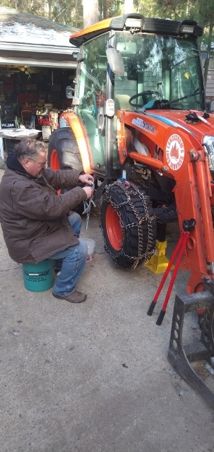

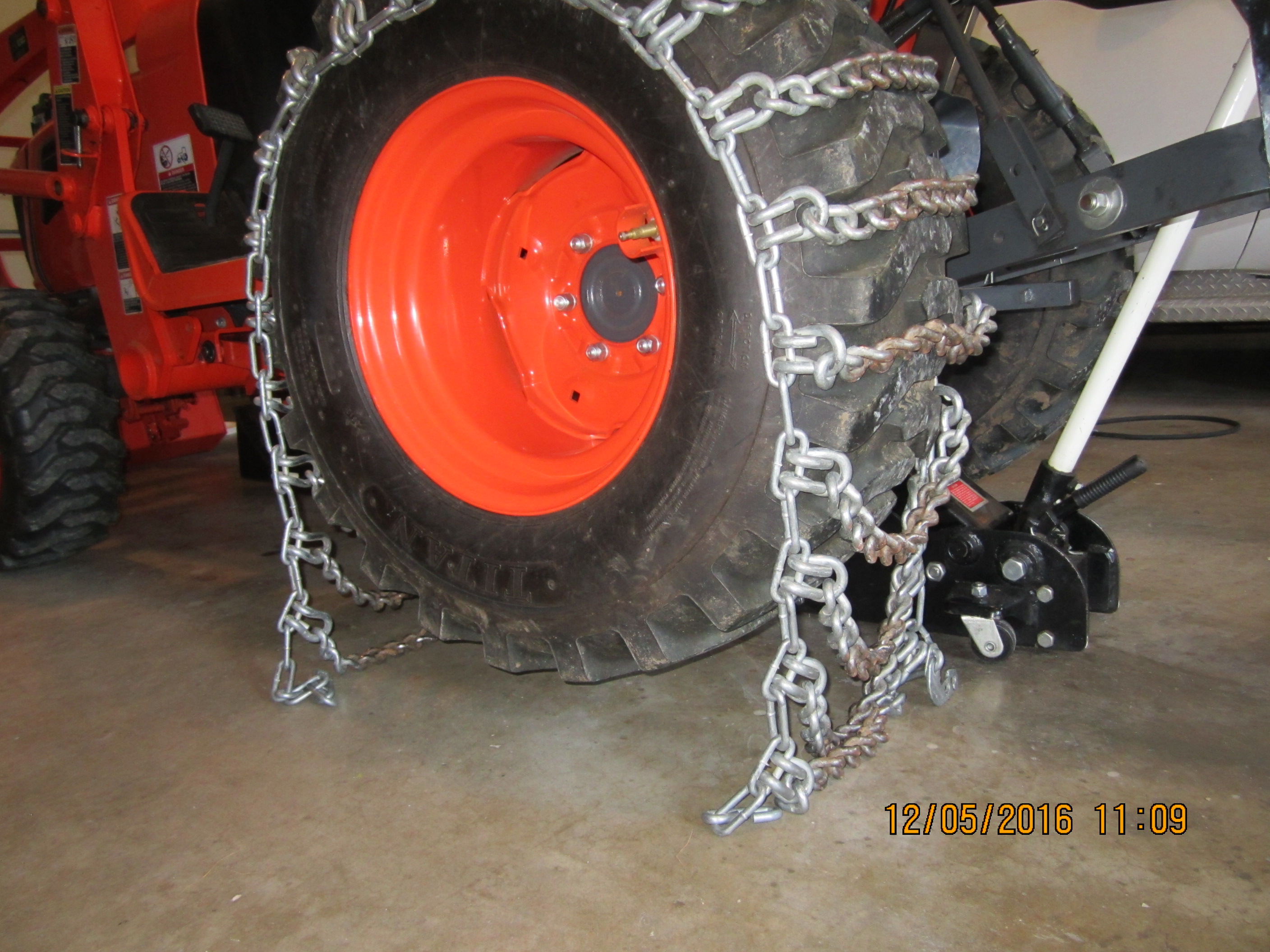

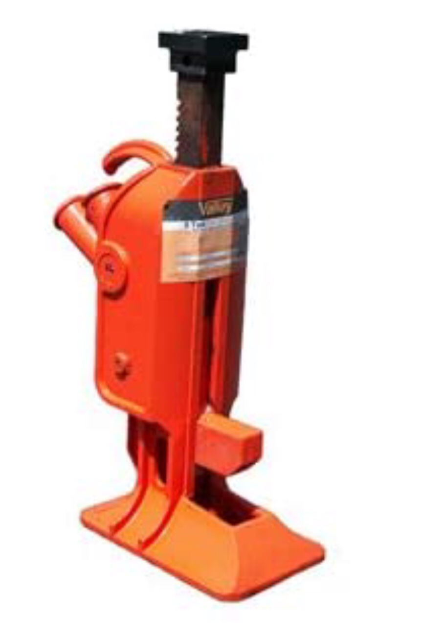

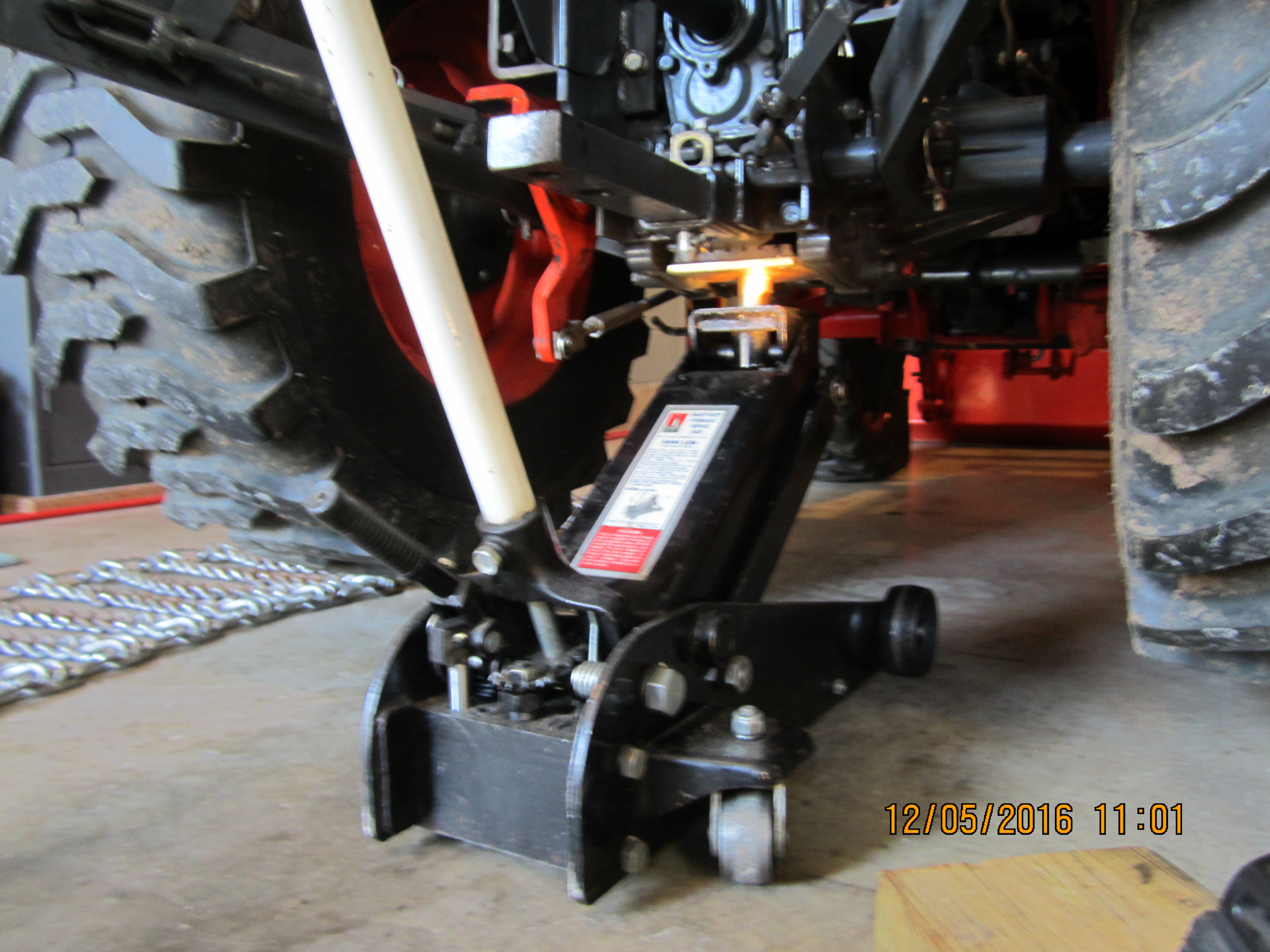

Thanks LouNY for posting your pics to help us out with a new idea. I'm on my tenth year of mounting chains and have made notes to myself and am getting better at it. I use the jack method now and find it not so difficult or frustrating. My happiest experience is to mount the chains and then never have enough snow that season to get in it.:D
Cheers,
MikeView attachment 579293View attachment 579294
That's my method also.
I generally use a bungee cord to hold the chain as I manually rotate a wheel to wrap the chain on then clip the inner followed by the outer.
Due to minimal fender clearance I also need inner and outer binders.
LOL, this year my jack bit the dust so I had to use a bottle jack.

Welcome, it took quite a few years for me to start doing this the directions came with one of my sets of chains 5-6 years ago.
I did one tire my way, then tried the way the directions said to, it surprised me to the first time.
I can't seem to visualize why you specify laying the chains out with the outside down.
because when you pick them up to lay them on top of the tire, the part that was facing down on the ground will now be facing up on the tire.
from post #1;
1) lay the chains out with the outside, the ground contact side facing up
2) tie a short cord to the side chains, the length will depend on your tire size, on mine I end up with a V shape about 3 feet.
3) back up to your chain, take the cord and hang it on the tire treads.
4) drive forward slowly, stopping to spread the chain out on your tire.
5) continue doing this till you have rolled the chain up on the tire and have working room at the rear of the tire
6) your chain should be well centered on your tire and have very little slack.
7) fasten your chains.

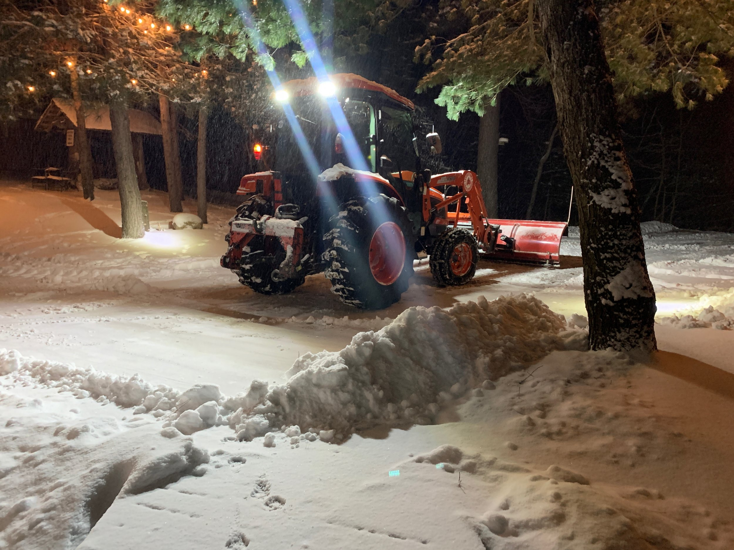

had 4" of snow today....no plans on doing anything with it. will get warmer later this week. high yesterday 22, today 28, wed its supposed to me 39/

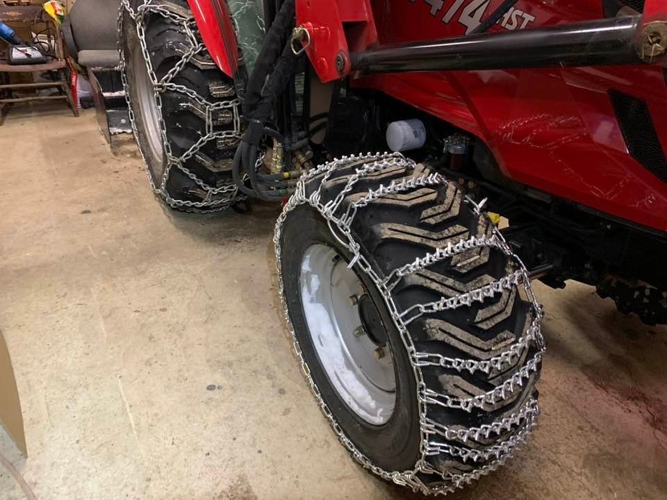

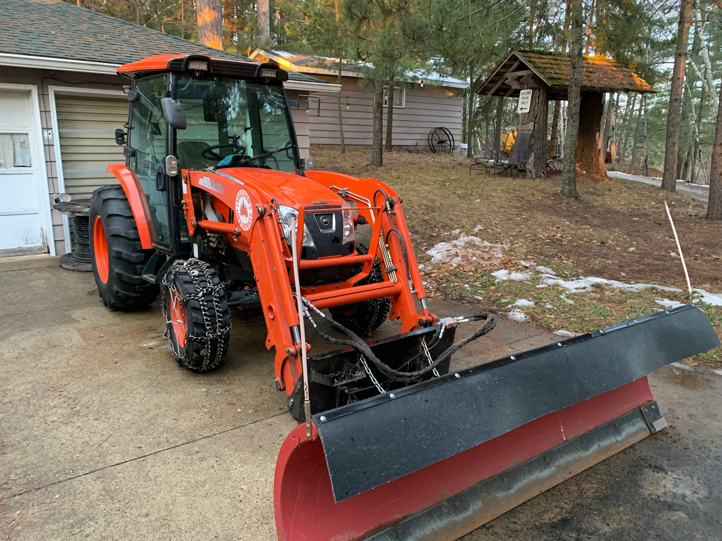

I mounted chains all around yesterday, we have mostly slushy summers in Montana anymore. Wetsnow/rain/freeze/ice........I have a FEL plow, so steering gets light all the time. Figured it was time to chain up on all four.
Kalispell is so mild anymore. I think the last major winter the whole NW MT area has had was 1996-97 when I was in Libby. We left Kal 4yrs ago for a real wintery high elevation area south of Jackson WY and tooled up into a Kioti NX6010 to combat the constant wind drifting. But when we move back to MT it's questionable if I'll need that much tractor again.
