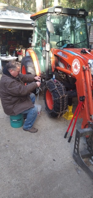

I first lift the wheels off of the ground and crib them. I then pull the Schrader valves out of the tires to deflate my tires (because the beet juice clogs the valves when they are merely cracked open and makes a mess). Once deflated, I then reinstall the valves back int the valve stems. I then puzzle out which way the forestry studs should go and then (ideally) have a buddy helping so that while one of us is using a chain binder to pull the chains together at the top of the tire, the other person is adjusting the chains draping on the sides that get caught on the tire lugs. The second person also supplies an extra set of hands to screw in the pins into the clevises that my chains use to hold the chains together.
After the chains are mounted, I install a spring-loaded tensioner to help keep the chains biased toward the outside of wheel, air the tires back up to 25psi, and finally drop the tractor back down onto the ground ready to go!
