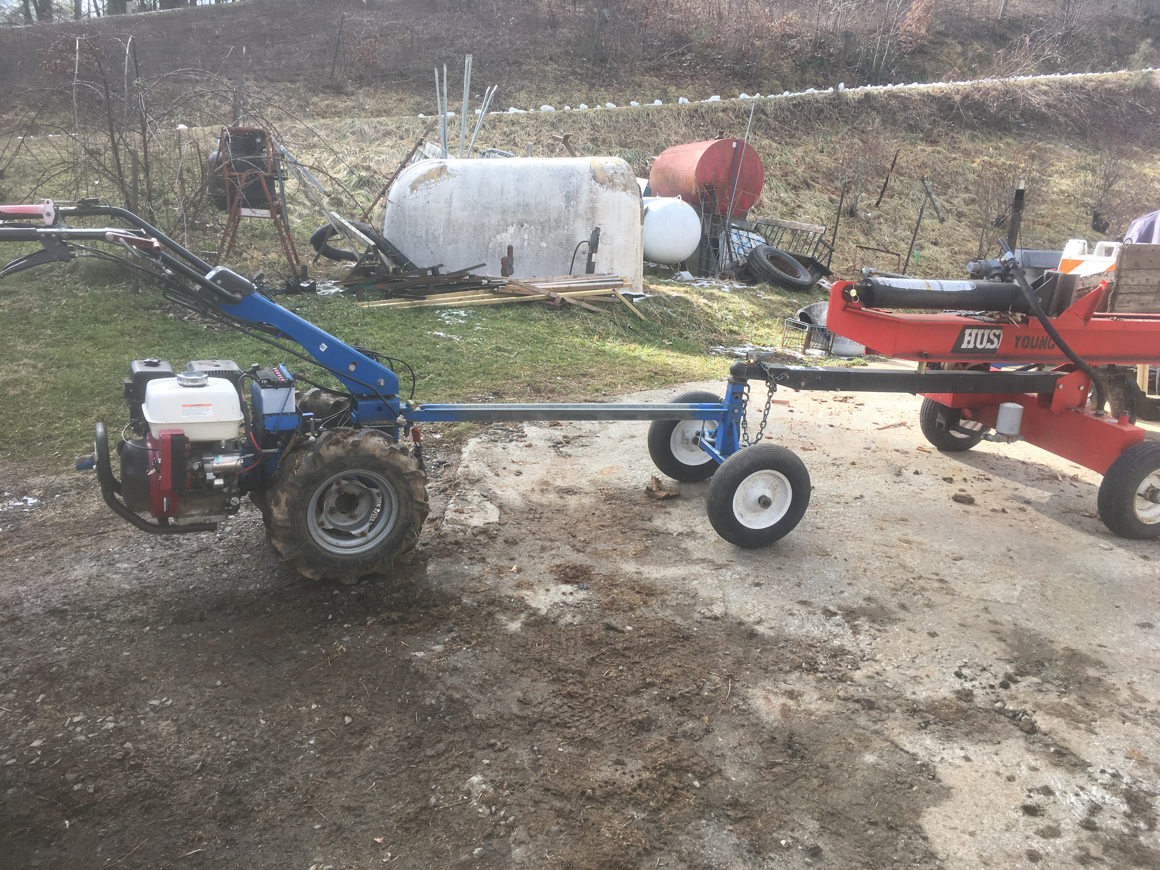

IMG_1199.JPGIMG_1200.JPGI built a dolly to use the BCS to move stuff around. The log splitter, trailers, use the ball. If I'm pulling a spreader I replace the ball with a seat and ride. It does work a lot better to pull the trailer than push, and flat ground would really be nice.

thats a great idea. I was considering an over sized pneumatic caster, but your setup looks much better.
How big is the trailer that you move?

I use the tow coupler (available from Earth Tools) and strap or bolt a short piece of 1 1/4" pipe to the trailer tongue to receive the coupler. I like this method because it uses the tongue weight of a trailer, log splitter, etc, applying weight to the BCS directly for better traction. I also have a sulky and can tow behind that too, which would be like cmyoung2's setup. That works great for longer tows and gives me a seat. Earth Tools
I forgot to add...
I use a small 40" x 48" trailer with wood sides added. I've had it heaped with wet clay and sod, and with me on the front bench seat it was probably approaching one ton. On level ground it drives fine (usually only loaded with half that weight), but I have to step off and steer from the side (walking) on slight hills.

My trailer is a 5x8, but it is very heavy, 1200+ lbs empty. I seldom have to move it with the BCS, and most of my ground is not anywhere near either level or smooth. Mostly it is for the log splitter, garden wagons, seed spreader.

I thought I had some pictures but I can't find any. It's -15 degrees this morning and a foot of snow so I'm not going to get any new pictures, but the link I posted to Earth tools has some that will give you ideas. There are a couple pictures and a few paragraphs describing the tow coupler and pipe on that page I posted, and a couple pictures of small trailers/carts with the coupler here: Earth Tools

On that small trailer I talked about above, it had a ball coupler for regular road use. I originally bought the trailer to haul my BCS to a couple locations for tilling and it worked fine. Funny that years later the roles were reversed and the BCS now hauls the trailer. Since I hauled quite a few heavy loads and when I sit on the front of the trailer (bench seat along front wall) it adds that much more weight to the tongue and was beginning to bow the original u-channel. Last year I upgraded the trailer by removing the tongue and replacing it with a length of square tube going all the way to the back. The tube is sized to accept standard 2" trailer hitches and I can add one to the rear to pull an additional cart, wagon, or wood splitter behind the trailer. I left the ball coupler off the front of the tongue and added a 1' piece of 1 1/4" pipe for my BCS coupler. I can also add a trailer hitch to the front of the tongue and attach that behind my sulky or larger tractor. It looks like a train when the BCS is pulling the sulky, which is pulling the trailer, which is pulling the large gorilla wagon. For most heavy hauling I just connect the trailer directly to the BCS coupler.
