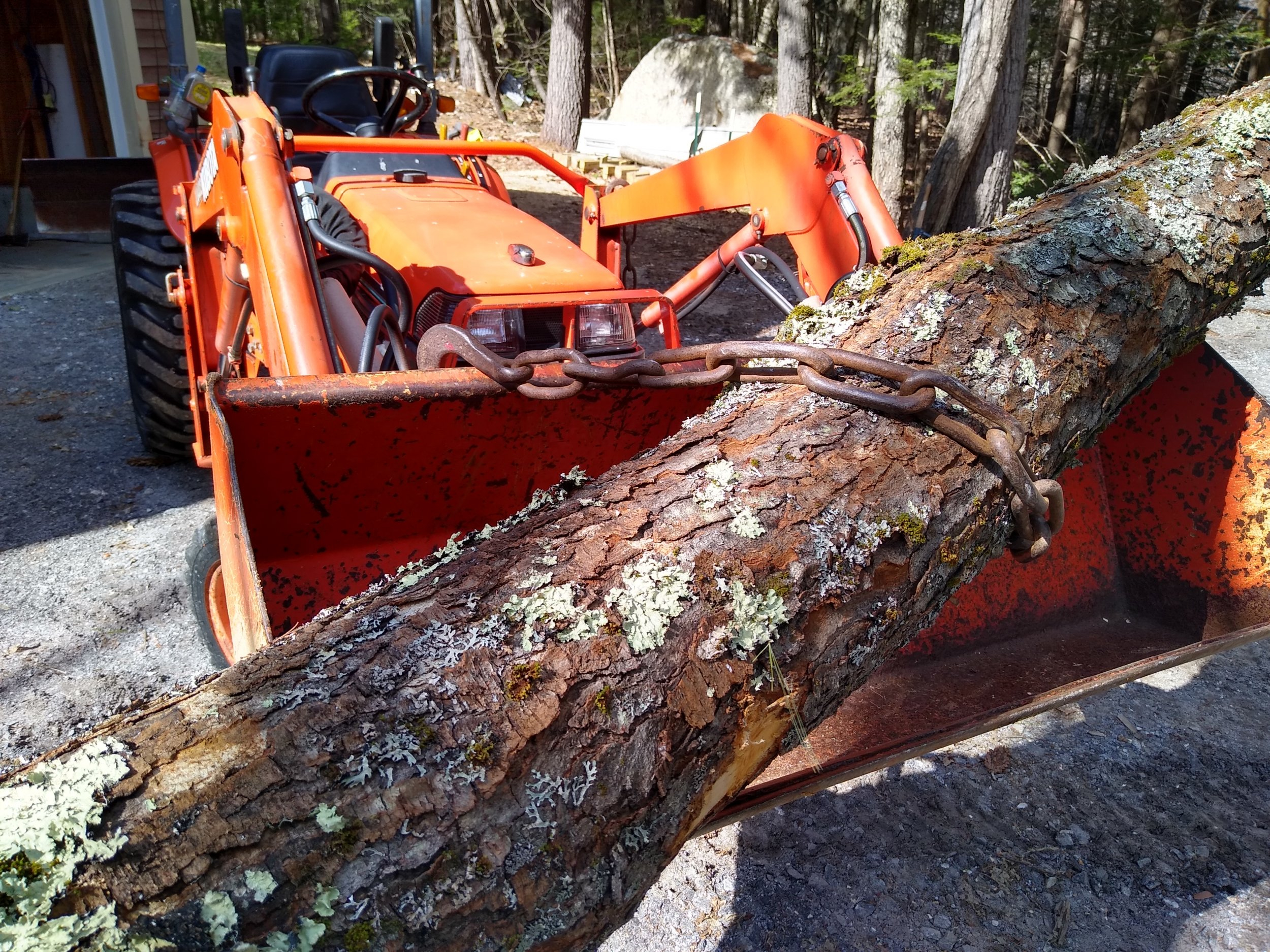

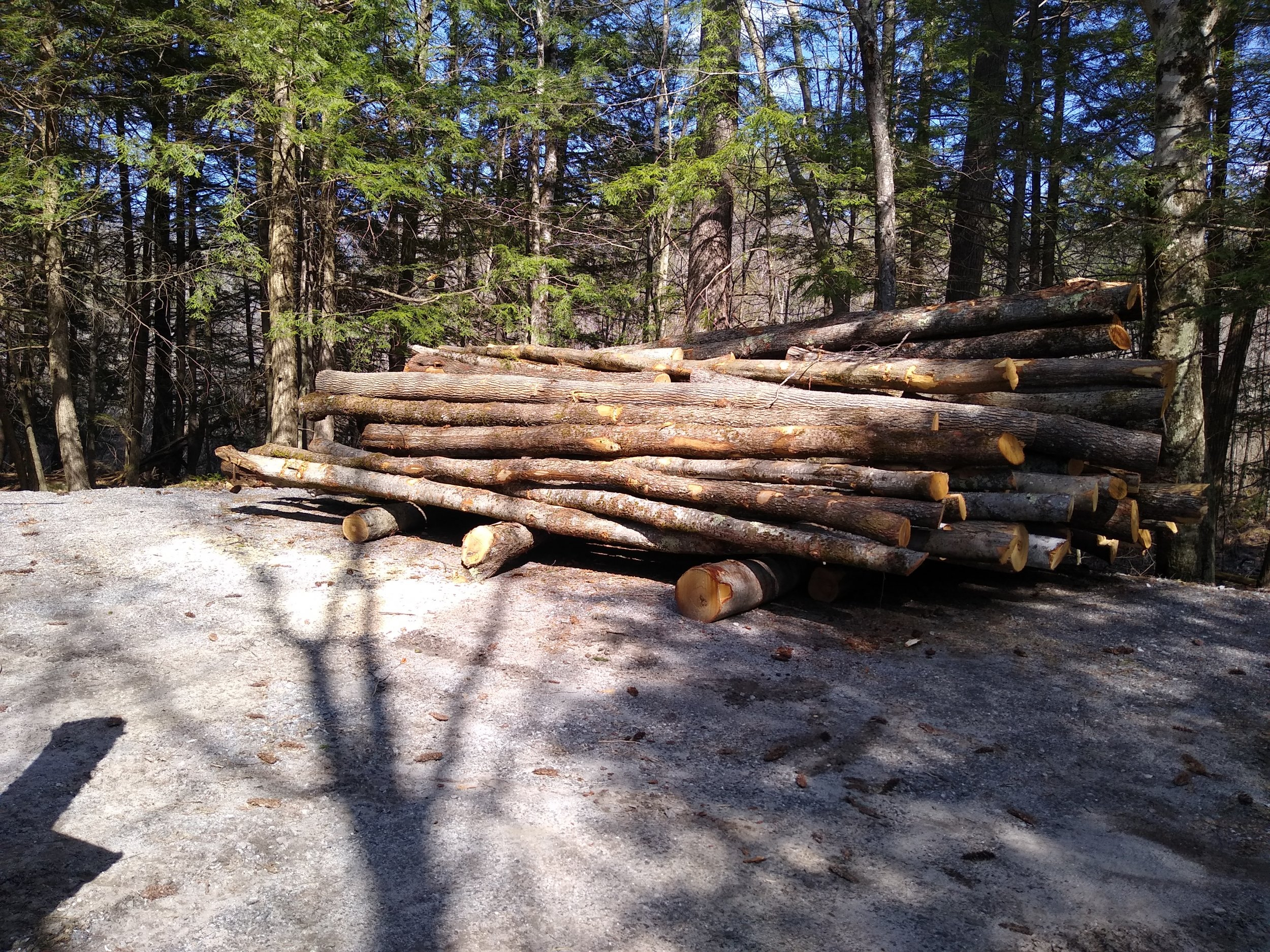

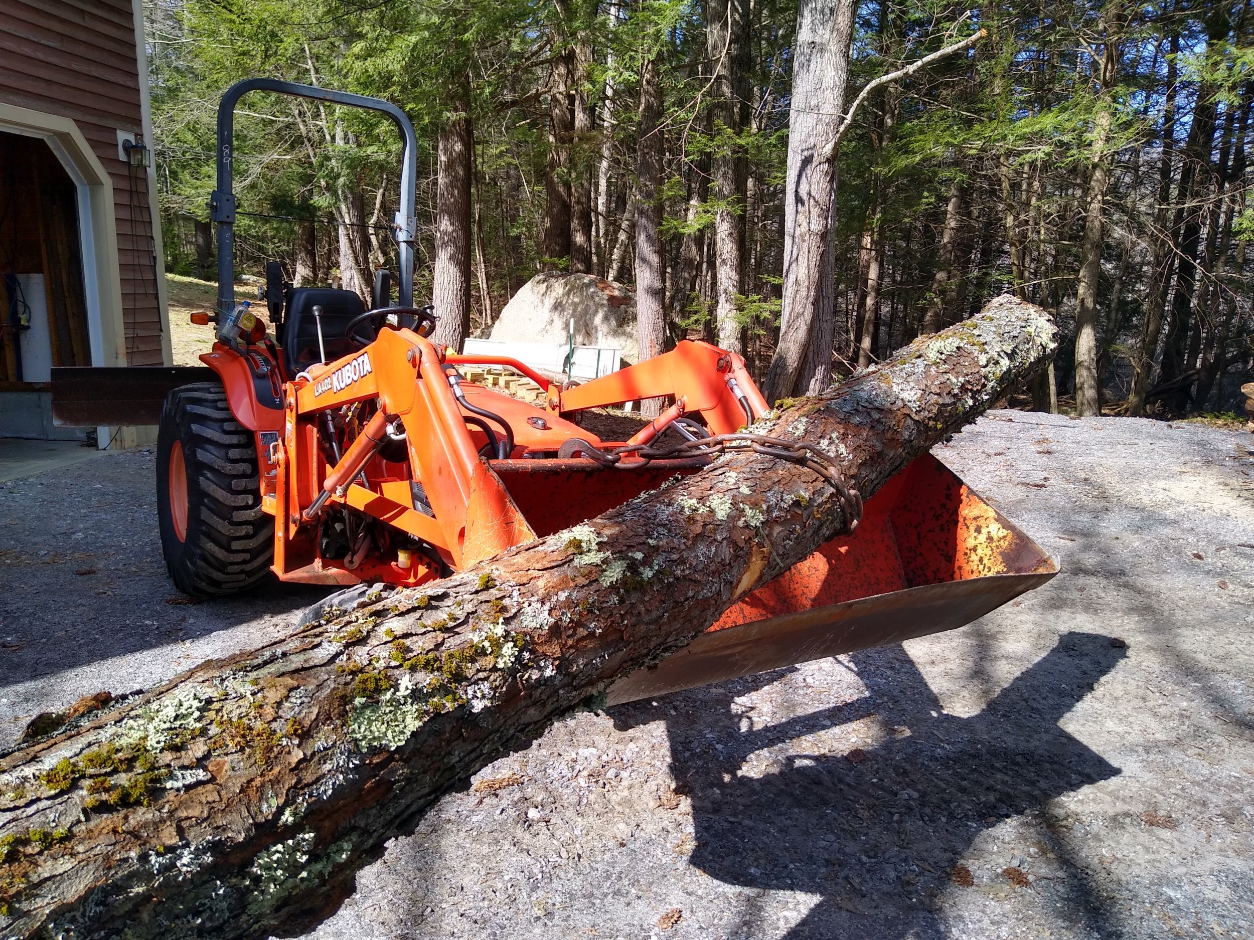

I have a Kubota B2710 which I love, but here's my problem. My logger dropped a grapple load of wood in front of my garage (the only place he could) so it's difficult to get the cars in/out, and it will be impossible to plow next year. It's at least 3 years worth of wood, so I need to move at least 2/3 of the pile before Fall. So far, I've been doing this by cutting each log in half and I chain each "half-log" to the bucket, and move it to the back yard where it's out of the way. This often involves climbing onto the wood pile to unhook the chains. As you can imagine, this is only marginally safer than Alaskan crab fishing.
My dealer quoted me on a L2501HST tractor with an LA525 loader with "quick release" attachment function, and a Land Pride grapple. With the grapple, I can keep the tractor between me and the wood. Much safer.
It's more than I want to spend, but I also don't want to be maimed or killed because I was too cheap to buy the right equipment.
Does anyone have any experience with this kind of work, or the L2501 (or Lx2501) tractor? I like the "quick-release" attachment idea, but I'm afraid of trading "down" from my B2710. Not sure if the engineering is better, or whether they just made it lighter-duty to cut costs.
Any thoughts/ideas/suggestions would be appreciated.
Thanks.
Dave.
View attachment 696855View attachment 696856View attachment 696857
How long is the log on your bucket? And how long a log do you need for your purposes?
If Slowpoke Slim's suggestions are impractical, I suggest bucking the logs into lengths short enough to fit into your bucket. You will have to process the logs for firewood anyway. Moving the shorter logs may require more trips, but the shorter logs will not be as unwieldy and will be safer.
This seems to me the most obvious solution if you will be using lengths even bucket width. It looks like each log would only require 3 cuts to fit in the bucket. Then using muscle put the 4 pieces in the bucket and take them around back. You might have to make more trips, but that would not cost much.
And unless you NEED full length logs you have to cut them up sometime.
I would (and did) buy a pair of clamp-on-the-bucket forks for moving logs. They were a little over $100 10 years ago.
But I want my logs 10' long for my sawmill.

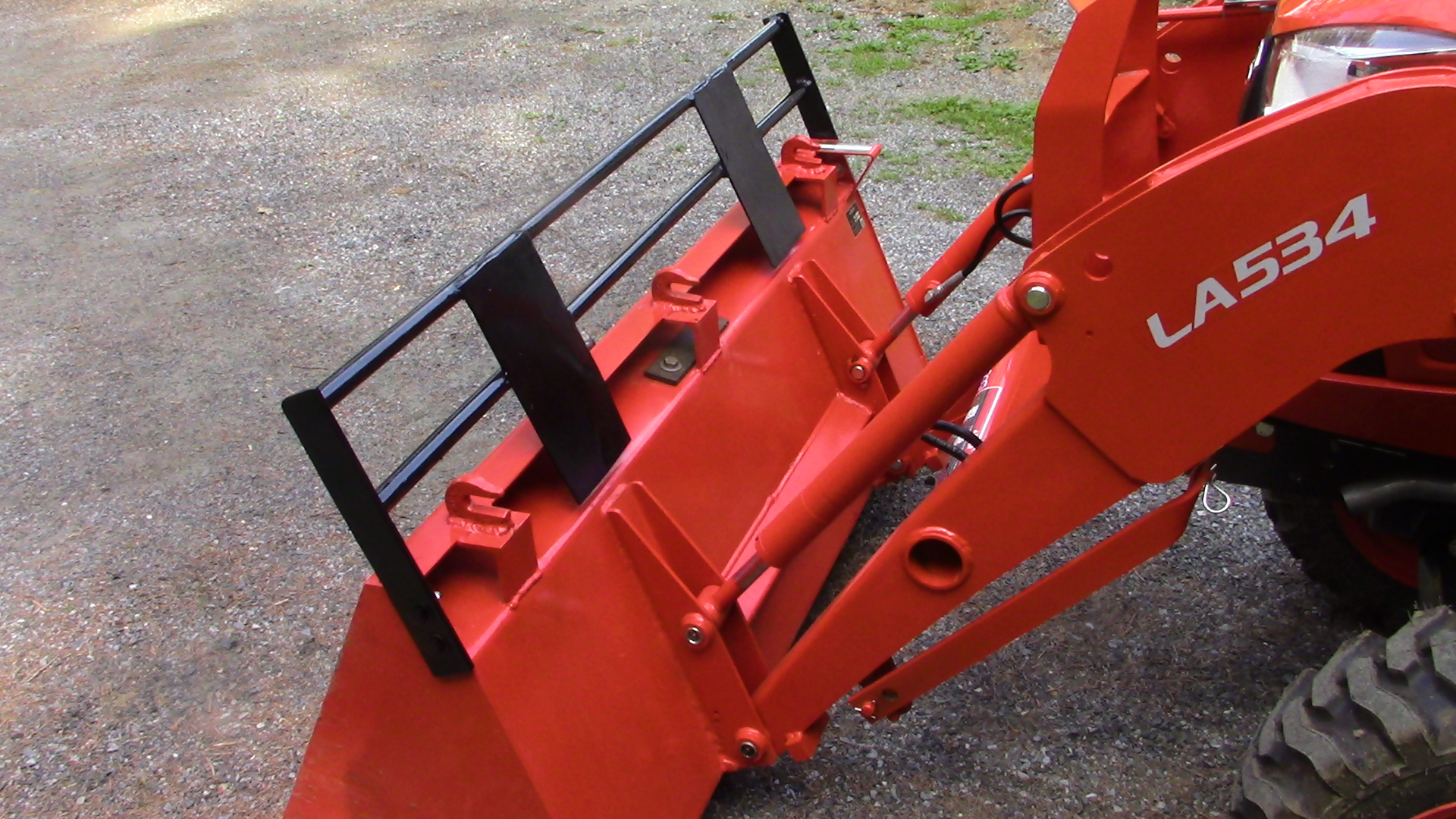

How did you get the "back fence" on the bucket? I like the idea of logs not ending up in my lap. But with those tongs, the log would want to go parallel with the tractor.(?)
I used 1/2" x 2" flat stock drill 2 holes used 3/8" bolts.
2 - 1/4" x 12" plate for protection of piston.
True sometimes the log will swivel but not often if log against bucket,if in tight area tilt bucket just enough to pass object.

Nice job Thomas - I like that a lot.

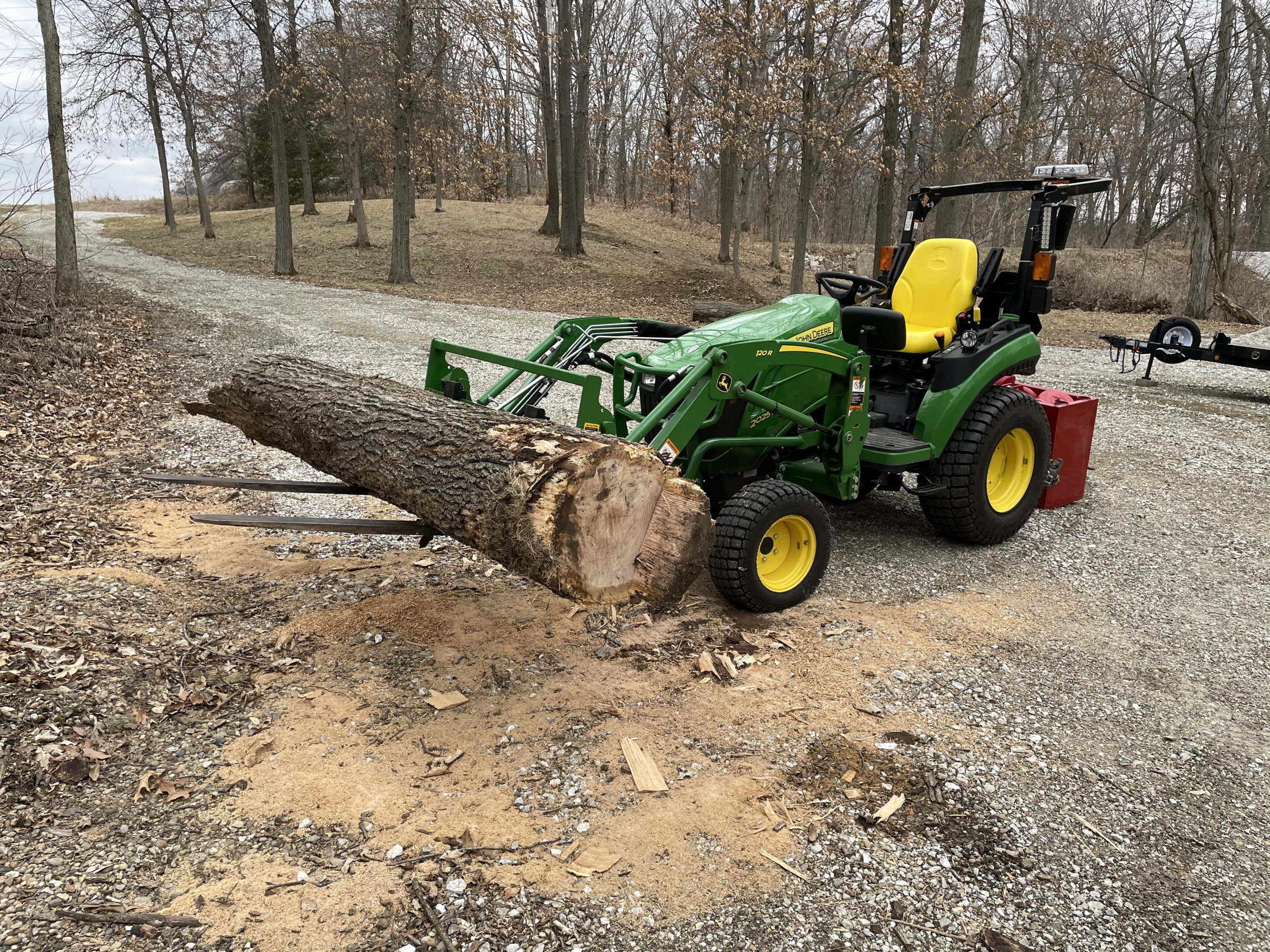

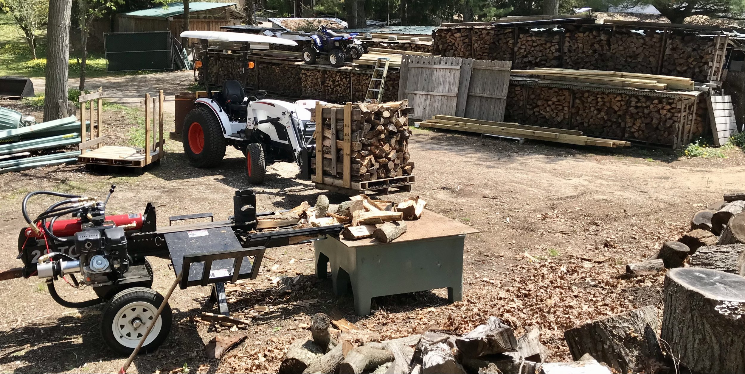

Post #23 mentions WR Long. They are the best and custom make the quick attach to fit your tractor model. I did this with my old Ford 1920 and they were great to work with! Remove your old bucket and pin on new quick attach bracket to the loader arms. You do need to cut the tabs off the bucket and well on a new backplate
Pallet forks are the most useful attachment to have and not too expensive at that.
You can easily lift the logs and make pallets to hold split wood
Long term solution convert bucket to quick attack
Short term you can move the logs easily with a short chain like in pics below
