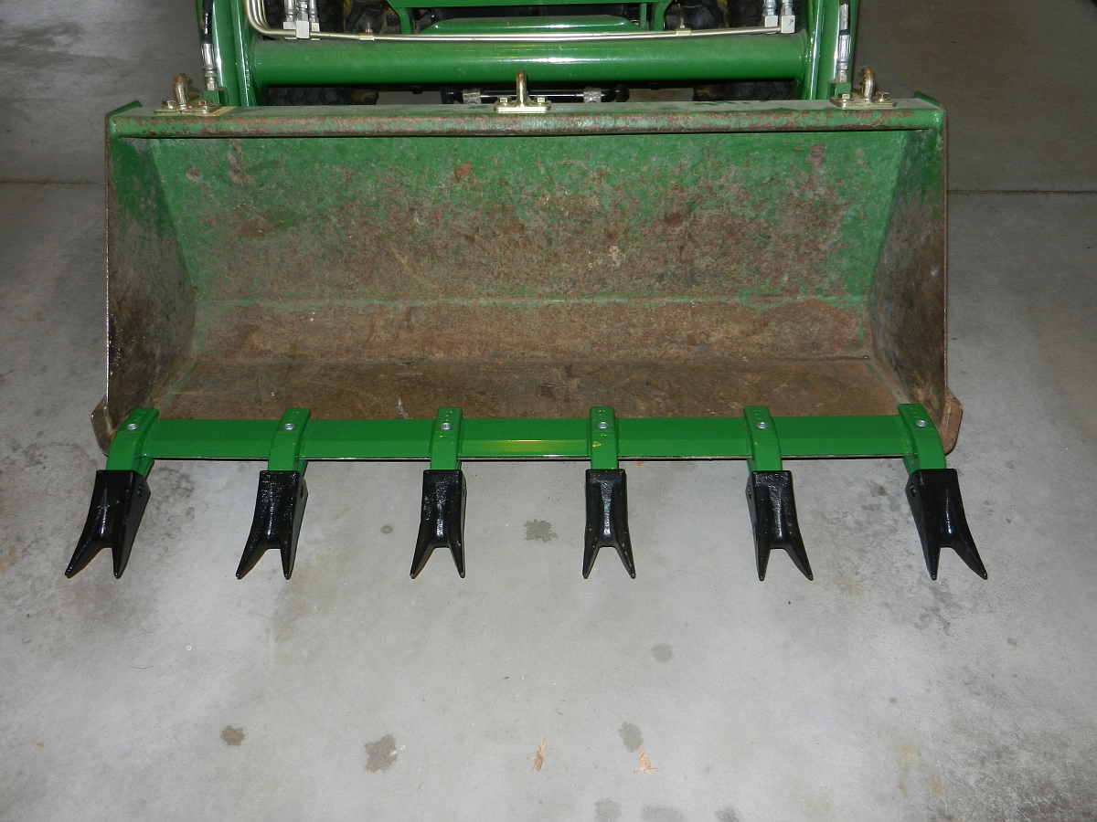

Add some hooks to your bucket - good source is Ken's Bolt-on Hooks and if you are looking for inexpensive forks, hit up Pallet Forks.com (Titan Attachments). I bought two sets of their 30 inch working length forks, one for me and another for my Dad. Easier to work with than some of the longer, heavier ones available. Here is what my set up looks like. Or as someone else suggested, a good set of teeth. Heavy Hitch has some teeth sets that don't require drilling, but you will need to call about the fit for your Kubota as bucket thickness. Here is what mine look like - note the bolt-on hooks on top of the bucket.

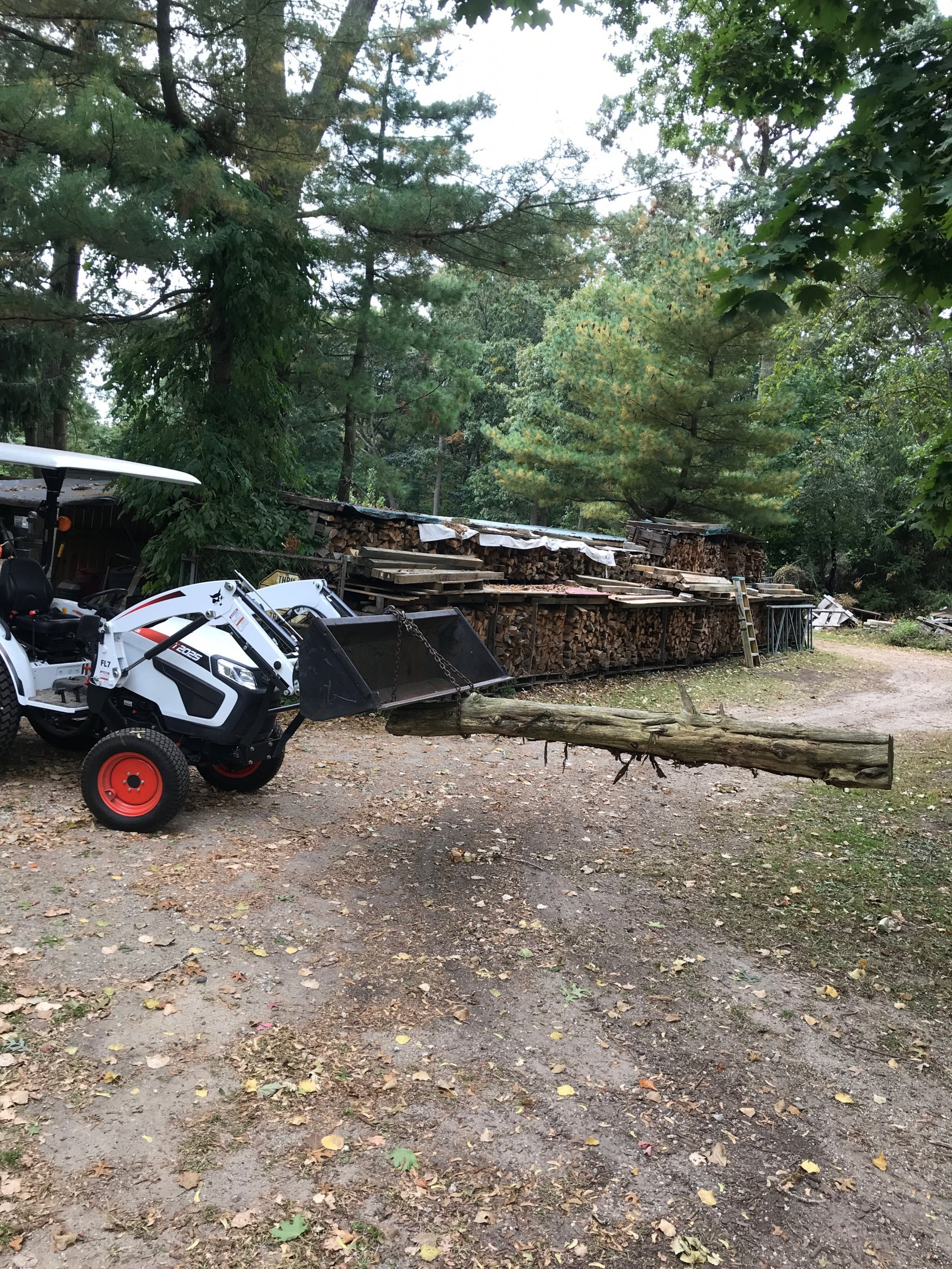

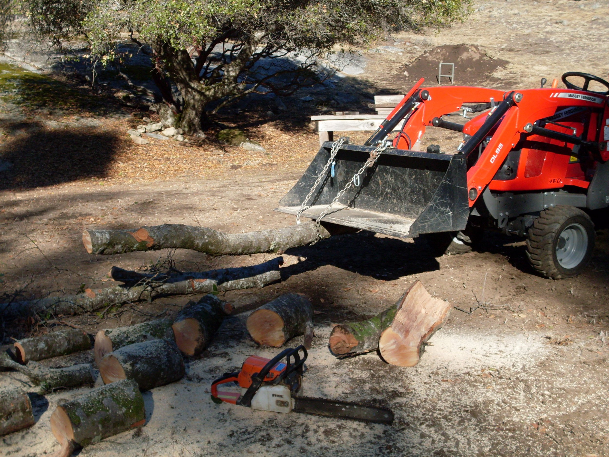

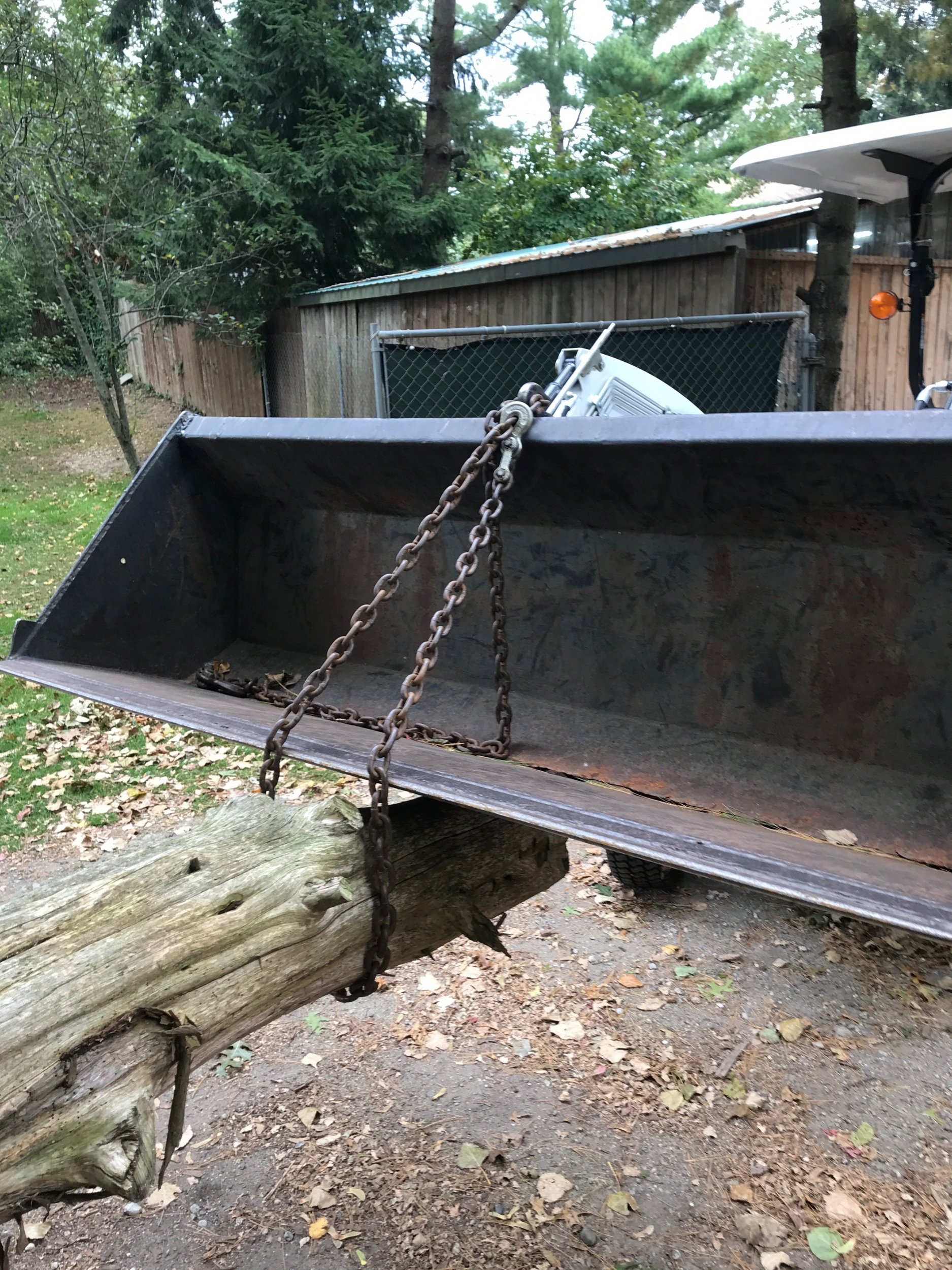

I have a Kubota B2710 which I love, but here's my problem. My logger dropped a grapple load of wood in front of my garage (the only place he could) so it's difficult to get the cars in/out, and it will be impossible to plow next year. It's at least 3 years worth of wood, so I need to move at least 2/3 of the pile before Fall. So far, I've been doing this by cutting each log in half and I chain each "half-log" to the bucket, and move it to the back yard where it's out of the way. This often involves climbing onto the wood pile to unhook the chains. As you can imagine, this is only marginally safer than Alaskan crab fishing.
My dealer quoted me on a L2501HST tractor with an LA525 loader with "quick release" attachment function, and a Land Pride grapple. With the grapple, I can keep the tractor between me and the wood. Much safer.
It's more than I want to spend, but I also don't want to be maimed or killed because I was too cheap to buy the right equipment.

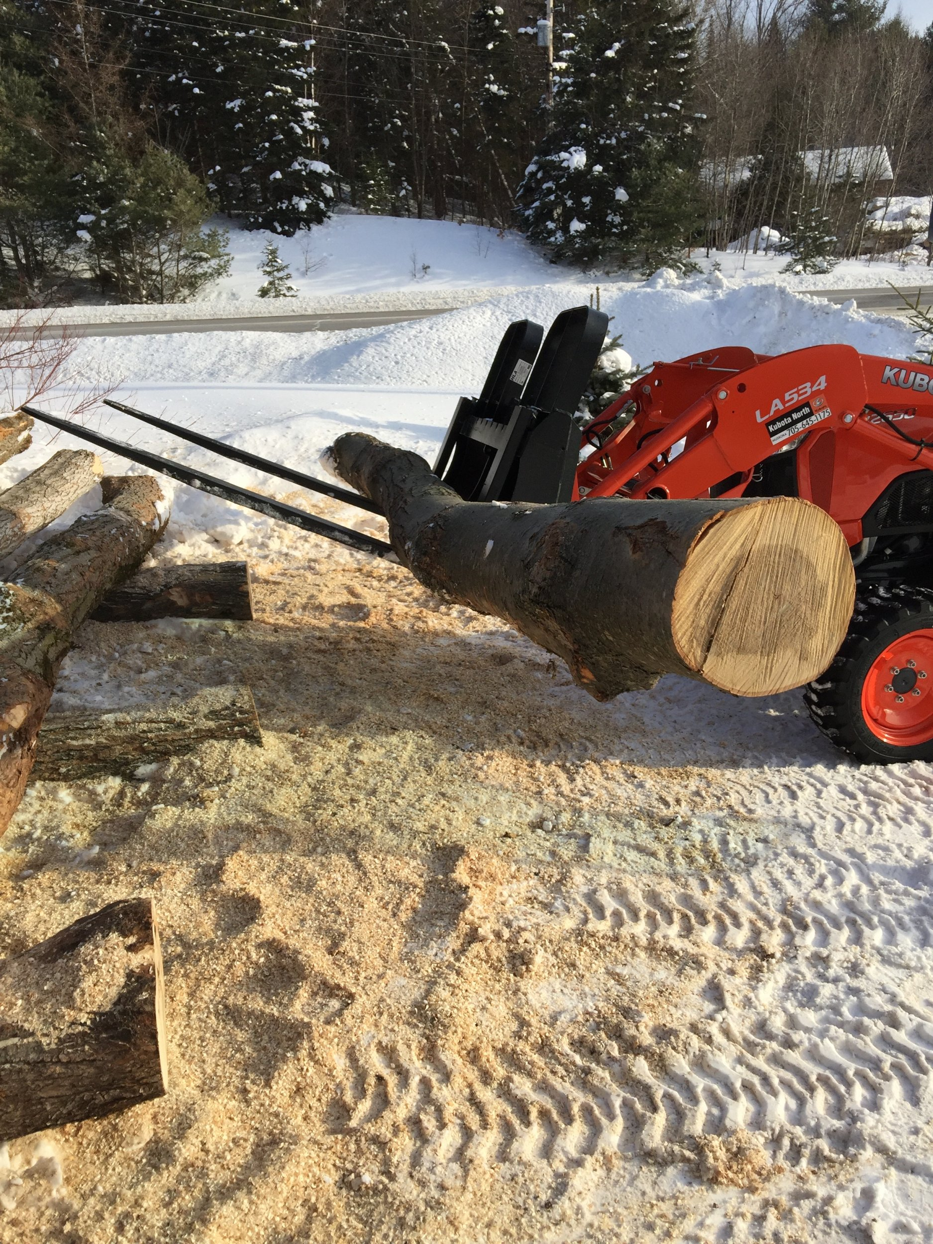

Forks. I cut 40 face cord a year and pick up 2 to 3 logs at a time with my B2650. Quick attach and pallet forksIMG_8113.JPGIMG_0868.jpeg

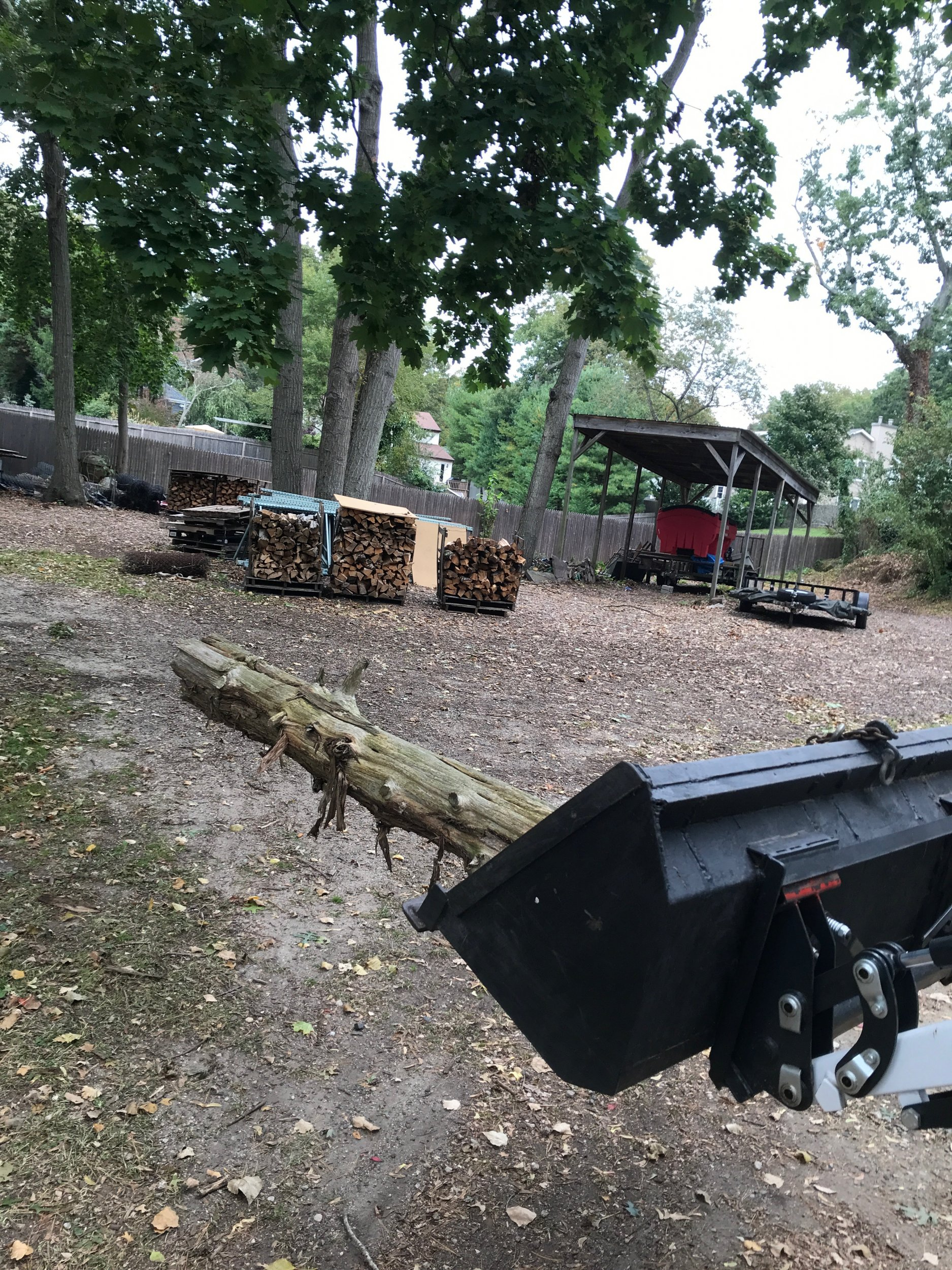

These "forks" were made for 50 bucks. 3/4" stock. They bolt to the bucket with 1/2" bolts.
If I had to do them over, I'd make em out of 1" stock.
The curl in the stock is important. It makes it uber easy to mount the log onto the tines.

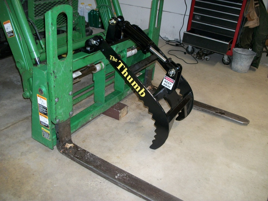

Get the forks and then add "The Thumb" for an effective and low cost solution.

Nice. I had something similar on my first Kubota. One comment though; It would be simple and advantageous to put an upright piece on each fork to prevent the logs from rolling up the bucket and down the loader arms into your lap. Recent;y I posted about a local man who didn't have that, and was killed when a log rolled onto him. Self exiled member OldPath also pointed that out frequently, and showed how his bucket forks were set up.
This is always a good idea.
I think some people curl their buckets too much in order to hold the logs in. They also raise their buckets too high w/o tipping the bucket down for fear of losing the log.
These forks are long enough to hold the stem in and the little "curl" on the end prevents them from rolling off as I tip the bucket to approach load off.
I can safely stack logs in this way with no fear of roll back.
Those little fork bar holders I have are 8" off the bucket and can also lend themselves to prevent roll back.
They have never had to be put into effect in this way with these forks and responsible fel handling
