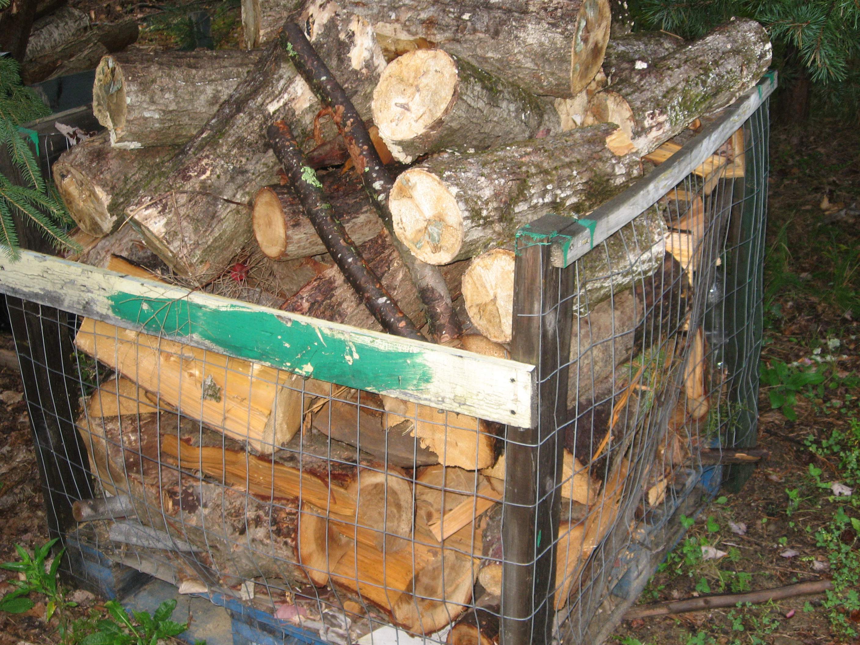

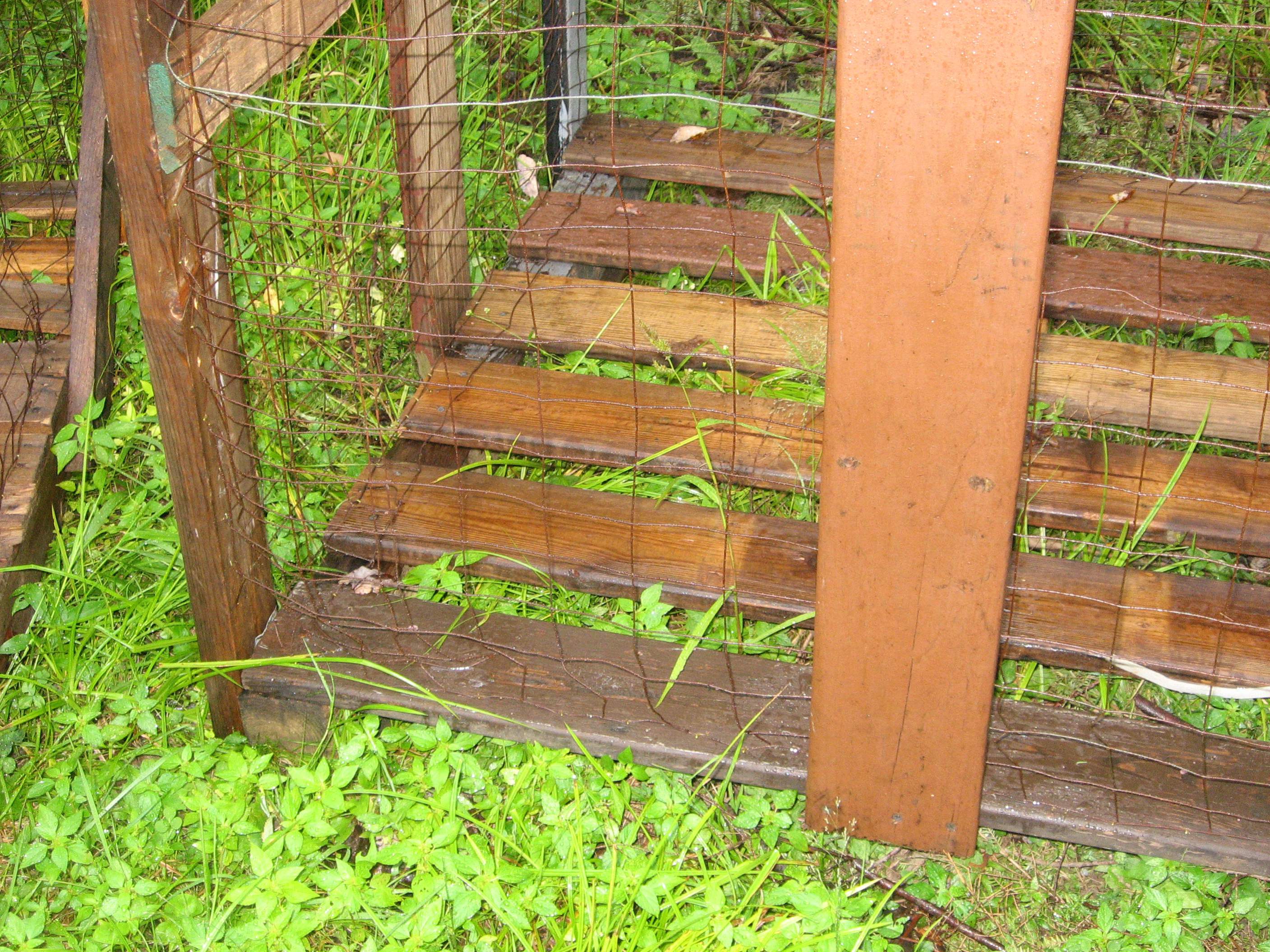

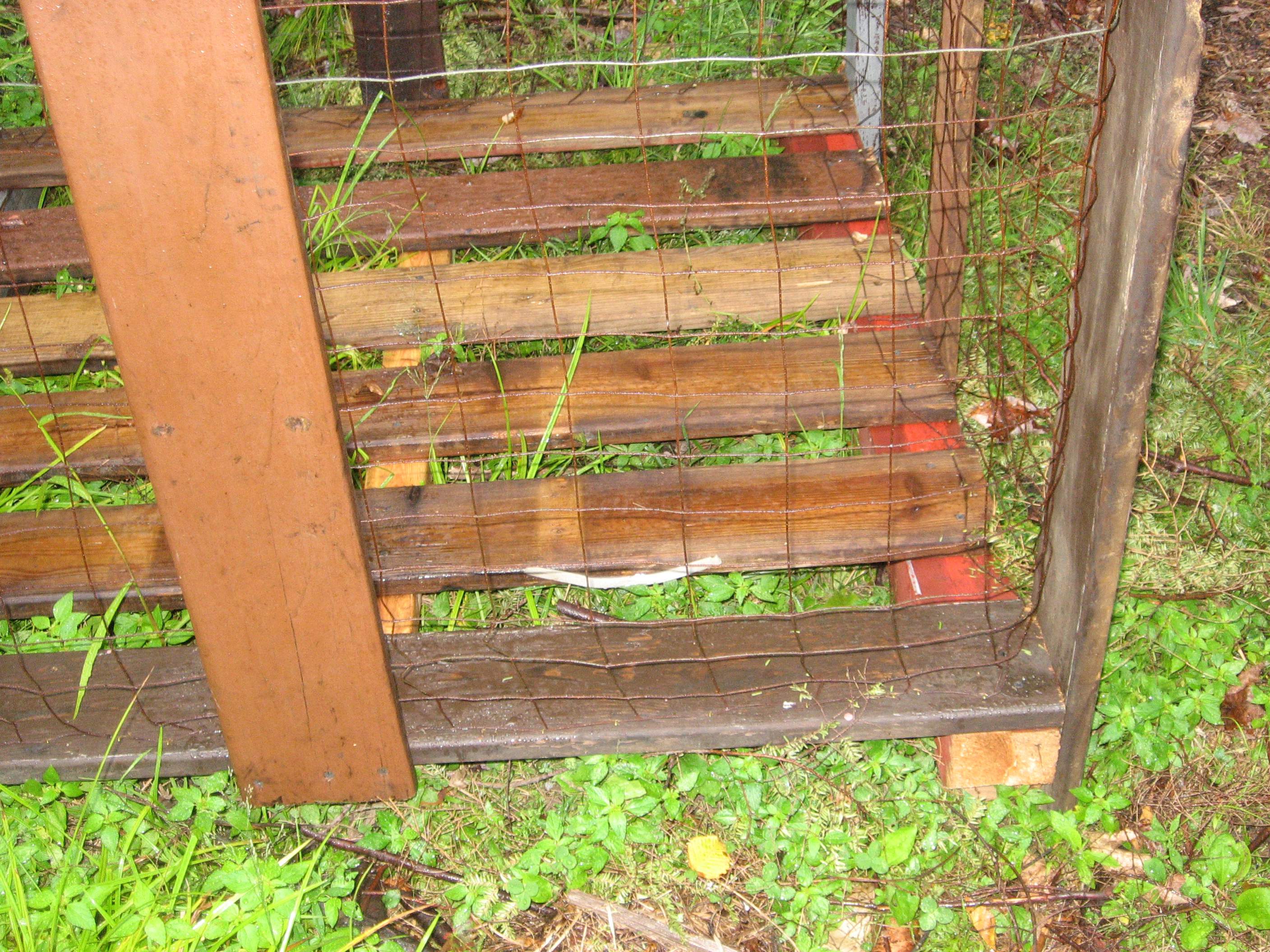

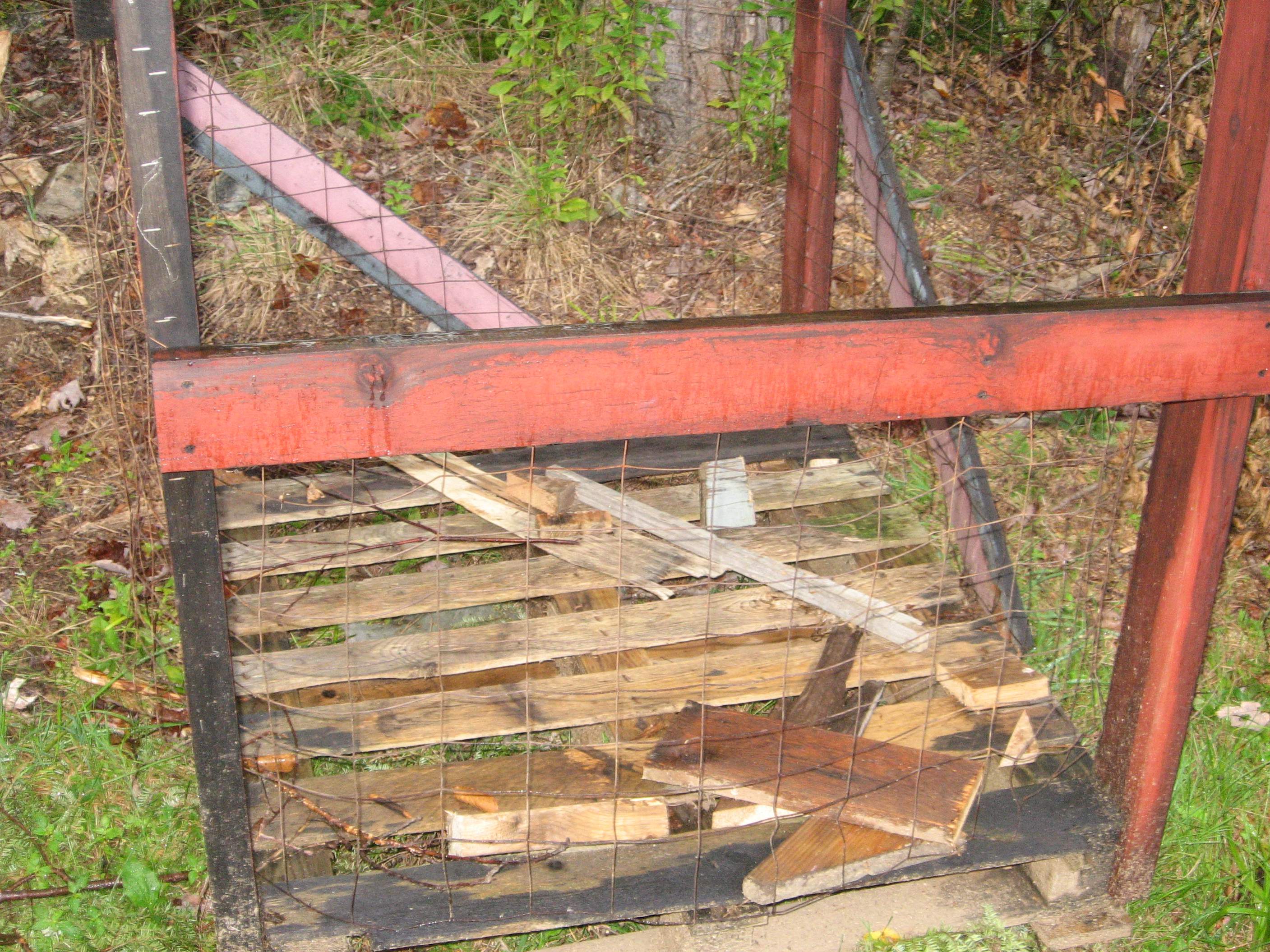

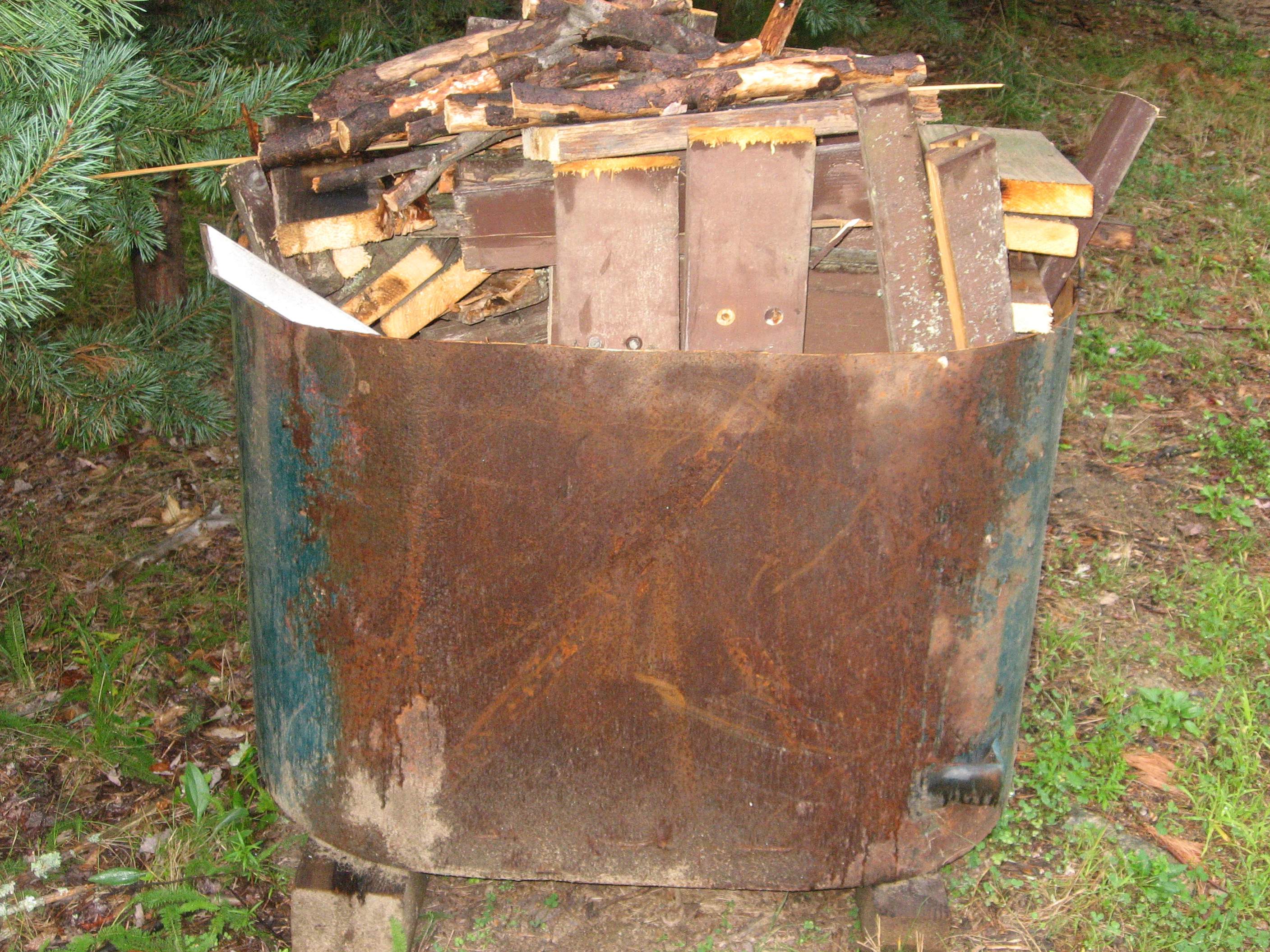

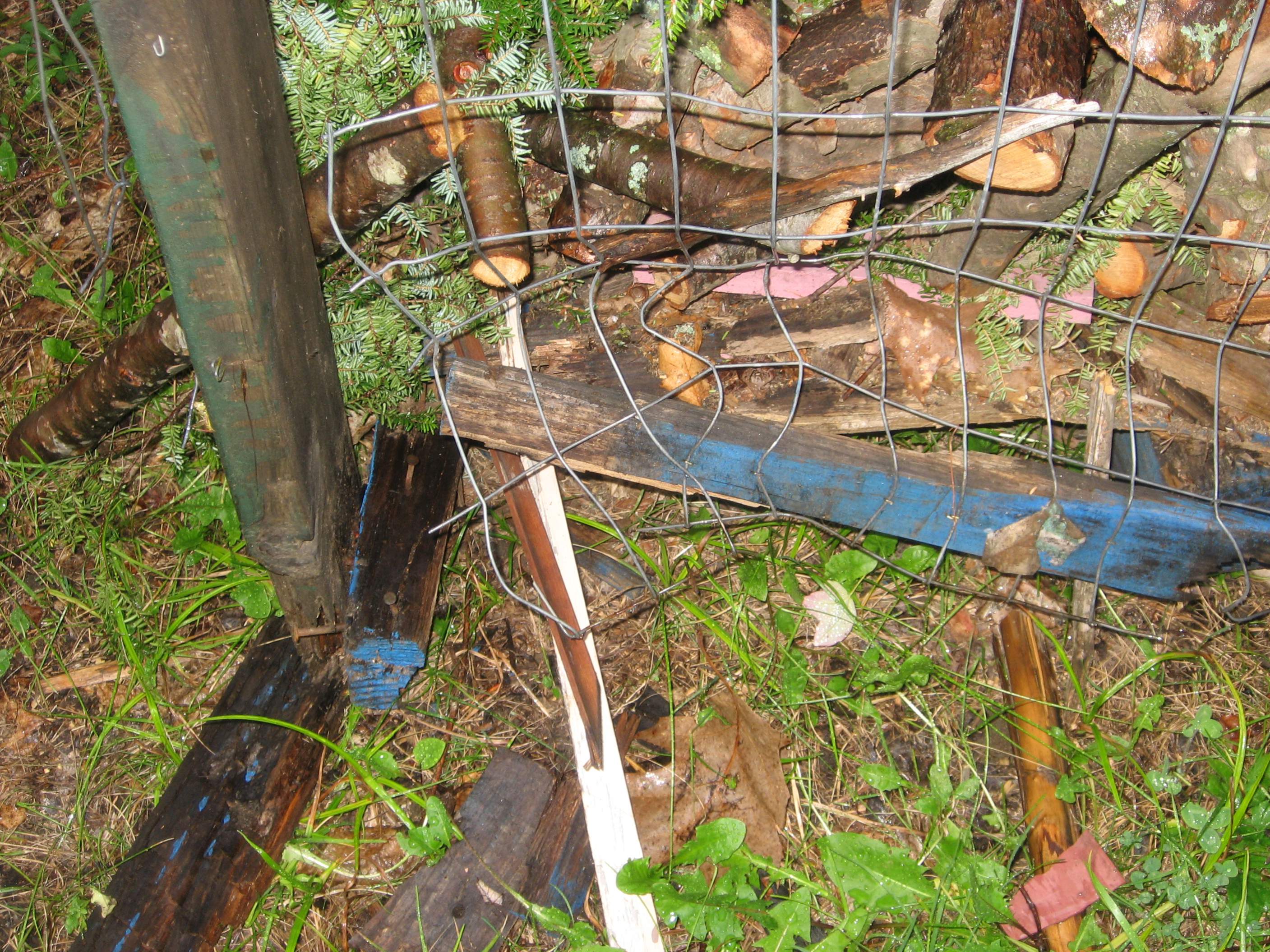

here are a few.nothing to pretty, but for the low cost of used lumber etc. they are works of art . Also not the old freezer as a tote, and the old oil barrel cut in half.:laughing:
Oh and the second ones show what happens when your to high with the forks onthe 'pallet 'type.

Chopped, those r very creative. What tool did u choose to cut the oil tank with? How long did it take to cut? How difficult? Would u cut it again? I ask because I have two fuel oil tanks, which r in great condition, but if I don't find someone interested in them, I've been pondering ideas for cutting them into "rings" to hold the wood.

Sure Id do it again.One I used a torch, but it was messy .So ive progressed to using some abrasive wheels for the circular saw. they have them at wal mart for around 5 or so dollars for three.
I think I used one wheel if that.A note is if you do that, make sure you give the saw 'breaks'.It can heat up fairly fast. I used an older saw and it really takes a toll if you push them to much. Ive just lately been using a fan to blow cool air into the end of the saw.That helped greatly.With the chop blade you get a good clean cut.some suggestions are to not bury the blade any deeper than you need.I also went lightly to make the initial score mark and then I went back and forth working it.sometimes even cutting backwards.I drilled a few holes in the bottom for drainage.And then used a 4x4 for the skids. a couple of good lag bolts from the inside out the bottom into the wood.they are quite rugged.
