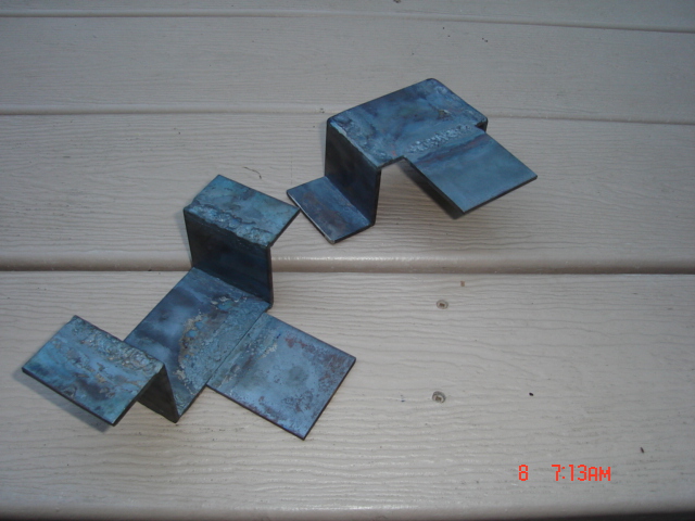

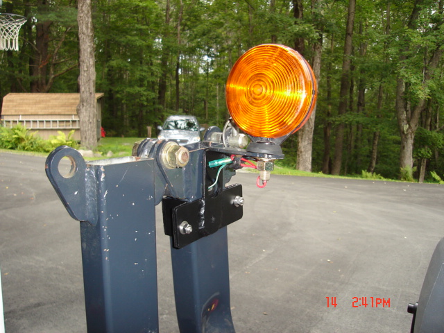

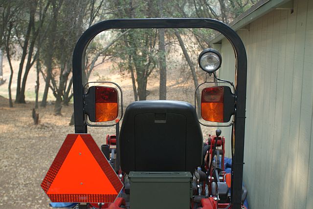

"I do not know why they put them outside the ROPS..." I think the idea was to give the BH operator, when the seat's spun around to the rear, more room.... but I'm small enough it's no problem. As far as being mounted on the ROPs, I suspect there may be a height requirement for SMV blinking lights.
When I moved my lights, I welded together some 2" wide by 1/8" mild steel pieces to fashion a clamping bracket; used original mounting holes.
