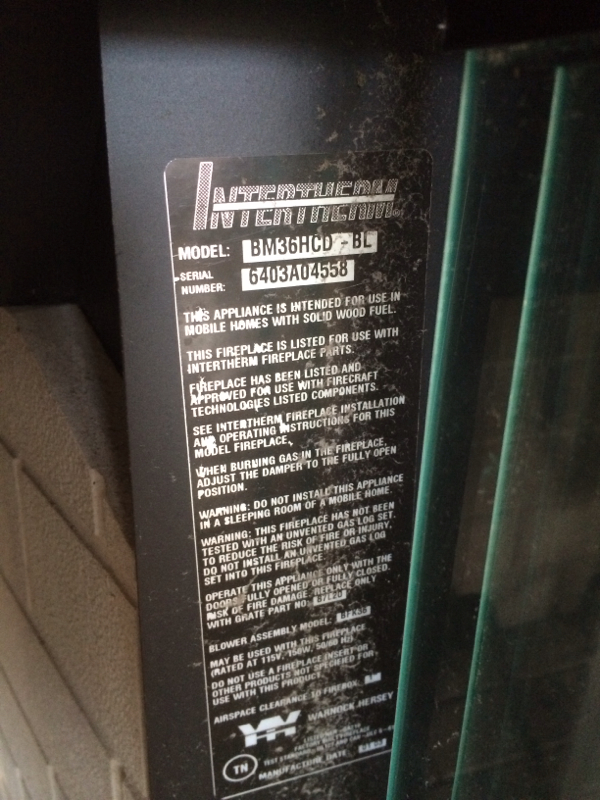

Here is the tag on the fireplace.

I would give the one you have a try. Any time you can wait to spend money, it is a good thing. And you can get what you want to go in the house then.

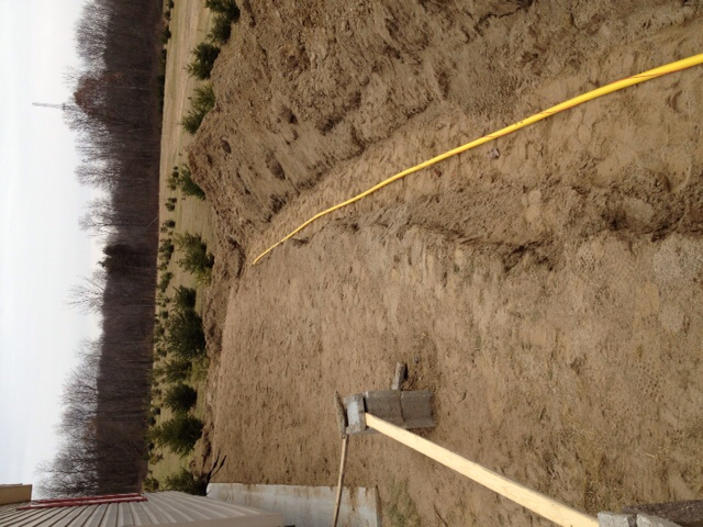

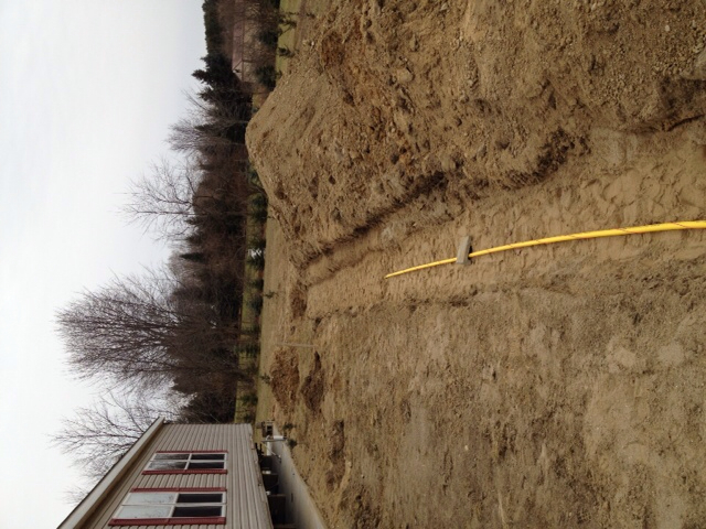

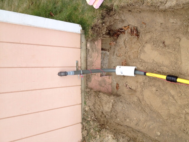

Some pics of the gas line.
