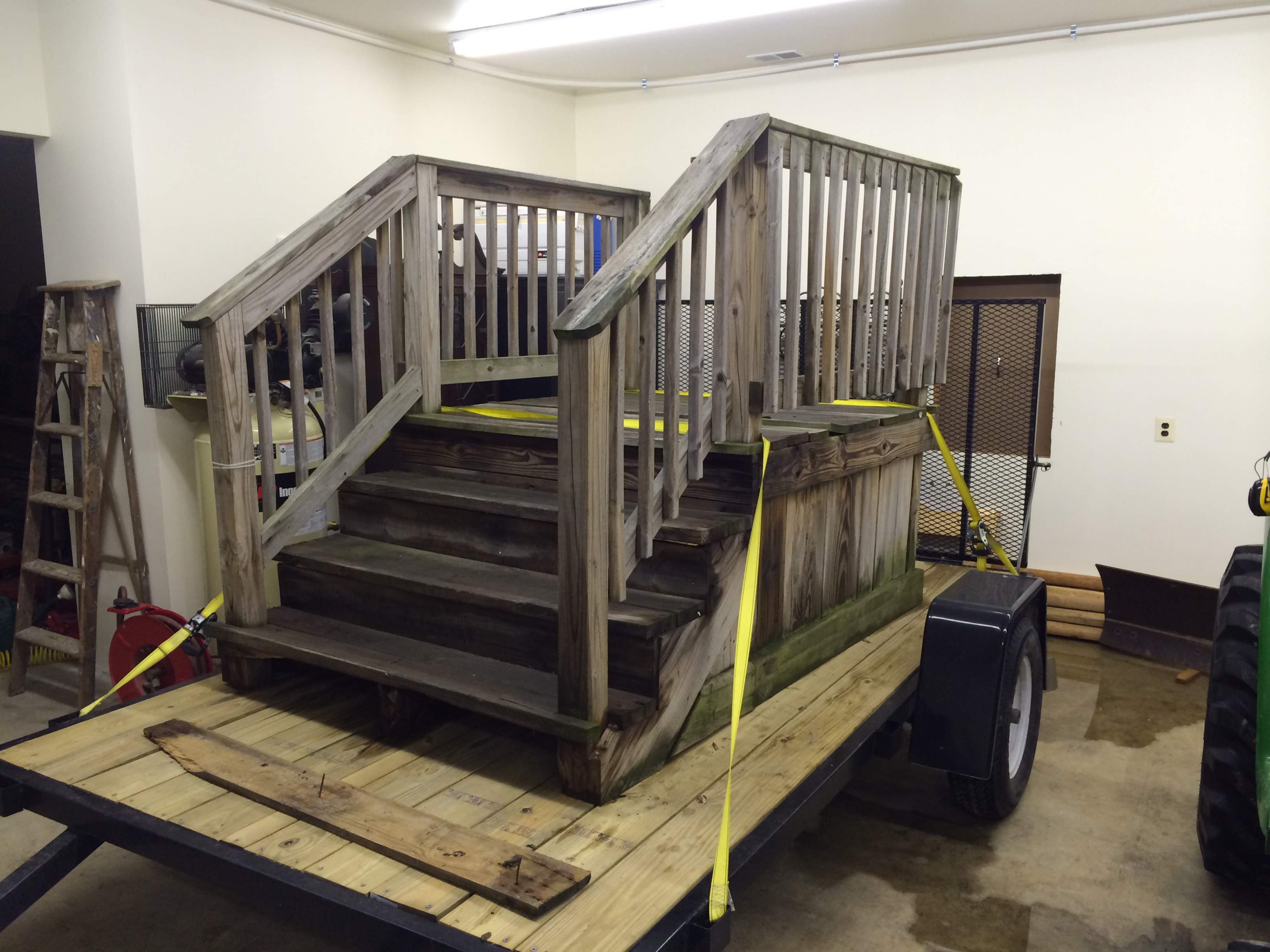

I had a busy weekend. Picked up a set of stairs, some foam board insulation for behind the skirting, and nearly got my van stuck. Oh yeah and the tractor won't start.
I used it to plow snow on Friday, and when I tried starting it on Saturday evening it wouldn't turn at all. When I tried to jump it via my van or jumper battery it would try but not turn over. I have to imagine the starter isn't getting enough juice but I haven't had time to clean the battery connections or try to start the tractor straight from the starter but hopefully I will find some time soon as I would like to use it to try and help unload the stairs.
More details can be found here http://homesteaddad.com/2014/01/12/snow-stairs-rain-dead-tractor-and-other-updates/
